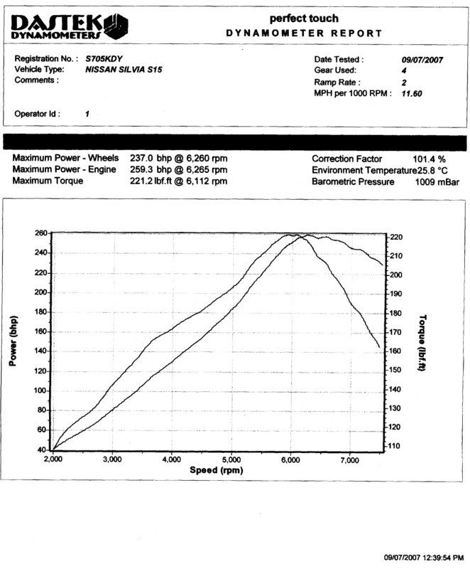

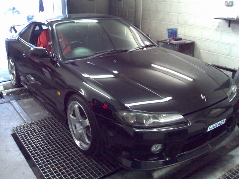

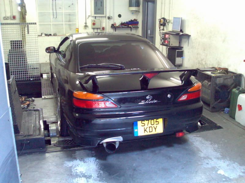

Popped down to Perfect Touch in Hoddesdon for a dyno run,as before I start to up the power I thought I'd better check that all is ok.It came out at 237whp (260 fly) which considering the only mods the car had is an Apexi exhaust and unknown air filter,I thought wasn't too bad:D Rob the dyno operator did say that it was running an AFR of 12 on cruise and 10.5 on boost :eek: so pretty rich! he thinks the lambda's at fault,he said the overfueling was robbing me of some power,but as I'm going to change the ecu for a apexi power fc which doesn't need the lambda no point in getting a new one.There was absolutely no det whatsoever so good news there too,let the modding commence :D

:cool: Just remember though that det will have been kept at bay due to the over fuelling, which in turn was possibly caused by the lambda. As you say though, the PFC is going on before you alter anything else :)

Nice one mate. Nice and smooth curve there.
