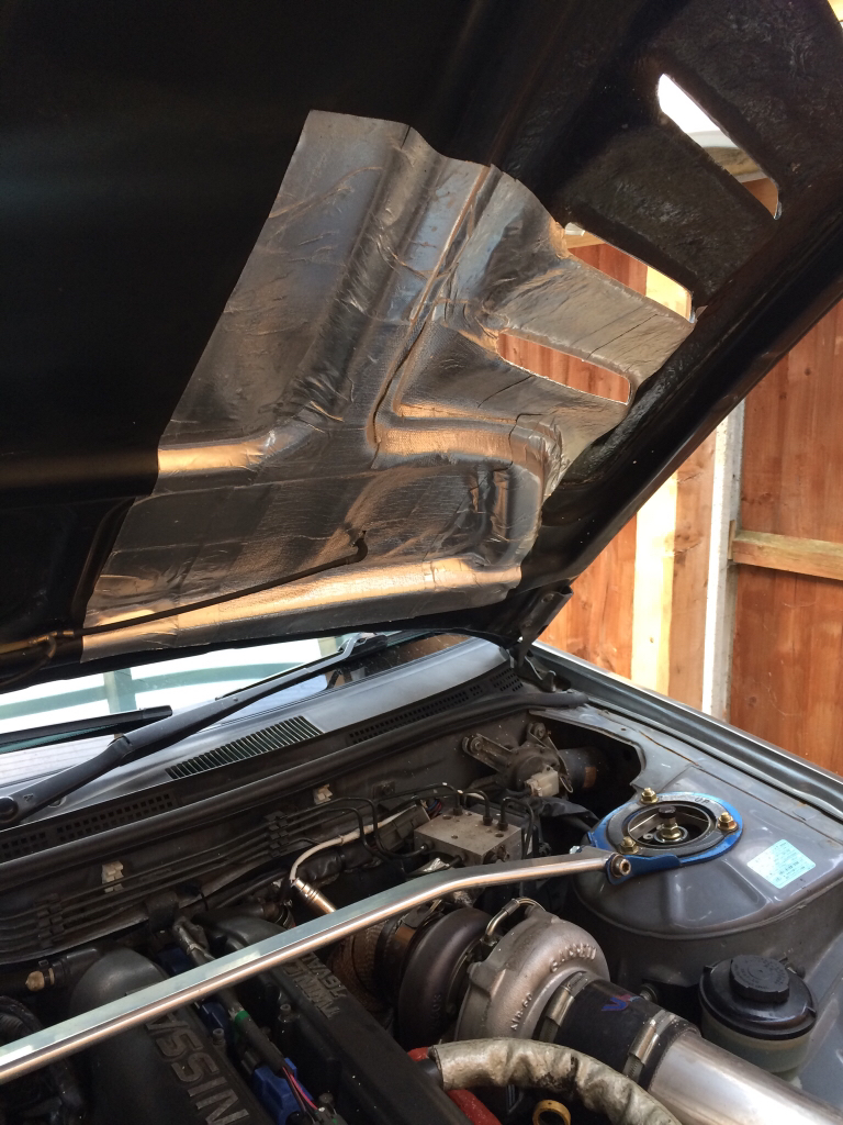

I've covered the underside of my cf bonnet with heat reflective sheets. Seems to have worked so far and that's with a top mount :)
17 January 2012
323
Essex
@kwalker88
did you coat the entire underneath? Any pictures?
drifter
4 April 2011
512
10
Norfolk
17 January 2012
323
Essex
@kwalker88
Awesome, Thank you. I think that might be my first port of call. Wack a load of heat deflector under the bonnet, raise the bonnet slightly and make a heat shield up to bolt to the block.

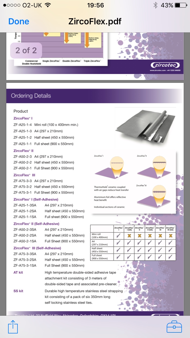

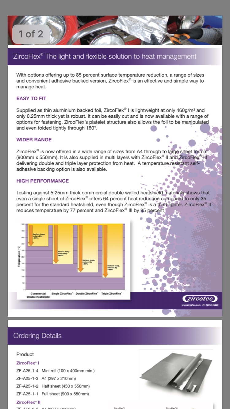

I'm in talks with zircotec about becoming one of their performance centres , this looks a good option
Or they actually offer a lower cost performance coating that can be applied to the manifold /turbo/downpipe that's not ridiculous money. I'm getting my turbo and mani done soon so can show you how it comes out if that's something that would interest you
17 January 2012
323
Essex
@kwalker88
That's the stuff i was looking at. It's not cheap but I think it may do the job. Can you let me know how it goes with them!
I've read some stories about coating used manifolds causing them to crack....I think that'll be my last option!
