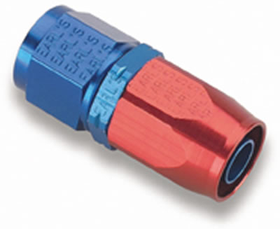

This is what I will use to fit to the oil lines.
I will cut the oil hoses and fit the correct ones to match the thermo. But how do I know that they'll fit the hoses I've got?
I can't see anything about a outer diameter on the hose?
39
Is the "6 AN" and "8 AN" and so forth some type of measurement of the diameter??
If I get 6 AN fittings I've got to have a 6 AN hose??
In that case. How do I tell what hose I've got?
39
