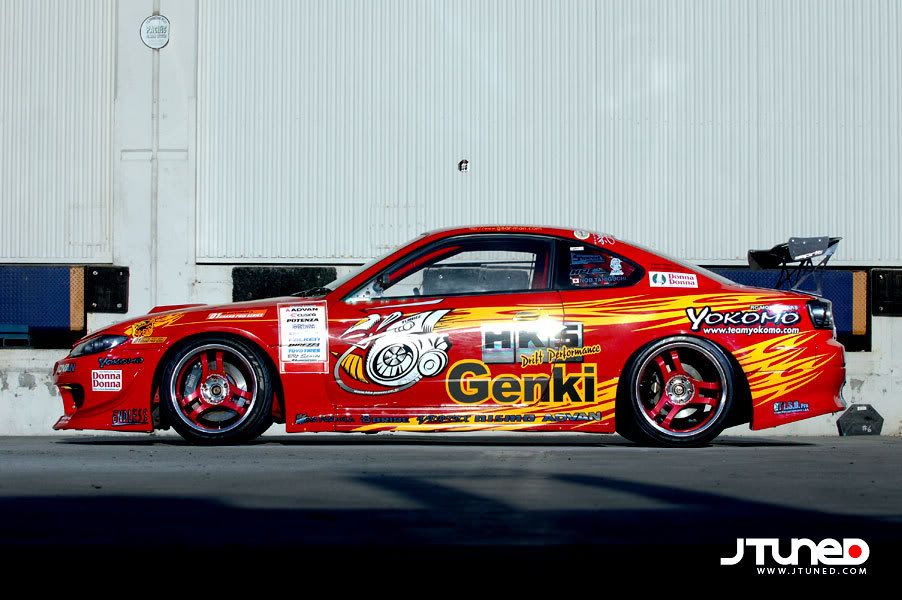

Lots of S15s in Japan use the Z32, R32, R33's 2 pot/300mm dia. disc. OEM rear brakes setup to match a aftermarket front caliper/disc setup.
The lightweight 1240kg S15 takes advantage of the heavier other Nissan siblings' rear brakes swap to improve braking power!
Even the HKS drift S15 uses this combination:

Personally I think all drift cars used this setup to benefit from the independant drum setup. Handbrake is more important to them than sheer braking power which aftermarket brakes dont offer. I'm sure if they want to run 6pot rears, they will. They just didn't want to.

Aftermarket brakes also utilise the identical rear drum setup!
Show me one S15 with 6pot rears setup? :rotfl: I'll belive you if I see one.
For a front weight bias car, the front brakes are always the main! For a rear engined and mid engined car then some uses same disc size and caliper/pad size. For FF car like the DC5 type R, only front brake calipers are brembo while the rears remain single floating calipers. Thats b/c of front weight bias more than a FR car! I'm sure a pro drift car like the HKS sponsored team have all the budget to get a pair of aftermarket rear calipers like some other teams do!
For a 1240kg car, the Z32 rear setup is more than adquate. Front to rear brake balance is very important. I say that because I had my front AP racing brakes installed 2 days before I had installed my rear Z32s....my ride braked real badly..the ABS would easily lock up due to the unbalanced tight front brakes!
