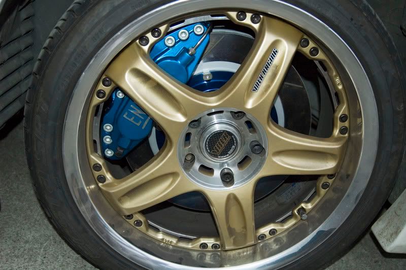

endless all the way :) I tried fitting mine yesterday....

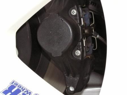

R32GTR/R33GTS callipers allow slightly bigger discs. I've got these and picked them up for around ?100 off GTROC.
On my 345s, they sit further out, but the Aston pads compensate for that.
So if i was to use say the R32GTR caliper, what size disc's do that take? 300 ish say, so i couldnt used the bracket i currently use? Also will they not suffer from the same sticking issues i had with mine?
They'll bolt straight onto your existing bracket. If you increase the disc size, you'll need to change the bracket regardless...

Projects and Endless are more for bling and u run into wheel fitment issues as well...but they do look hot..... I'd go Project between the two brands or even Brembo BBk,

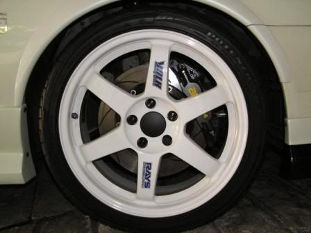

If you don't want to spend the $$ for the above set-ups copy Nicely's set-up best budget set-up IMO.
sillbeers15
Front: AP Racing 330mm disc + 4 pot
Rear: Z32 294mm disc + 2pot
