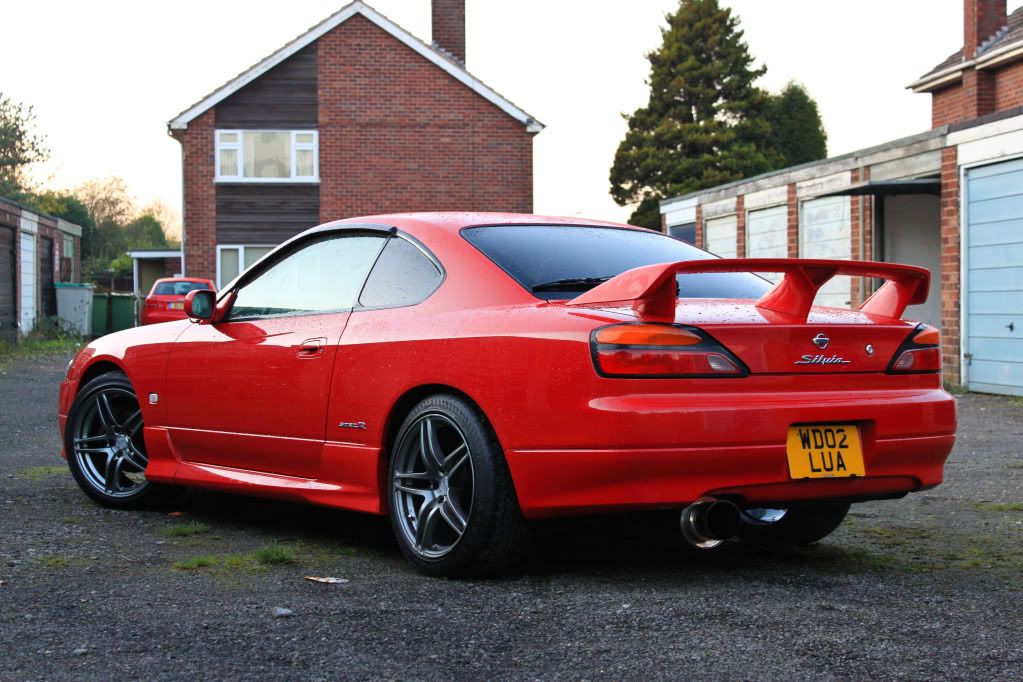

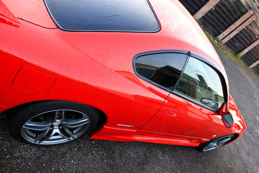

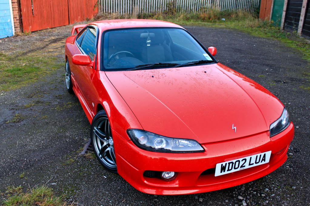

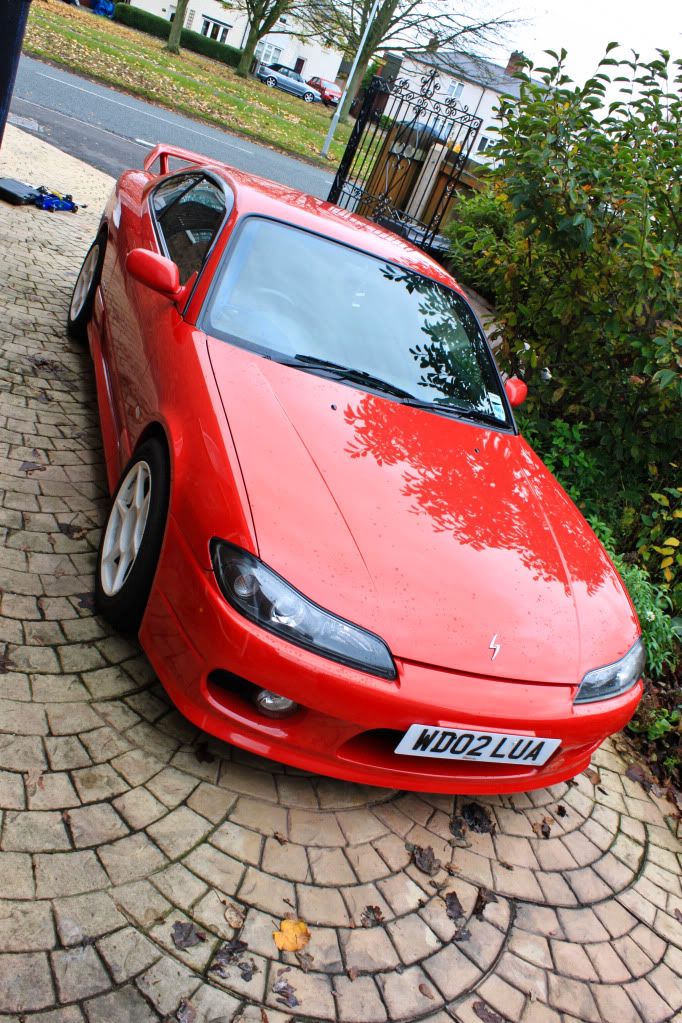

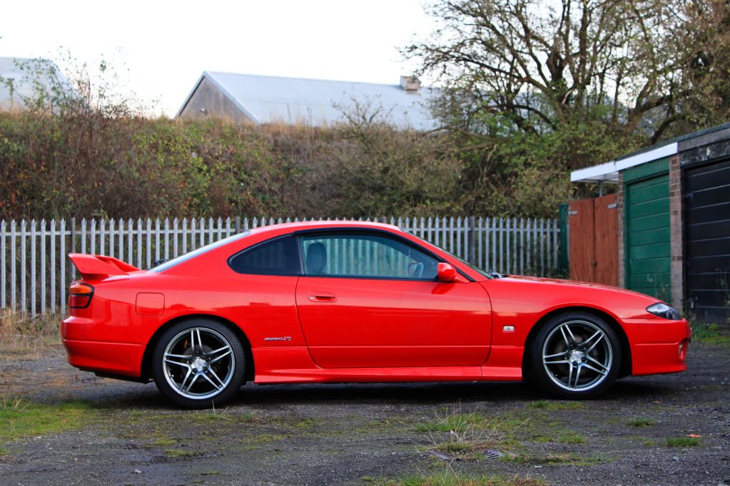

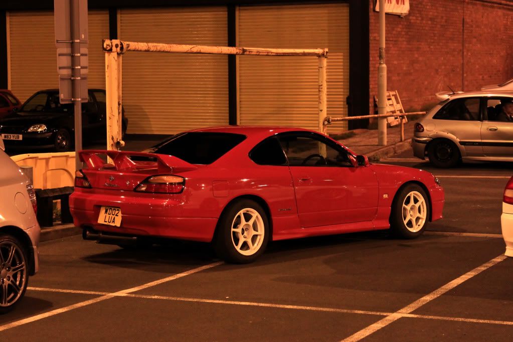

Few recent photos of the car -
I managed to re-fit the skirts after about a month or two on the road as I thought I was in need of new clips but turns out I had just enough to put them on. Also removed some gay horns that were in the front bumper not sure if you can see them in any previous piks but yeh anyway theyre gone!
Car is running fine still, nothings fallen off and I havent died, and im sure some people I know my mom included thought this was a slight possibility after what they saw me doing during the year :p
Car needs a service soon when I can afford it, needs the gearbox oil chaning for some thicker high quality stuff, needs new disks and pads and an oil and filter change, im hoping to do this during the winter.
Im still trying to save for new wheels atm, im hoping I can fetch mabi 200-300 for mine? But to do that I need spares to go on...
The car is also in need of a full detail and paint correction, if anyone feels like doing it give me a shout :D:thumbs:

Wow the car is looking sweet!!!
All the hard work paid off she looks lovely mate!
As for your paint, I have just started a course on restoring cars,paintwork bodywork etc if you haven't had it done in a month or so time I will be up for having a look at it mate
Looking good pal, nice to see it with wheels on for a change ;)

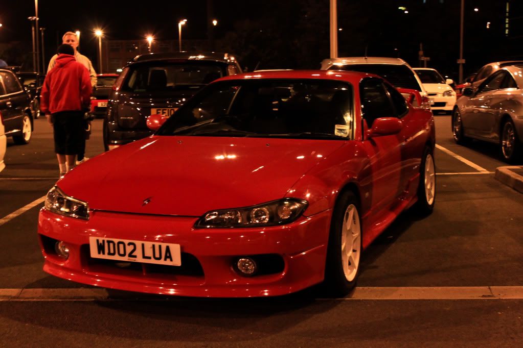

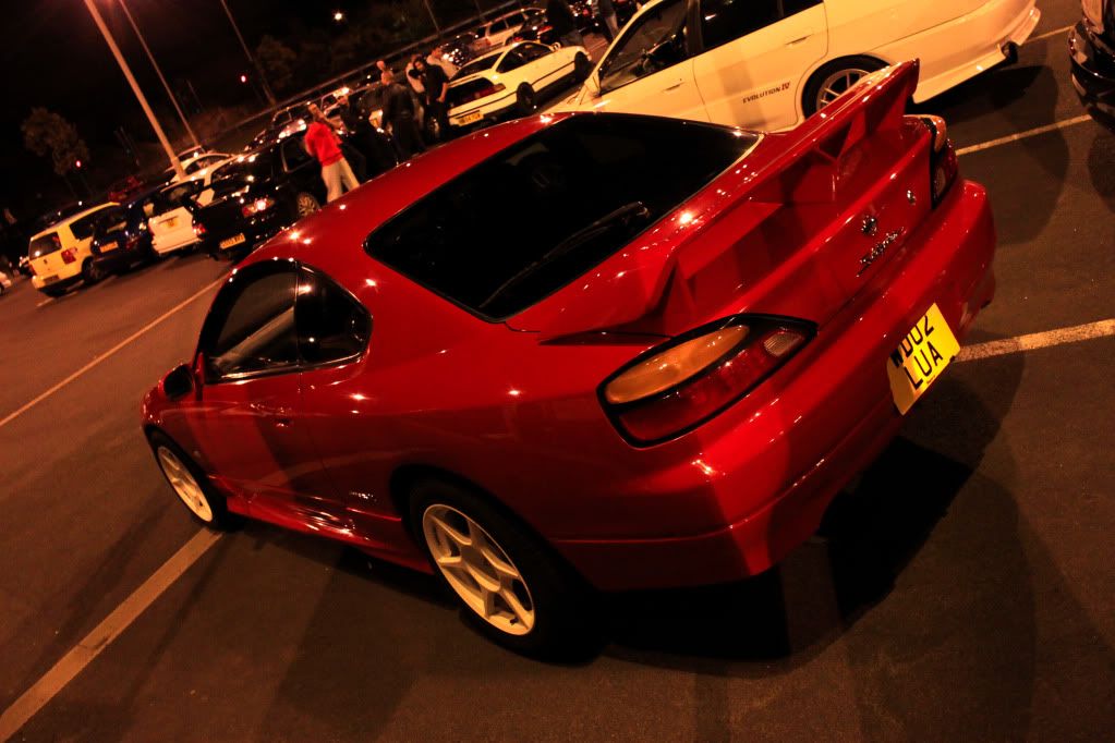

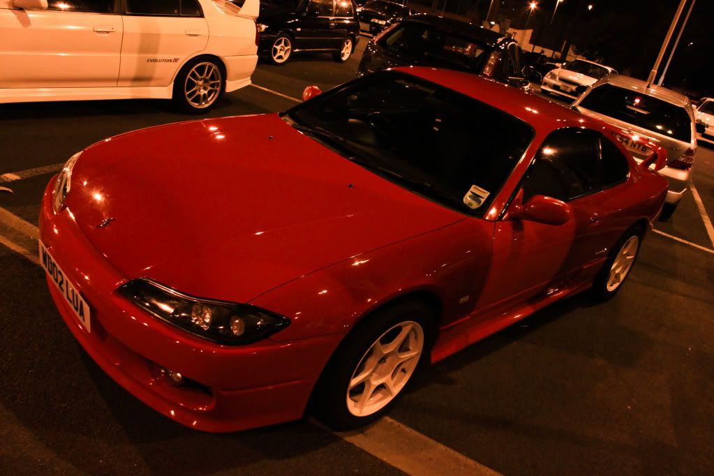

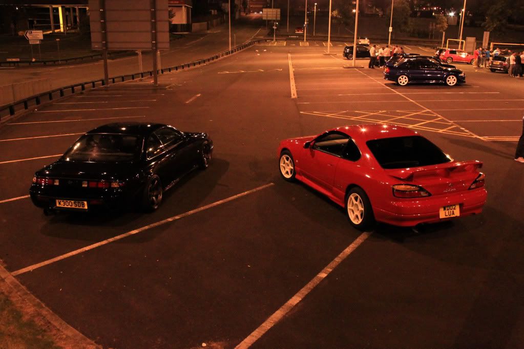

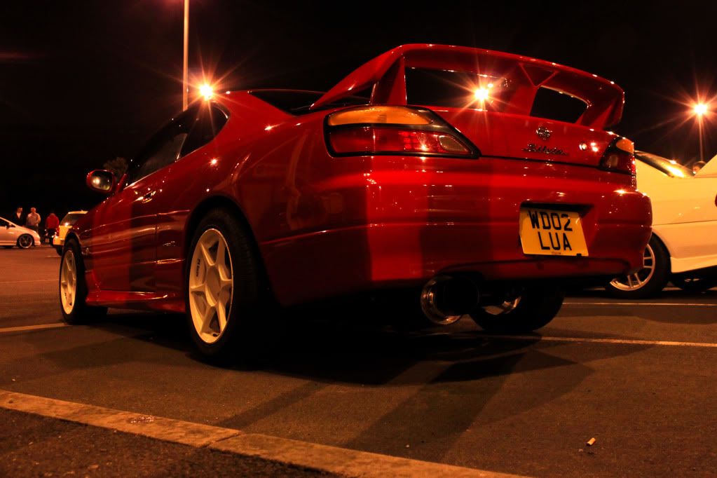

Did you take the pics at TOA meet last night? Looks good :)
Please get an import plate on the front! They look a million times better! ;)
1 May 2010
830
Wolverhampton
Yeh TOA, you should have come down with Jordan :nod:, I was saying we should have a Midlands meet soon as we could probably get 5-6 people? Mabi more if some want to travel, it’s just organising I suppose..
I would get a plate but I’ve got Lupix's old front splitter to go on after I’ve repaired it, then with that on I’ll get an import plate and mount it at the side I think if it looks decent? Should look good then once I get a front mount next year.

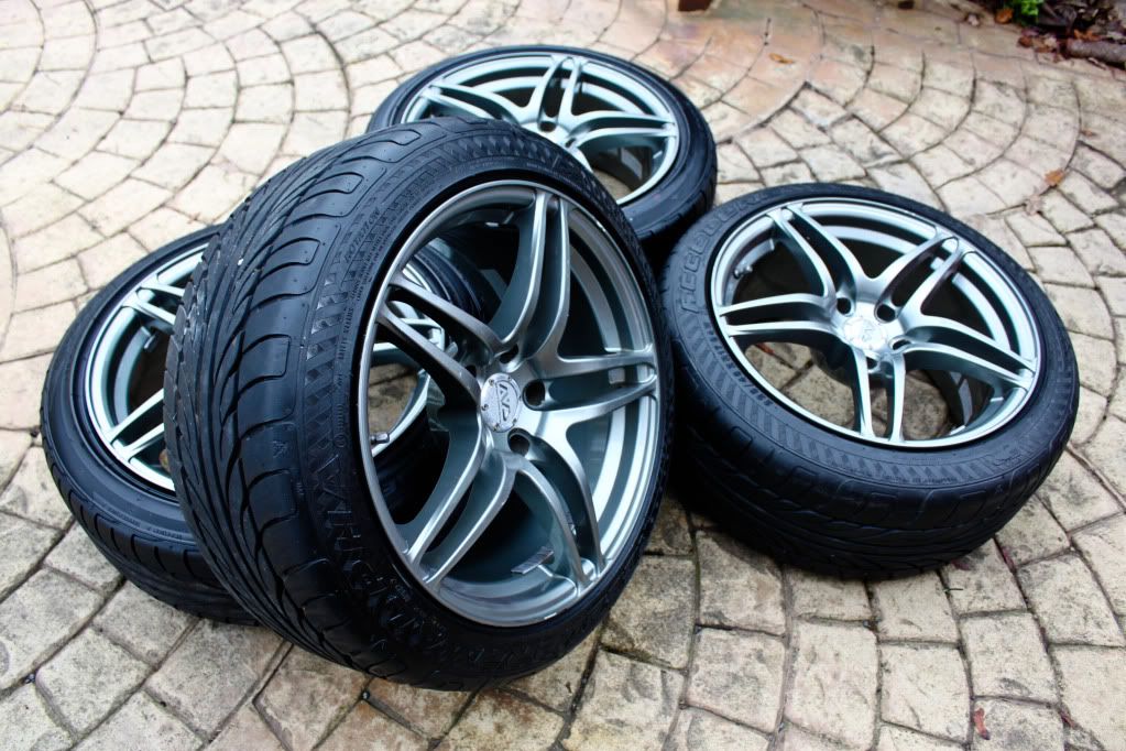

Advan AVS Model 5's 17x9 & 17x8

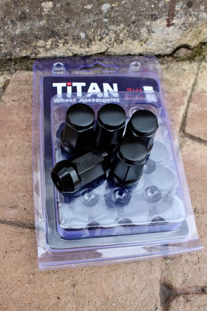

Thought it would be rude not to treat the car to some new wheel nuts as 1. they look better and 2. these are steel and shouldnt round like my crappy ally ones..

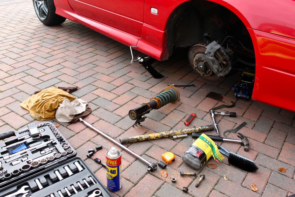

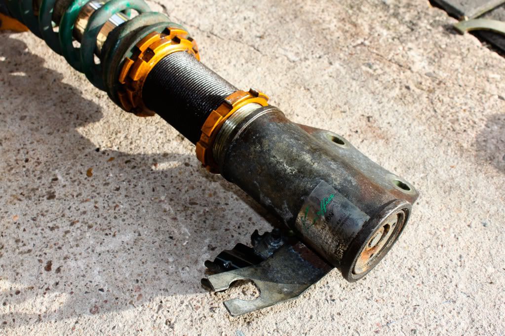

So with fitting the new wheels I thought the ride height needs to be looked at also, the fronts were a bit corroded and had to be taken off and persuaded with wd40 and a hammer on the mount. :D

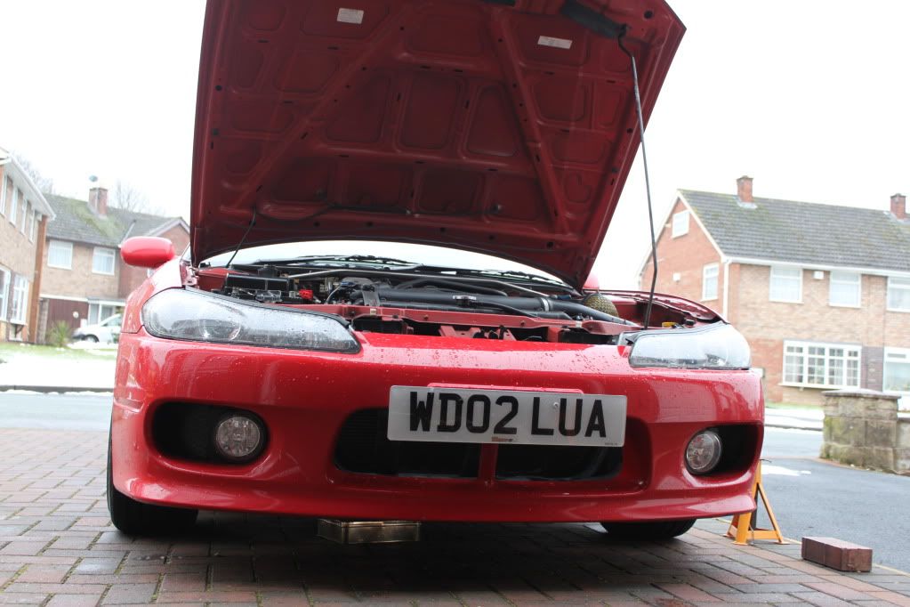

It took me about 3 hours maybe more to fully lower the car, it took so many attempts to get each side right and to the height I was happy with. In the end I think it went down about 30mm at the back and 15mm at the front, I still need it down more tbh but the centre box is quite low to the ground so will need to be removed before I can lower it more.
Anyway some photos -

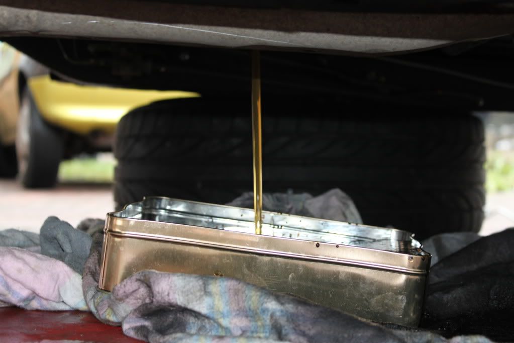

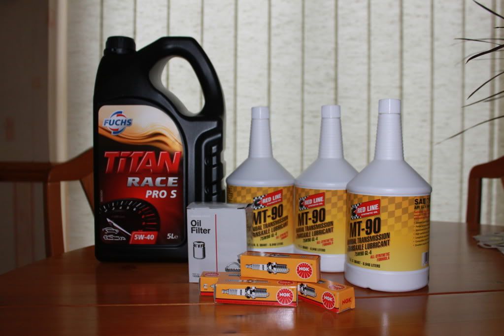

Gave it a long overdue service the other day...
Silkolene Pro S
Redline MT90
NGK 6's coppers

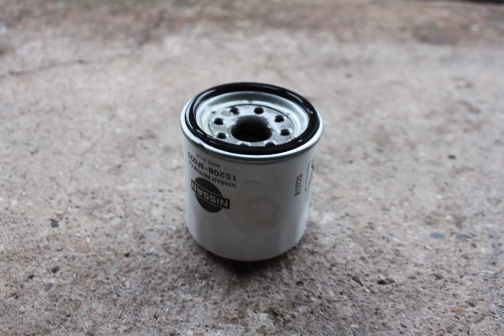

New Nissan oil filter

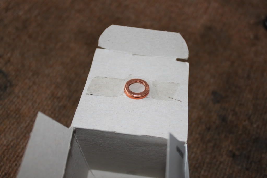

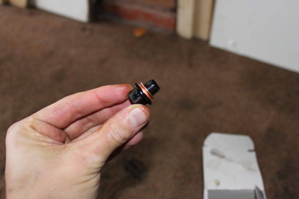

New sump plug

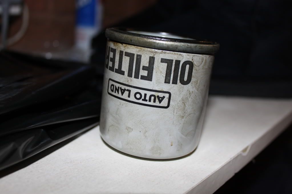

Took the old cheepo japanese filter off -

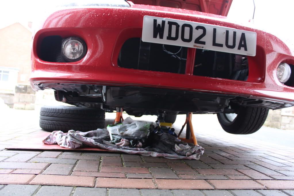

Drained the oil -
New sump plug -

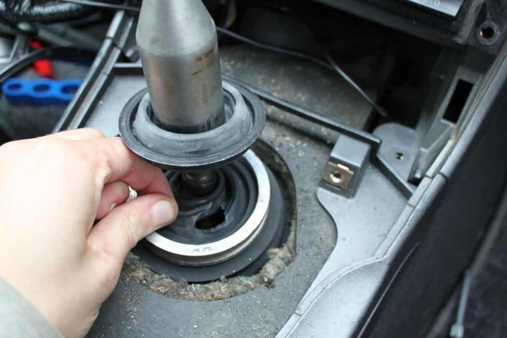

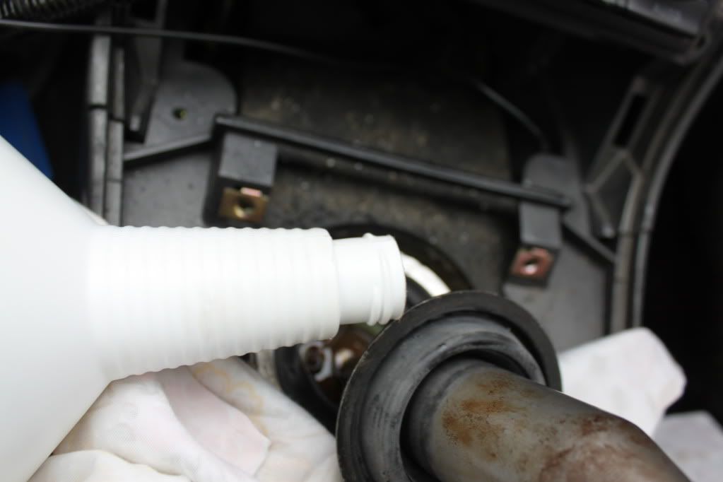

Then did the gearbox -

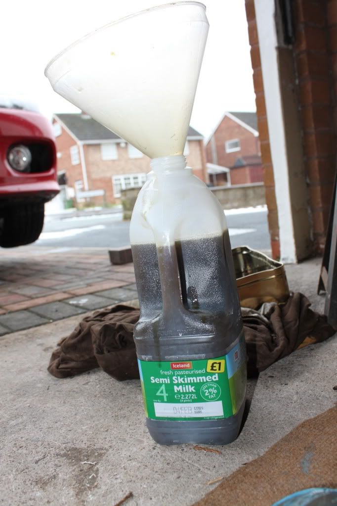

Thought id fill a milk bottle up so I could see how much oil was in there as I did loose a bit when i refurbed back end before..
Looks about 2ltrs..

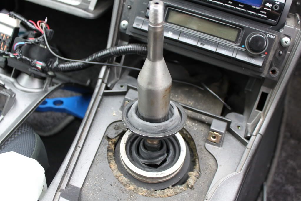

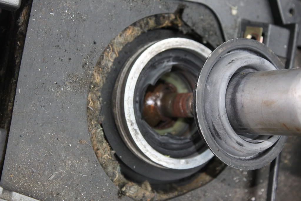

Filled box through shifter -
Got through almost all 3 of my MT90 bottles so thats about 2.6ish ltrs..some people say its bad some people say its good so i think ill leave it for now as it has improved the shift feel :nod:

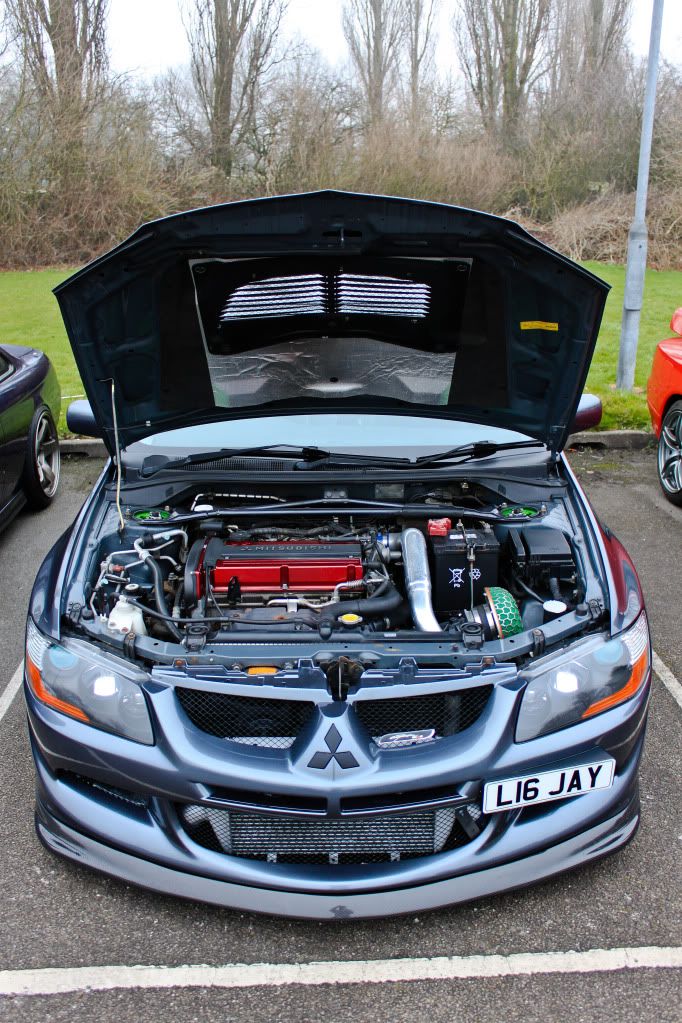

Loving the evo, used to have a mr-fq340 miss it sometimes.... Flashback to 6 monthly services, 7mpg and 1100 quid clutch change, hmmm yeah I take that back! :rotfl:
