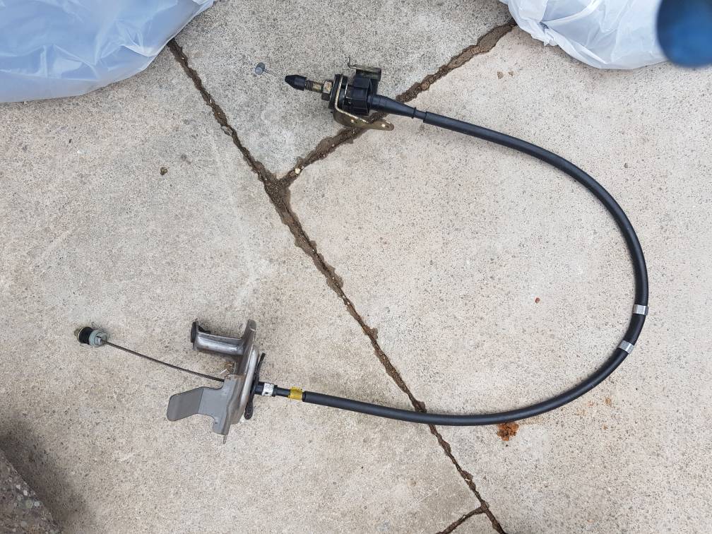

Has all the mounting hardware

Hmmmmmm, I see, mine is missing the black rubber dumper thing on the pedal side, that could be the culprit.
