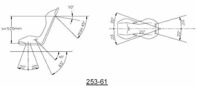

From what I've read so far the angle for the back straps is the main issue as not to compress in the event of impact, the same reason not to fit harnesses on reclining seats incase of failure of the seat itself. Also harness bars unless they are welded cages are to be avoided?
I found a picture of the MSA angles from another forum I'll post below but really I'm just fishing for info and opinions. :)

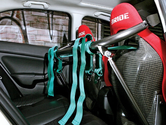

You can get harness bars that go behind the seats
Like so... Or if you want just use the rear seatbelt points and use eye bolts

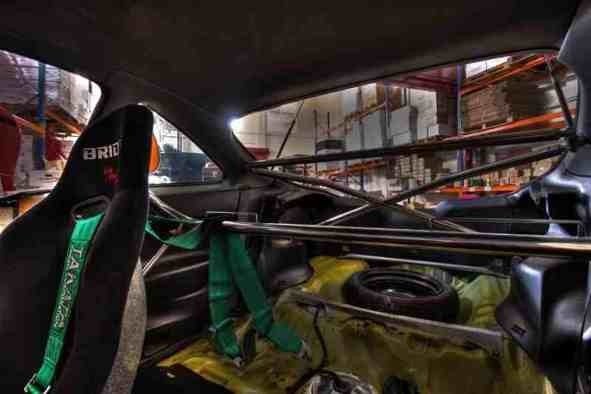

Are harness bars like that strong enough to attach the straps to? I thought they were to guide them to the correct angle before fixing to the rear belt fixing points? Like this.

The one I posted if you look has extra support from a bottom mount point so id imagine that it's fine,

The other was has to the bottom point to doesn't it? :S
