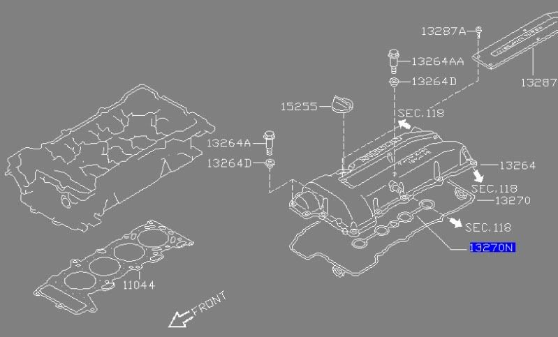

Looks like i'm going to have to change my head gasket. Has anyone done this before? Looks a big job..
Head gasket is the gasket on the left of this picture (11044):
Have had a look on the service manual, but cant find any details. Only details on complete removal of every part. Is this required?
