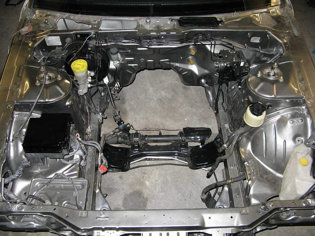

I've been able to get some more work done. Coated the bottom of the car to prevent rust from forming. Something that easily happend with the dutch rainy weather.
As well as putting back the R33 GTST subframe and rest of the front suspension.
After which I cleaned some more parts such as the ABS unit and some brake lines.

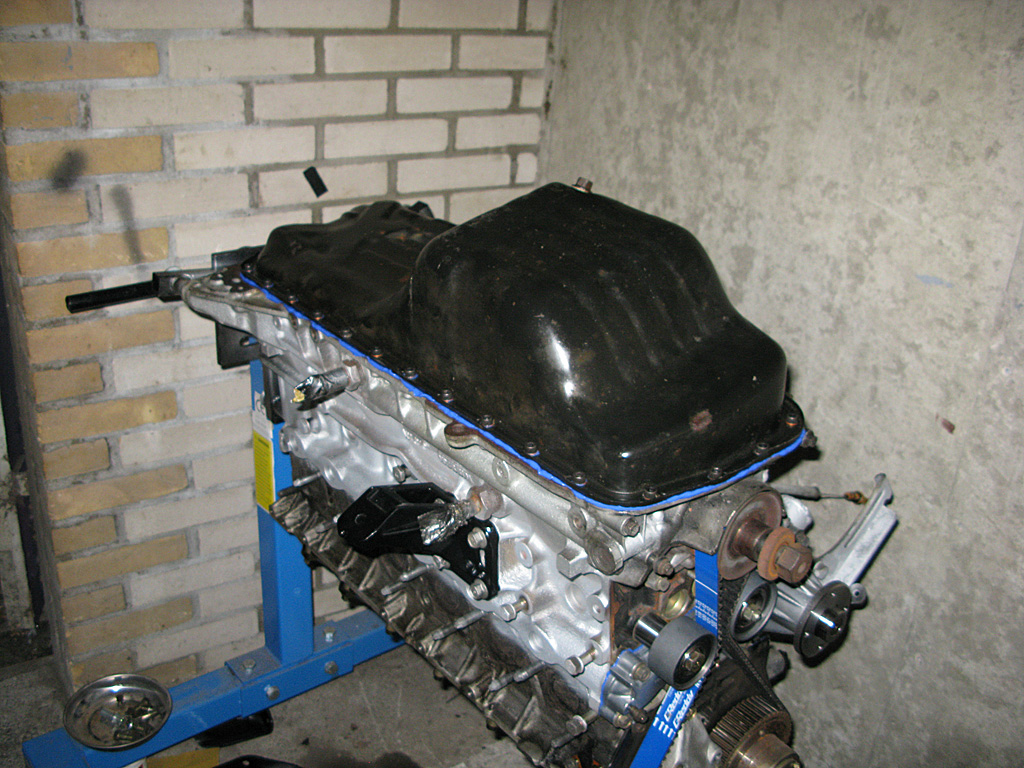

Applying seal to te waterpump
Timing belt fitted:
Oilpan removed:

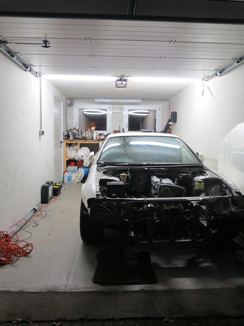

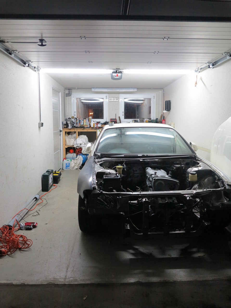

Engine bay ready for the engine to be dropped in:

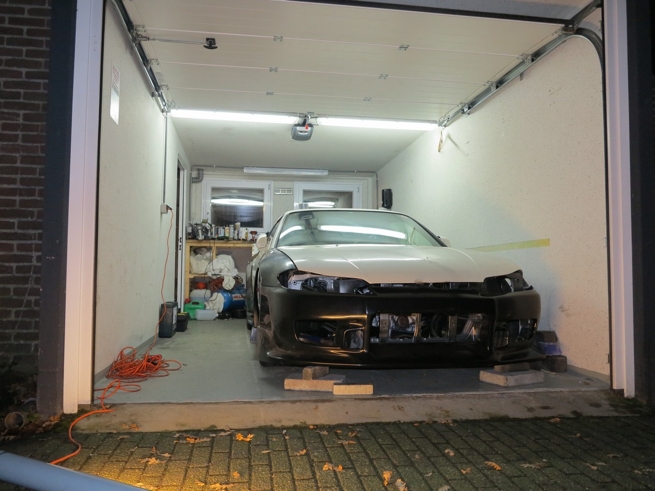

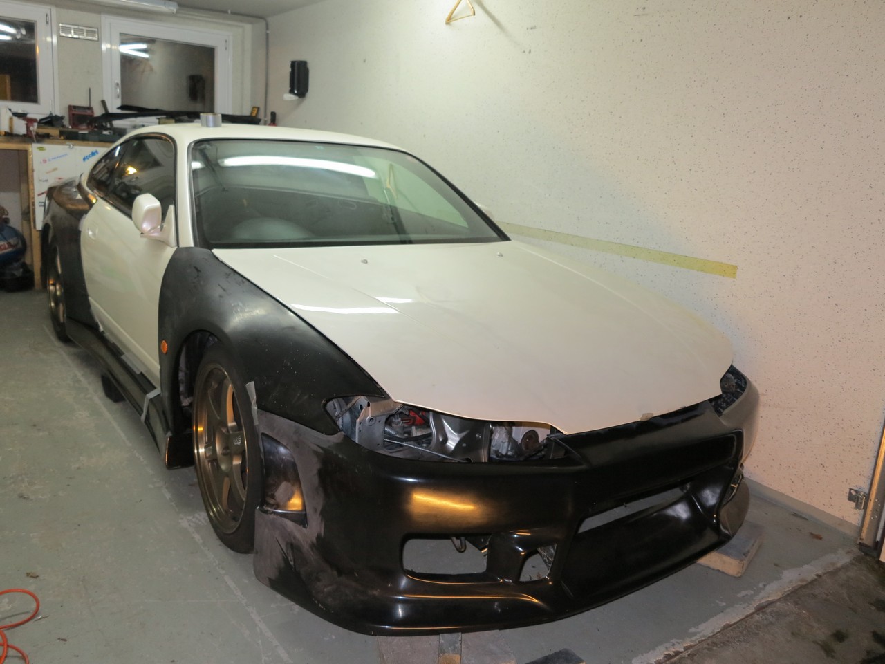

Valances test fitted:

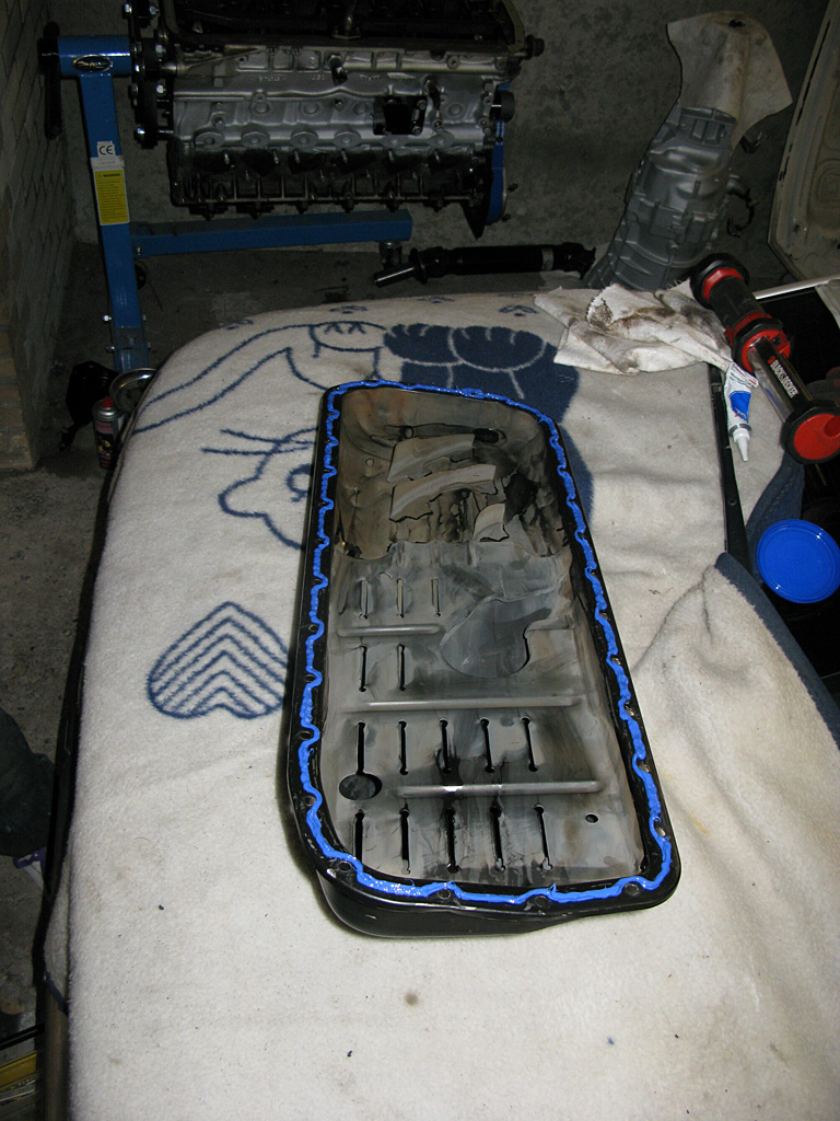

Remounting the oilpan

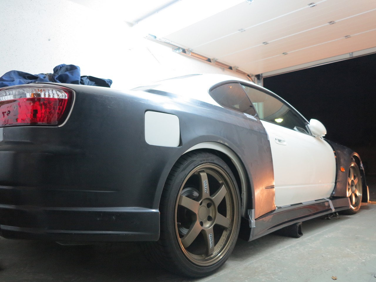

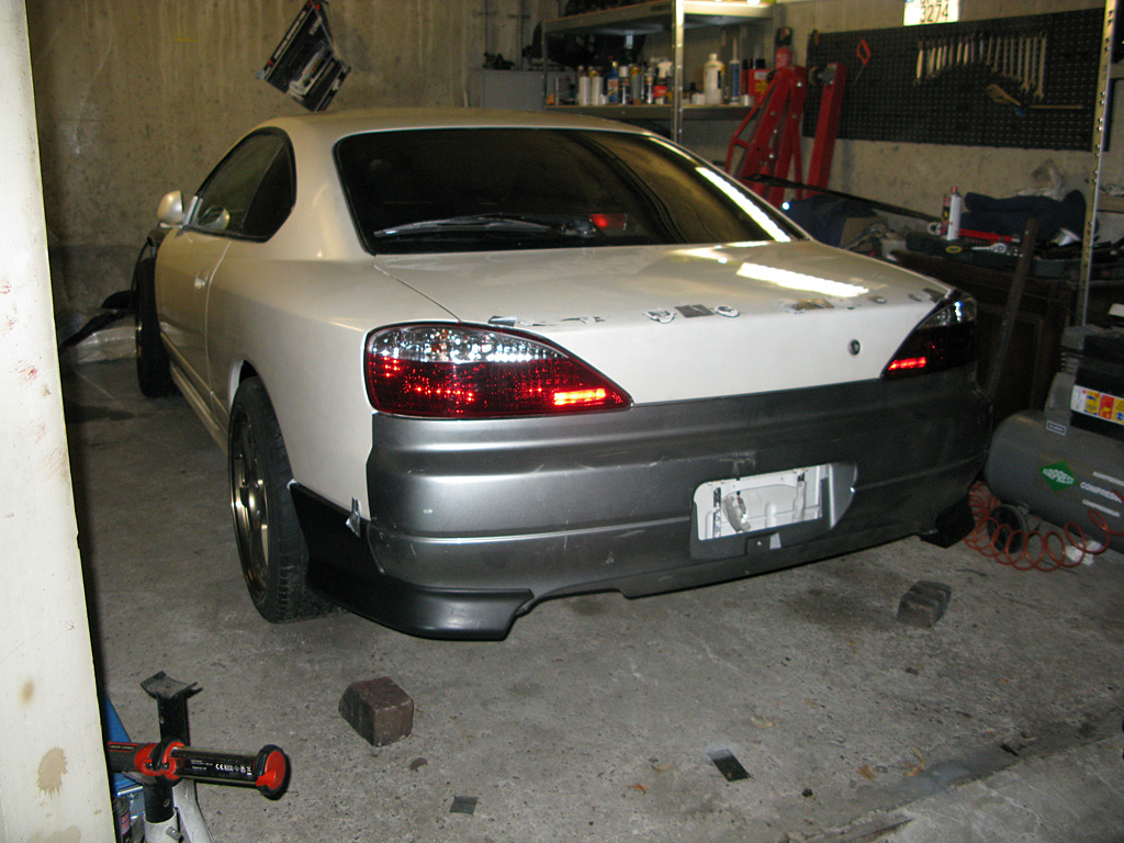

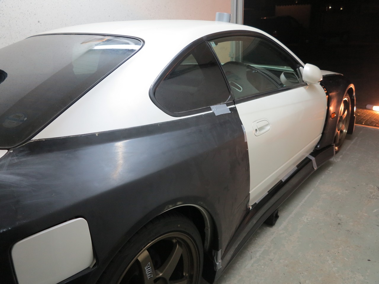

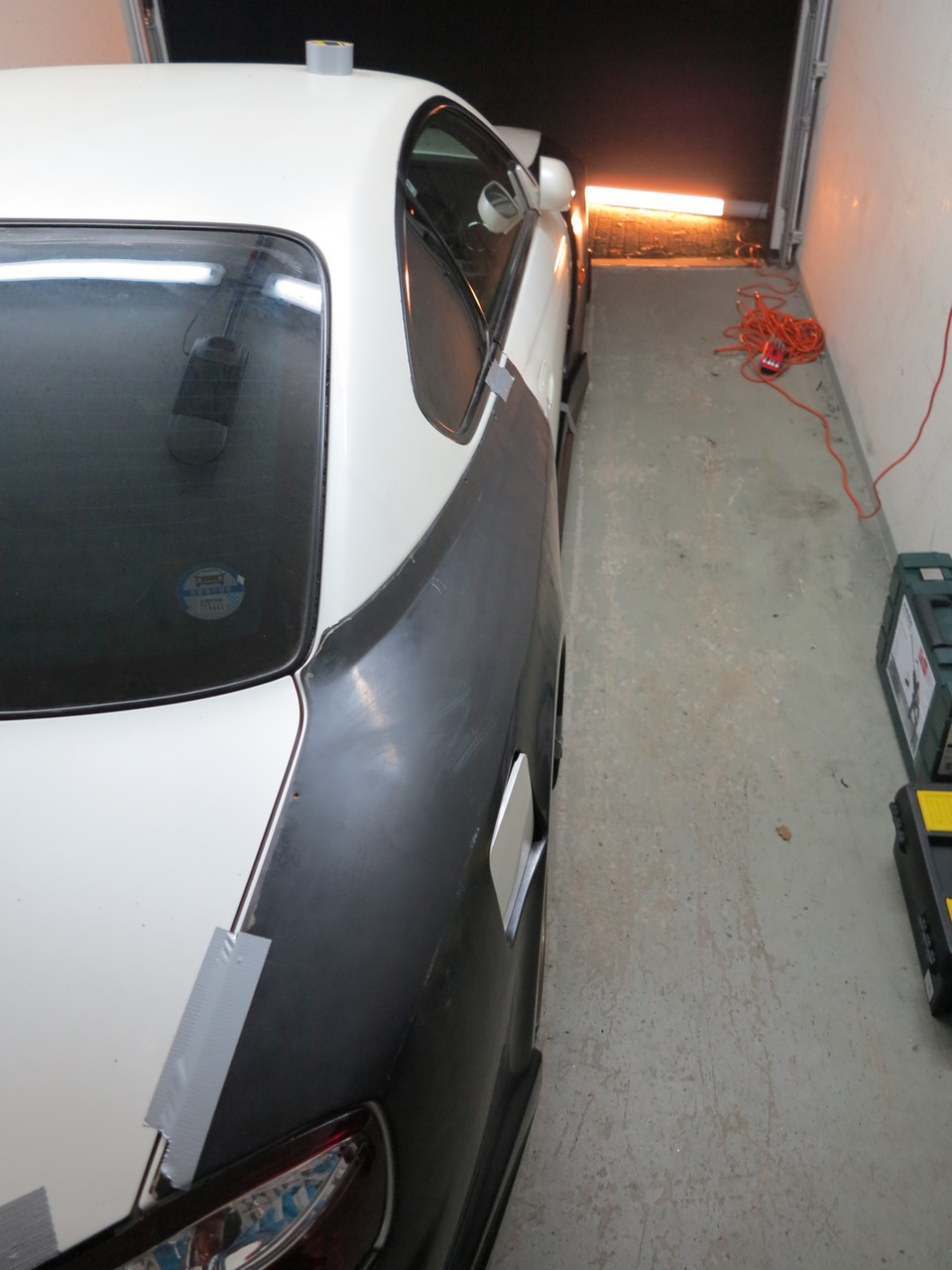

Anyways, my latest update is quite the big one. Took 9 month to arrive but the C-West GT kit finally arrived:

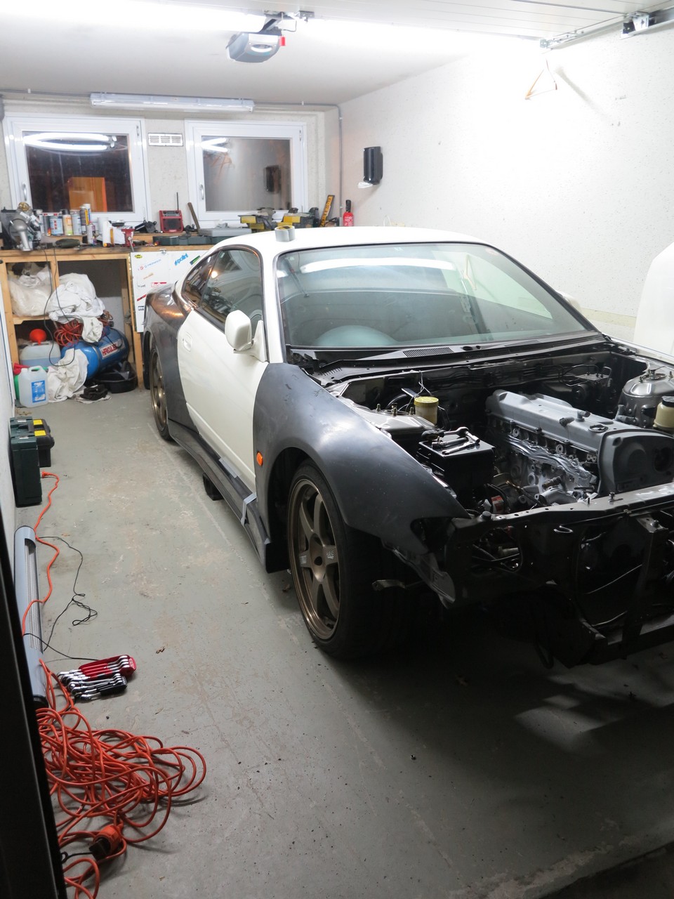

just posted my last photos in the photo thread.
Currently busy installing all parts which I gathered over the last time.
Intake plenum, injectors, oilcooler, intercooler, fuel pressure regulator etc are all installed now.
Need to work on some custom brackets for the radiator and oilcooler core to mount them.
And I am currently also making my own fuel lines with parts from EARLS Performance.
Still waiting for my 6Boost manifold which apparently has just cleard customs after being kept in wait 2 months.
