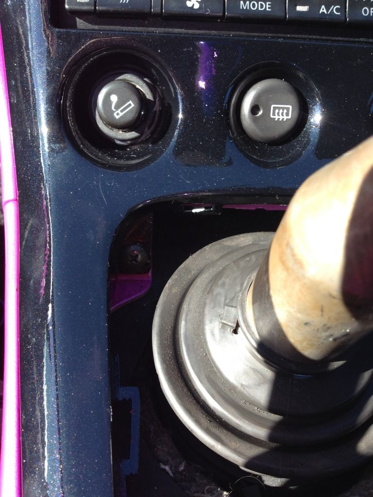

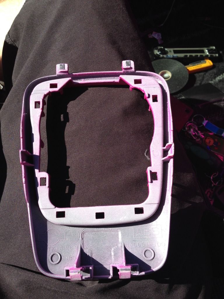

First remove the gaitor,this just pulls off

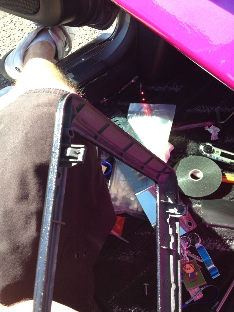

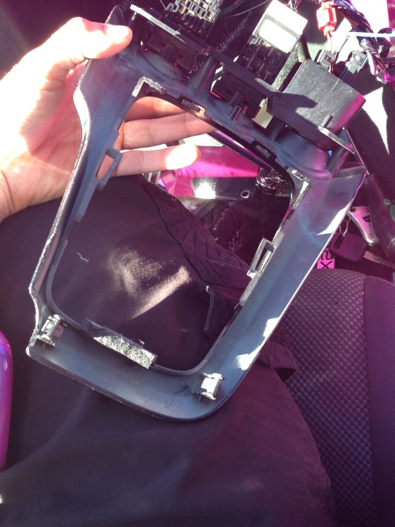

Then the gaitor surround next which you pull up from the back then slide the front out as you can see there is 2 clips at the rear and 2 slide tabs at the front
Then there are 2 screws on the stereo surround in front of the gear stick ,and 4 clips on the frame itself 2 up by the air vents and 2 at the rear near the ash tray

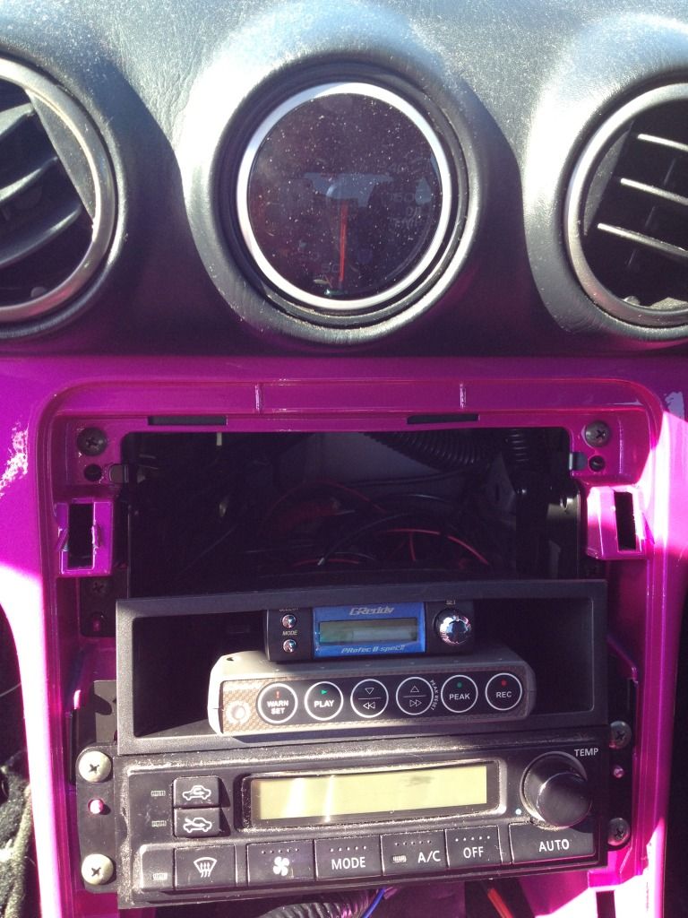

Then there are 2 screws by the air vents you have to undo

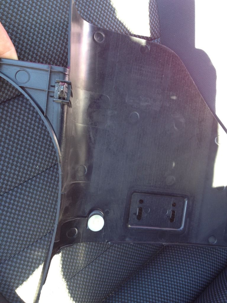

by the passenger door remove the plastic kick plate it has 2 clips on the rear and is position in the foot well on a screw(may be bolted in mine isn't) behind there is a screw

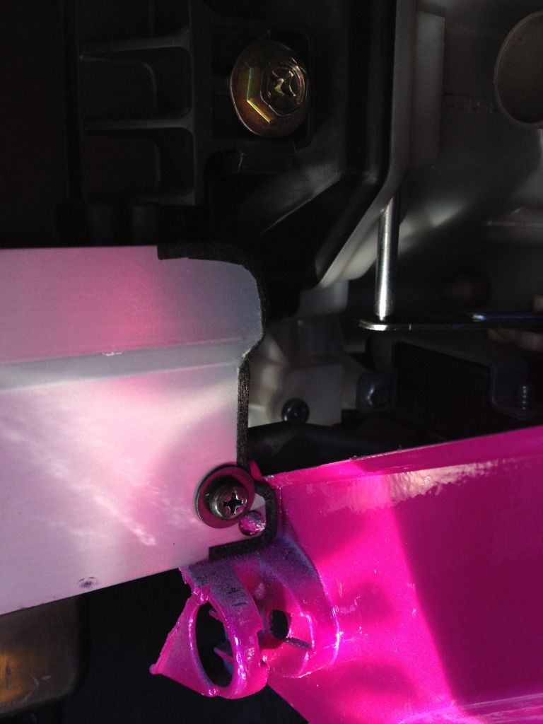

then on the rear corners of the glovebox are these little plugs that just pull out,may have to twist them first
http://i1134.photobucket.com/albums/m609/peglio/IMG_3366.jpg
http://i1134.photobucket.com/albums/m609/peglio/IMG_3367.jpg
The glovebox just slides up and comes out and there are more screws behind there
