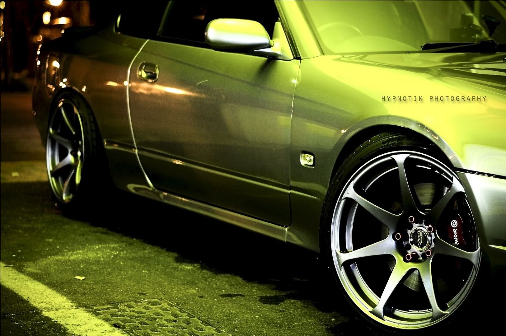

Sweet brakes look mint, I am waiting on my rear R34 brembos to install, I am currently running crossdrilled R33 units, no doubt stopping will not be a problem either.
I have R33 brakes now and they just don't seem up to the task of track use. After more than a couple hard stops they are overheating. I'm trying to get my car ready to go to Mugello Circuit this summer. Brakes was one of the issues I thought needed addressed.

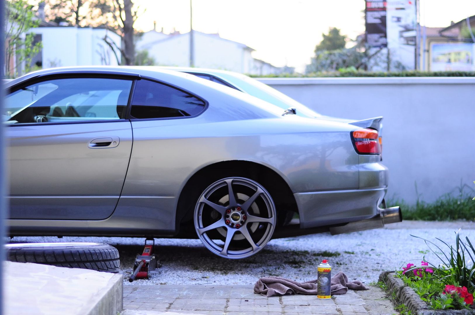

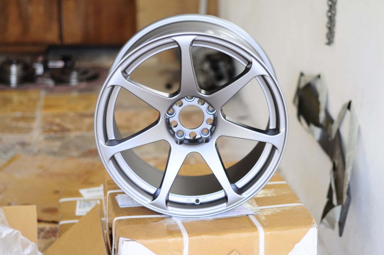

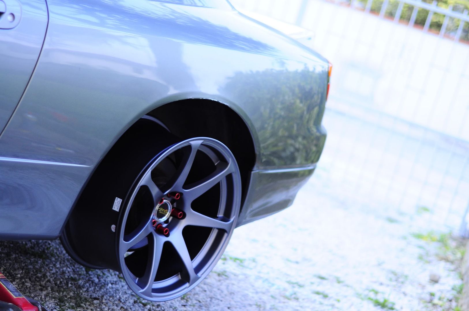

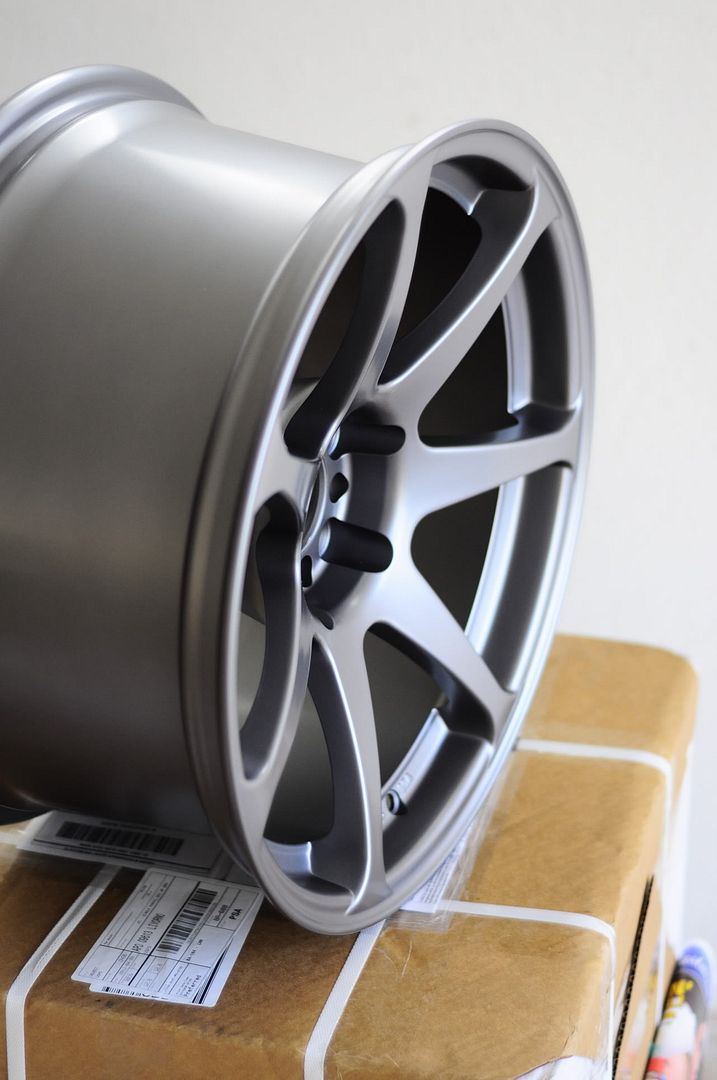

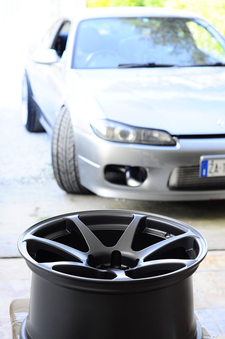

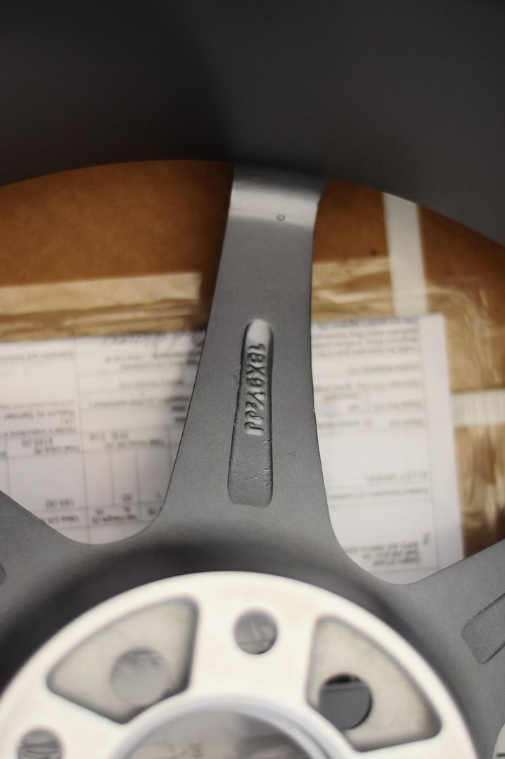

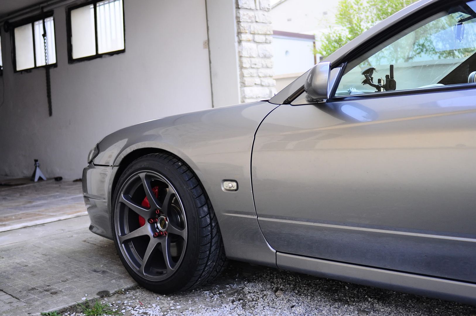

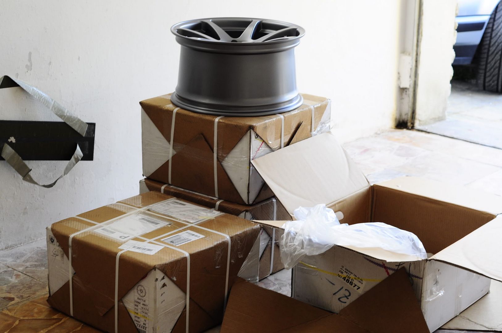

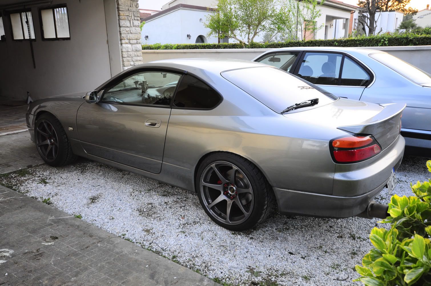

I got my Brembo's and my wheels put on. I also rebuilt the rear R33 calipers and painted them to match the Brembo's. After I put the wheels on I lowered it and redid my alignment. The picks are before I lowered it, it's too dark now.
The alignment;
Front
-Toe, -1mm per side
-Camber, -3*
-Caster, +6.2
Rear
-Toe, -3mm per side
-Camber, -1.75

Wow very nice wheels!
Its crazy how crap the S15 arches are compared to the S14...they seem to be able to run 18x9.5j's with no problems or the need of wider fenders!

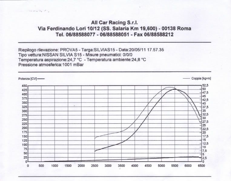

Do you have alot of tyre stretch on your wheels, coupled with the rear alignments. That power on that turbo is, well, physically impossible, especially at that rpm. Wheel spin from narrow tyres can cause false readings. I don't mean to sound rude, but it's true.
13 June 2010
240
Pisa, Italy
www.flickr.com
It wasn't spinning. I have one of the dyno sheets where it was spinning and it's obvious, the line is very erratic. I'm running methanol also.

That's 50bhp atw more than what I get with a top mount TD06 with ext wastegate etc. If that's because of the meth injection I want it :D
To be fair Ken on the SXOC got 480bhp on SCA rollers, same spec was 430bhp on APT's Dyno Dynamics rollers so they can be wrong :)

20g or 25g? What cams do you have? The methanol makes a big difference, at least 10%.
