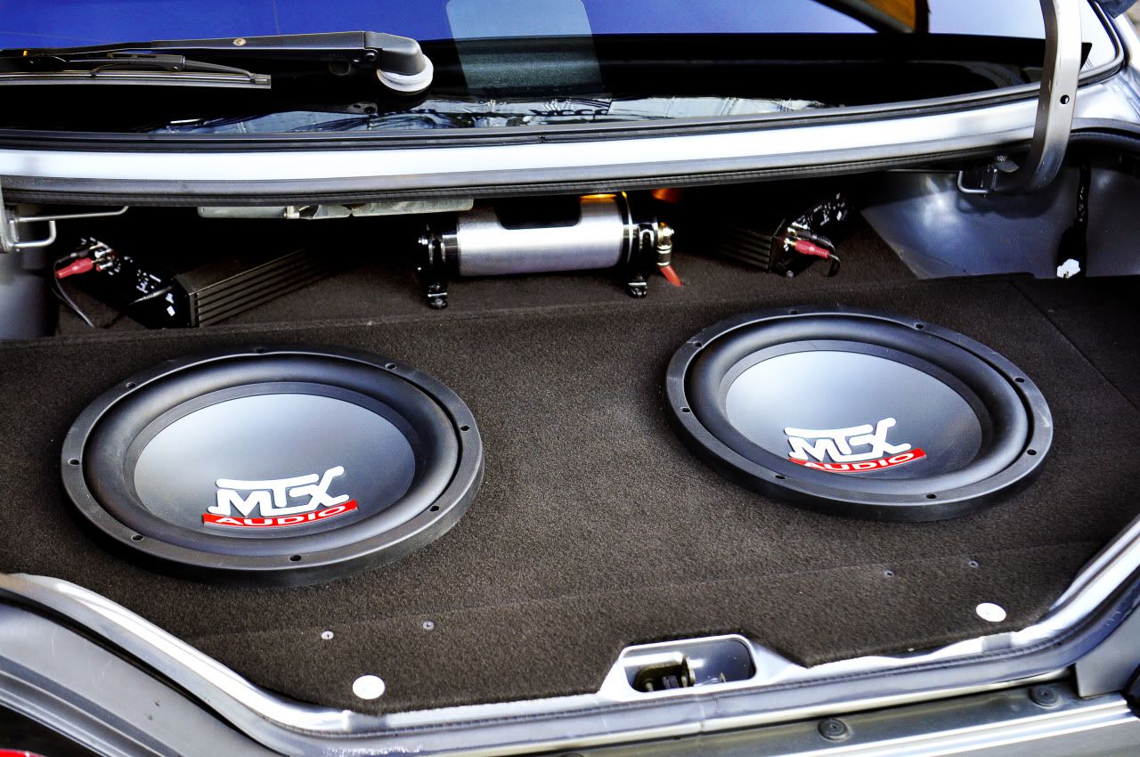

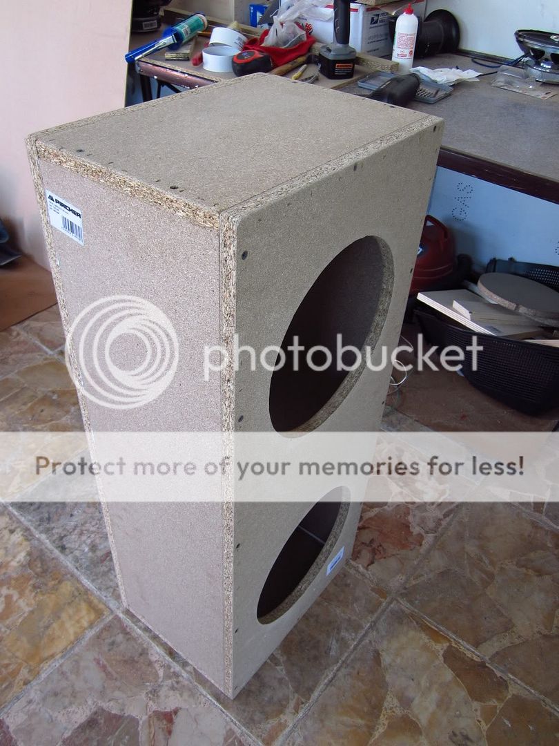

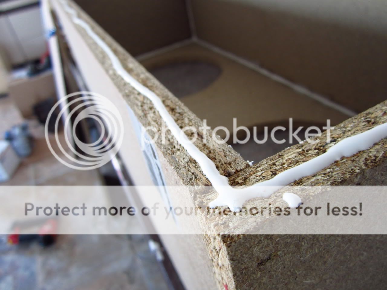

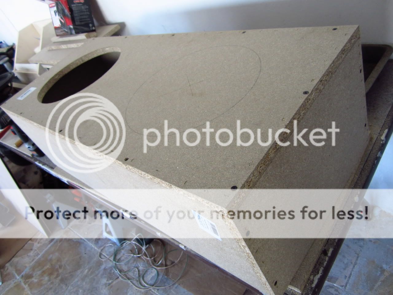

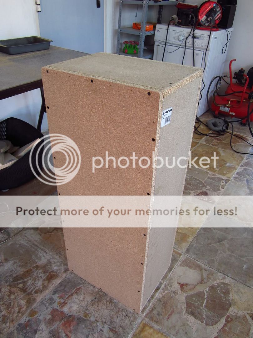

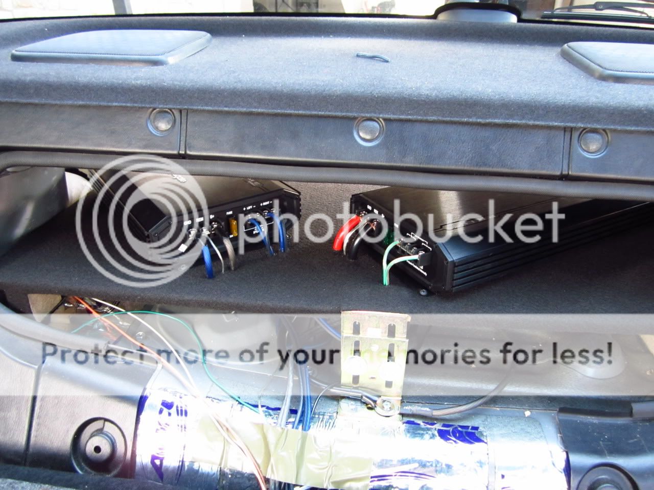

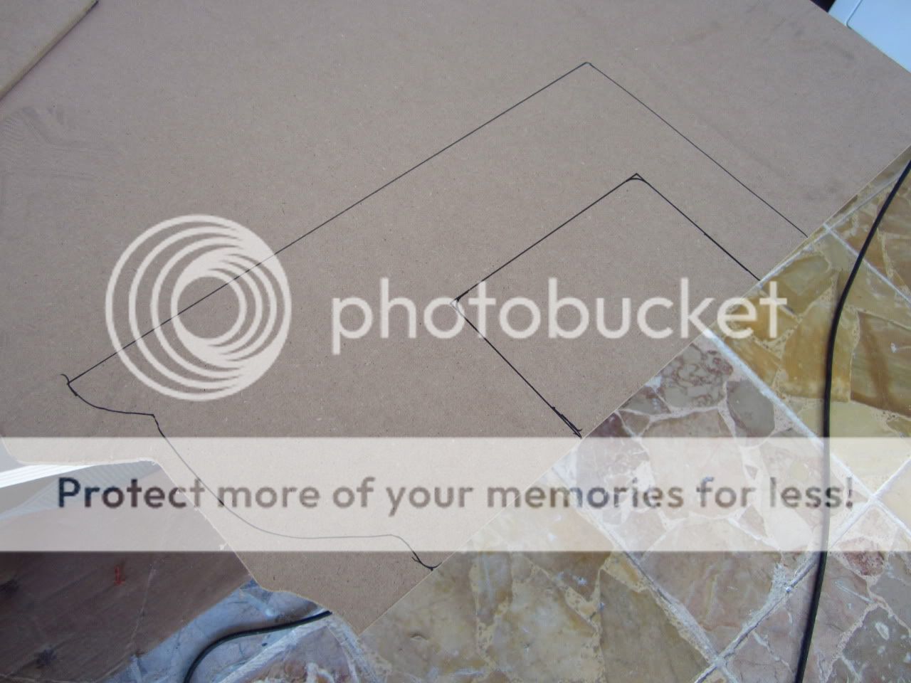

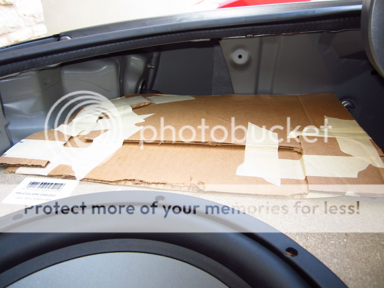

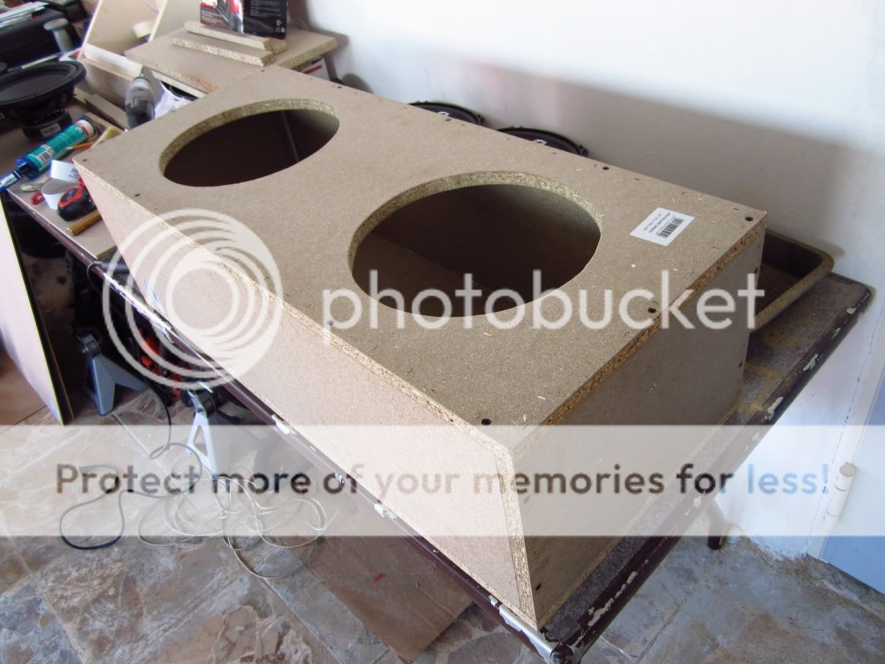

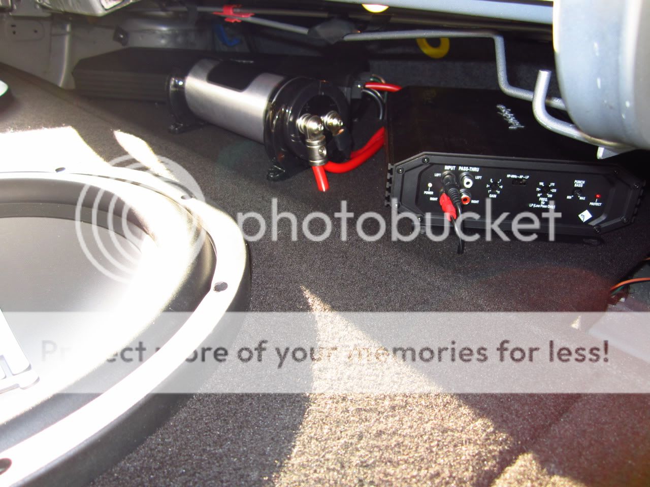

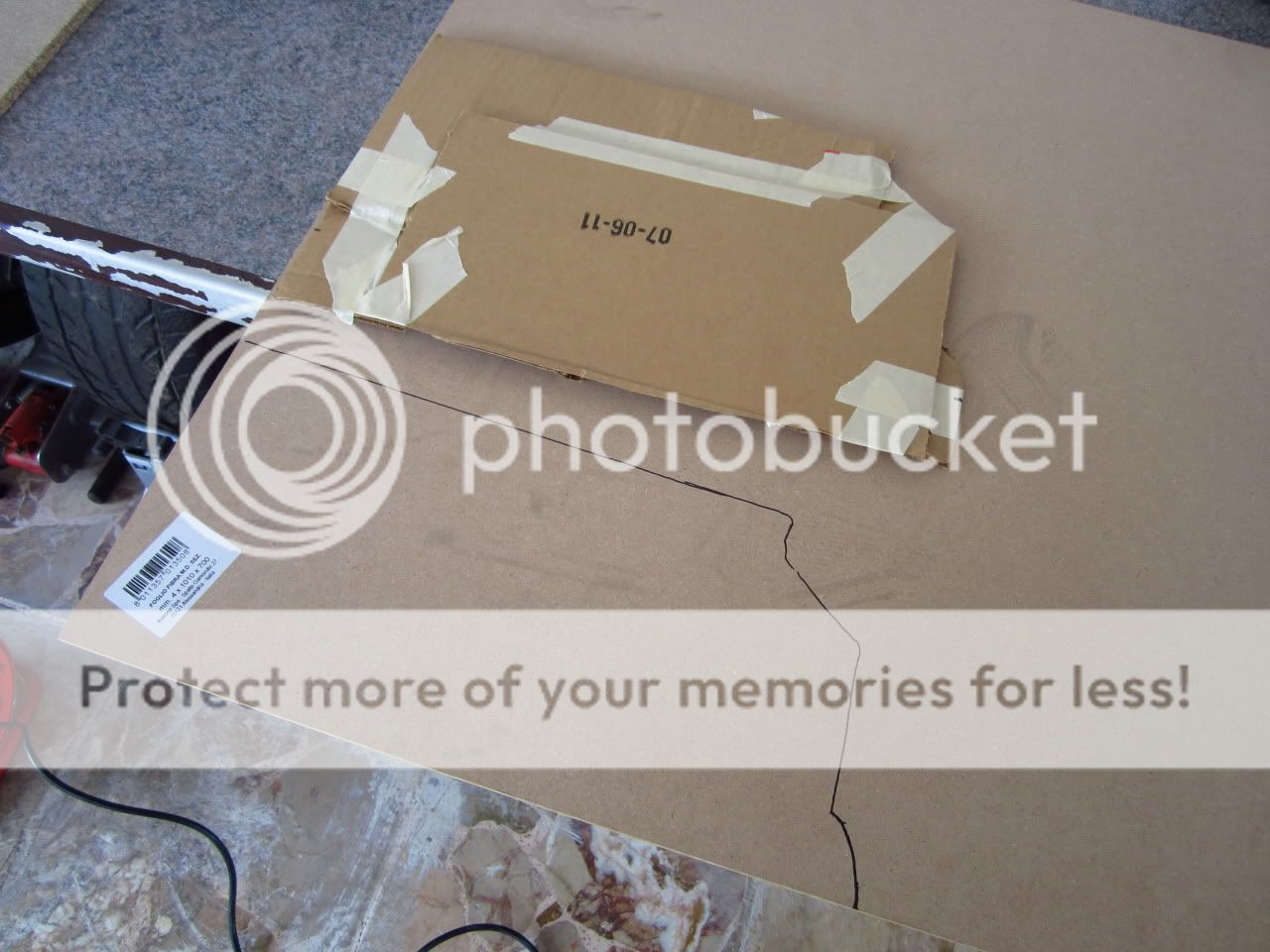

This is what I've been working on for the past couple days. Not done yet. I need to figure out where to mount the amps and capacitor then wrap everything in carpet.
The pictures are pretty self explanatory.

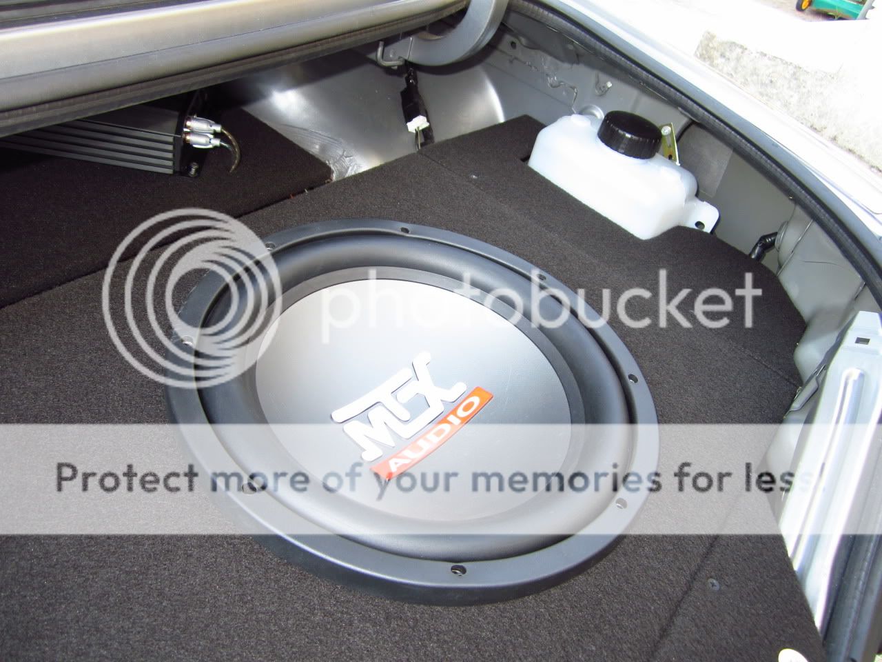

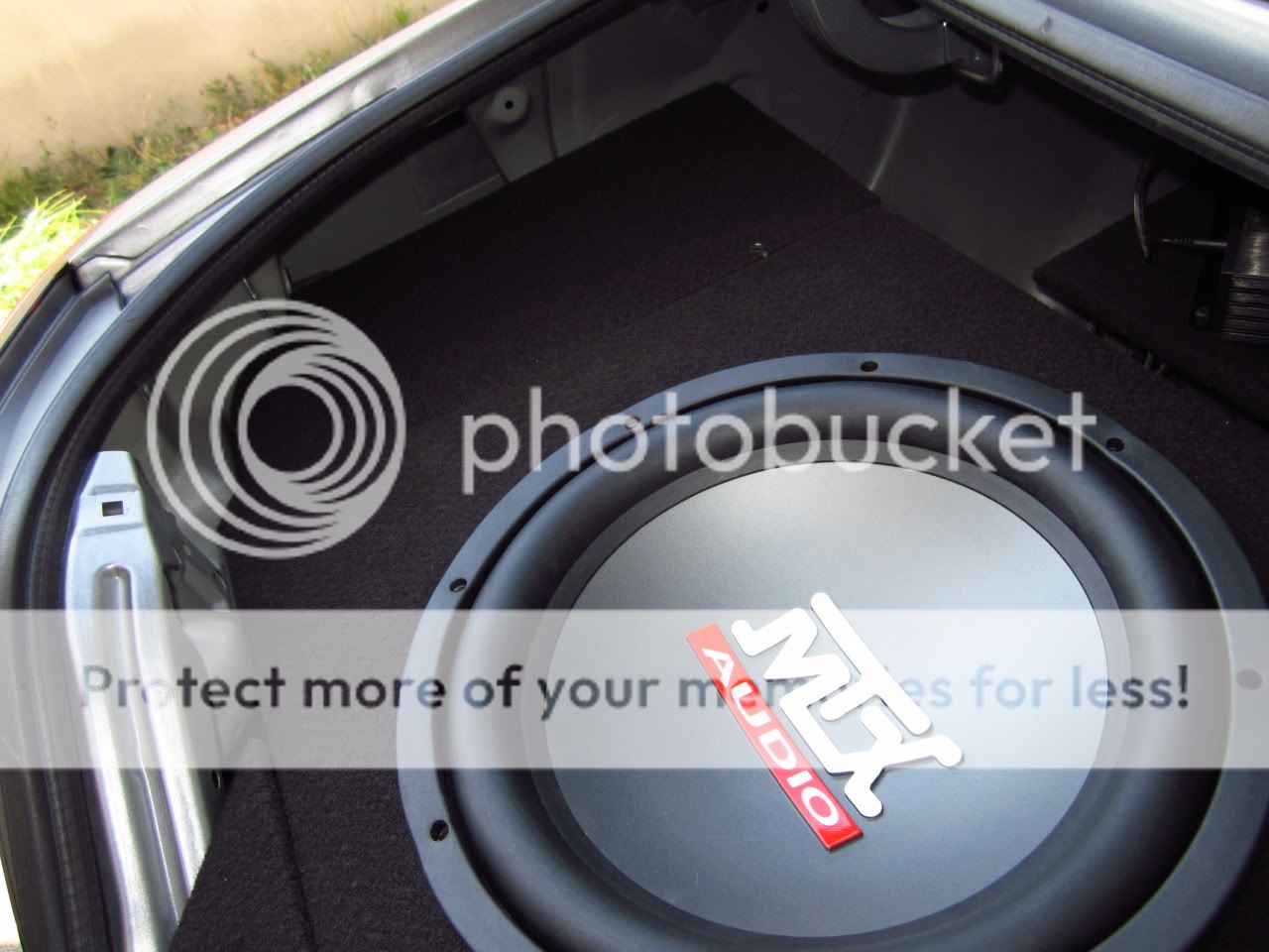

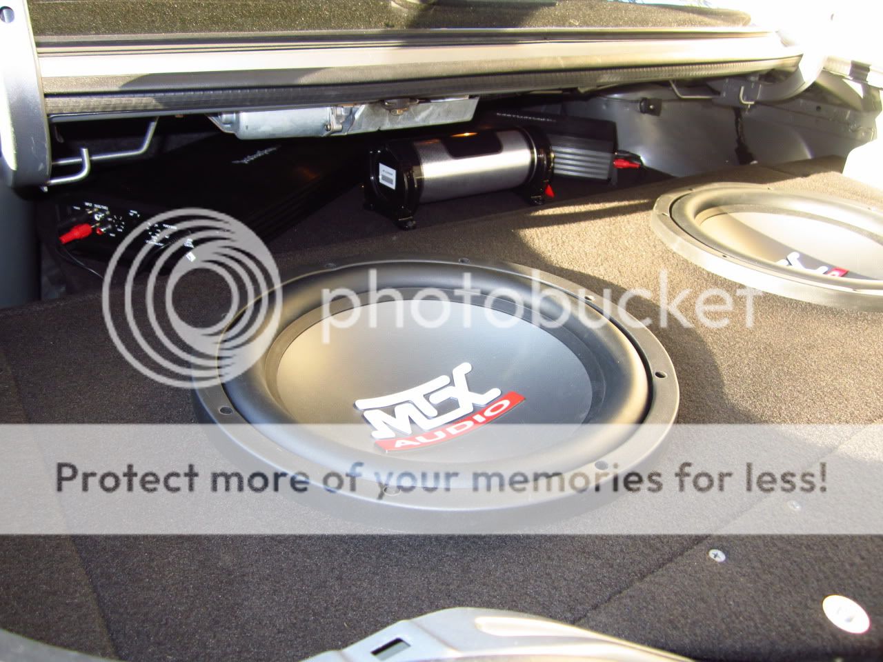

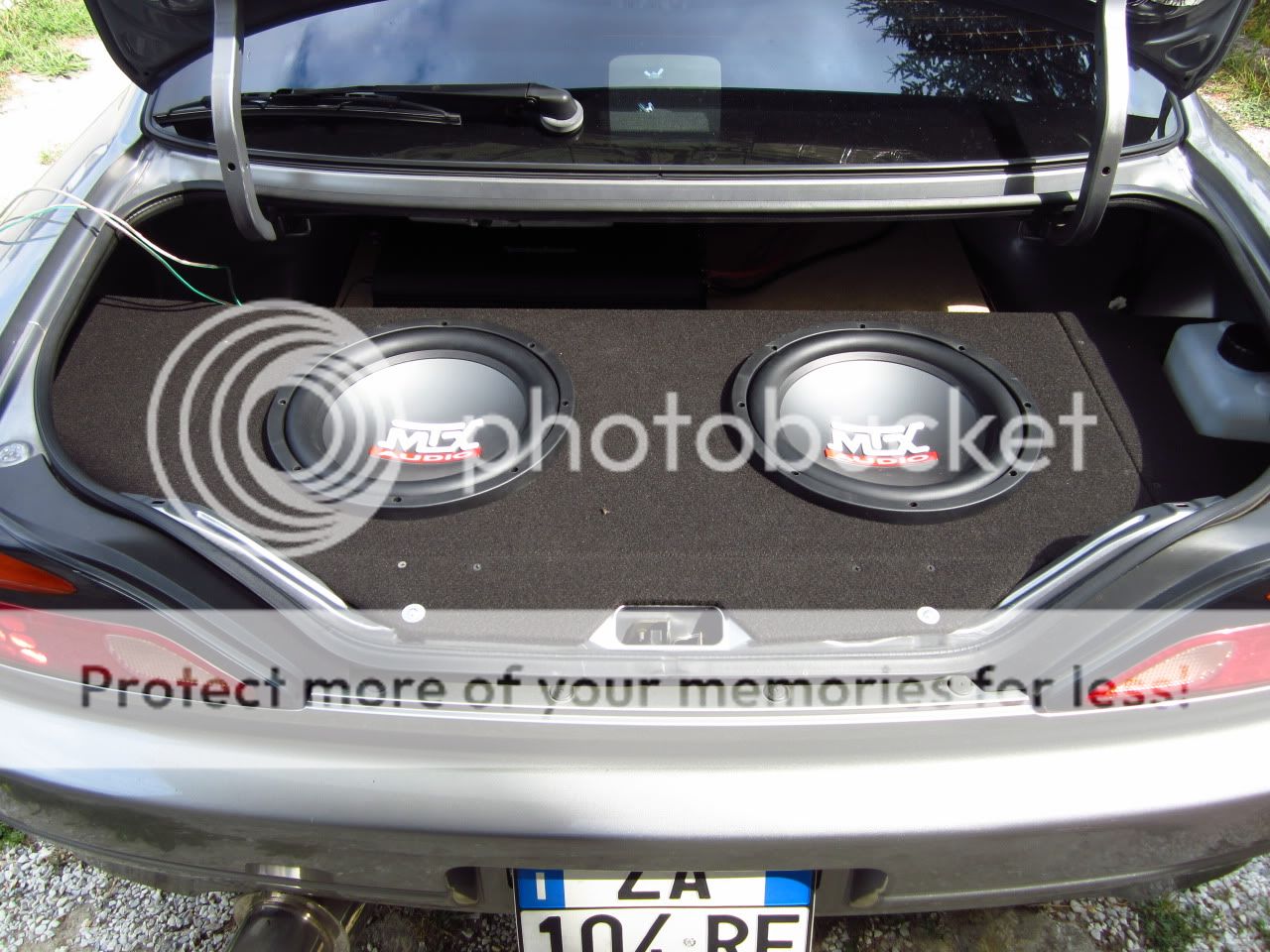

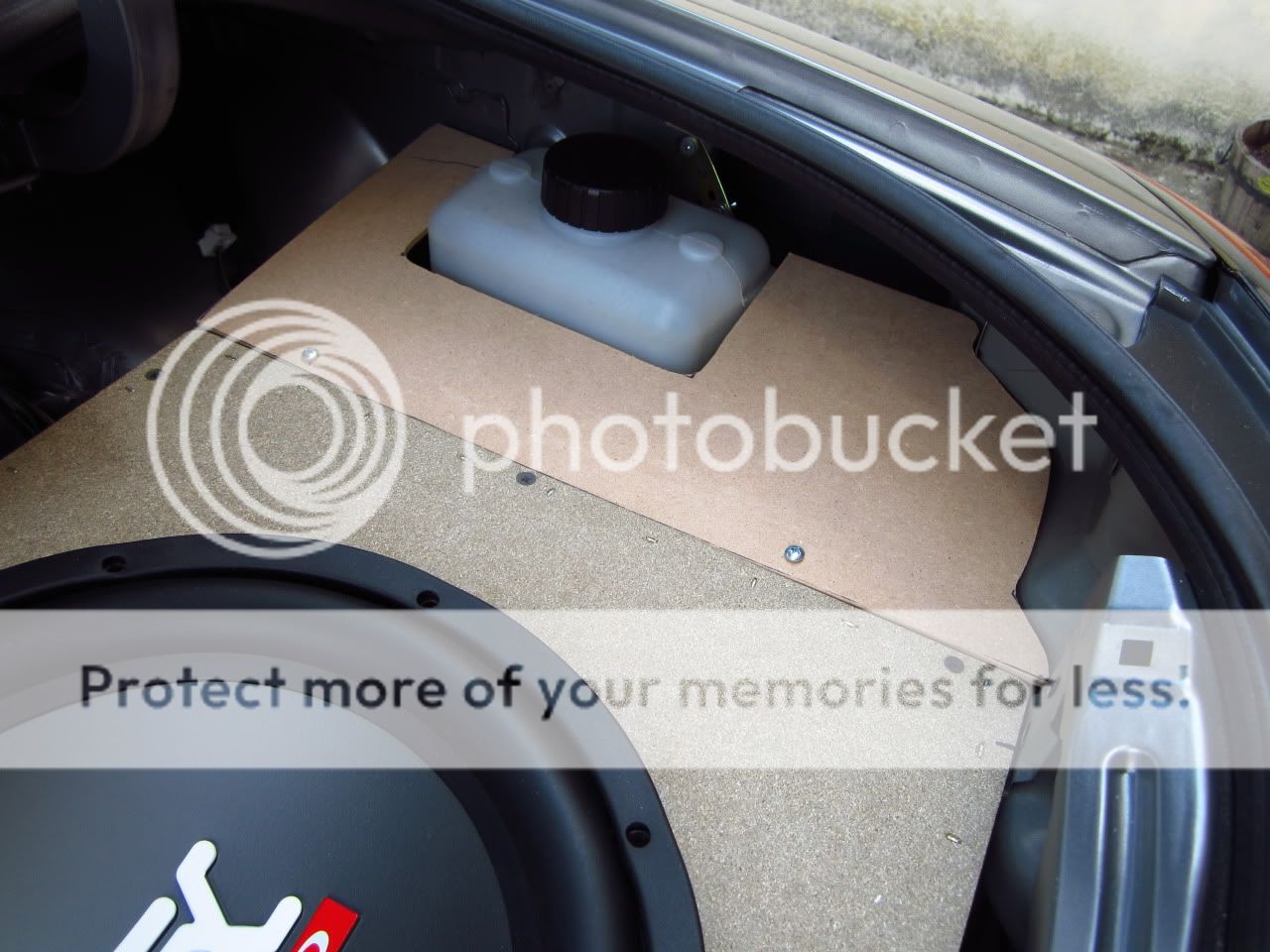

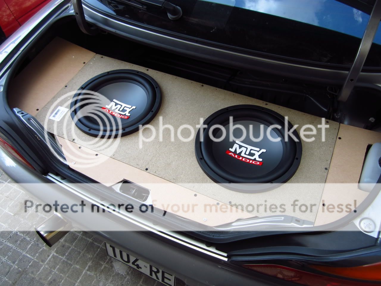

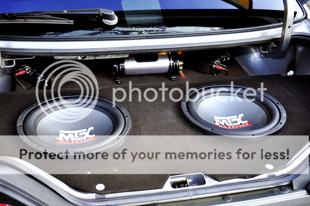

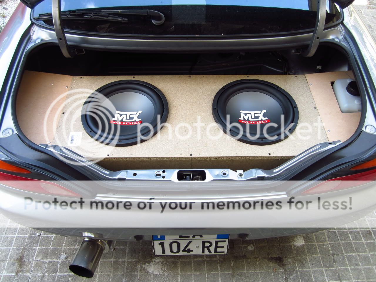

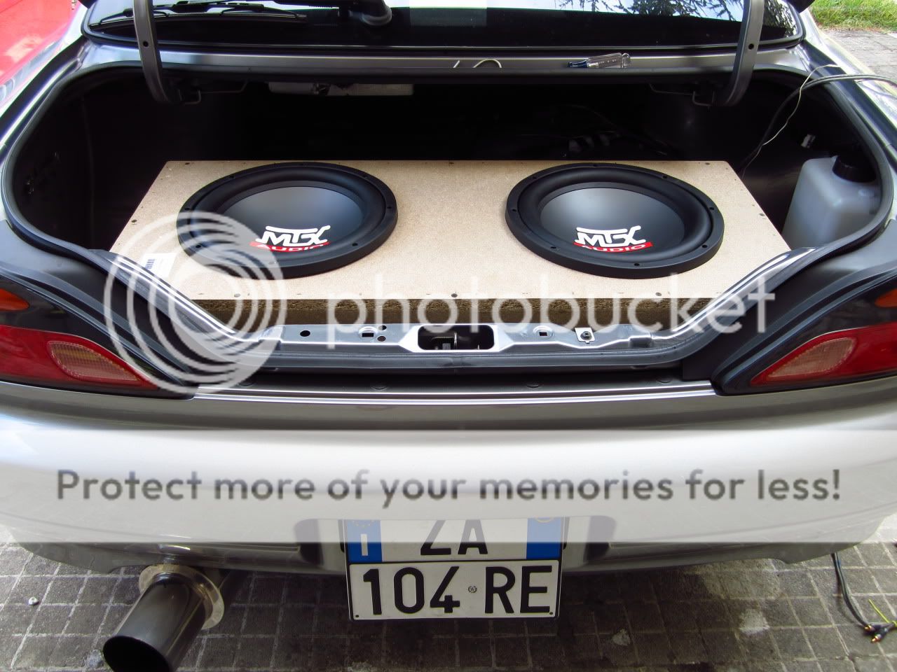

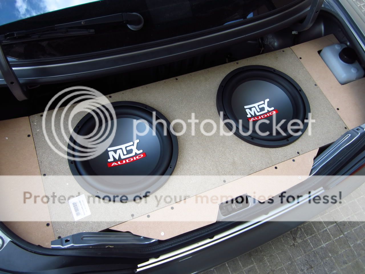

This is the finished product. I'm super happy with how it turned out, simple and clean. It all comes out in about 10 minutes with only a philips screwdriver. Next time I go to a show I'll get a SPL measurement. I'm guessing in the 115-120db range. I can actually hear my music over my exhaust now with the windows down.
9 September 2009
1,864

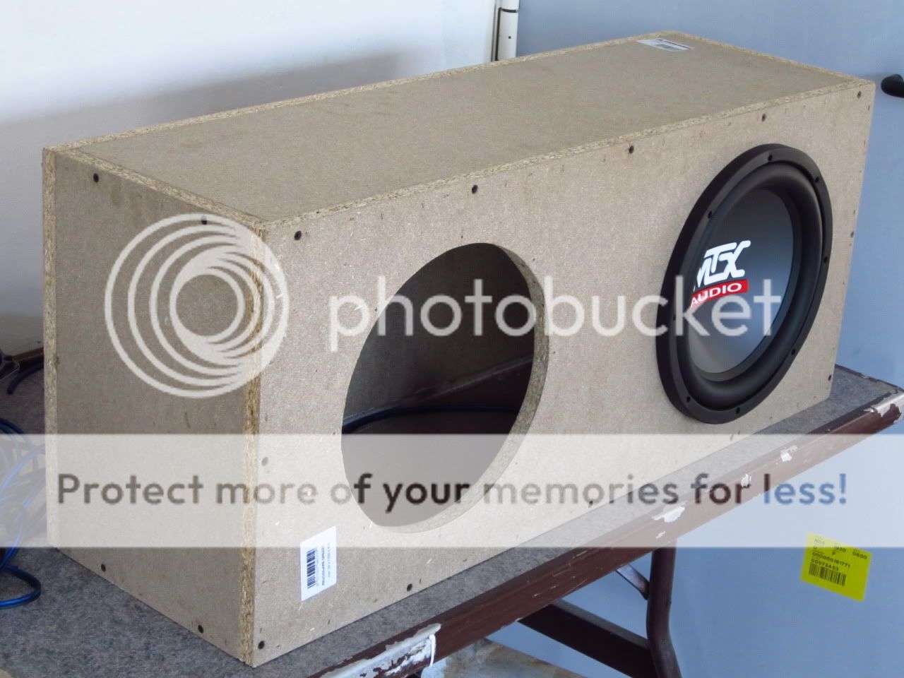

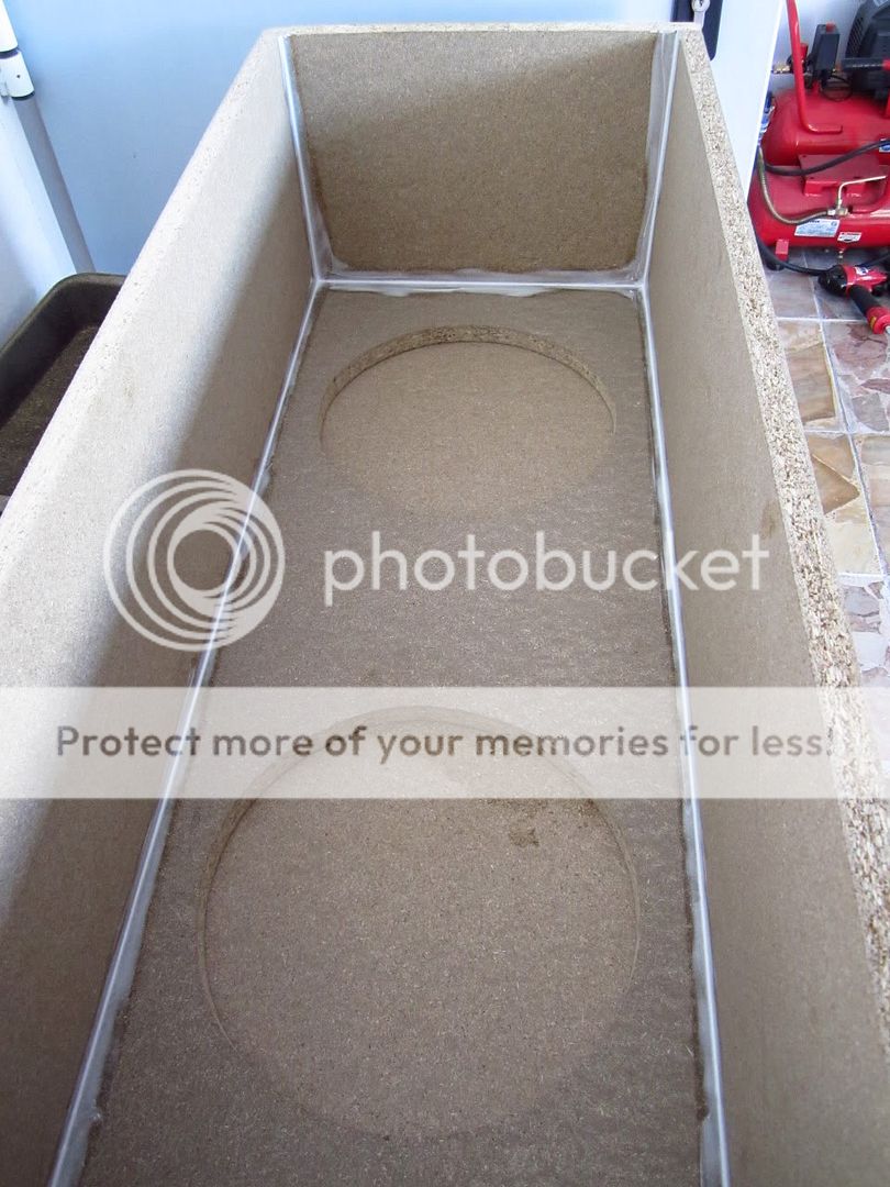

good choice of boot space usage, is that bottle on the right your windscreen washer? and was wondering where the breather holes for the subs are?
13 June 2010
240
Pisa, Italy
www.flickr.com
The bottle is for my methanol injection. I ended up keeping the box sealed. Because of limited space I wouldn't be able to use the size ports that I need to stop port noise and also properly space them away from the sides of the box and woofers.

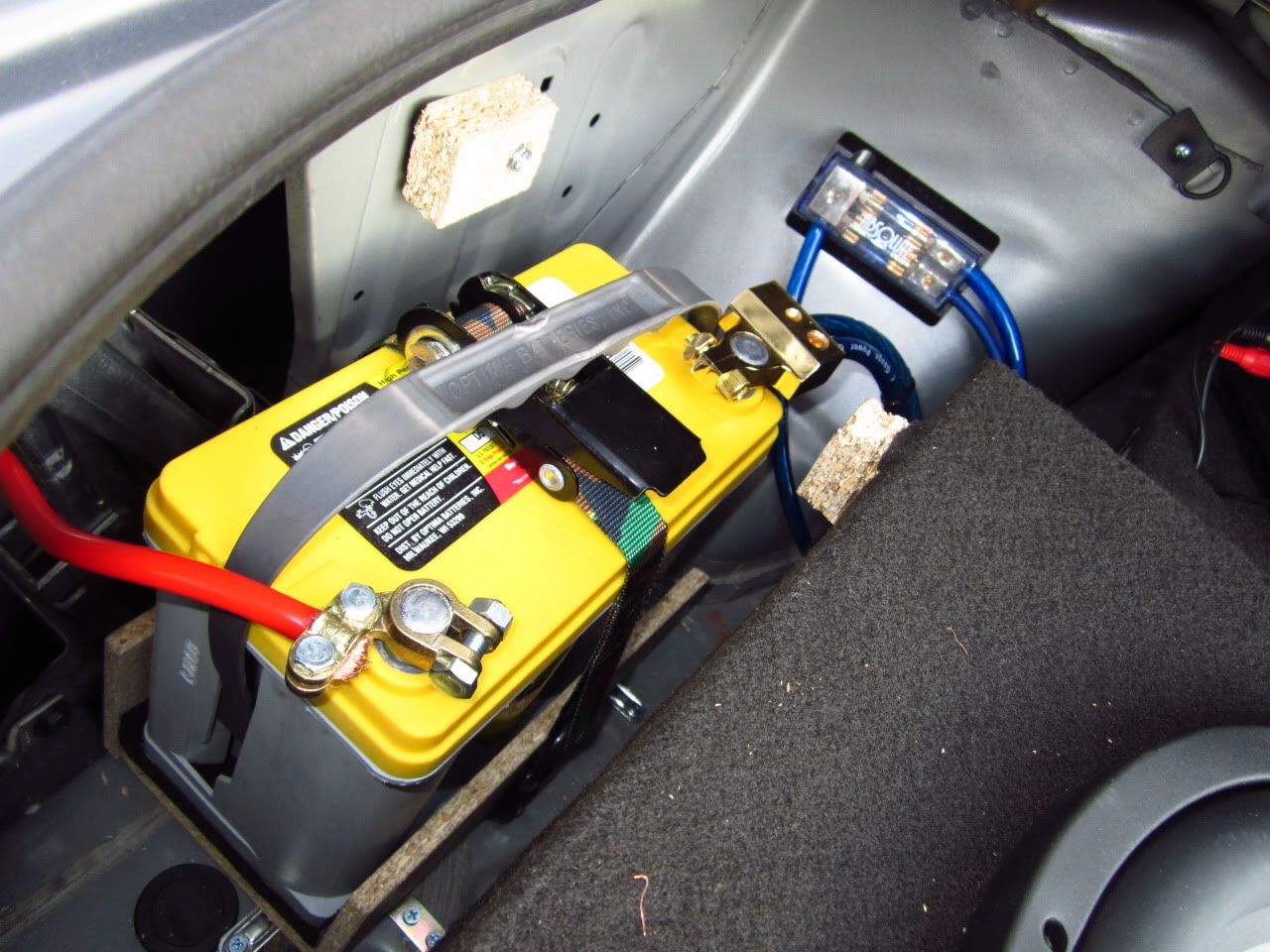

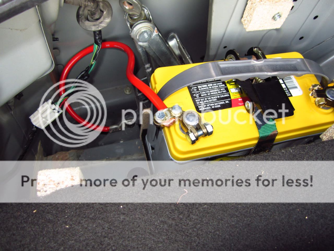

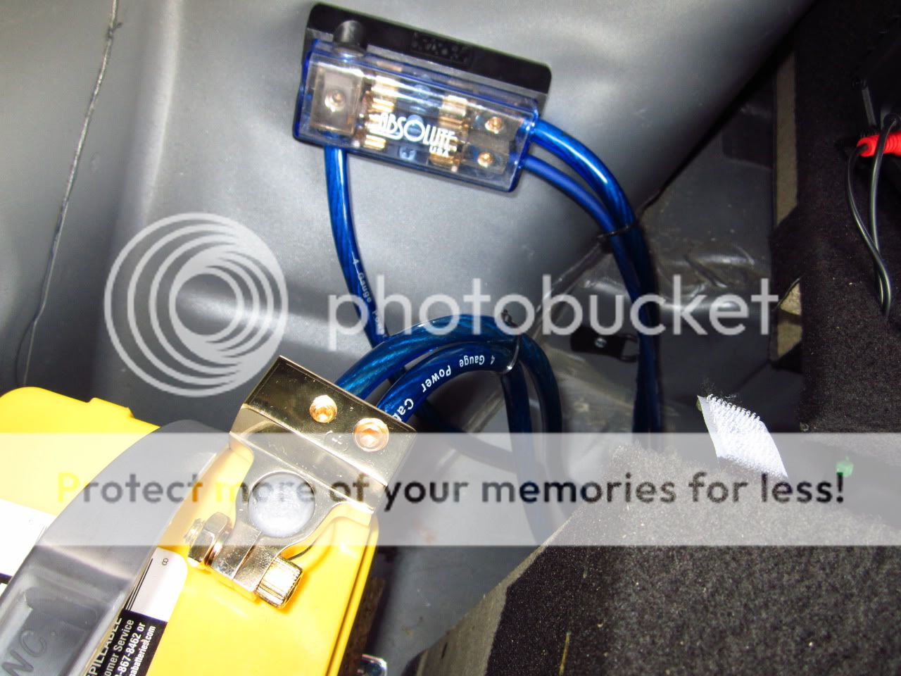

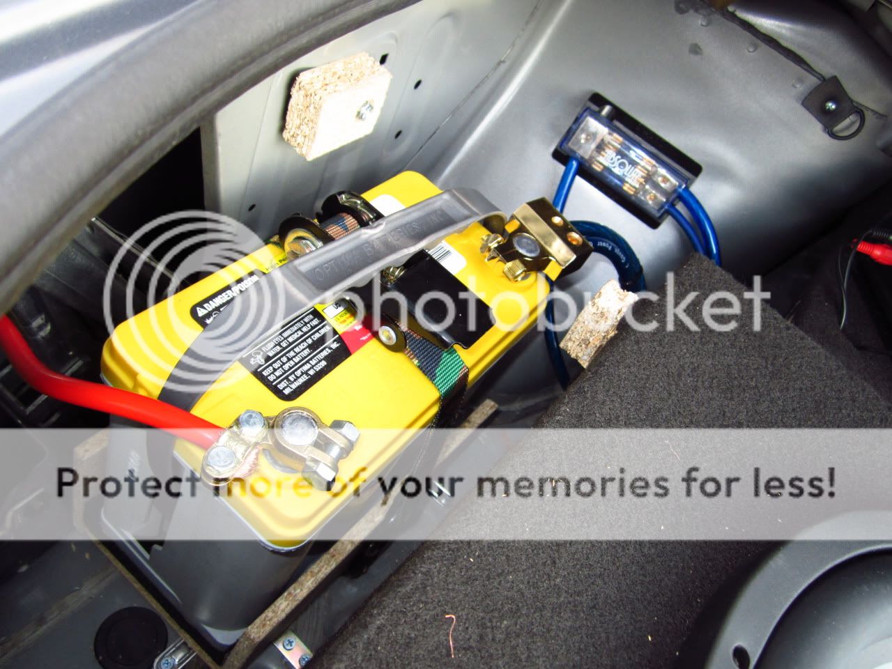

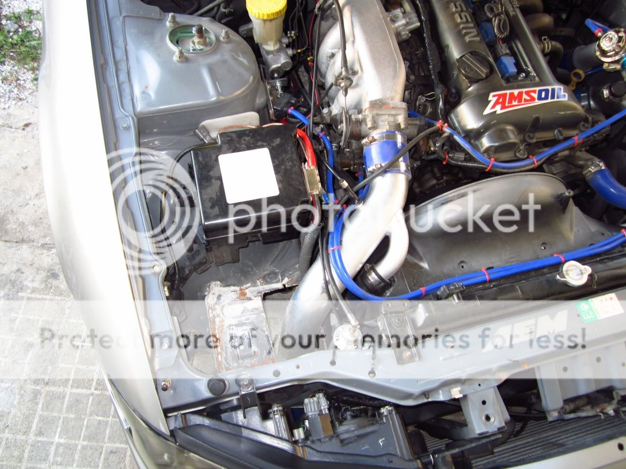

I finally got around to putting in a Optima and moving it to the trunk like I've been meaning to do for about 2 1/2 years. My old battery leaked all the acid out of one cell and got all over my engine bay. If anybody knows the best way to clean that **** up please let me know. I also got a bracket from CodyAce on Zilvia to use a 125amp alternator from a Nissan Quest, the stock 90amp isn't keeping up with 650watts of sound system and 55watt HIDs.
Pics.
31 December 2009
