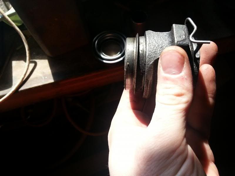

Well IMHO it looks like to me that there was some dirt on it and i put in on unevenly :( and now im afraid to pull it off encase it Damaged the E50 Bearing :O. i took it to my engineering mate and he said oh ill just press it on and it should sit straight and be ok... so after a quick squeeze the Shoulder started to bend back :mad: so now im guessing its Defanatly Screwed and ill need a new Sleeve *FACEPALM
here you can see where the Shoulder is Damaged, i measured to see how ineven it is, here its measuring 59mm
and this side is 60.5mm :(
id say this is a fairly persise peice of kit so im guessing a new Relese bearing and Sleve E100+ :( o well ya got to learn somhow :(

well i pulled it off the bearign is still 100% ok... but the Shoulder of the sleeve is damaged badly,
so ill be needing a new sleeve... anyone have the part number for it? or can confirm that the 5 and 6 speed sleeves are the same?
the only partnumber i can find is 30501-0h600... but that is for a s14 5 speed.

i ordered a new sleeve through a nissan dealer they seemed to know there stuff and i was assured it is the right one, i have him the 30501-h600 and he told me it was subseeded for 30501-k0404. he has it down on the receipt as a 6 speed release sleeve... but it looks nothing like the old sleeve.

im sure it will work, its machined a little different as companies make things like this to fit heaps of different models, the overall height is the same and where the lip stops, (going from the top down) is the same distance, and the diameter is the same, the location for the clip pin is the same, and the tabs are the same

well your a legand :) i got in touch with the just jap lads got talking to andrew apperently he removed the duel mass flywheel and fitted a 5speed flywheel and it needed a 5speed sleeve and release bearing to work ao seems after all this time i needed a 5speed release sleeve to compensate for the distance created by removal of the duel mass flywheel

haha ya it turns out i need a 5speed one now as the duel mass flywheel was removed andits hard to see in the photo but there is a 10mm diffrence in the sleeves, thanks for all your help bro, if there is onething i learned in australia last year is that kiwi's are the soundest people on earth :D haha ill be sure not to let him near anything again lol

if yes why would you need a different sleeve, is your flywheel from a S14 5MT or something? which would not work with the 6MT input shaft as its too short
I have a SMF (designed to work with the 6MT) and kept all the S15 parts that control the release and it works works fine, didn't have to change or adjust anything

just thought id Update everyone on this, as Spoonman just Explained, it turned out that i Had a s14 solid Flywheel, its nearly 2inches thinner than the duel mass fly that came out of the car, as the input shaft of the 6 speed Gearbox is shorter than the 5 speed one, the shaft is just resting on the Clutch its not reaching the spigot bush in the crank, and this is putting stress on the Gearbox and clutch and that's why the clutch **** its self.
