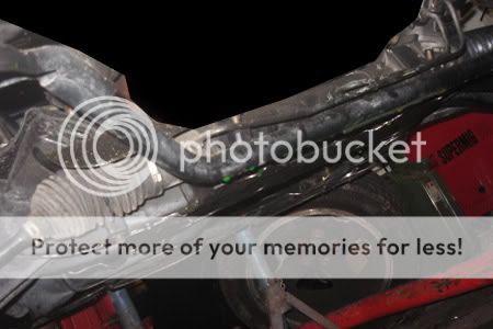

Front Brace --- will bolt onto Spec S just behind front subframe

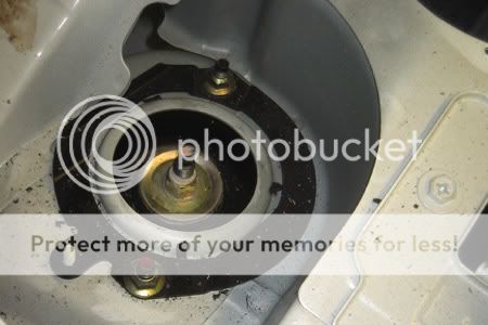

Front & Rear strut top plates --- will bolt on

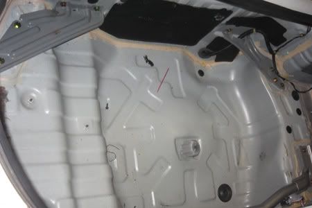

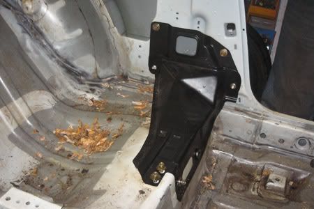

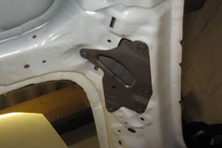

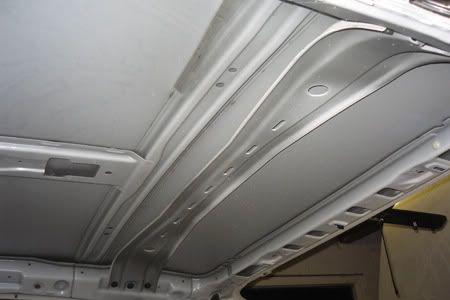

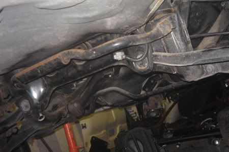

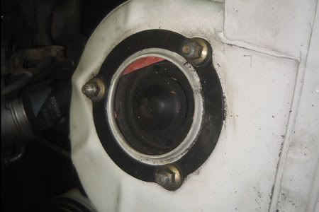

These pics are what they look like if you are trying to source them, (missing pic of front lower control arms)
Boot Brace (rear of boot) --- wont bolt onto Spec S, but can be made to fit
Boot corner braces (front of boot) --- wont bolt onto Spec S, but can be made to fit
Roof Brace --- not sure on bolt on
![](/discuss/proxy.php?image=http%3A%2F%2Fi266.photobucket.com%2Falbums%2Fii280%2Farcnz%2FS15RearSubframe.jpg&hash=848c12d8cb795a35acb6541e5ea6f7ea)
![](/discuss/proxy.php?image=http%3A%2F%2Fi266.photobucket.com%2Falbums%2Fii280%2Farcnz%2FChassisRailBrace.jpg&hash=2e2e877b2d877cad15269d1e07f2657d)
![](/discuss/proxy.php?image=http%3A%2F%2Fi266.photobucket.com%2Falbums%2Fii280%2Farcnz%2FBootBrace.jpg&hash=3805a4be52f8a2defd74a08a89a140cd)
![](/discuss/proxy.php?image=http%3A%2F%2Fi266.photobucket.com%2Falbums%2Fii280%2Farcnz%2FBootCornerBraces.jpg&hash=348b6d4715db7f0fa965cdfdb8a8dd94)

![](/discuss/proxy.php?image=http%3A%2F%2Fi266.photobucket.com%2Falbums%2Fii280%2Farcnz%2FRolloverbar.jpg&hash=34d58ffccc3f0ab31f2c46f2c2bc55ae)
![](/discuss/proxy.php?image=http%3A%2F%2Fi266.photobucket.com%2Falbums%2Fii280%2Farcnz%2Ffrontstrut.jpg&hash=3a1569618e84749462a35962fb289a7b)
