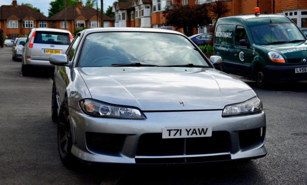

Anyway, after focusing on tasteful handling mods and renewing aging parts to make the car feel modern again I thought I'd see what happens with a headlight restoration kit. Turns out, this was a great idea!
Also running in my Nismo 1.5 way which just keeps getting better and better. Very polite with preload setting at 'low' and no noise what so ever (some skipping on tight corners as its runs in, but this has nearly faded)... Loving ownership of an S body so much right now.

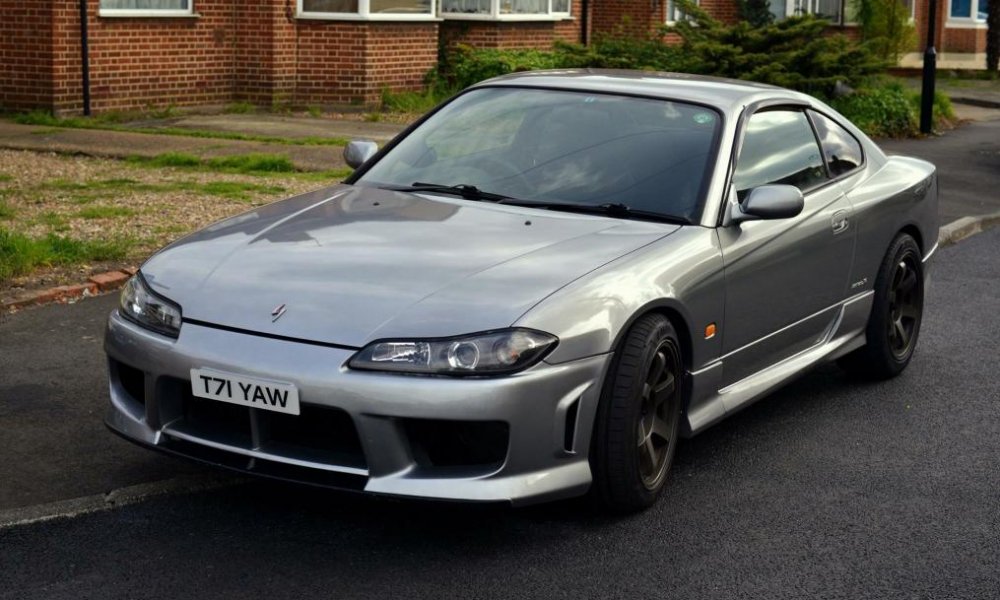

Well, I'm no longer the owner of this beast. Got her to such a nice state where she was perfect for the roads. Diff was easily the best mod, and power-wise she was close to standard but in the end the gearbox self destructed under moderate power. No abuse to speak of, just a weakness resulting in 3rd/4th becoming next to useless followed by crunchy grinding. I've cut my losses and passed it on to someone who's done loads of work on her already and has a very high standard so it won't end up being bodge wagon covered which I'm pleased about. OS Giken 5 speed due to go on, should be absolutely brilliant. Also, knowing the new owner it will be making 400hp+ before long.
Heartbroken!
