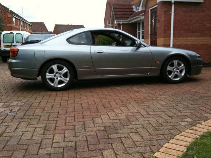

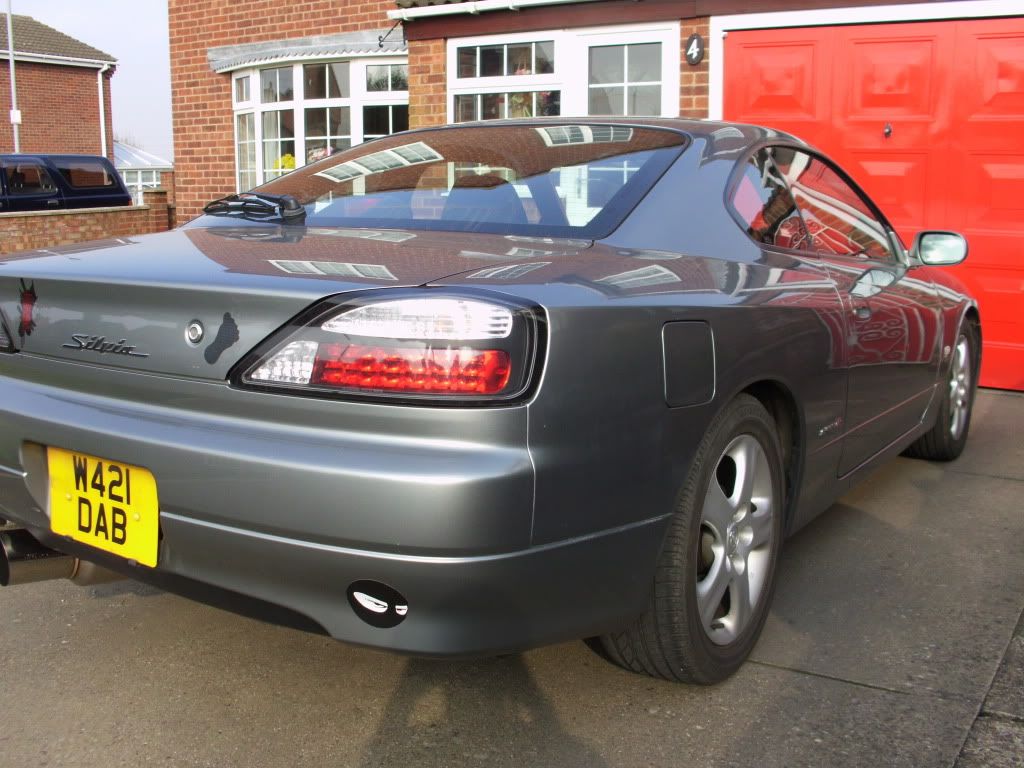

After a year and a half owning my S15 i think its time i put this here, not that its anything special or different. (copy and paste:wack: but i'll try and slightly edit)
This was a pretty much standard car with i believe just an aftermarket stereo and alarm?
It had a Clifford which was removed and had a pro fit a new Cat 1 with the Immobiliser linked up correctly B)

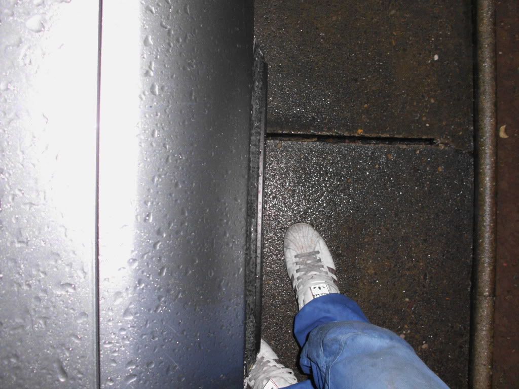

Now it needs undersealing (this weekend pics to follow :) ), the paint sorting and a new boost gauge. The boost starts at the bottom, moves all the way around and back down :huh: Its definatly boosting though B)

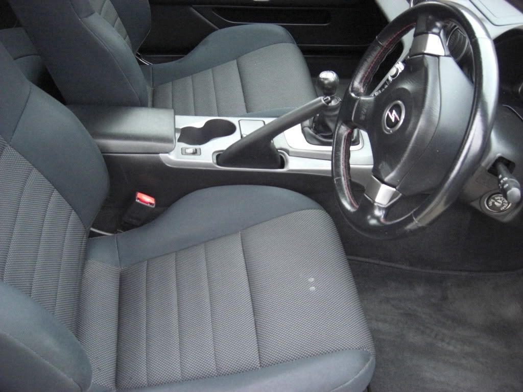

fag burns :angry: but very comfy

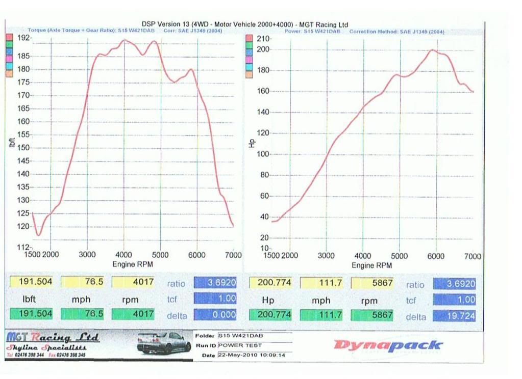

Had a Dyno run whilst it was standard (hub figures)

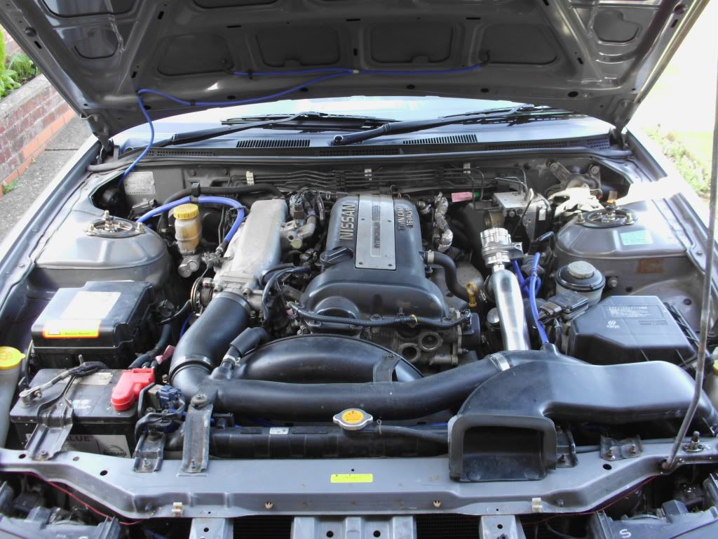

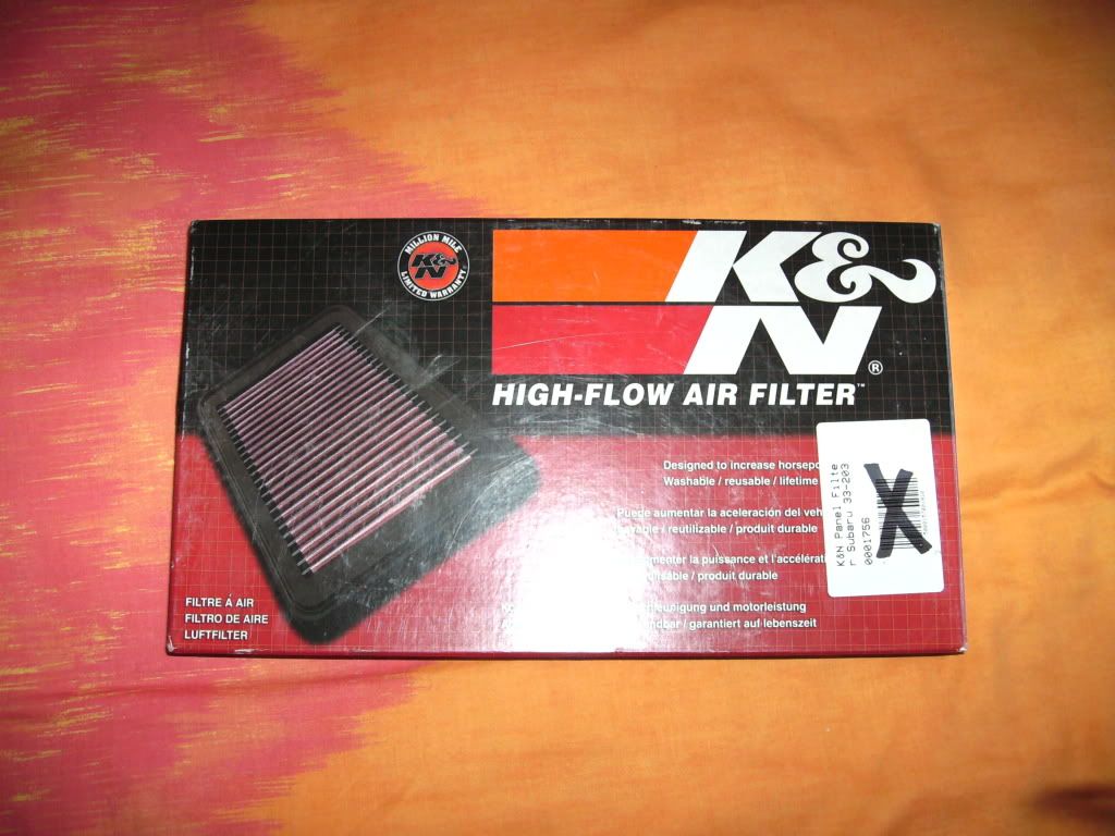

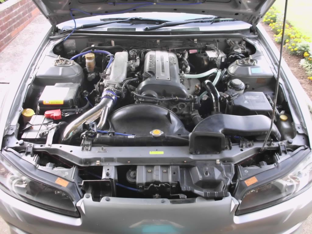

K&N panel filter

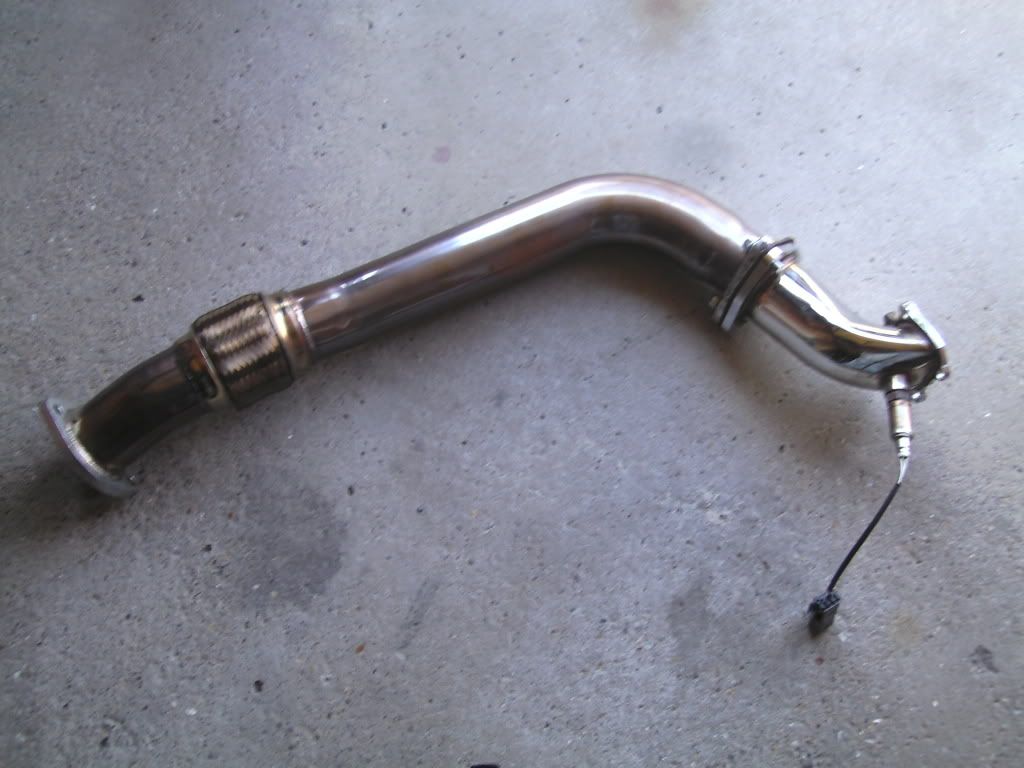

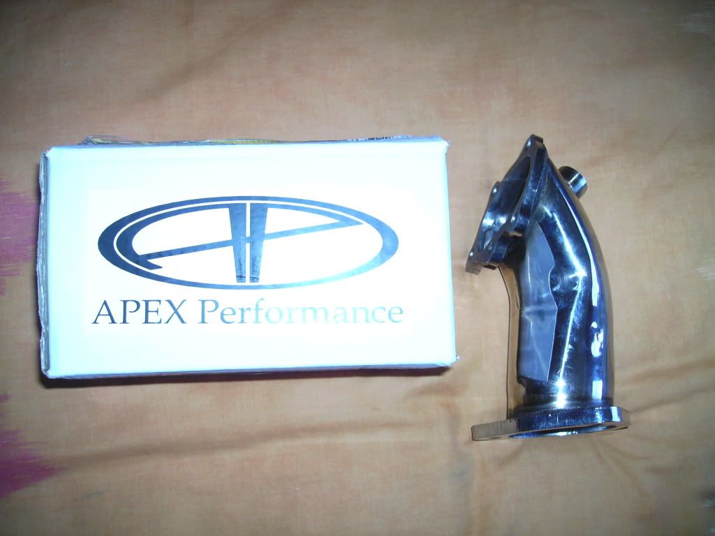

Apex Downpipe

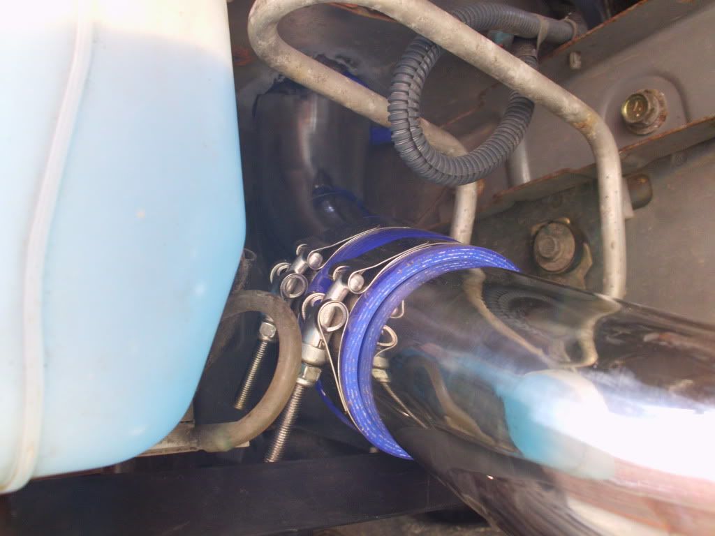

Apex Decat
Blitz NUR Spec R Cat-back
Pigeon mod with removal of un-necessary items

Also fitted Hicas lock out bars

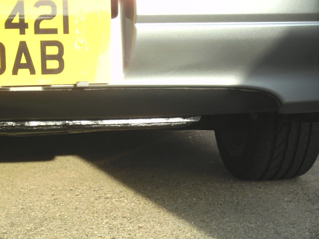

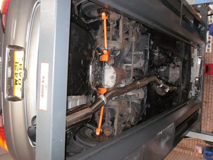

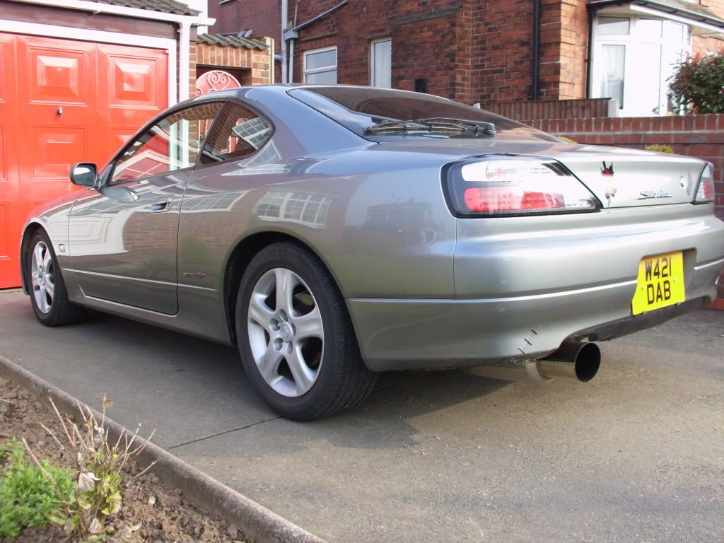

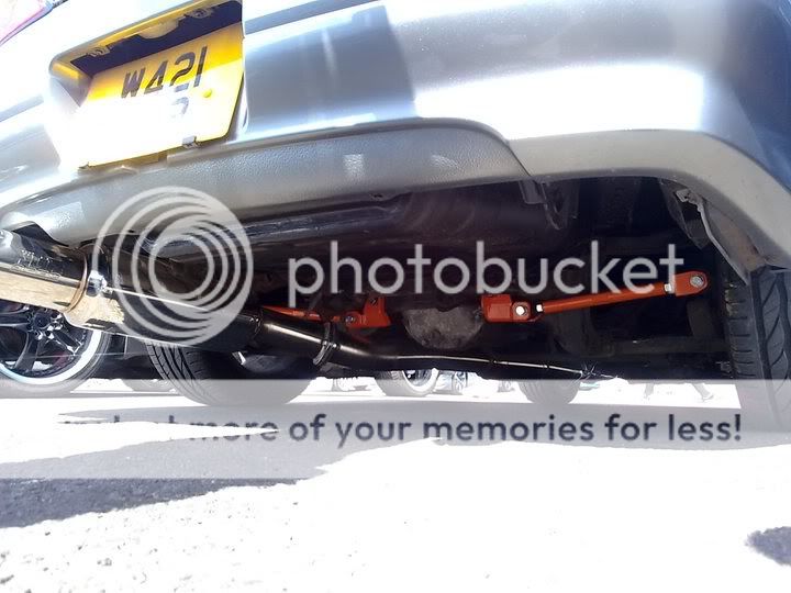

Photo of the exhaust

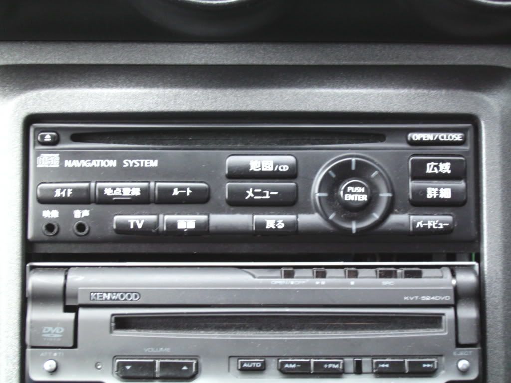

Eventually got bored of listening to the poor radio reception when i finally tried the stereo so fitted my DVD MP3 player which is IMO still a nice bit of kit :cool:

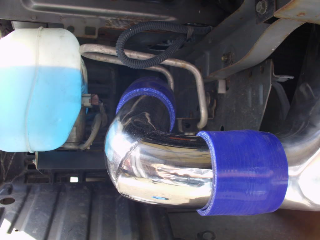

Fitted the elbow

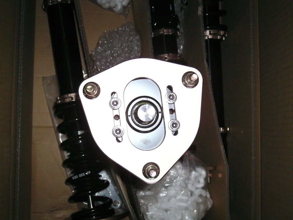

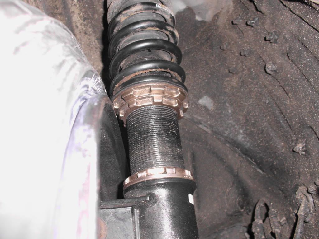

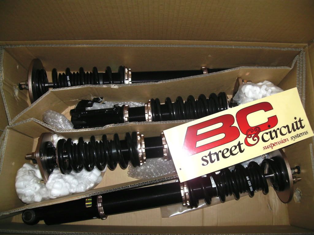

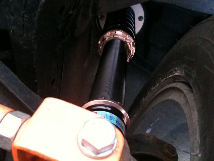

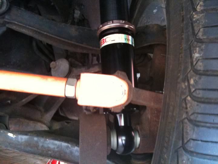

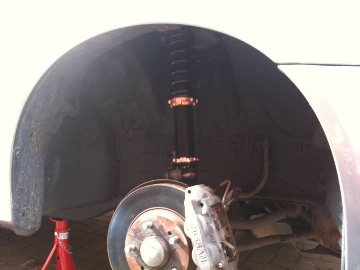

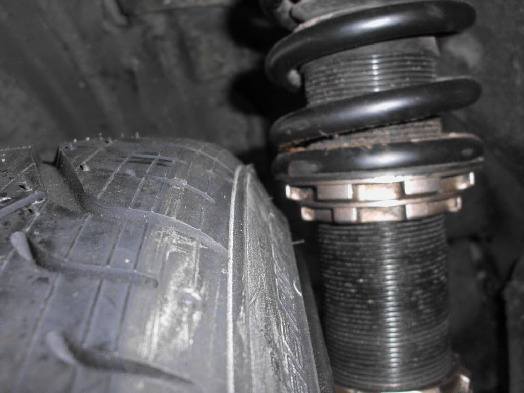

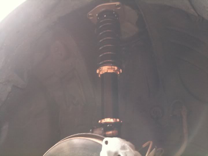

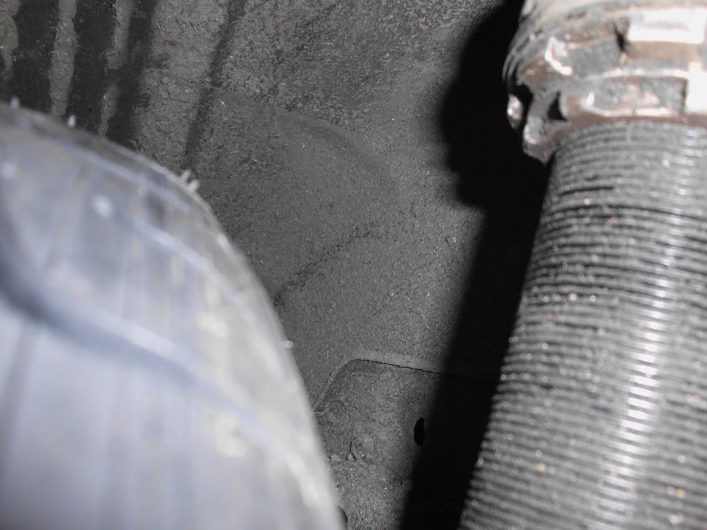

Fitted the coilovers at a friends house

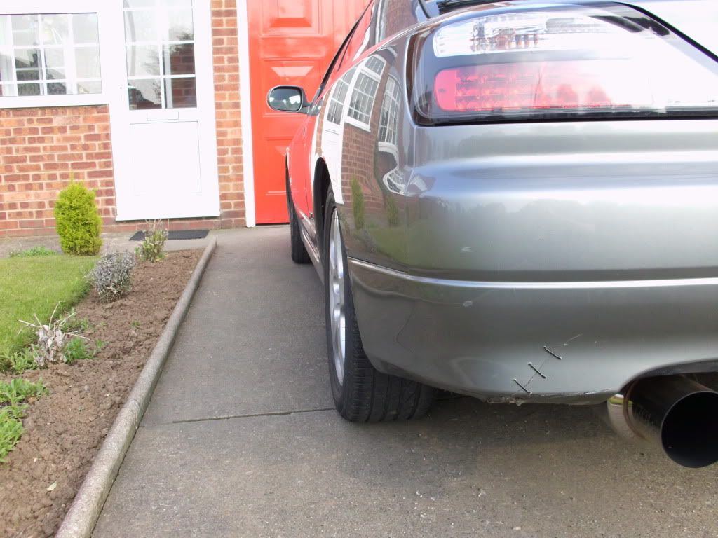

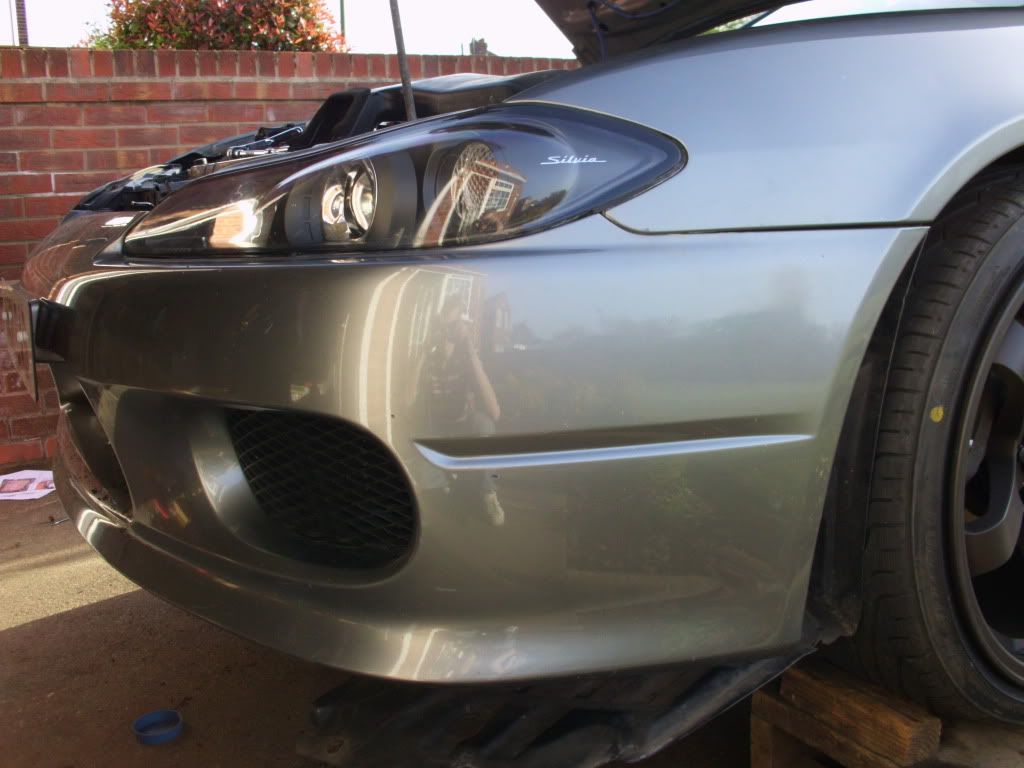

The recess on the rear bumper had a mark so gave it some matt black

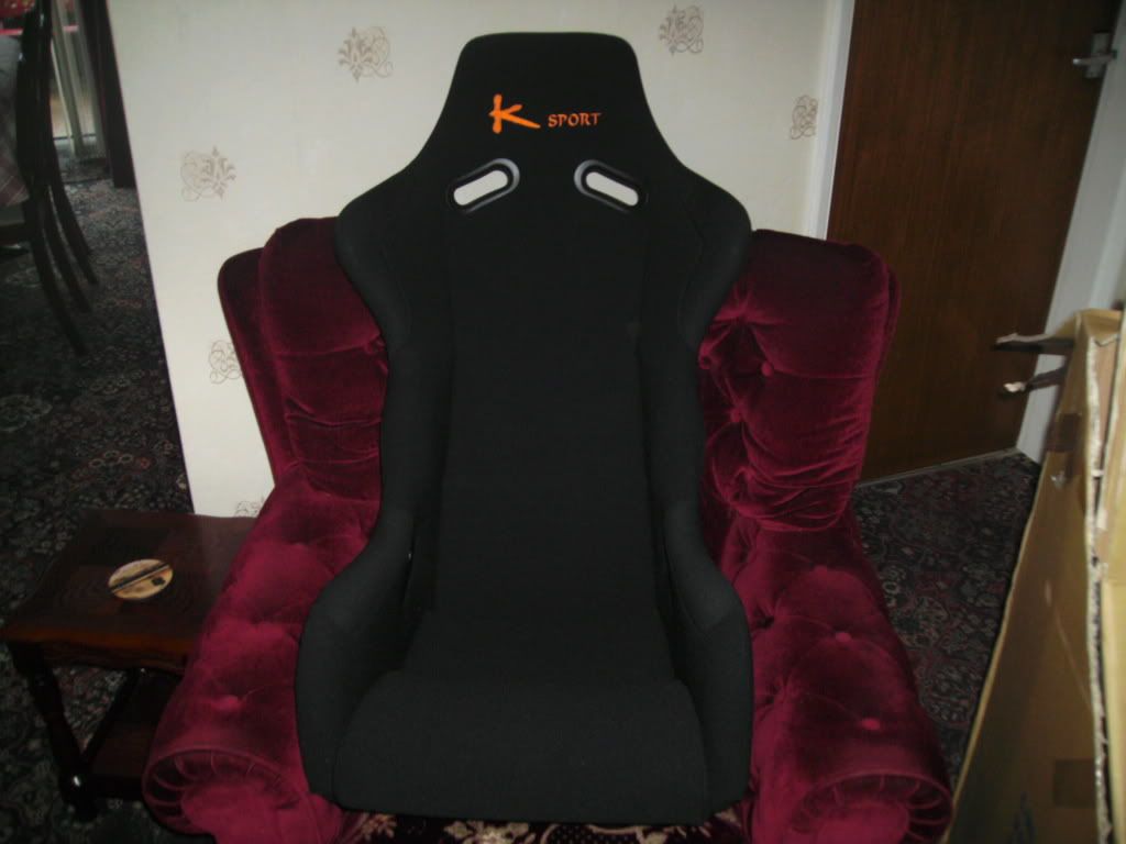

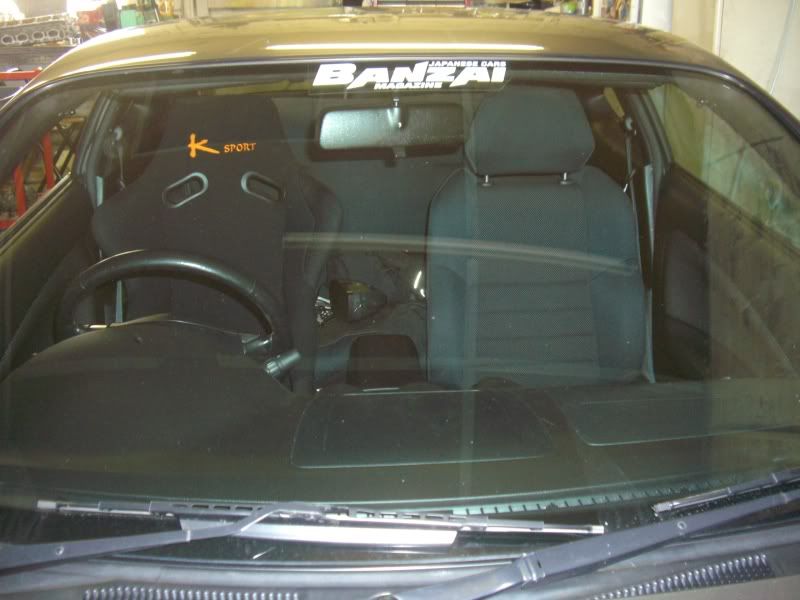

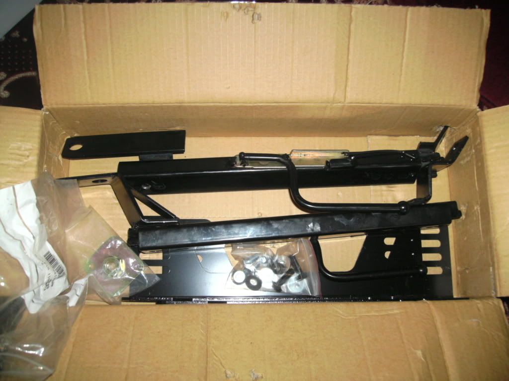

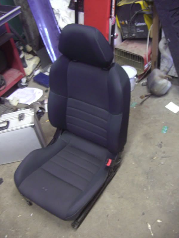

Bucket seat
Rail

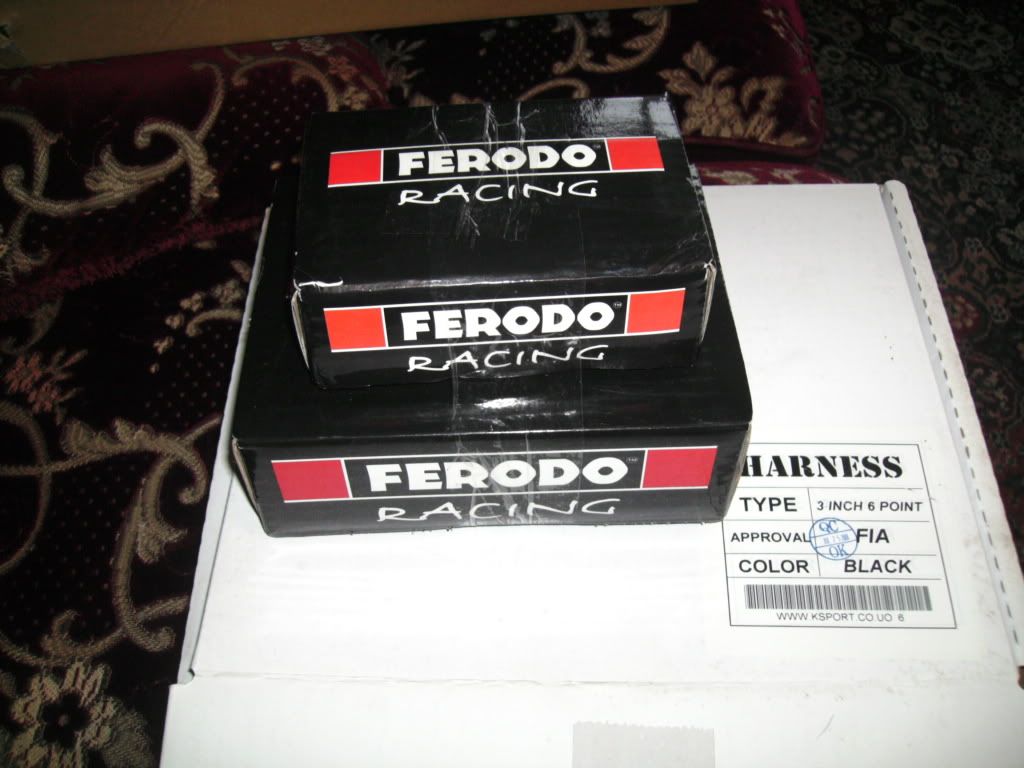

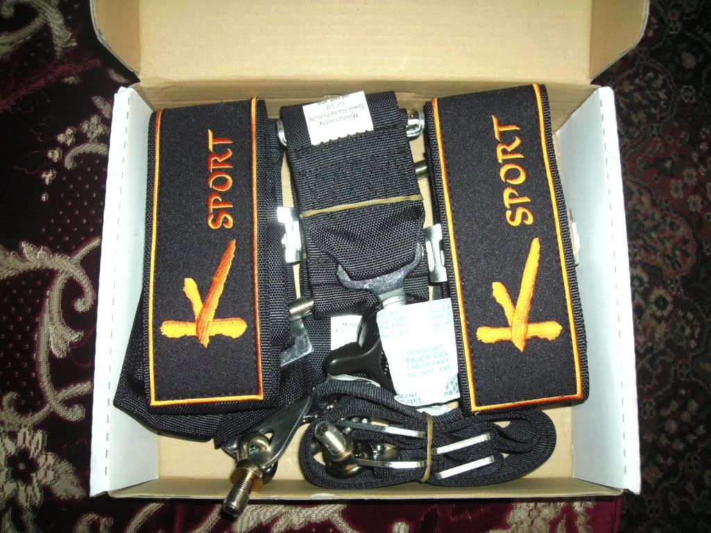

Harness
Ferodo DS2500's

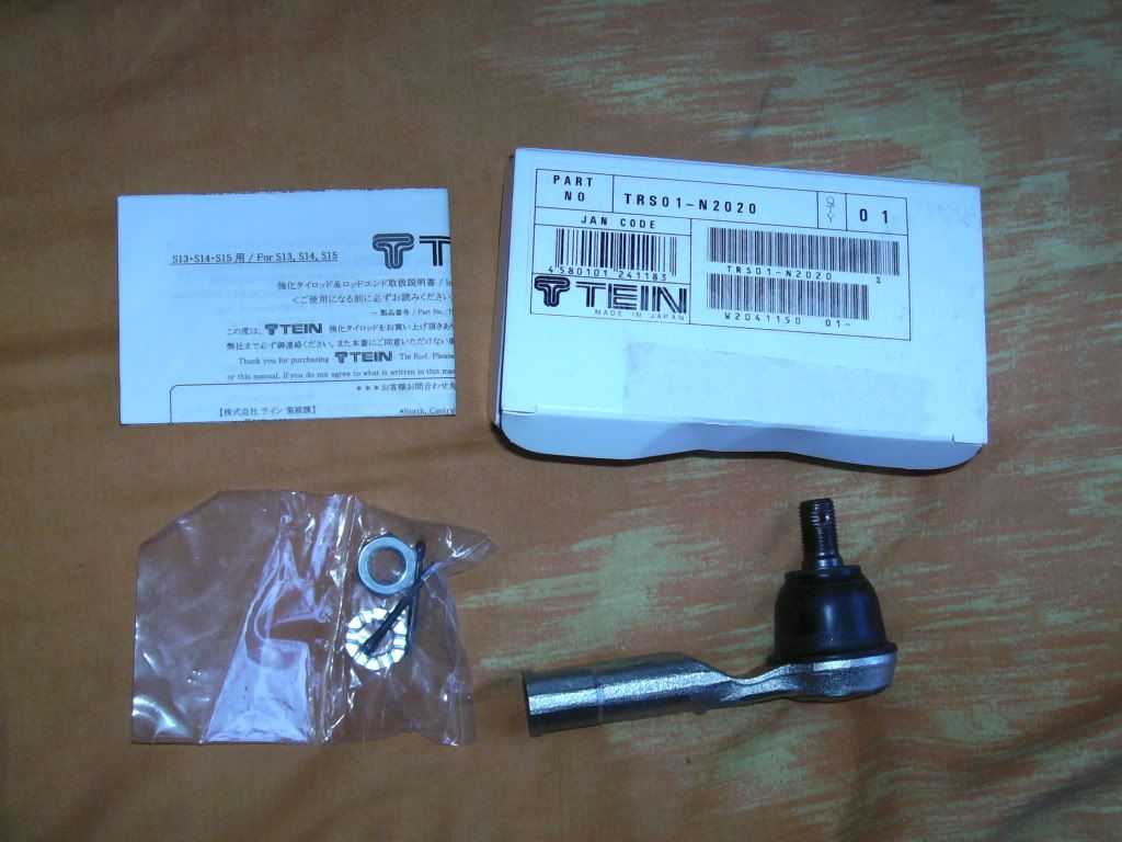

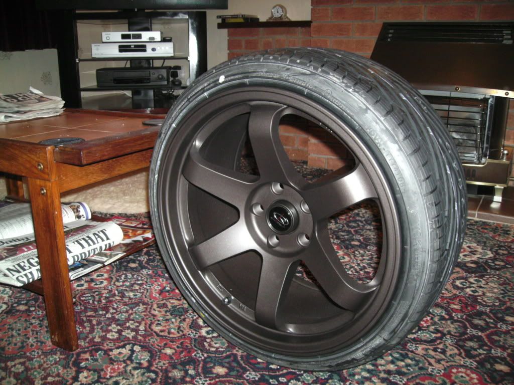

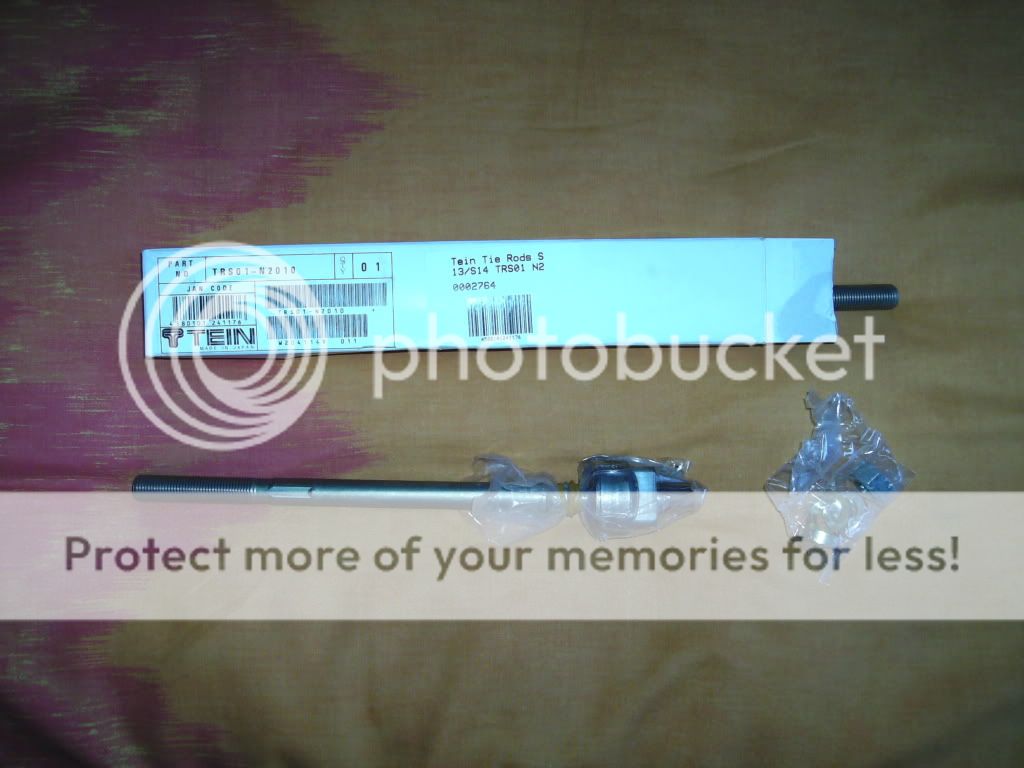

After fitting the wheels it went to a local tyre place where it got full 3D alignment after the track rods, ends and rear camber arms were fitted

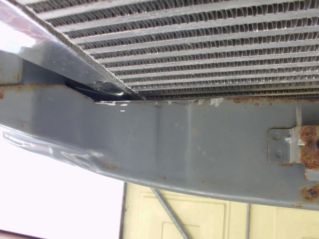

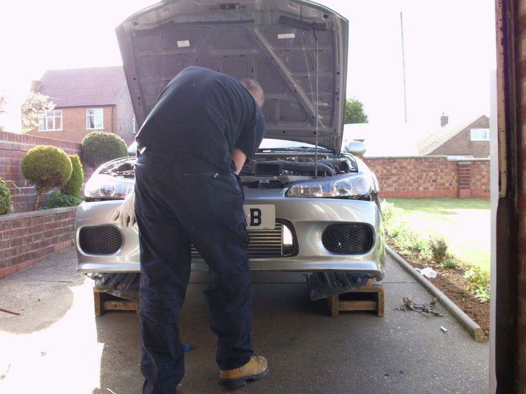

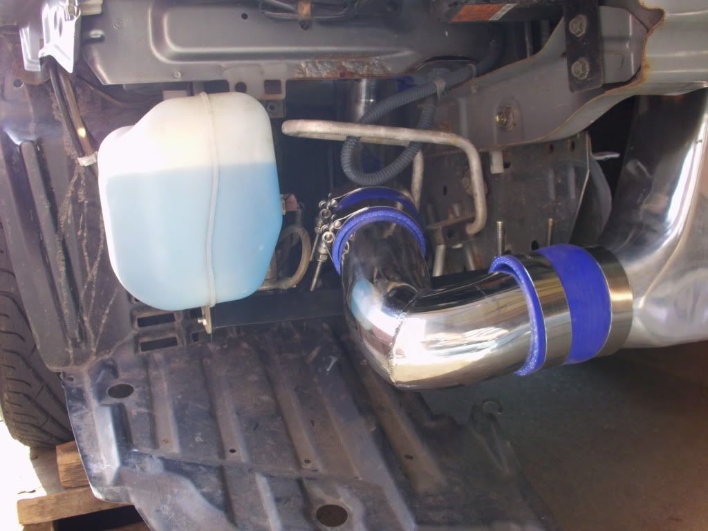

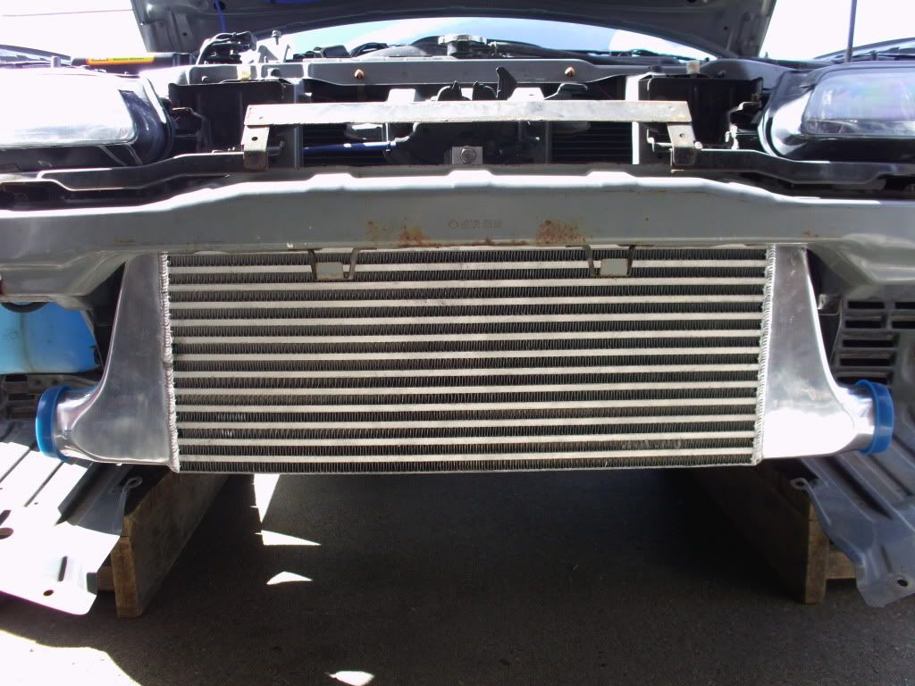

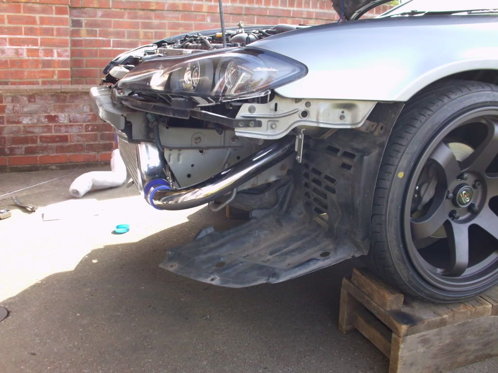

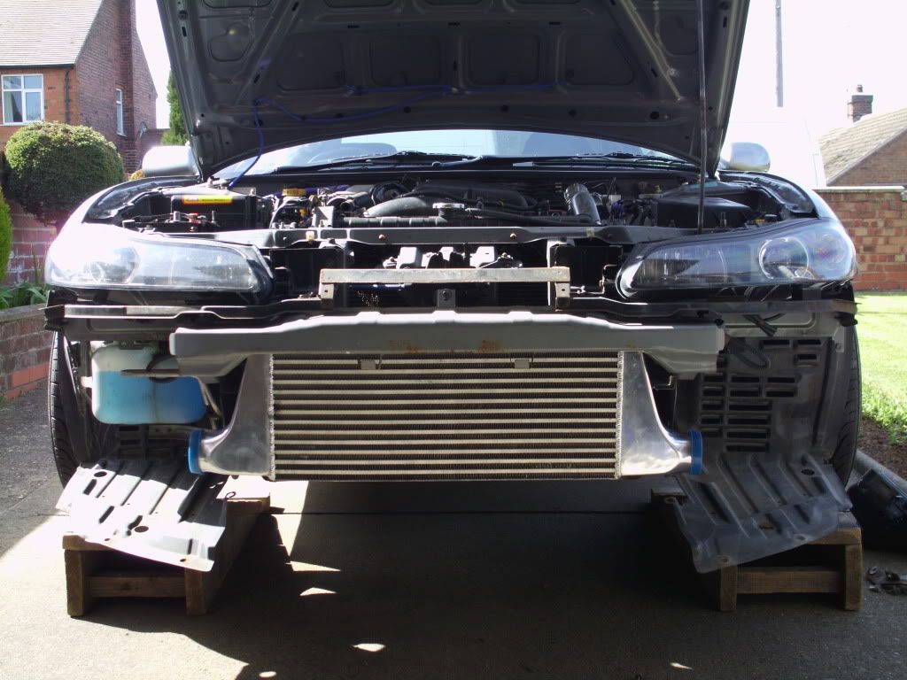

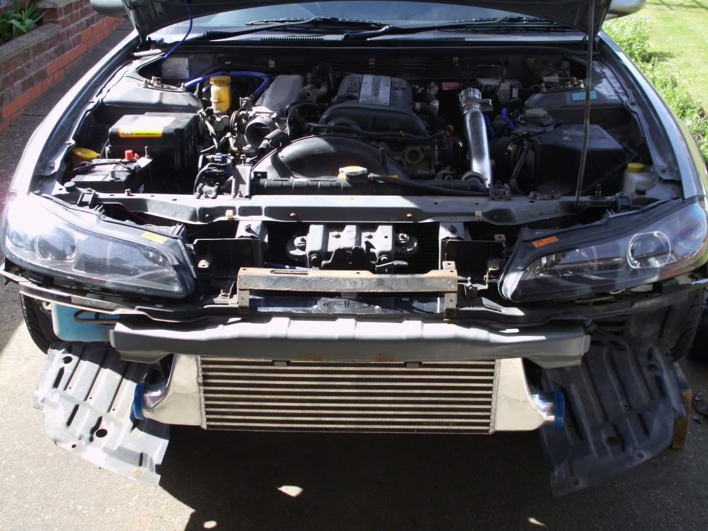

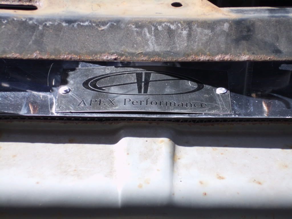

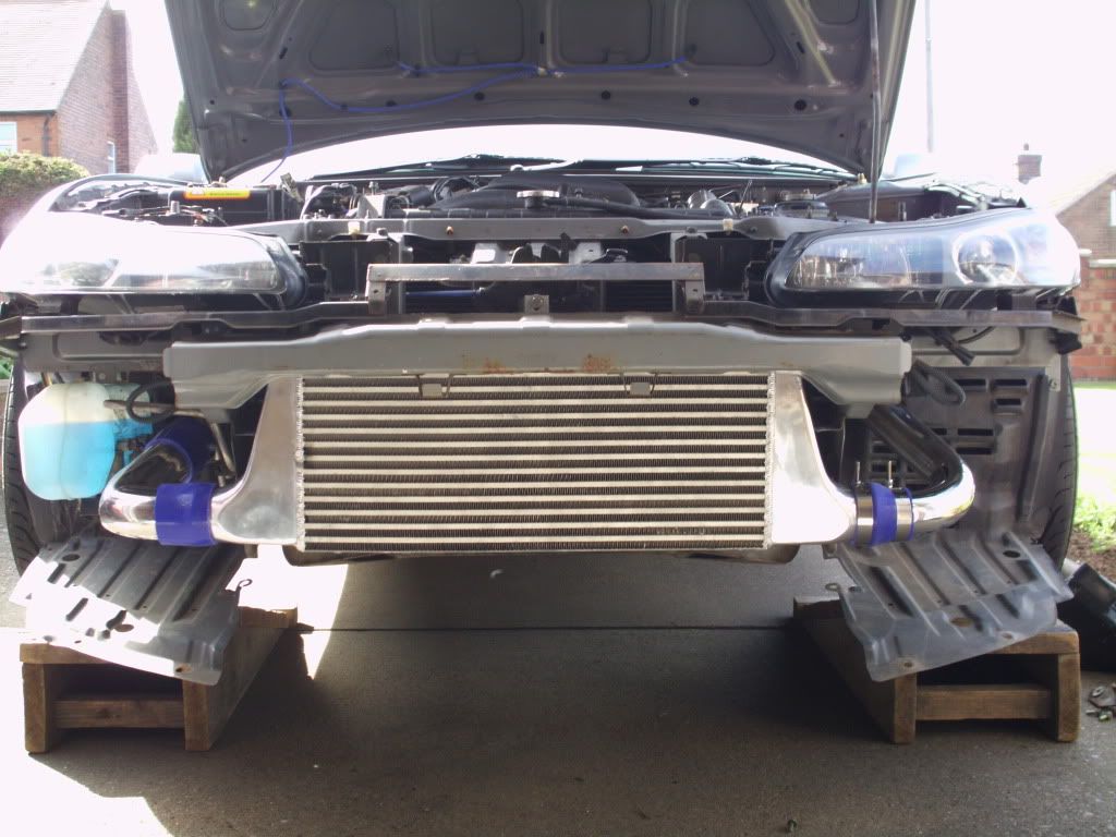

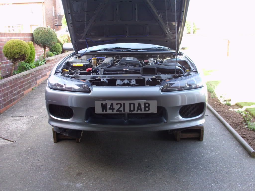

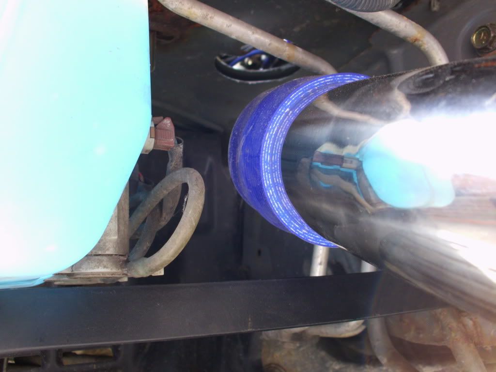

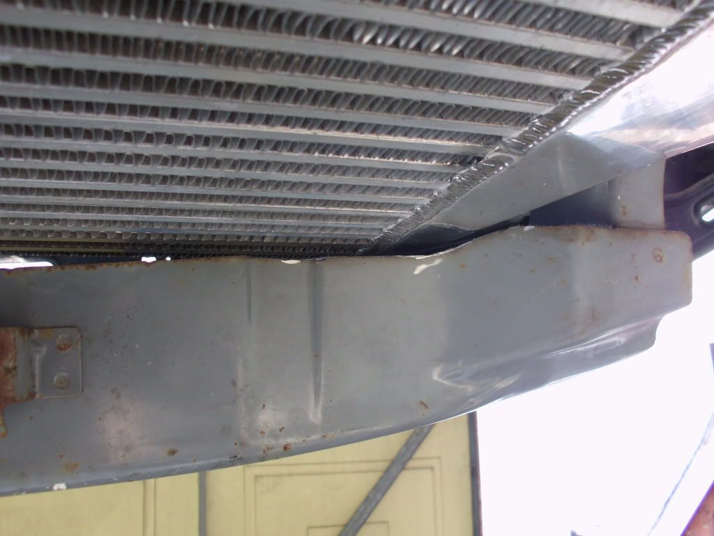

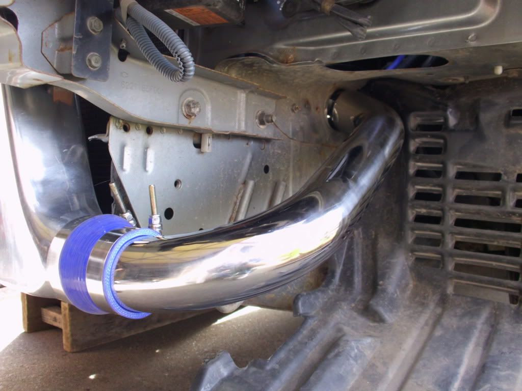

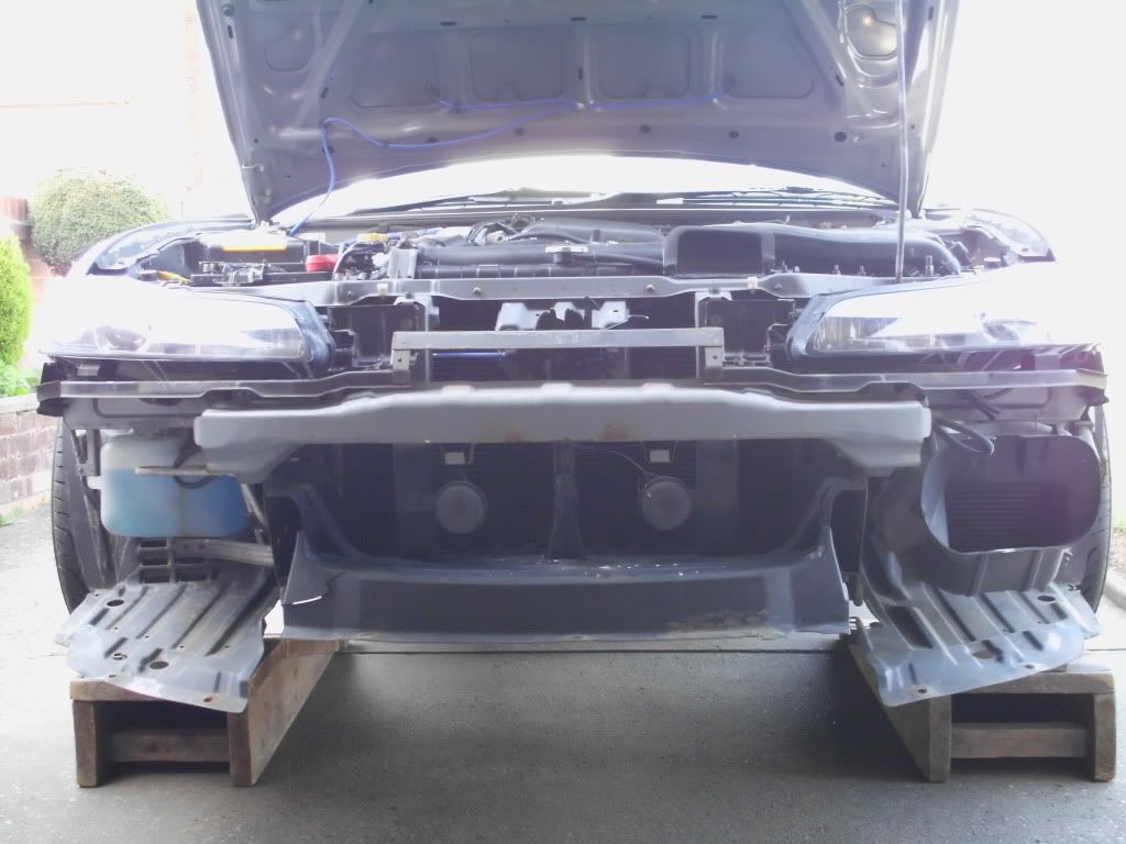

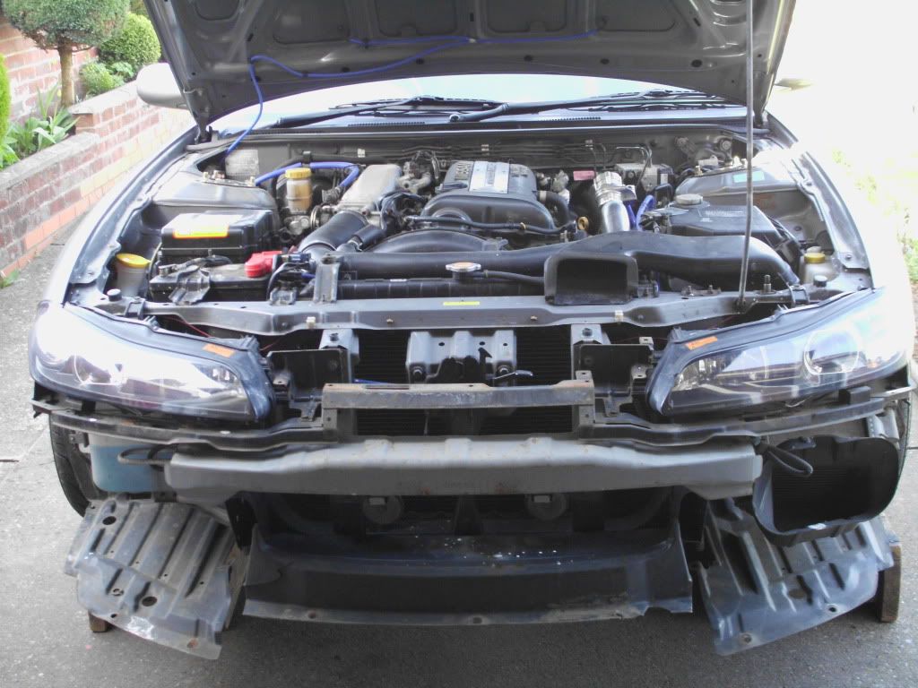

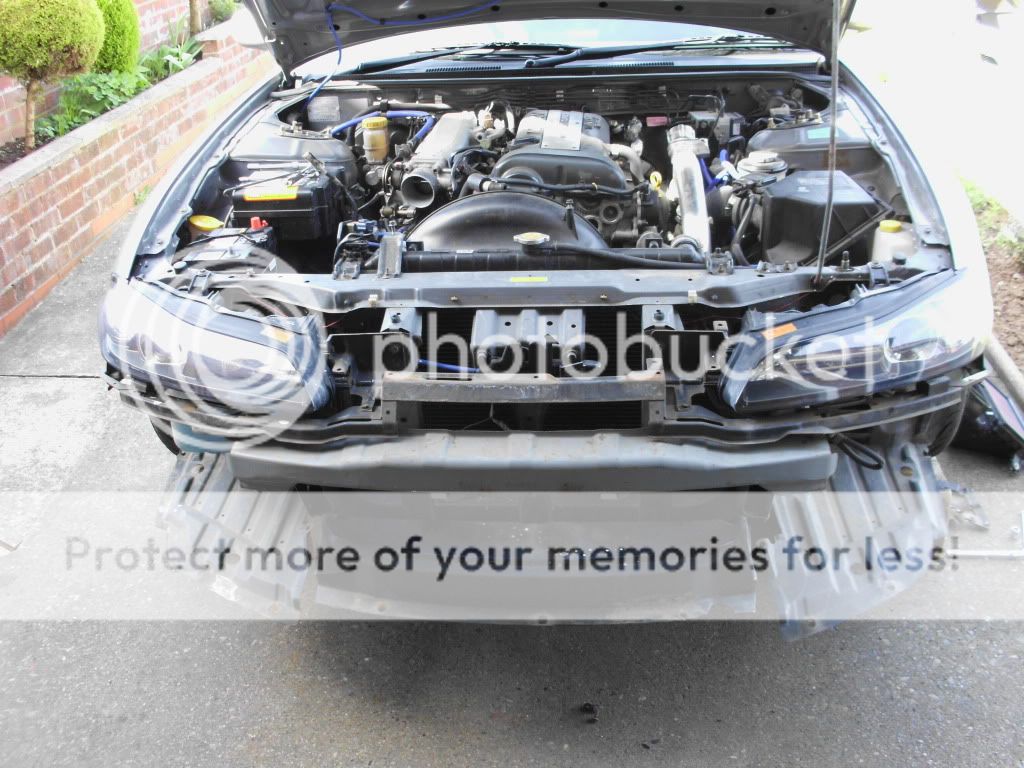

Fitted an Apex type 1 FMIC

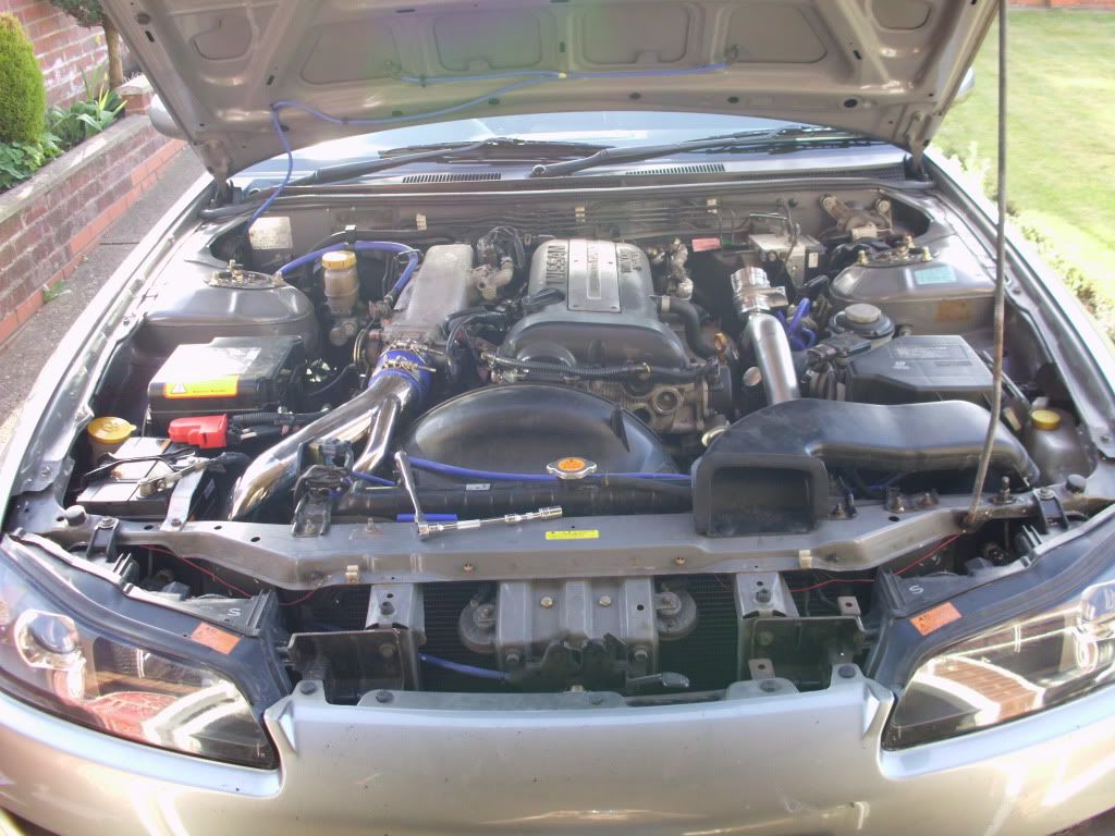

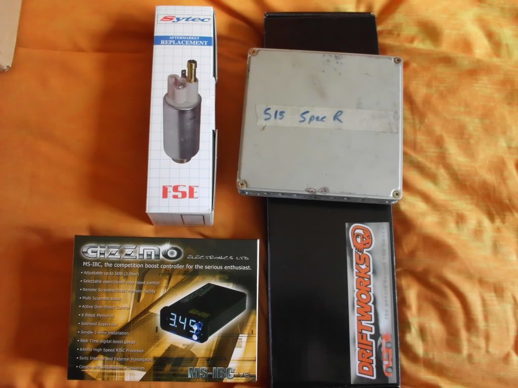

Bought a Walbro, stock ECU with Horsham chip, Gizzmo and tension arms
Then fitted everything (except tension arms which are still in the box :eek:) and took it miles down south to Horsham to let Jez do a live map. Had the Gizzmo set to 0.7 and 1.1bar running nice and reliable (fingers crossed!), to get 1.2 i'll need a better actuator to keep it stable. Very happy with the map so far (not dyno tested yet) except the boost, i can give it half throttle and still hit 1.1bar which i dont want, it kicks in too soon without my foot being planted. I hear i need to lower the gain but i dont want to damage anything.

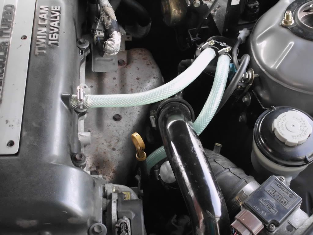

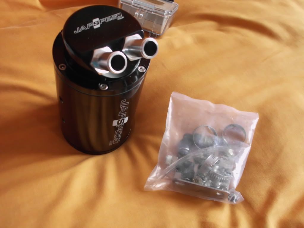

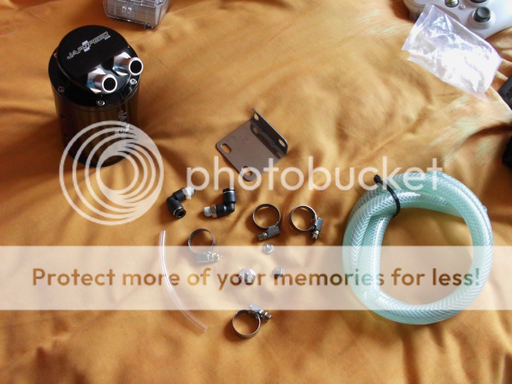

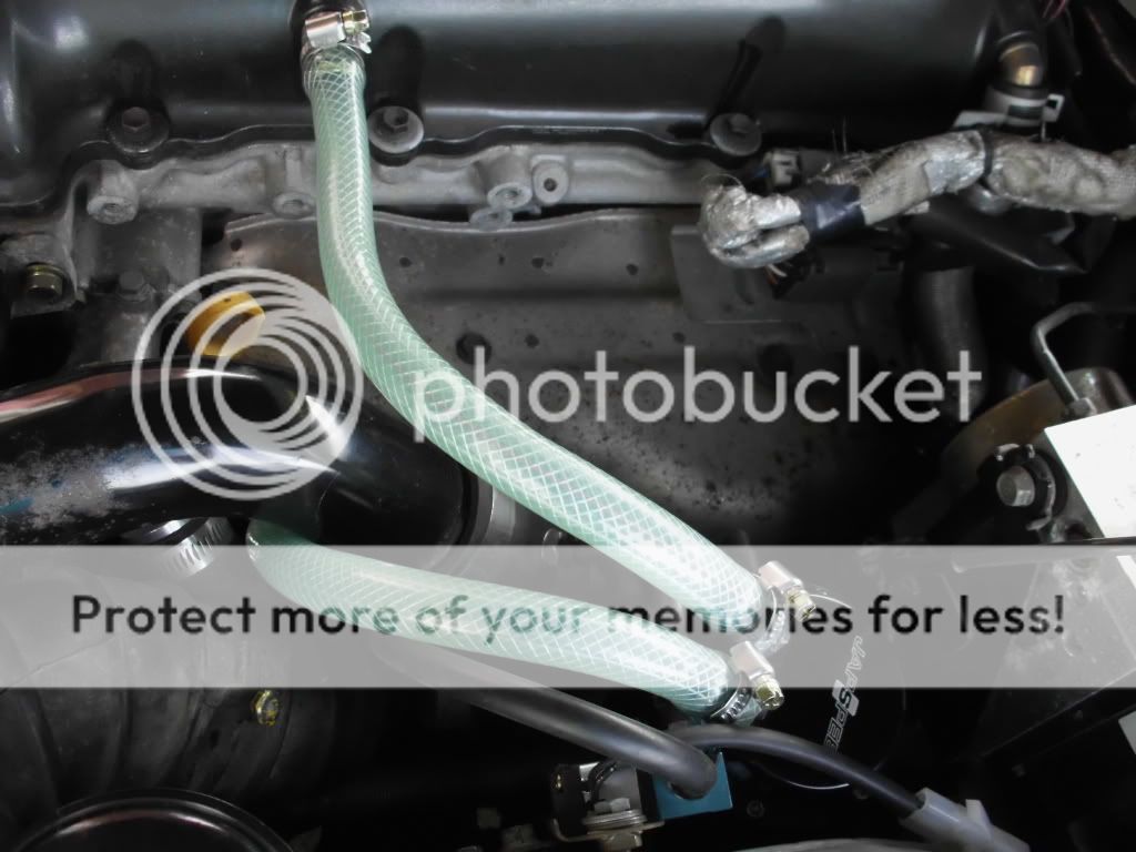

Yesterday i got an oil catch tank from Japspeed so put that on
and thats about it for my car as i'm very happy with it :D

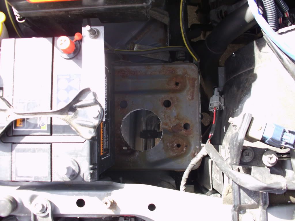

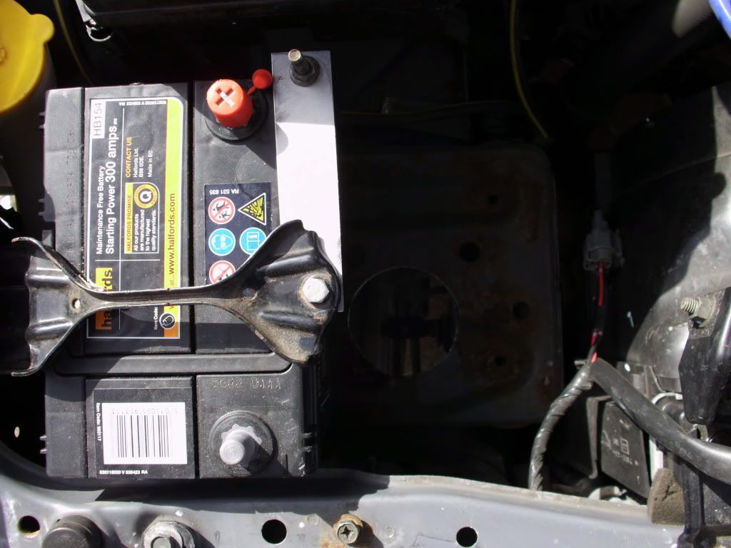

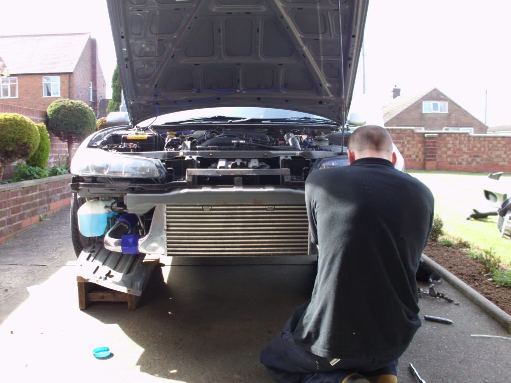

As above looks well mate,what did you use to cut the battery tray? I am about to fit my fmic.Like what you have done though looks good,how do you rate the coilies??
11 February 2010
101
Mansfield
Thanks chaps :)
I just used a holesaw, think it was around 80mm. I've done 4 so far and another when the chap in the photos buys a FMIC :wack: so the teeth are chipping away now! Also forgot to mention all the bare metal was covered with a rust primer and ran a bit of vacuum hose around the battery tray hole.
The BC's aren't bad for the money, monkey metal c spanners so can be a pain to alter if they've been used. Ride wise they're quite good, i soften them by about 10 clicks for the road and stiffen back up for track if i remember, teeth shakers on the roads :D

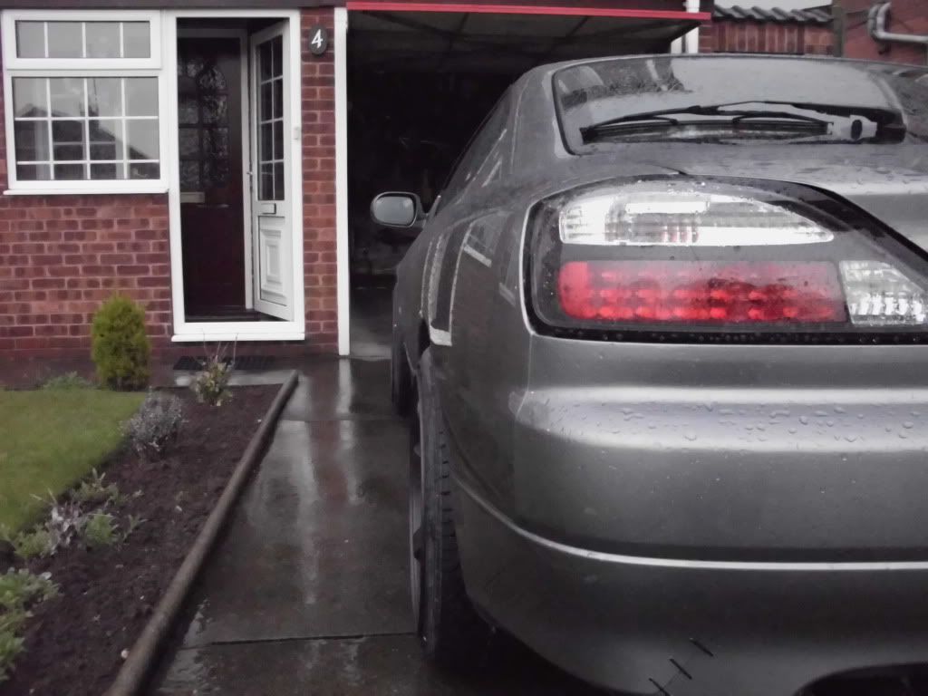

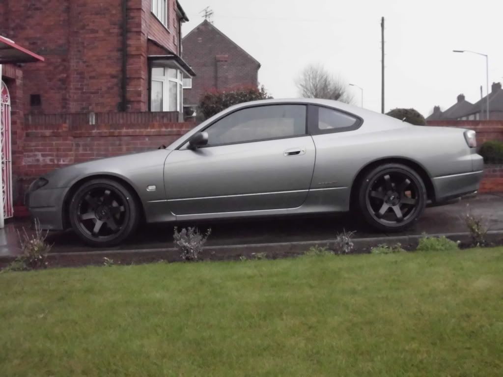

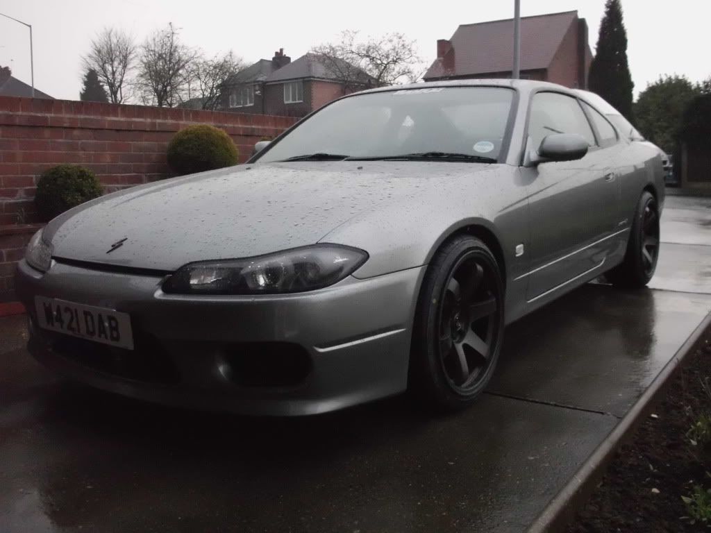

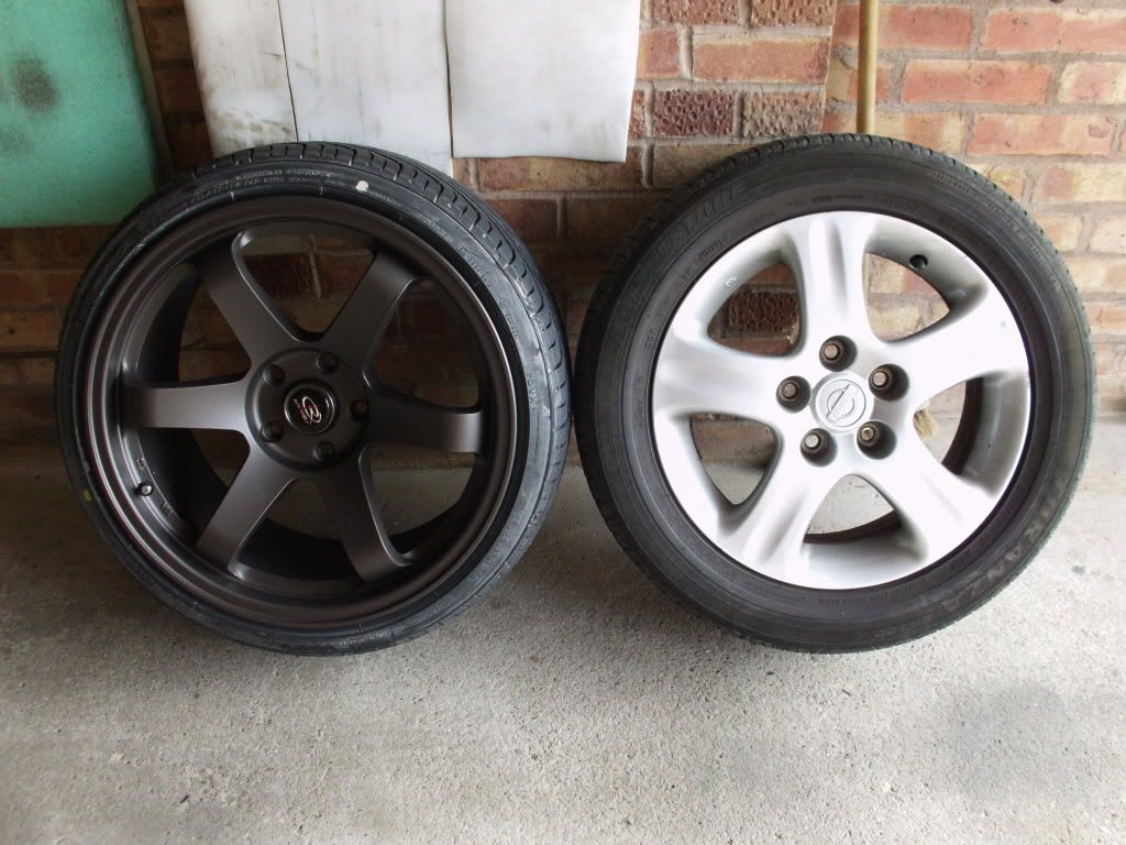

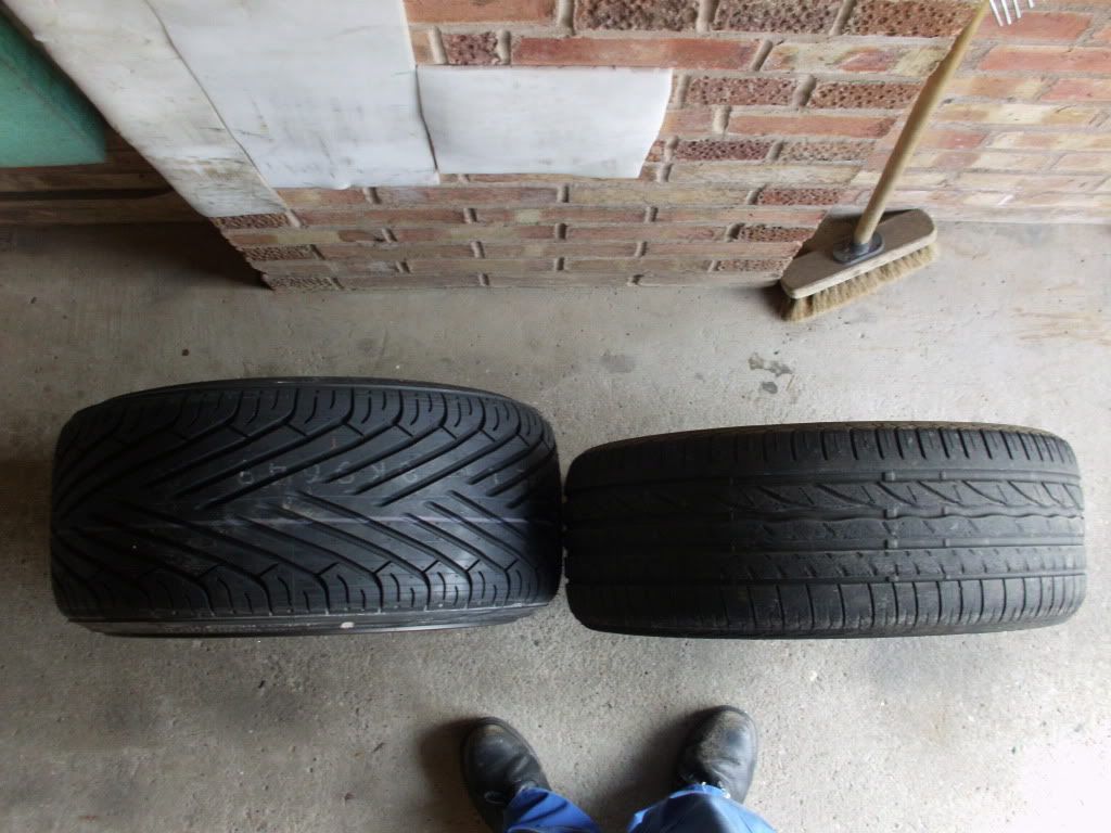

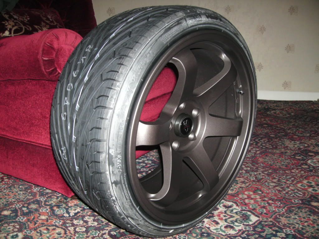

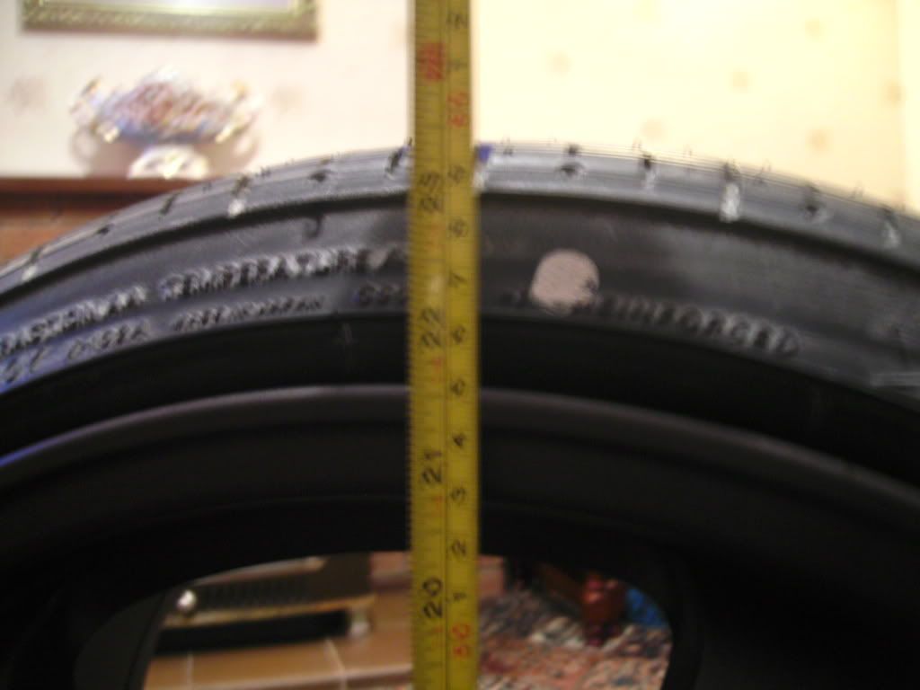

Wheels are 18x9.5 et35 with 5mm spacers and 235/35 tyres, needed to slightly file the calipers to miss the spokes.

Wish mine had the built in sat nav tbh.

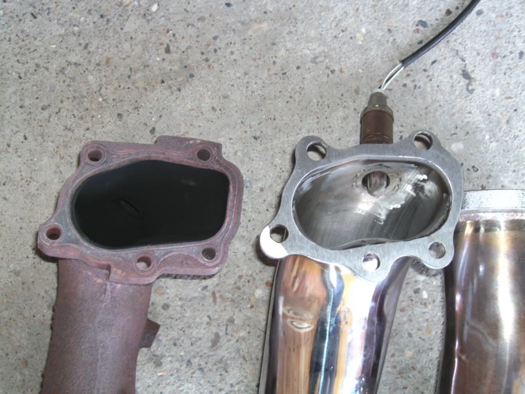

The Apex front pipe you have, is that the s14a one? I was planning on ordering one from RHD japan or somewhere but since these have a flexi section I might go for one of these.
11 February 2010
101
Mansfield
Thanks chap, there are loads of photos kicking about of stuff getting done but a few times i forgot to get the camera out :wack: I had it all undersealed when i 1st bought the car but have lost all the pics :down:
Yes its an S14 pipe mate, but with it having the flexi on the bottom it has scraped at some point. I've seen some with the flexi on the front but im not sure where to get them from, alternative if your running low is Japspeeds or Driftworks Low Rider downpipe but these have no flexi pipe.

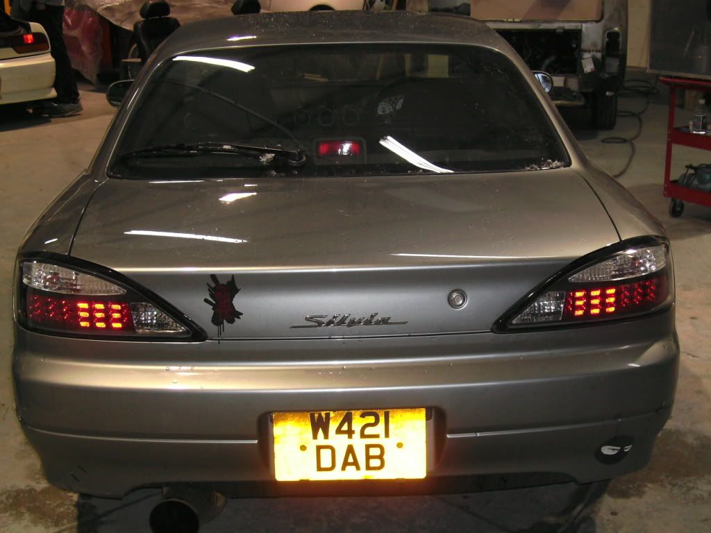

Looks nice, would look better without the stickers dotted about though but just my opinion.
11 February 2010
101
Mansfield
I know what ya mean, i have some lifestyler mates who stick everything on their cars especially if it says 'drift', not that they can. I should get some recent photos as they're gone apart from 2 friends company stickers and a DW on the rear screen.
Nobody has spotted the extremely poor paintwork around the fuel filler yet! However i'll do a few more skid days then its having a going over top and bottom
