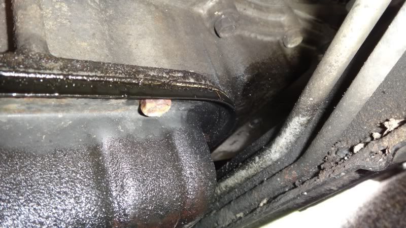

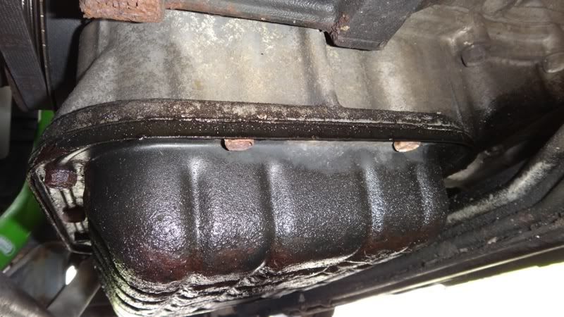

I dont think its my sump thats got a leak. It looks like it could just be dribble from my turbo leak, not 100% sure yet, will have to fix the turbo leak first to see.
heres some photos:
You can see the oil going to the right more towards the rear of the engine -->

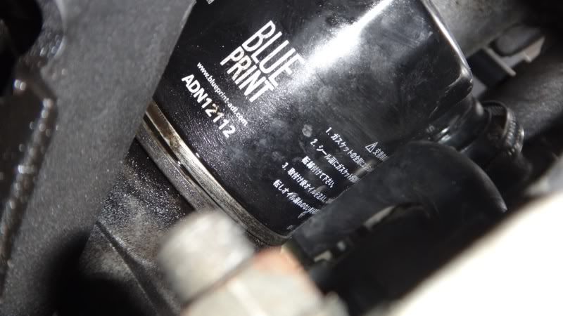

Also, is this worth worrying about? its only a tiny bit round the seal, checked the filter and it seems tight enough..
