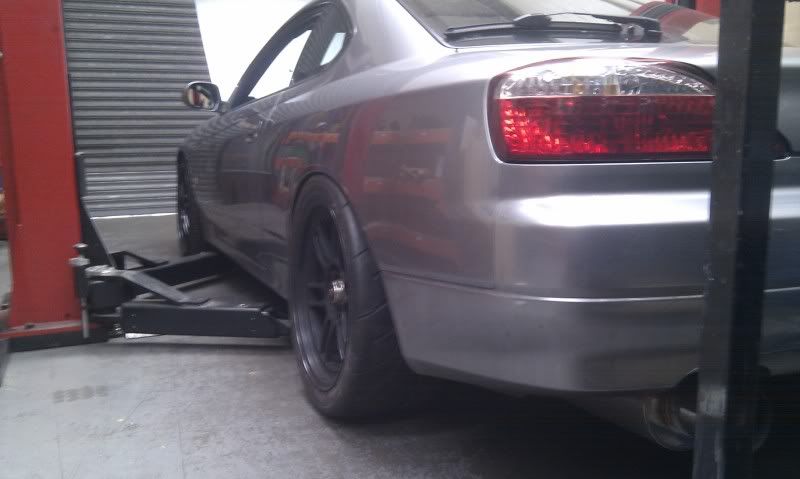

I ran
front 18x9 et20 225/35 tyre
rear 18x9.5 et45 265/35 tyre
The car was very low and I never had scrubbing issues! I should add that my arches had been rolled, however.

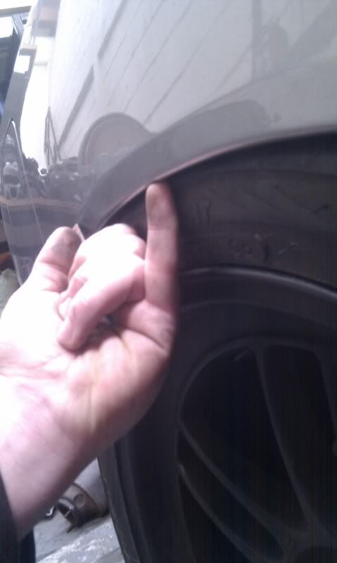

This was my rear arch gap, haha
