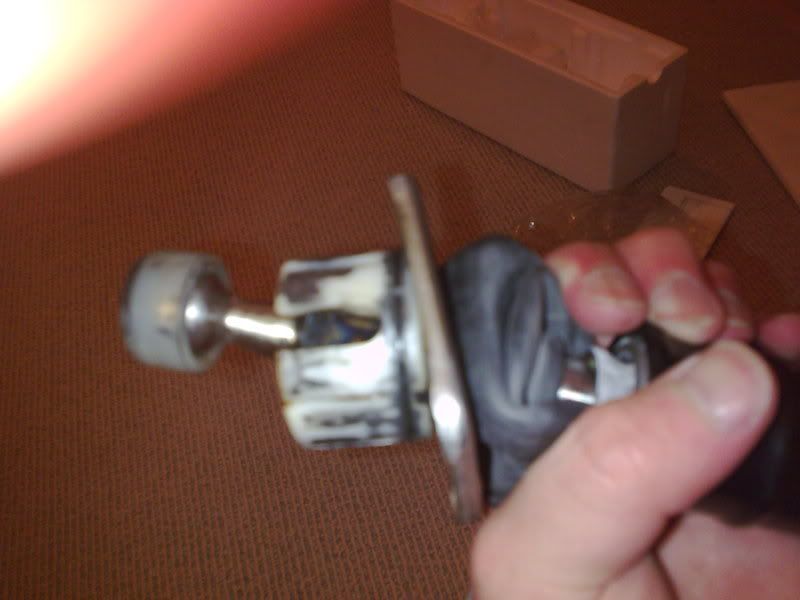

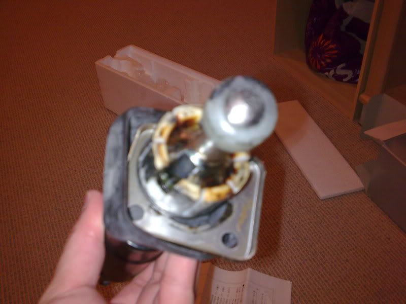

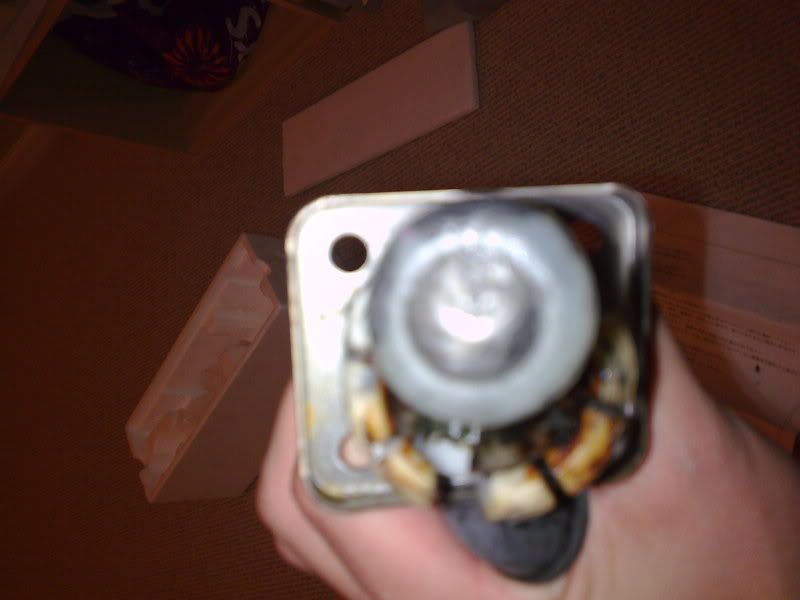

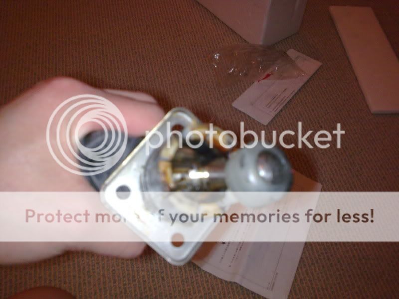

I never used the s15 6 speed before. this is my first time, I tried and my machenic tried to put in reverse, we couldnt get it in..and we had a loser look at the shifter, there is a slight damage to the housing, the gaps where the housing clip into the box has a little damage...so we thought it would be better off using factory ones...but because my bro has a spare altezza shifter so I just want to try and see if it fits in..if not I will have to hunt for the s15 ones..it will be hard finding here in NZ...
here are the photos..excuse my cell phone photo..:eek:

since the housing is broken you can easily slip it off and i can see that there are two 'slots' on either side of the pivot ball which may sit the whole thing in the s15 shifter housing ok, but you have the problem of not having a retaining "ring" to hold the thing in place.
there shouldn't be a reason why a s15 short shifter wouldn't let you go into reverse, try give it more force! momentum works really well too! i assume it's installed already because trying to get into reverse when the gearbox is sitting on the floor is a bit of a challenge especially if you haven't used one before
