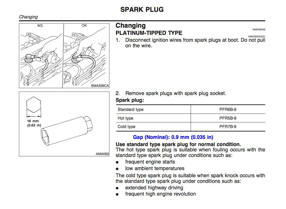

From the S15 service manual:
Thus, mine are 0.9mm.... but mine are platinum tipped, not iridium.
