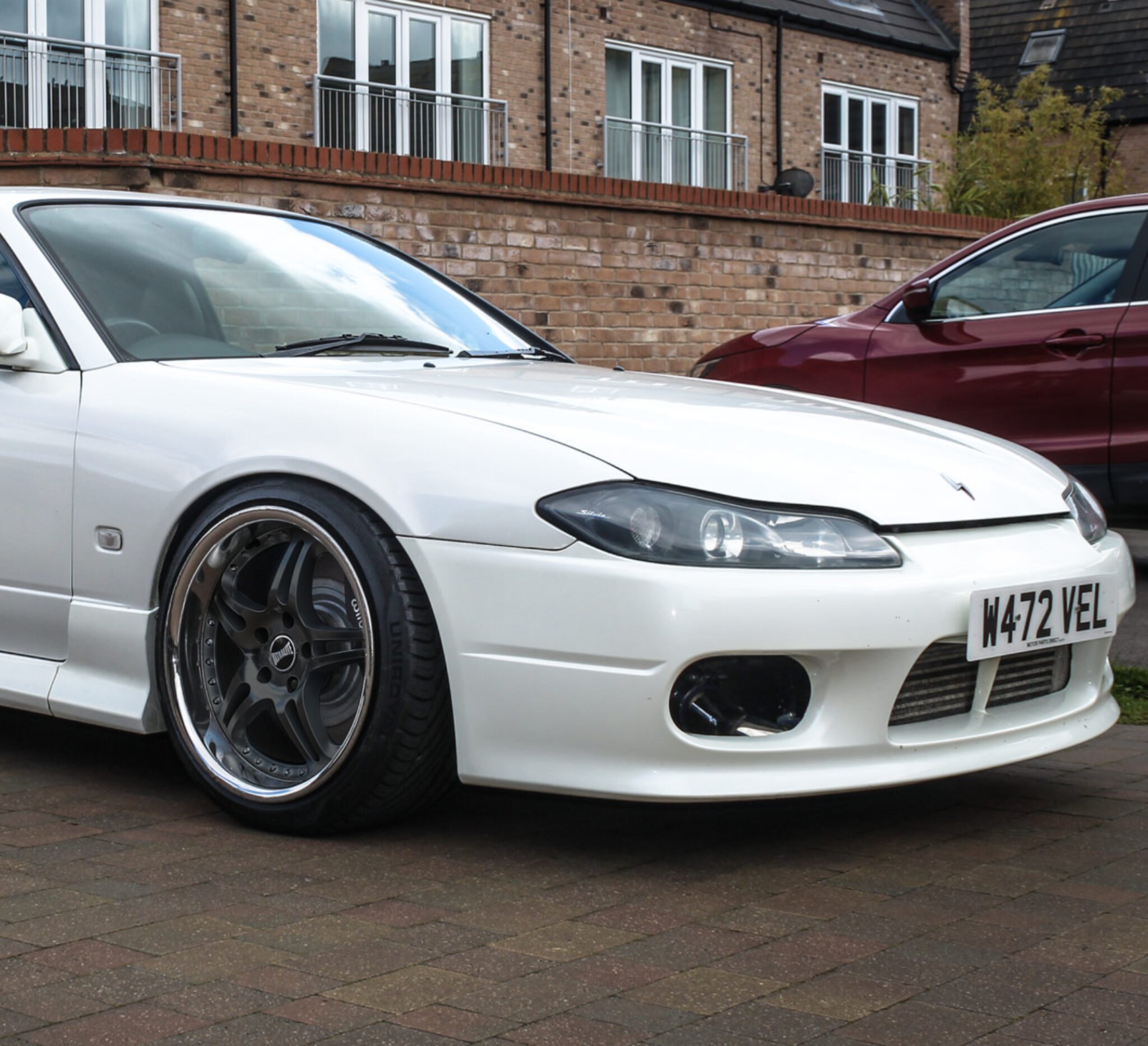

Im not 100% sure on the front wheel fitment, at certain angles they push out too far at other it looks fine, they are 18 9.5" et10 (with spacers) which I've read fit fine with 3º of camber but not sure myself....perhaps slightly narrower spacers might be a solution

Agree on the front wheels, bit aggressive for the stock front arches. Bet you can't wait to drive it!

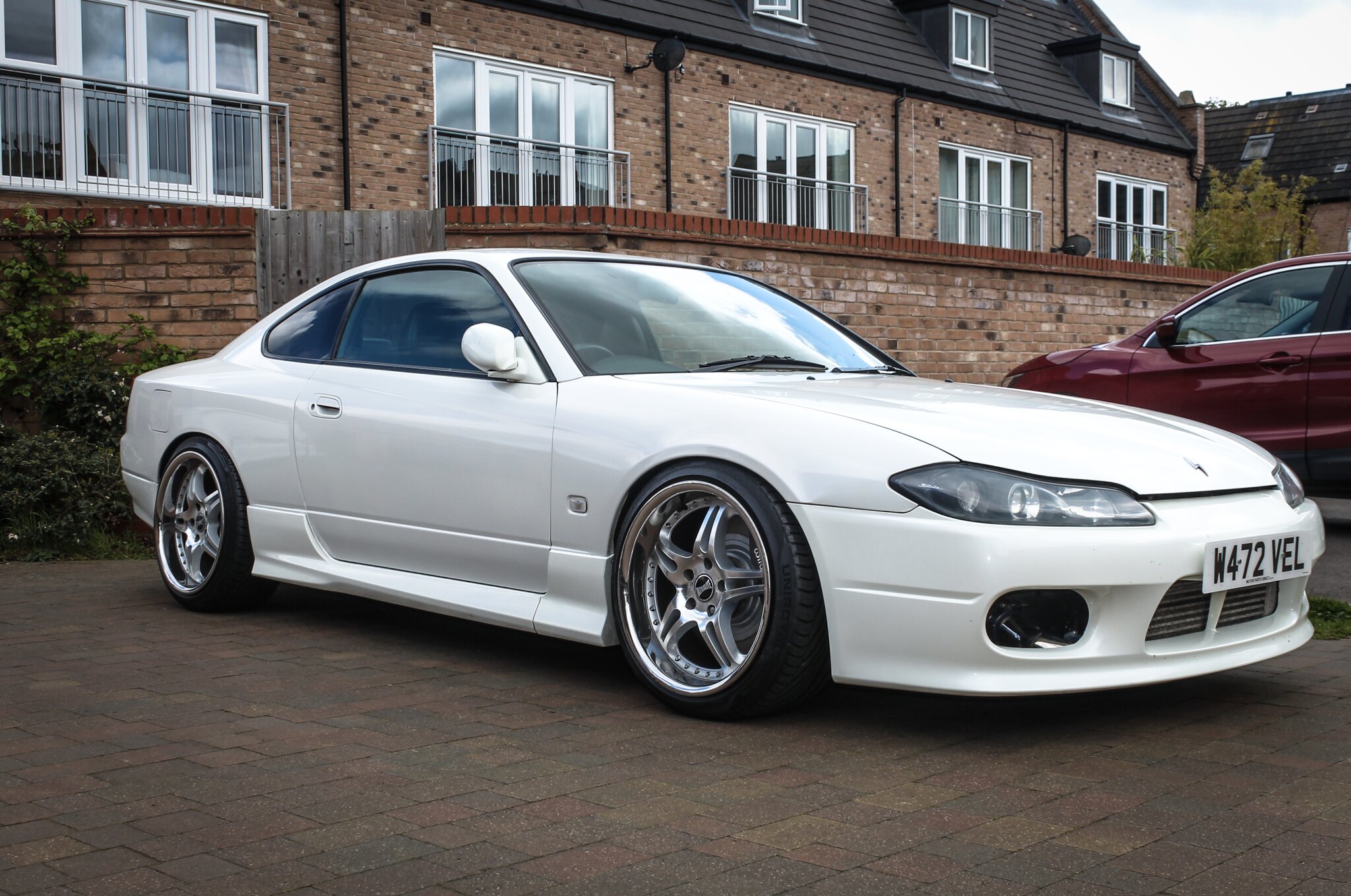

I am governed by the wheels, on my 14 they sat perfectly the S15 doesn't have quite as much room, the distance between the wheel and the shock is around 8 - 10mm so i don't have a lot to play with :S ideally i would like to run a 9" but I simply don't have the money to go buying new wheels at the moment, but when i do i want to get rid of the spacers.
Plus I am sure the weak fitment on the rear ..i had to remove the spacer is making the front look worse than it is.
PLUS i think once the skirts go on it should also help...possibly..maybe.
But yeah i am looking forward to driving it :)

Done a lot in the weekend. Not a big fan of the wheels to be honest. Bit too vip for me Personally. Is the exhaust from a 14? Sticks out a lot
Nissan Silvia Spec R Aero S15

The exhaust is from a 14, may cut and shut it at some point at the moment it's more "function over form"
The are wheels are marmite.

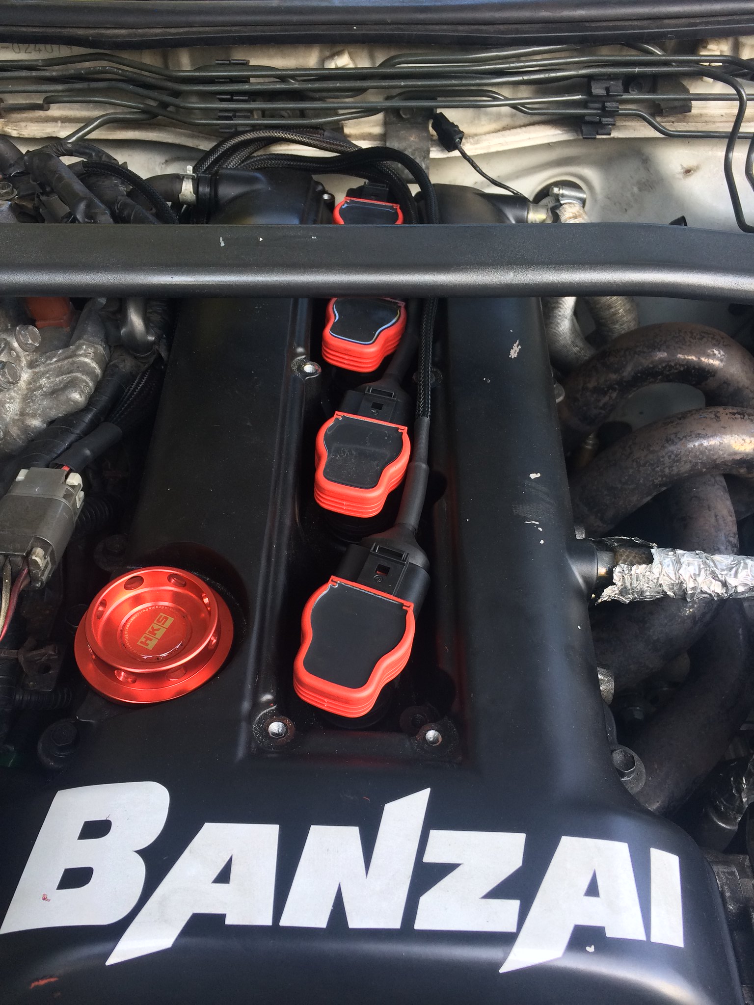

also did a R8 VAG coil pack conversion too

Absolutely right about front lip...as for rear spats I'm not actually too sure about them tbh.

Nice work mate.
I actually quite like the wheels and fitment which is odd as I'm not normally a fan of ultralights:)

Cheers Chris, 8 years ago they were ok, now well, they aren't lol
however i do not like staggered fit, square all the way.
so as a temporary measure been thinking:
whilst i decide which ones to go for, i painted my mates wheels with cans and they came out really well, so for the sake of an afternoon.

How much did the coil-pack conversion cost all in? Mines picked up an intermittent misfire which i suspect is the plugs on the way out.
