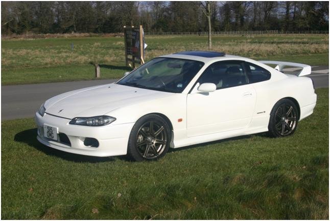

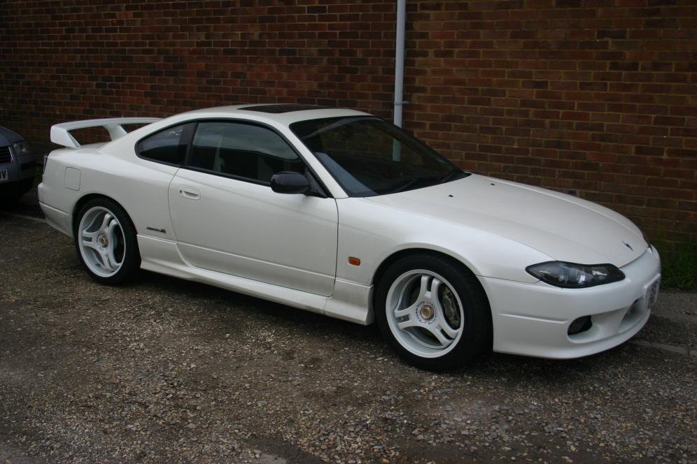

I got the car off Lynny up in Doncaster in November 2010 when I was 20.
I never thought I would be that bothered by having a sun roof but I love it.
In tuning and modifying I’m now going by the principle ‘do it once, do it properly’ approach. Why waste time and money a second time.
Car when it was imported in 2009 by Torque GT, starting UK life with Lynny for a year and a bit.
(picture of standard white S15 that doesnt want to upload, probably my fauly)
It had very few things needing doing to it when I got it. Some paint was peeling on the roof but that is really about it. All that wasn’t standard was a 5Zigen cat-back, Blitz filter and Splitfires, and a horrible rear bumper that didn’t last long. Managed to transport a new front and rear bumper in the car, with a passenger, with the bumpers poking ou tof the sunroof and boot at the same time. Only have to drive about 300 miles that day. Wished I took a photo!

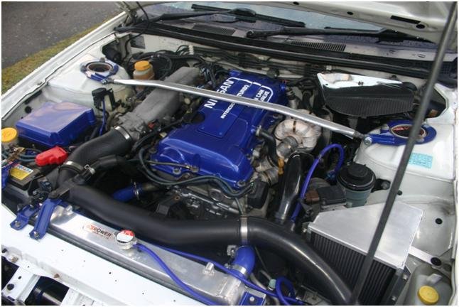

Engine bay started as this, with a leaky front crank seal
Much better now
5Zigen exhaust had rusted through so I swapped it for a Blitz Nur Spec RX, wrapped Apex downpipe, and wrapped SIS?? Elbow and manifold (whoever they are made by they are cracking quality as Fasthands can attest to, comparable to his Tomei J Braided oil and water lines while I’m at it too. That seems to be my big excuse for buying more things.
To complete the exhaust system I have a sports-cat waiting to go in when I get a wideband + boss welded in.
Induction wise, the ARC type box looks great and I have a GReddy intercooler to fit once I get some custom piping sorted for it as it is going in upside down. At that point I will try and knock up a cold air intake out of fibreglass once the old boost piping is out of the way, plus fit the HKS adjustable actuator I also have waiting for a boost increase.

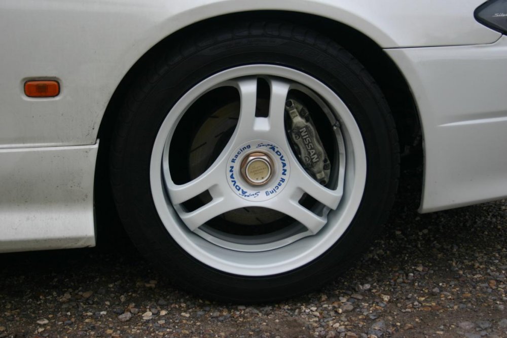

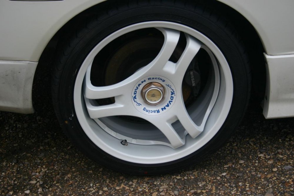

As you might see here, front brakes swapped with refurbed R32 GTR Non V-Spec (296mm) and rears from an R34 GTT (297mm) with an R33 GTST BMC. Braided lines all round. Very good net result, much better than re-furbing rears (been there twice and didn’t go well for me)

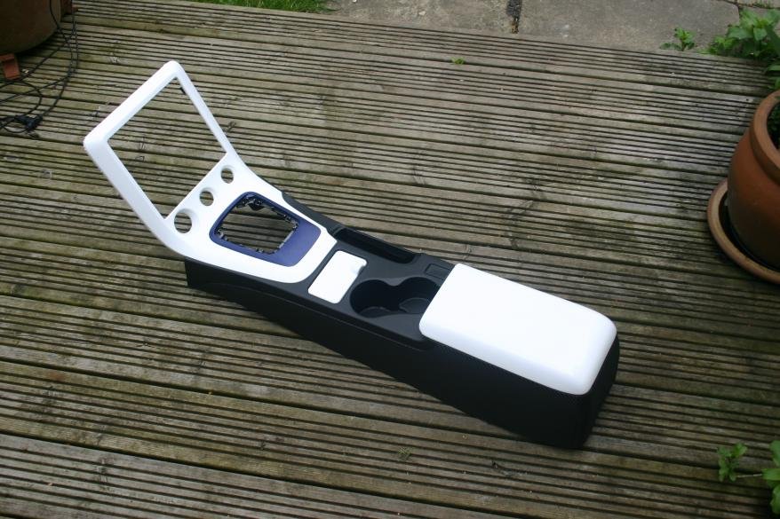

Decided to spruce up the interior some more. While I was in there I changed all the speakers, just have to get a decent UK double DIN Radio rather than keeping the Jap one.

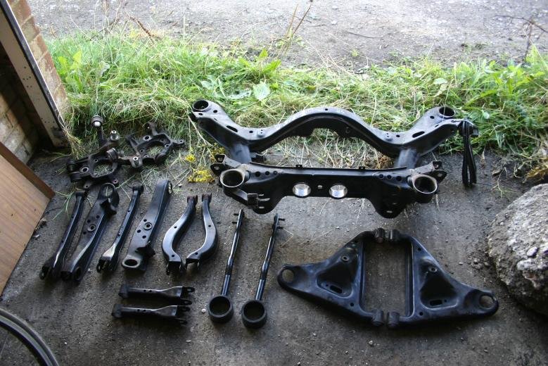

The main effort recently has been rust. Nothing too bad but prevention is better than cure!!! Sorted the front end and sills, rear end of the car to go. Using kurust, wire brushes, primer then wax oyl. It is all in the prep.
Next up in Sept, fit sports-cat + AEM wideband. Blast + powder coat replacement arms and subframe and get new energysuspension bushes in, I have their entire range of bushes waiting. At the same time fit the HKS Hipermax Performers that are on their way from Japan and have it all sorted locally. And ‘while I’m at it’ get a Depo 4-in-1 Oil temp, press, boost and volts gauge in too. Maybe HKS Adjustable Actuator at the same time too.

I was V lucky with the seats, but a bit annoyed that they weigh more than stock! Just subtle(ish) looks changes for now, and pretty low key mods in general. Try and keep the money pit in check that way!

They are just a bugger to keep clean now as I'm sure you understand.
Could have got a black finish behind the spokes but nevermind.
Terrified of kerbs now but who on here isn't!

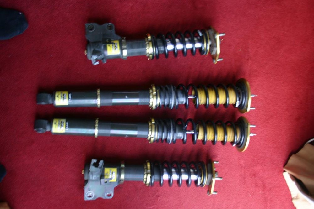

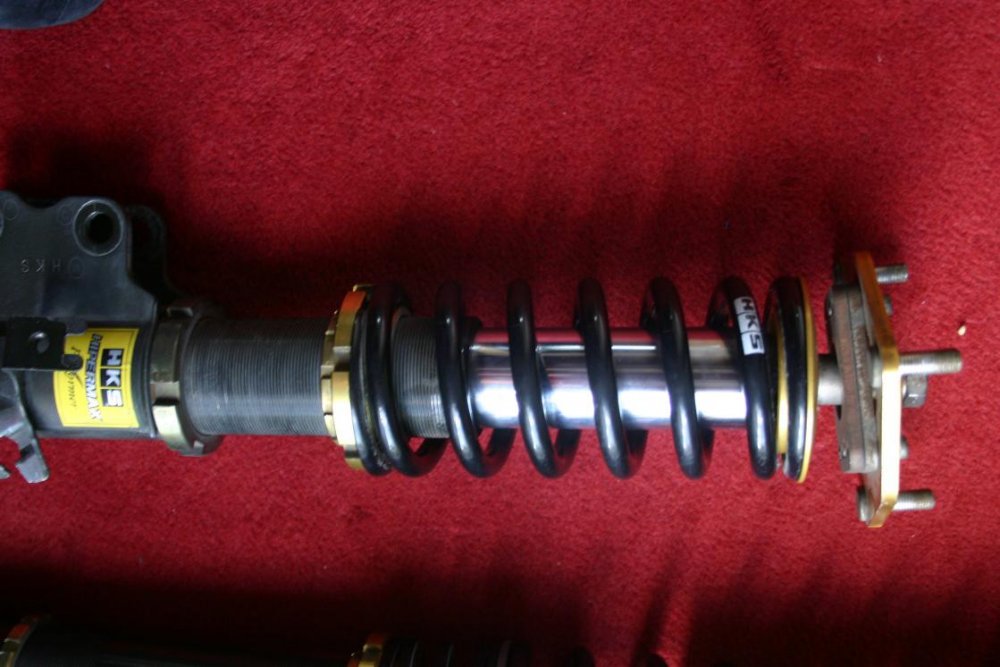

Still waiting for the HKS Coilys btw, so wont be doing the subframe change for 2 or 3 more weeks, then it can wing it's way to you.

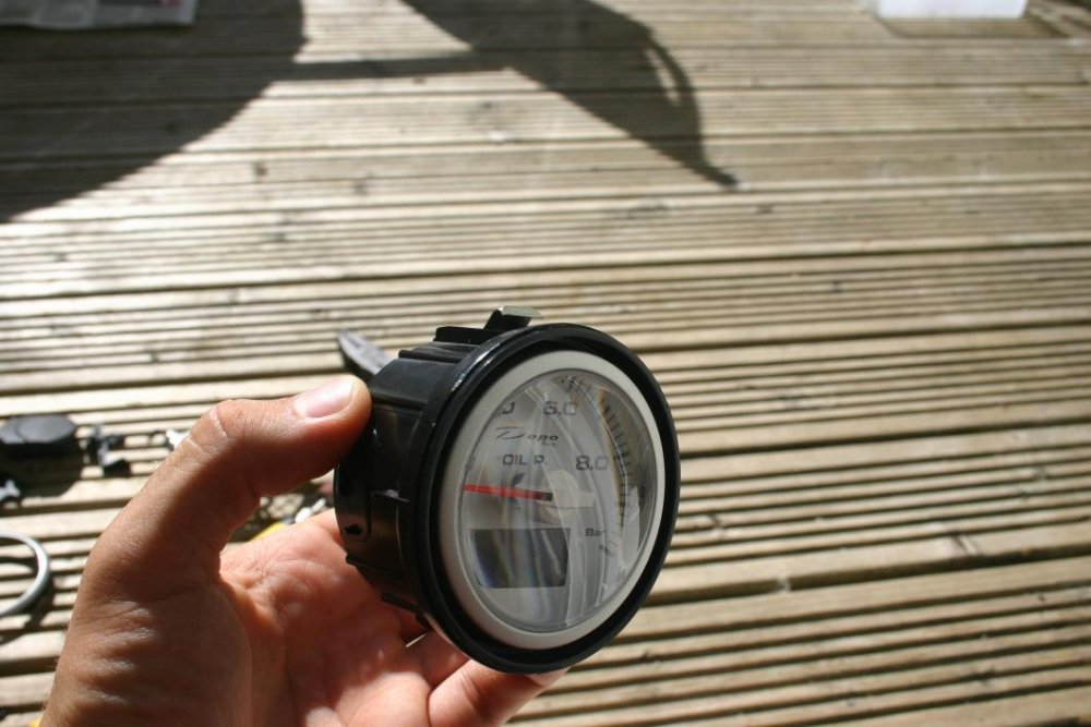

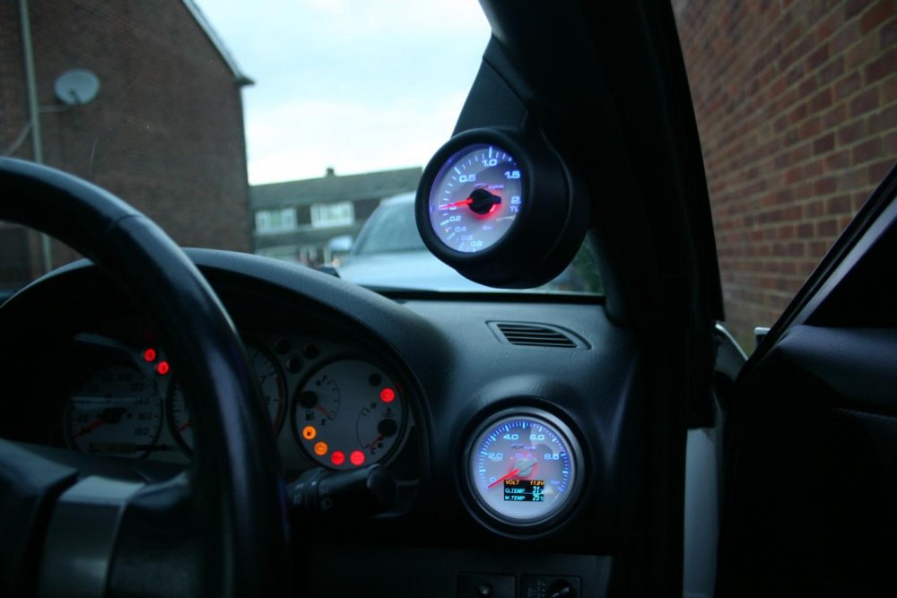

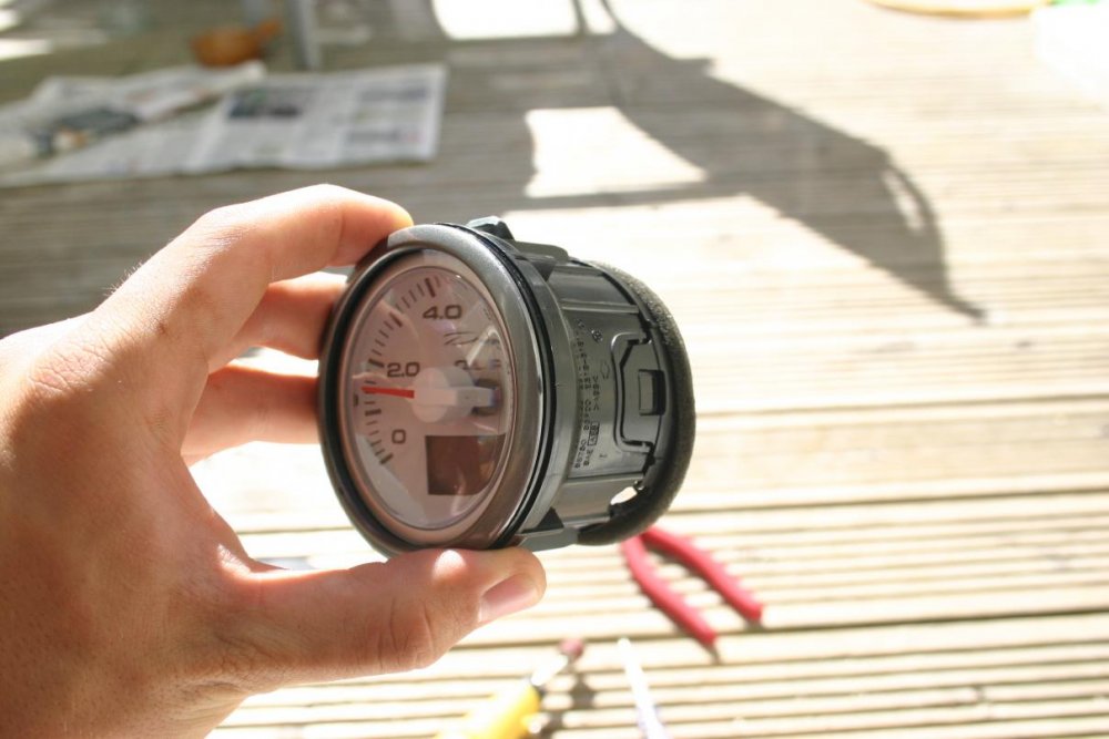

Quick update, Depo Gauges
I got a replacement Boost Gauge and also a 4 in 1 Oil pressure, oil temperature, water temp, and volts.
I plumped for the white background one to match the car :) and wasnt so keen on the smoked lens.
Quality looks really good, even though one came from ebay. Fortunately no additional cost at the borders either. I got a sandwich plate from prolex-uk's amazon shop but had a bit of a mare with oil leakage.

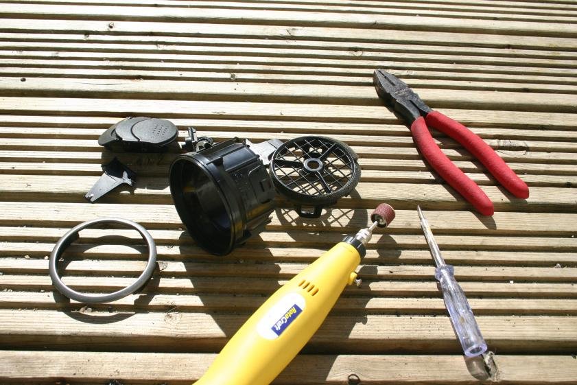

Pulled out the vent and took a dremel(esque) tool to it to keep the silver surround.
Re-assembled the vent and blocked up the rear just to make sure I keep pressure in the A/C system and not to heat/cool the gauge.

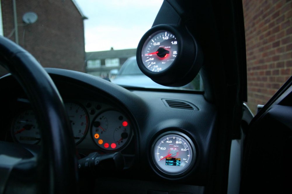

Fitted the press, temp one in the right hand dash vent and the boost where it belongs. You can get a 4 in 1 boost but I think it would be distracting.
You can choose blue or white back lighting by wiring it into the acc and parking light wires. For me blue when the lights are off, white when they are on, again, less distracting at night. Clever stuff to the un-initiated like me.
Wires to all the sensors get pushed through the main hole through the firewall infront of the fusebox in the driver's footwell. I'd recommend using some decent threadlock glue for all the plugs and sensors on the sandwich plate, one of mine was determined to leak.
I'm now a bit more ready for some more boost.

To go with all this that has been building up. Just need it blasted and coated before bushing

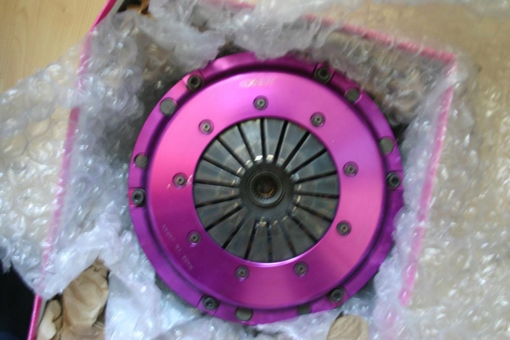

And got this for when mine goes bang. Exedy Hyper Single

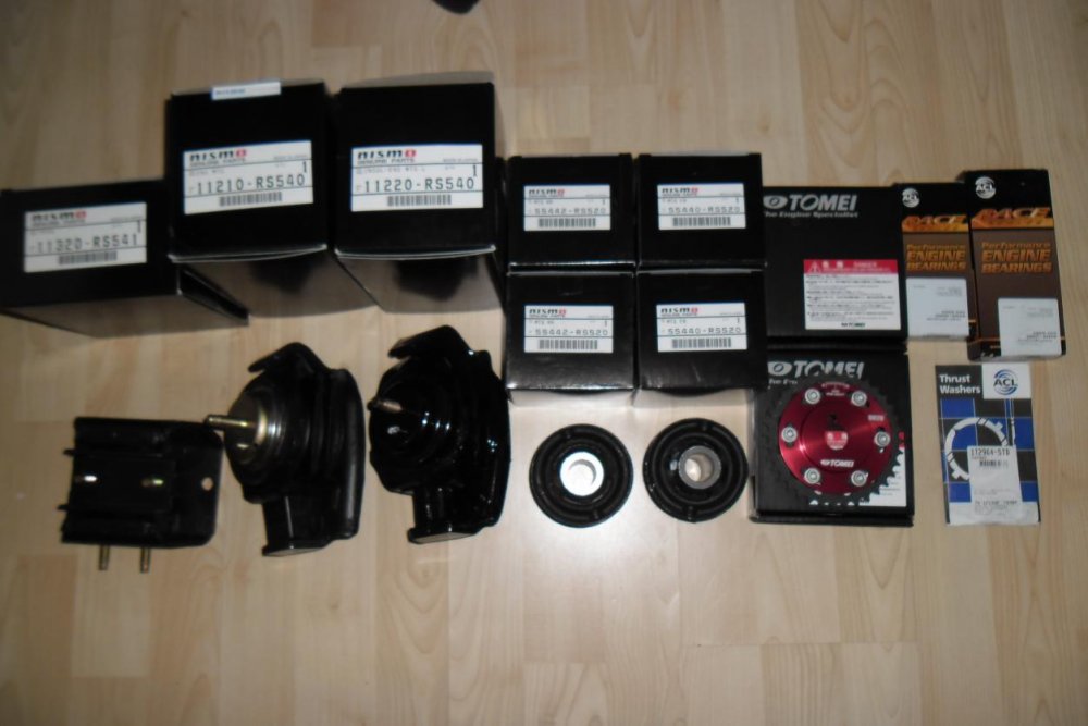

Time to elaborate on the build. Have spent the last few months researching what I need vs what I want for a VVL build. As the aim is to build a super daily as Mr Nissan could have/ should have made.

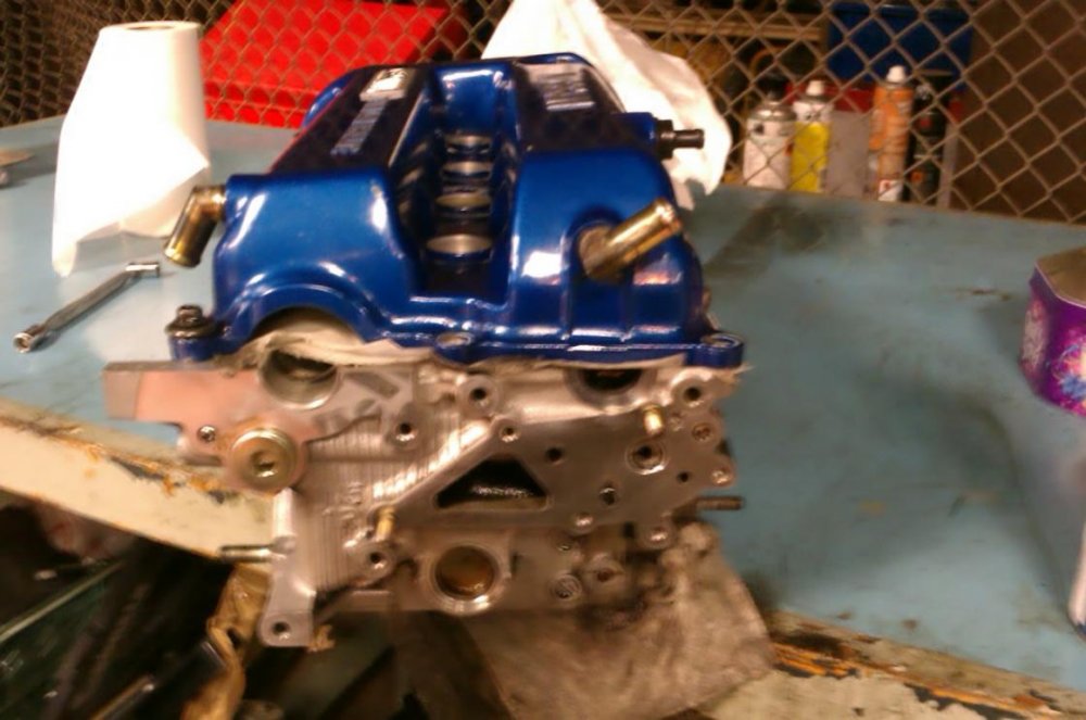

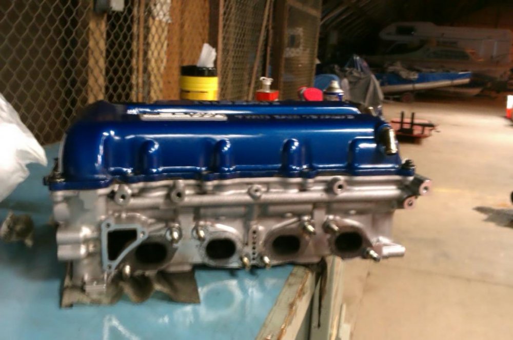

Here is the SR16VE head cleaned up.
It will be sent off next month to be properly skimmed + rebuilt. I had the inlet runners and a VE oil pump supplied with it fortunately as they are pretty difficult to get hold of, especially the runners.

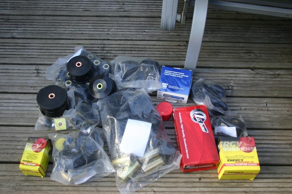

Here are the latest bits to arrive from JDM land. Should have a firm but comfortable ride. These will go with the HKS Hipermax Performers, Whiteline ARB's, and Energy Suspension everything else. The car will remain on standard arms but all newly powdercoated along with powdercoated subframe and knuckles. I'll lower as far as we can get away with on standard adjustment settings.

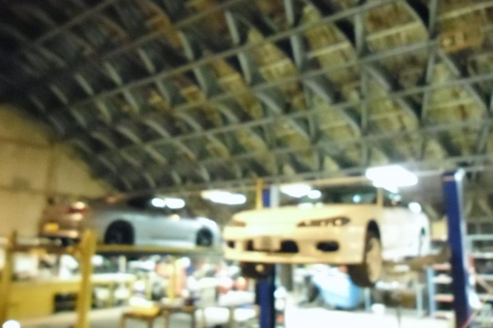

Here is the garage where the work will take place. I'd like to call it my garage but it is actually RAF Shawbury motor club. Best forces motor club by a long way. Air tools, welding gear, 2 + 4 post ramps, the list goes on and on.
Waiting for delivery of this lot from G-spec in the states:
Xcessive Plenum with IACV fitting
Pulley Spacer
SR16/20VE Gasket kit
Cometic Headgasket 1.5mm
Supertech Valve seals
Mazworx Solenoid Relocation Kit + lines
Mazworx Water neck kit
Mazworx RWD Oil pickup
Crank angle sensor from a Maxima (needs modding)
More EnergySuspension Poly grease
Piston ring set
ARP headstuds

Work that I will have to get done elsewhere should be the rebuild of the head, and skimming the block.
I'll have all the gear and parts and a friend with the knowledge to rebuild the rest but the VVL system is worth taking to an expert.
