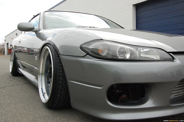

hi i started this thread just to know the exact experience of any of the guys here in the holy world of drifting
. i am actually trying to get 215/35r18 on 18x9 and thats much poke and stretch just to clear my fenders though im on big spacers. but can any one tell me that is it good for roughly driven drift car or you can say that daily driven drift car . there is no denying the fact that on tracks there will be no issue but on streets
. speed bump , breakers , reflectors or any other stupid things for lowered cars gonna definetly break the rims .. is it rite what i am thinking.
thats 215/35/18 18x9 dunlop

I ran 35 profile tyres on my old 206gti and I damaged so many rims by hitting potholes I got shot after 3 months. Was running 225/35/17. Personally I would drop lower than 40 especially with a lot of stretch like you're running. And if you're drifting it you're increasing the chances of the tyre coming off the rim with that size tyre on those rims

Could you not stay with 215 or even 225? I know stretch looks good and everything but it's nt the securest way of keeping the tyre on the rim as you can have a blow out where the seal breaks. I think most people who drift use quite a high side wall for this reason and also because the tyres are cheaper

If your drifting it you want more surface of the tyre in contact with the road for grip stretch looks good but too much stretch when your going lock to lock will rip tyre off
