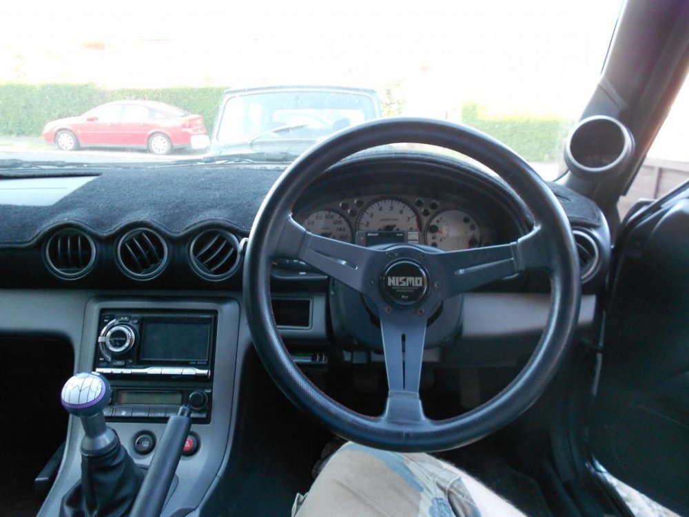

Just thought I'd do a little write up on changing the steering wheel, seeing as I've just done mine.

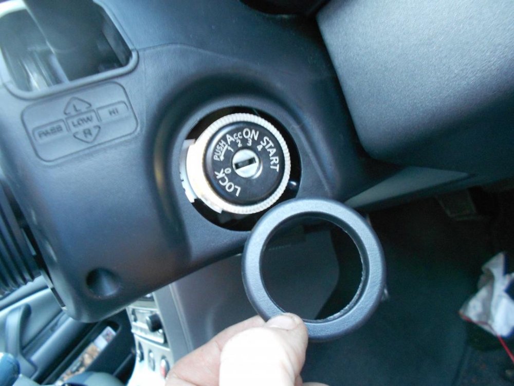

Once the steering wheel is off, remove the shroud from around the column. There are 5 screws on the bottom, and a little ring around the key hole holding it on.

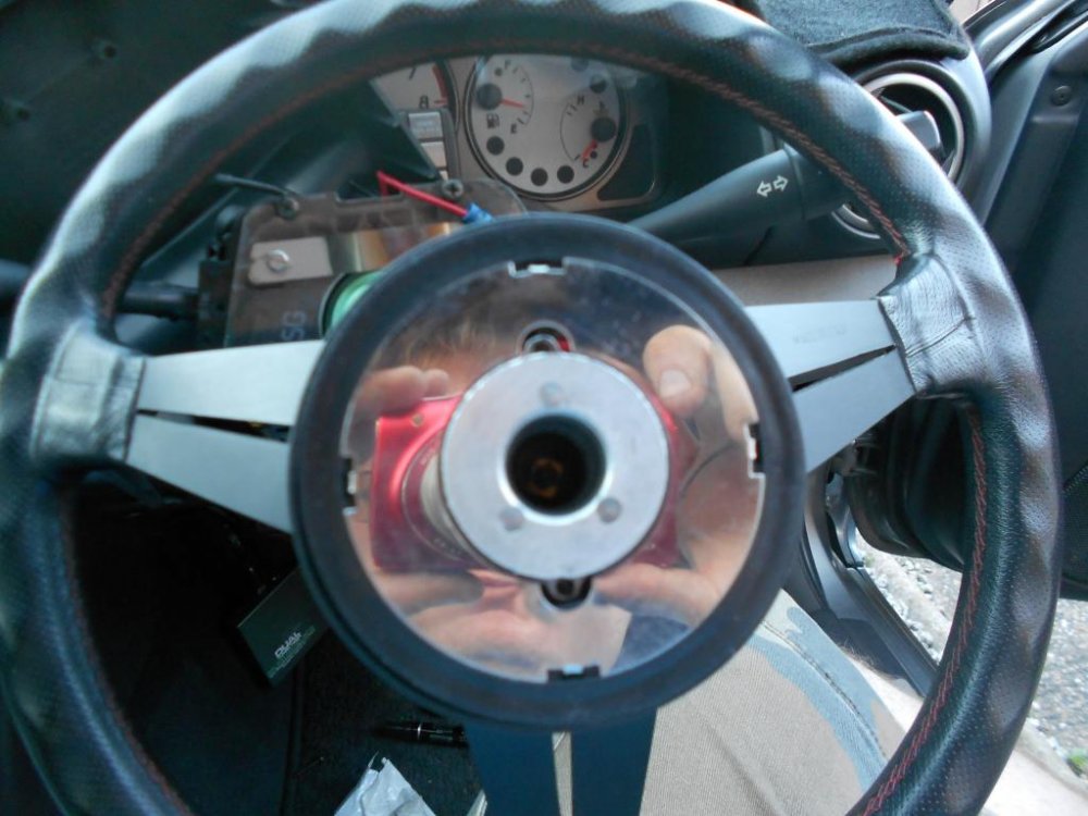

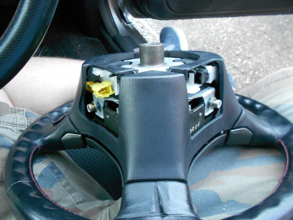

I didn't really want to for out a load of money on fancy boss kits with plug in bits for the airbag and indicator cancelling, when a cheaper on would do just as good a job with a little work.

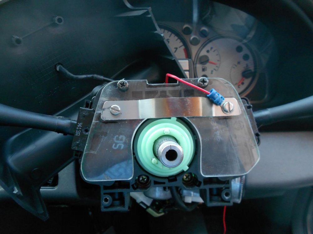

First job was to drill the little holes for the indicator cancelling bit to locate in. I used a little piece of clear plastic to trace the holes from the original steering wheel, the drilled them out and used this as a template to drill the new boss, which left it like this

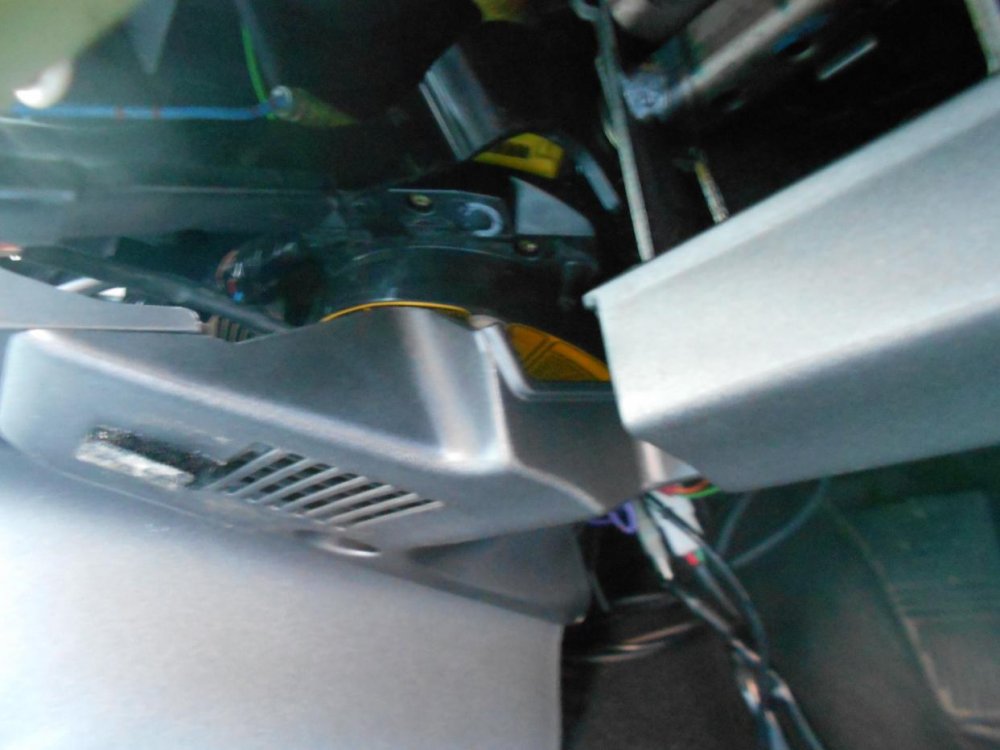

Next, the wiring side of things. I didn't want to do anything that wasn't reversible, so I took the spinny yellow disc thing and relocated it underneath the dash by your left knee, by the pocket bit.

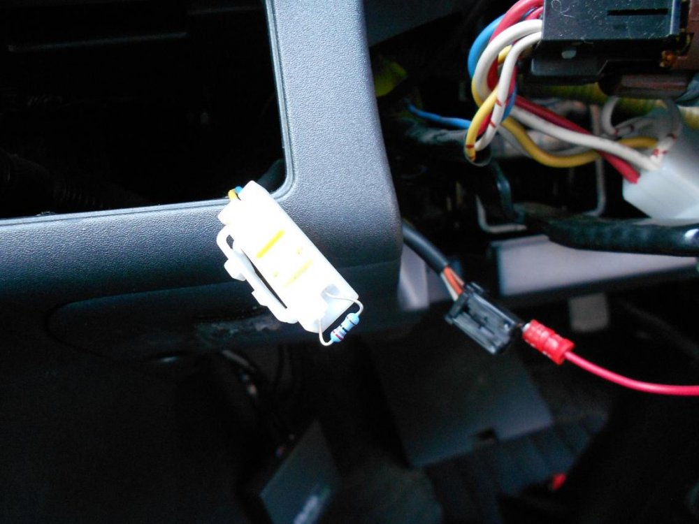

To stop the airbag light coming on, you need a 2.7 ohm resistor. It was 26p from Maplin, and was the main reason I didn't want to spend a load extra on fancy kits with special plugs, when the same result can be had for next to nothing. The tail ends of the resistor will push straight into the plug easily. The red wire is for the horn, and need plugging into the brown wire on the loom. I trimmed down a thin spade type connector I had to fit into the plug, so it is easily removed with no damage if required.
The wires reach over okay, and it also has easy access to the horn and airbag wires here by removing the pocket from the dash.
