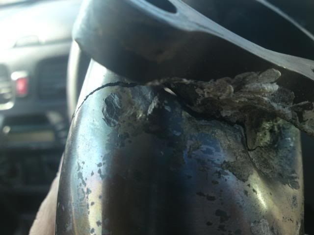

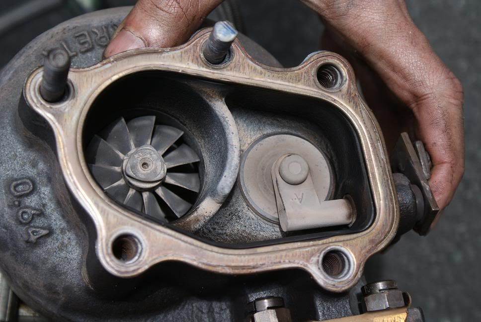

Dazz0i, the apex elbow did crack, its a piece of sh*t!
There is a load of exhaust putty in that pic from a temp fix while I was waiting for the new elbow and gaskets but damn... you can still see the 6 inch gash so get the point anyway! What a piece of crap.
I was in a rush to get a new one because I couldn't have my car off the road. Noone had any in stock, I ordered a trust one from apex but surprise surprise after telling me they had one I thought to cover my back I'd put a note in the "extra comments" box on the site about how urgently I needed one and I later got a phone call saying they're out of stock so they sent me an Apex one which is "just as good quality". yeah right....
I decided to redo the job lot after I found a few issues on the exhaust side of the car including this which someone had tried bodging back together before selling me the car *rolls eyes*
This in turn affected fuelling and EGT's which led to this:
Which in turn led to me replacing the exhaust side with new parts to cure several issues I came across I wasn't happy with:
Anywho... Back to topic.
Mint, yeah you can take a grinder to the stud but as mentioned, make sure you put a nut on and wind it down the stud before you grind it so that that way once short enough you can remove the nut from the stud and it'll make its own thread :)
The only thing is, in order to do this you need to take the turbo off. It's not a bad job, I can have the manifold and turbo off the car in under an hour on my driveway at home with about 6 tools lol. Remove your elbow and front pipe as one piece if it wont separate... ie. unbolt it from the cat and from the tubi then drop it out the bottom of the car and try the old WD-40 and wire brush trick, if there's still no luck use a blow torch followed by worst case scenario of a grinder if you cant undo the 3 down pipe bolts and you may aswell fit braided hoses while you're there...

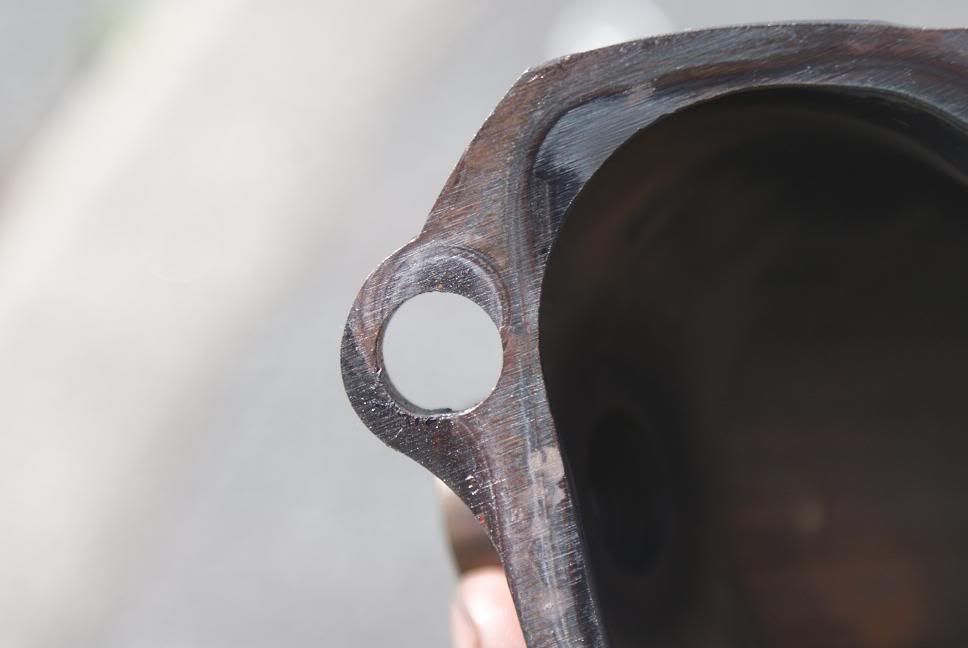

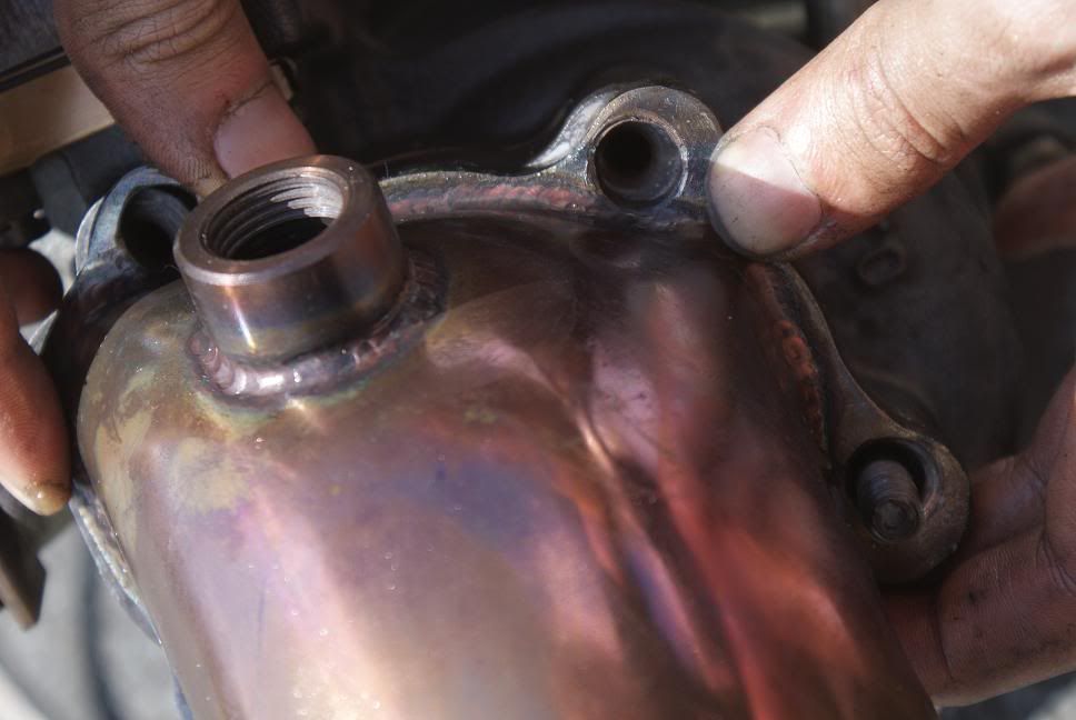

The apex stuff is SH*T though, more examples (four bolt holes lined up, one is erm... not):
Even if you elongate the hole to allow you to actually fit a stud/bolt. The bolt head/nut will foul on the housing of the elbow itself rendering it completely f*cking pointless. Cowboys IMO :( complete gash and not the good variety either :ghey:
If you need any help or talking through anything on the removal/fitment side, just holla and I'll be happy to help.

Tilly sir.. good pics thanks for the help there chief!! :)

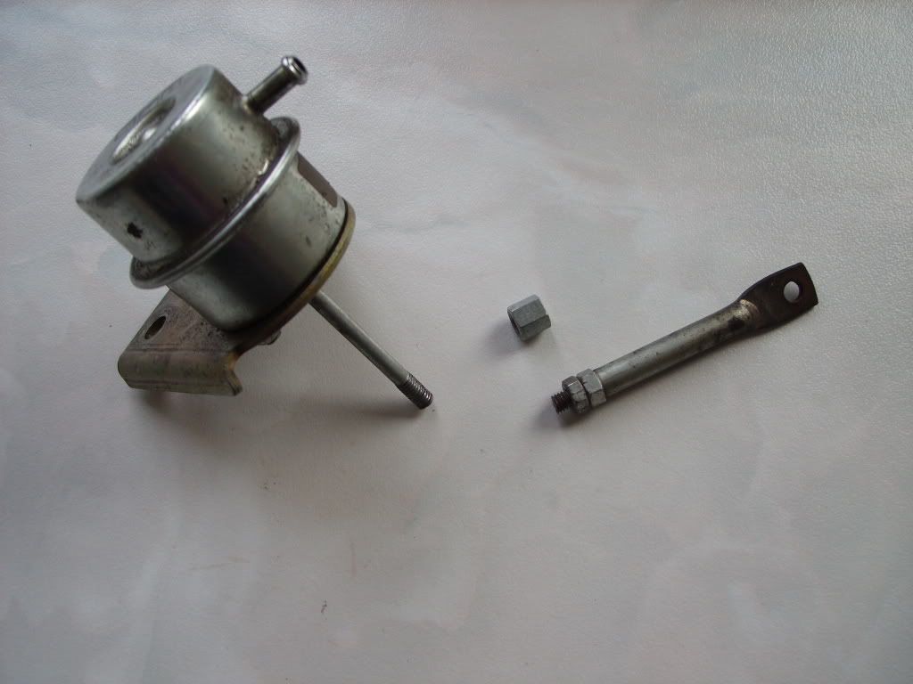

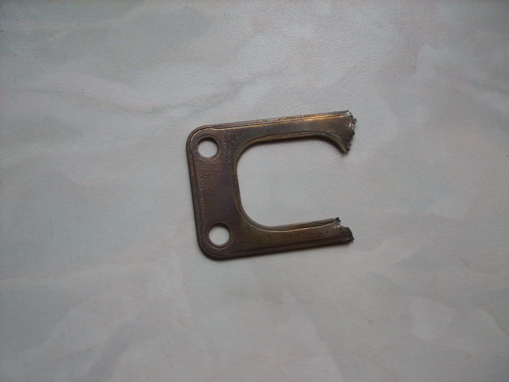

The compressor housing.. can this be adjusted to allow the elbow to rotate? I was told I could remove the turbo to rotate the housing so the elbow will sit straight with the rest of the piping.. does this make sence?
the exhaust housing is attached to the turbo by about 7 bolts - if you loosen these then you can spin the housing round a bit and then re-tighten the bolts. trouble is you cant move it much as the actuator arm will not line up properly....
i havent used the apex elbow as i heard it was crap, but the ths one has been on for ages now with no problems at all.....
StarletRick
i take it youre talking about the elbow on the compressor housing that goes to the hotpipe?
you dont need to spin the cartridge. the compressor housing is only held on my little plates and a rubber washer. loosten these, and itll spin however you like.
youll need to get the actuator mount sorted out though. which is a pain.
