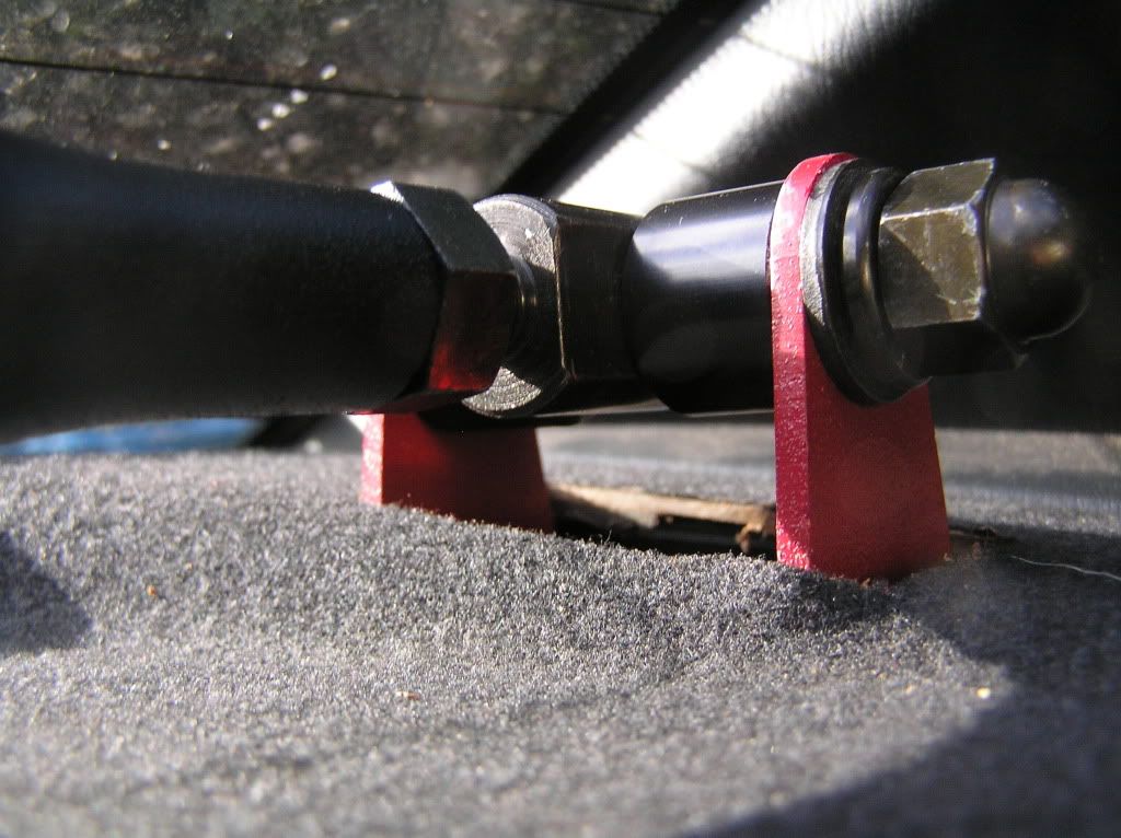

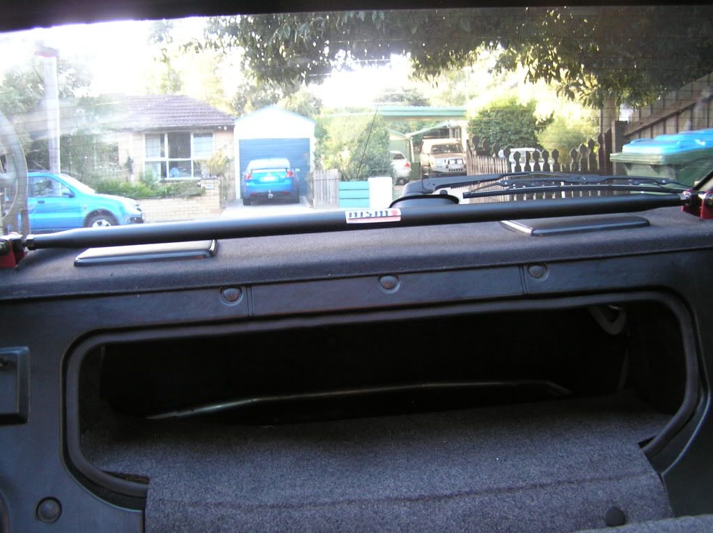

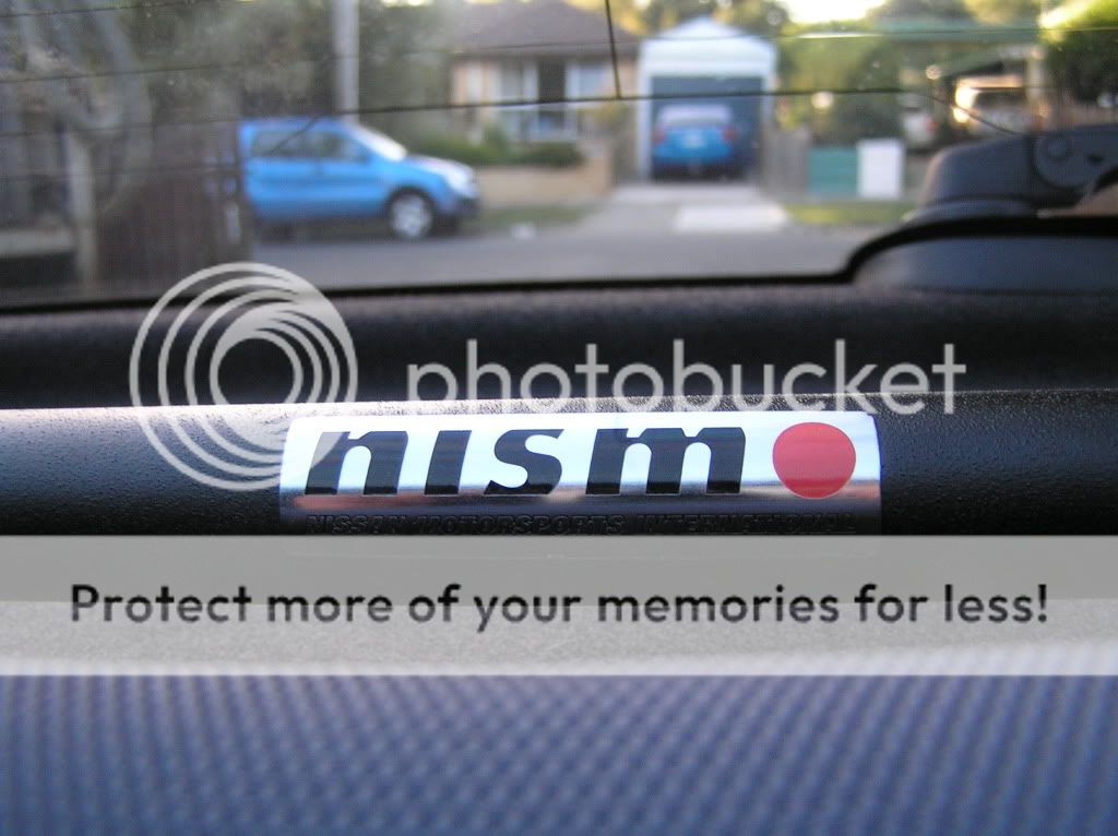

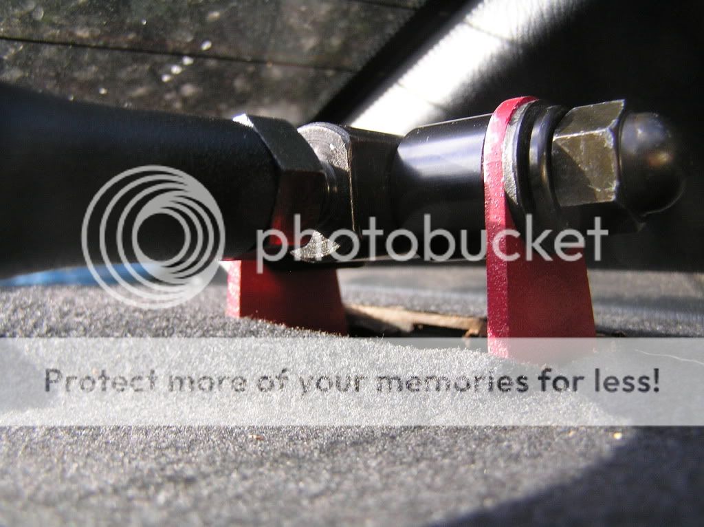

Got a hold of a used Nismo rear strut for a good price. Looked pretty shabby, but 'VHT roll bar & chassis paint' is magic stuff and it turned out like new. Some minor cutting of the parcel shelf board is required as this version sits above the parcel shelf.

Looks great, have you seen the Greddy undermount rear strut ?
I beleive I saw a user on hear with it, but I looked for months here in the US for it and Greddy had 1, just 1 in stock in the US.
SR2O
31 August 2006
124
Melbourne, Victoria
I actually had a Cusco rear strut brace that sits under the parcel shelf. Didn't like it because it blocks part of the boot access port, which sucks if you need to transport anything long.
T
tripleJs15
Great point, I didn't think about that, I never really put anything in the trunk!

S15 SILVIA
I've also got one of the nismo upper shelf braces, mines got little socks/covers on the ends of the brace.
Mike
I have the Cusco undershelf rear strut brace. It doesn't really make much difference, the boot in the S15 is so small above the fuel tank and if you were going to fold down the seat and put something through, the strut brace will more than likely not get in the way. The reason I chose this is I didn't want the strut brace above the parcel shelf.

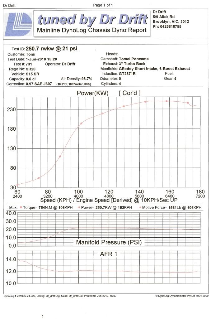

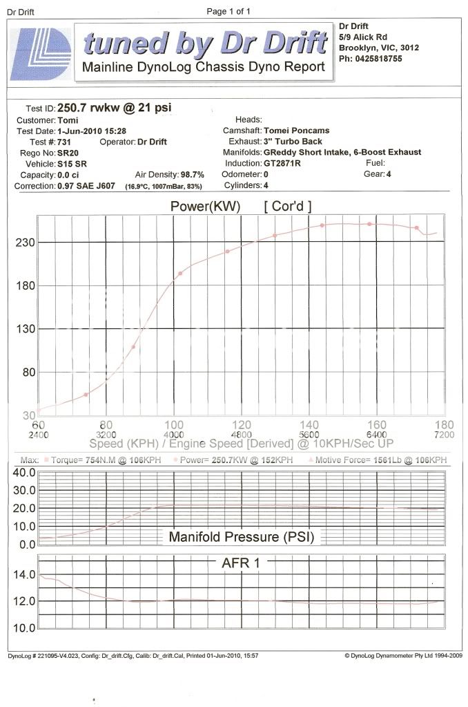

So I decided to go with a different approach with the ECU. Went from a PowerFC to Nisstune for various reasons. Below are the results, thanks to Sam (Dr Drift) for the excellent tune. The car has never driven better :)

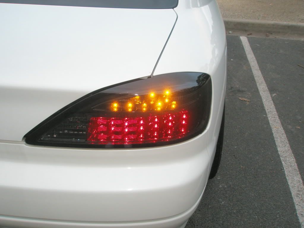

I like the Yashio LED's one which isn't tinted better...

Well done again mate, why the change from a power FC ? I know the answer I just need someone else to say it.
The stock S15 wheels won't fit due to my R33 GT-R Brembo conversion all round. You need a minimum of a 17" wheel, I could have gone with R34 GTT wheels, but they look crap in comparision to R34 GT-R wheels :p
Why change from the PowerFC? I'm not afraid to say it .. the PowerFC is complete rubbish :)
