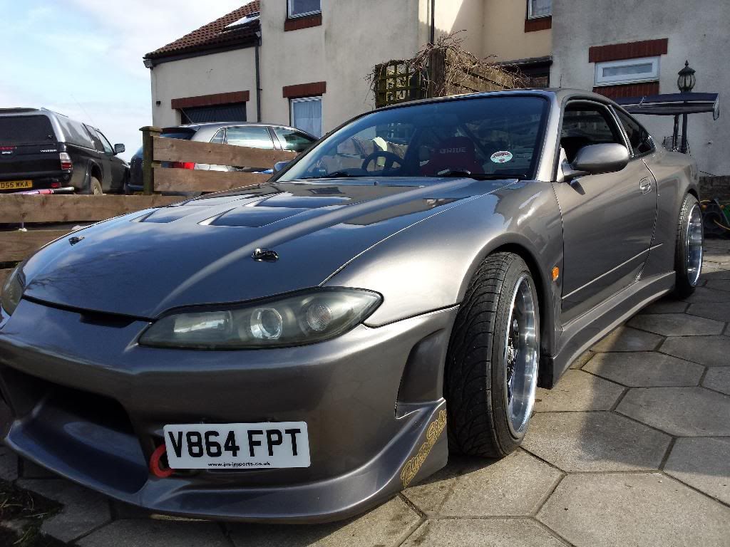

Yeah it's awkward with aftermarket front bumpers!
Either get them to tow you from the back, I had to when my diff broke.
Or get one of those towing hook straps and attach it to your front strut mount under you bonnet and then if they need to tow you they can pop your bonnet and connect it up safely!
