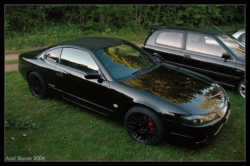

Wheels: BBS formula
Size: 8x17 all round
Offset: ET35
Tyres: F - Falken Fk451 215/45 R17, R - Hankook Ventus K102 255/40 R17
Spacers: none
Suspension: bridgestone Potenza damper for street
Comments: fits good. The wheels are equiped with central hub rings even though these wheels came stock on the S14a in Germany :confused:

How do they sit at the rear??
Where's the pictures :annoyed: :)
L
lj~R
It's just ok on the rear and may hit the arch if I lower the spring too much :eek:
Looks from those as though they stick out at the front and the rear, although the rear is very slight.
Look good though. Wish i could of kept mine :cry:
