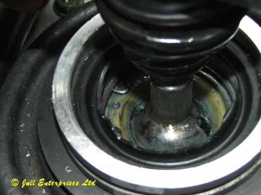

Hit a snag when doing this tonight.

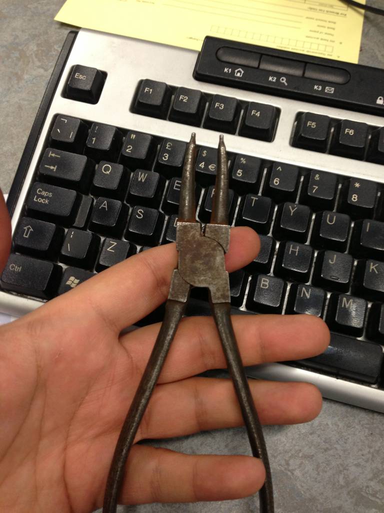

Couldn't get the retainer clip off with normal pliers. Also mine bizarrely didn't have any clips? Just had to pull it off. Well get someone tools tomorrow unless anyone has any suggestions.

I know. My own fault for trying to be a hero! Got the pliers now! Will try again tonight!

Circlip tool is wank and it won't lift off.... Given up time for a trip to APT :-(

Is that the bit I break off?
Nah, its a rubber boot thing. At the step your at you should have already done that. Yeah the circlip is a pain, I needed a hand as my circlip pliers were as equally poor as yours.
I used the pliers to pull the clip out of the recess. Then jammed a screwdriver in behind it to lever the clip out. Having a pal to help will be useful.

How do I get the rubber bit off? Practically impossible to grip!
21 May 2012
343
Stirling, Scotland
If your at the step in the photo you put up, you need to cut the rubber boot, you can see in the photo its been cut.
2 September 2012
180
Norwich
Yeh I've cut all the rubber. Just the rubber ring left like in the pic.

Sorted. Old shifter out. New problem though
How do I get this bush on the bottom?
2 September 2012
180
Norwich
Those bad boys had it off in an instant.

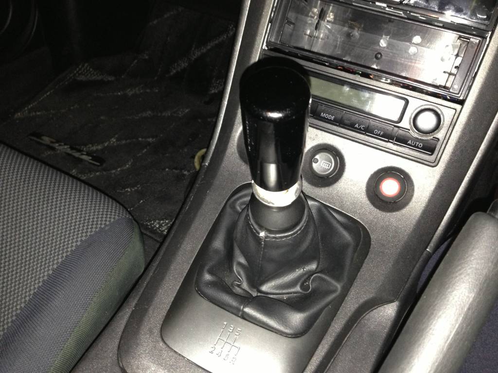

Feels quite nice and very tight, sits the same height as stock. Will test it out properly tomorrow. I'm expecting rattles....

Hello mate.
There's a bit more rattle but not as bad as expected. The shift feels a bit tighter through the gears.
Due to work and poor weather etc not really driven it hard enough to really tell.
