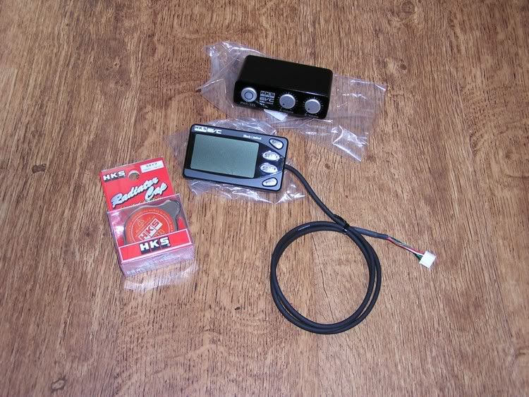

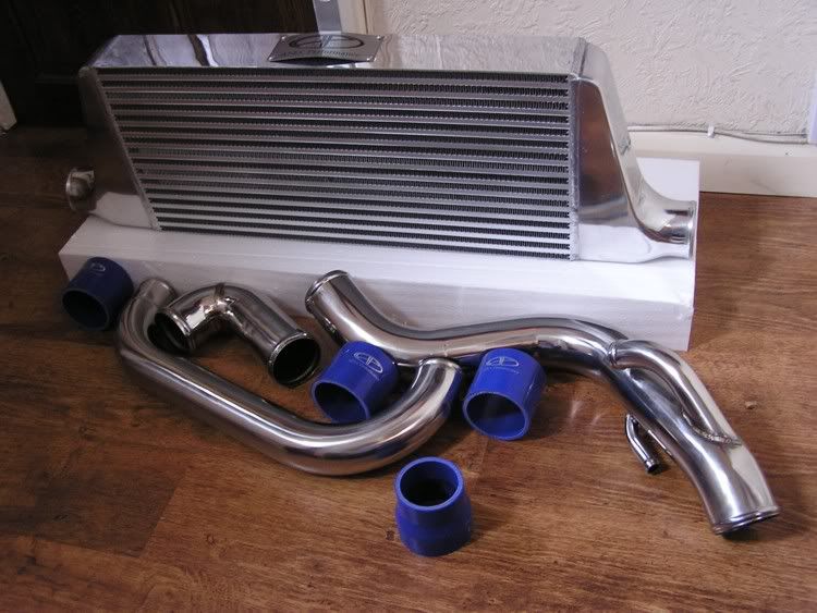

Thought i'd show you what i had delivered today :D
I went for the Apex type 1 in the end, big thanks to Apex for a great fast service :thumbs:
And a BIG BIG thanks to coordsport who did me a great deal on a HKS EVC 5 ltd edition black, HKS rad cap & HKS oil cap,
Thanks Gav :notworthy:
My techy friend is fitting my goodies in a couple of weeks time :D

Why did you get the Type 1? They're a right bugger to fit....
:rant: :rant: :rant: yes i know i've read the fitting instruction's :eek: :rotfl: :rotfl:
i've e-mailed the instructions over to my techy mate, he said no problem :thumbs:
Nicely on a more serious note if you have any tips on fitting it send them my way :D
Make sure you've got a good hole drill and lube oil.
The battery tray drilling diagram is an S15 tray, not an S14 :D
An angle grinder is good for the chassis rails, but a hammer works too :D
You WILL need a dremmell to trim your bumper neatly.
Mikalor clips should be tightened FT.
The bumper support will need its rear corners filing.
Paint your washer bottle black while the bumper's off :nod:

i Got my Fmic fitting a couple of weeks ago too. looks alot nicer and makes the car very torquie too...
i fitted it my self... there's alot of cutting.... and i also drilled the hole about a inch off centre . had to make it a oval to fit...
but hey its weight saving ... as i like to think of it..
should of seen the amount of srews left over.. :eek: just hope i got them all back in the right place

I fitted my fmic last week also. Make sure to put a bit of paint or primer on where u cut or drill or mr rust will eat through. I was torturing through Jap instructions.
41
:thumbs:
Don't forget the paint. And don't use any paint with silicone in it.

O..... K...... What's up with getting the Type 2 then? Apex Performance website says "No Drilling/Cutting" etc. Am I missing a trick here? :confused:
41
The piping is different on the type 2.
It's way longer and should add some lag.
But it's easier to fit :)
