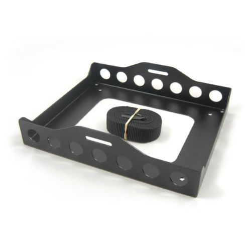

Thanks guys :) I've been having a look on ebay too and you can get trays for the Halfords size batterys for £25, which is probably a lot cheaper than the cost of having one made. I'm thinking of attaching it to the spare wheel mounting point too, so it will be easily removable. I haven't got a spare wheel anyway as it won't fit over the brakes, so the whole well can be used.

I like your fabrication Andeep, very nice. I have eye'd up an ally tray on ebay which comes with a retaining strap too as I don't have the equipment to make anything like that myself. Looking very good though, I like the build.

The tray I'm looking to get is more exposed than your battery box. Still haven't decided where would be good to mount it yet thogh..

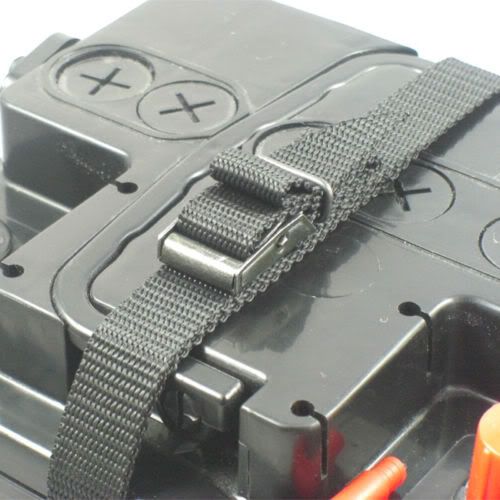

Here are some pics. It's £25 from ebay but obviously doesn't include the cables or terminals. They do a few different sizes but the medium one supports a battery that is over twice the physical size of the one I have now and twice the starting amps too.
