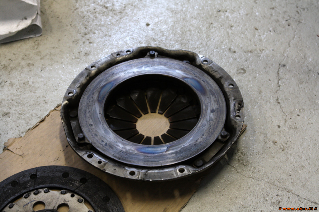

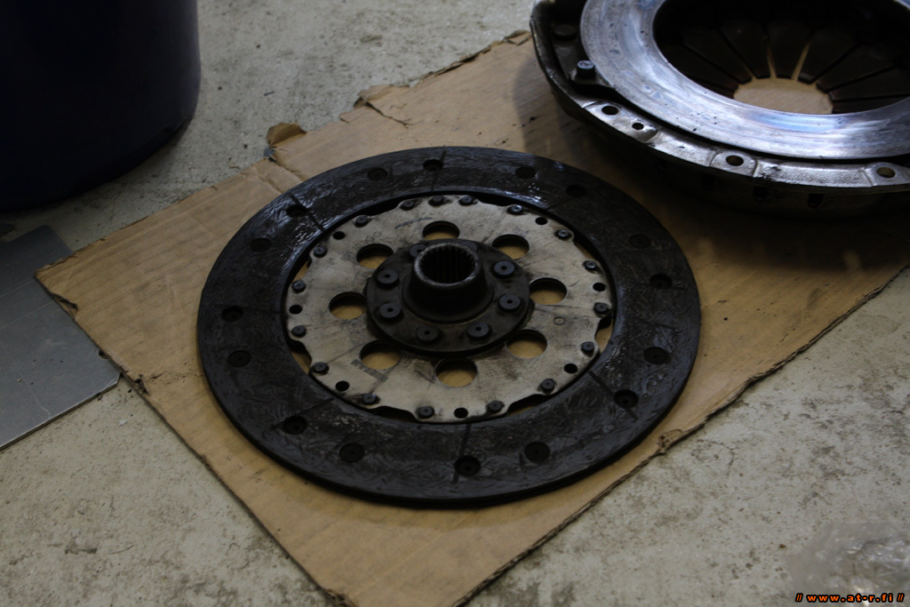

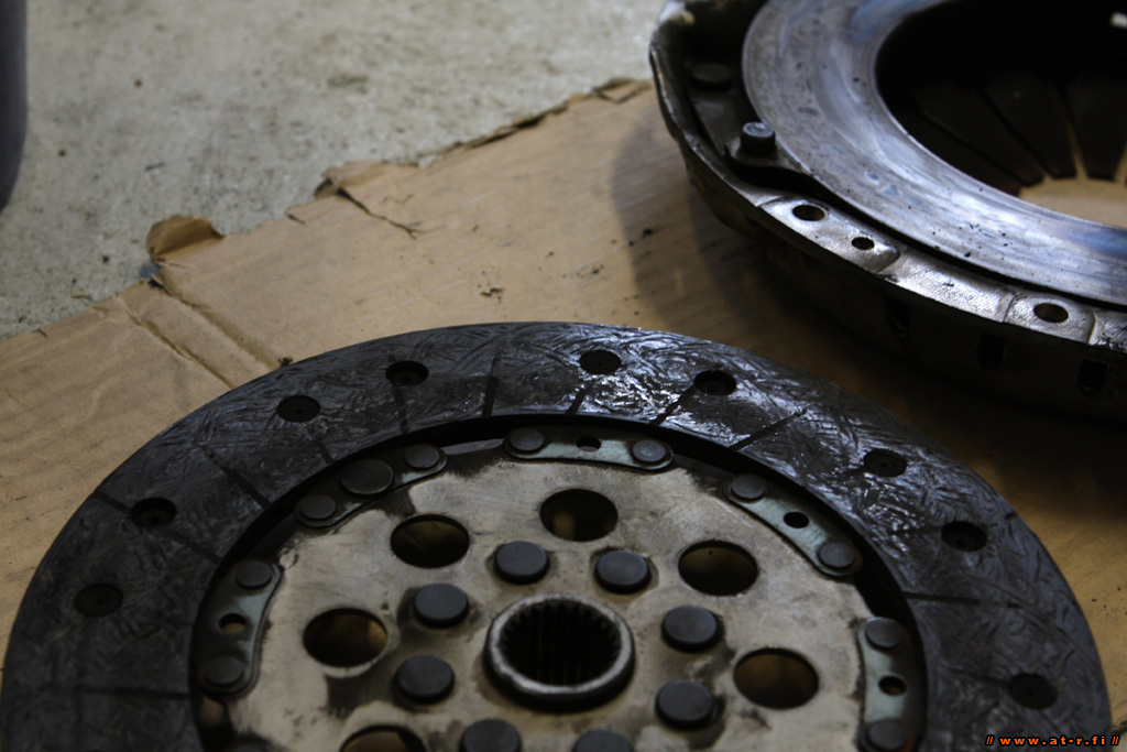

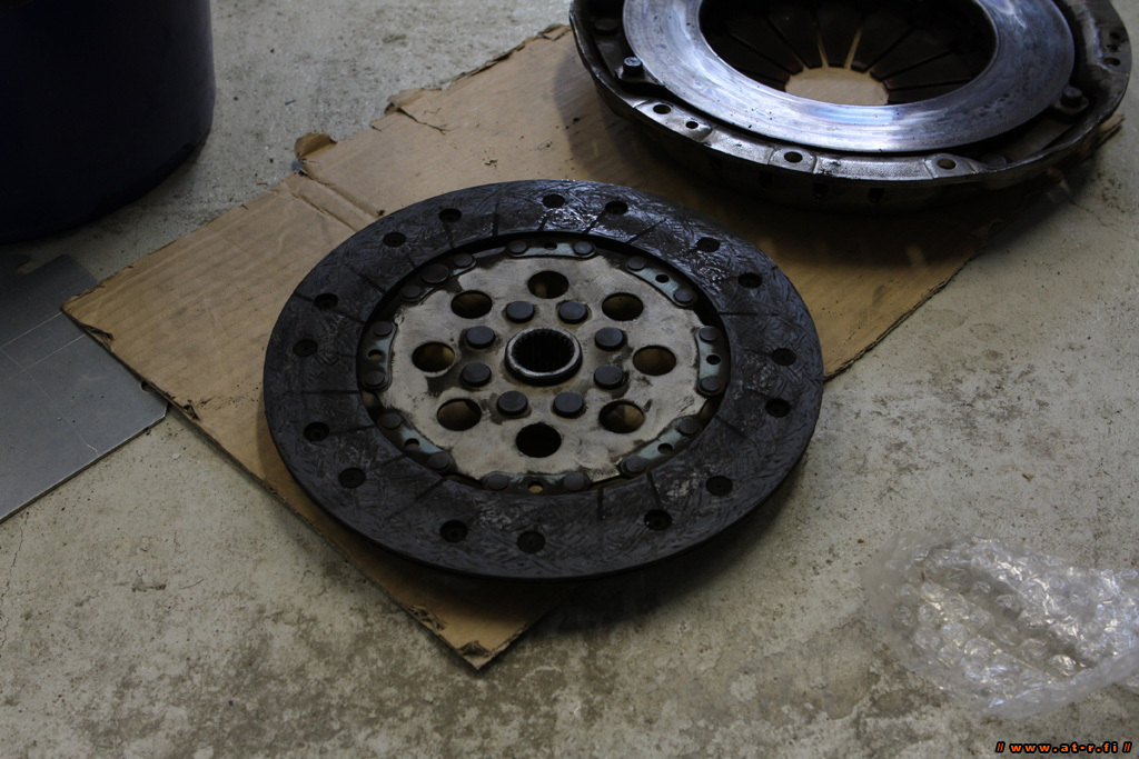

Few weeks ago my S15's clutch went "slightly" slipping. Couldn't hold speed uphills anymore.
Box still not out, bit problem with motivation and work etc. All bolts are off and shifter, but just need to pull it off.

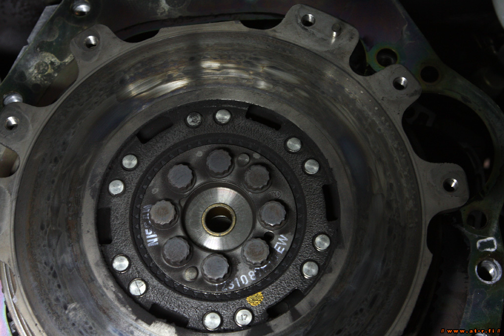

Should i keep stock dual mass flywheel (if not badly damaged) and try to find uprated clutch kit or maybe go with driftworks lightweight flywheel and get non dual mass S15 clutch kit?
Car is my daily drive, well would be... Bit upped boost (for now) with Greddy Profec controller. Keeping dual mass comfort is not essential, but will solid fw setup stress box more? Don't want to be replacing clutch every summer, tho. :D

Get rid of it, it's 10 years old and most likely FUBAR. As long as you get a sprung clutch disc then you won't add stress onto the gearbox
Then you risk vibrations and all sorts as members on here have reported. Super Coppermix is the way to go, if you have deep pockets.

If you remove the dual mass flywheel you do introduce vibrations because it's no longer there to absorb them. It isn't damaging, I've run 2 single mass for 3 years and they both did exactly the same, but it does eliminate the problems associated with dual mass flywheels and allow you to shave lots of weight off the crank. I had dual mass with my first tune, but went to single when I went up to above 350bhp/ib. It's a trade off really, you just don't know how long a dual mass flywheel will last at that power but a single mass is just a piece of metal so can't go wrong ;)

I'd guess that flywheel really needs replacing. So, current options are for me:

To get rid of dualmass flywheel. With my luck would be propably next place to break and surface isn't in good condition.
