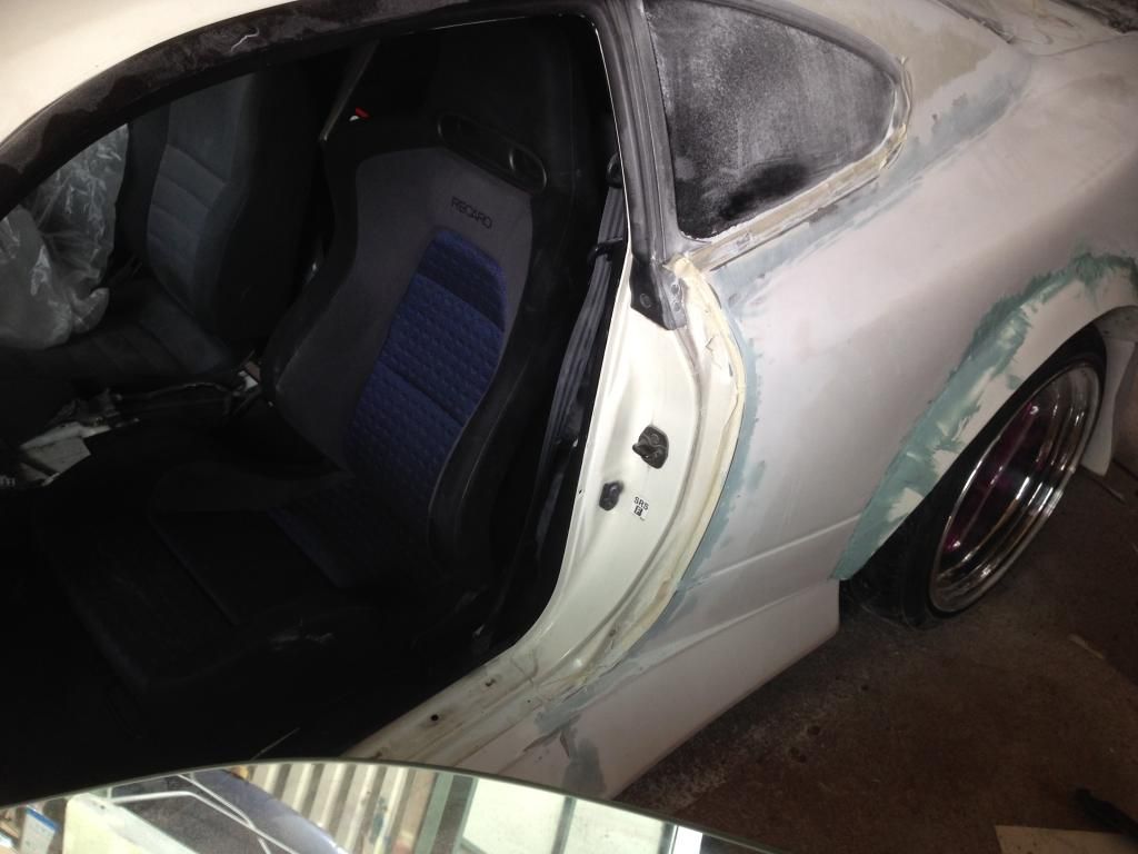

Chucked a seat in for this tread they fit!!!
