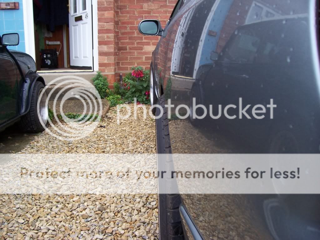

This is what it sits like on mine. 9x17 et+22, -1 camber
and this was before I had adjustable arms and it was at -3 camber
S.K

@ dan H ... what did you change to sort the rear ? looks dead on.
The top pic is with adjustable camber arms fitted and adjusted, and the bottom was with the standard ones. Because it's lowered they ran out of adjustment on the eccentric bolt before the camber was corrected, so they were swapped for a set of Part Shop Max ones.
Even though the edge of the tyre pokes out a little, it doesn't rub because the wheel tucks in under compression.
