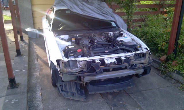

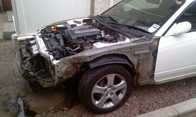

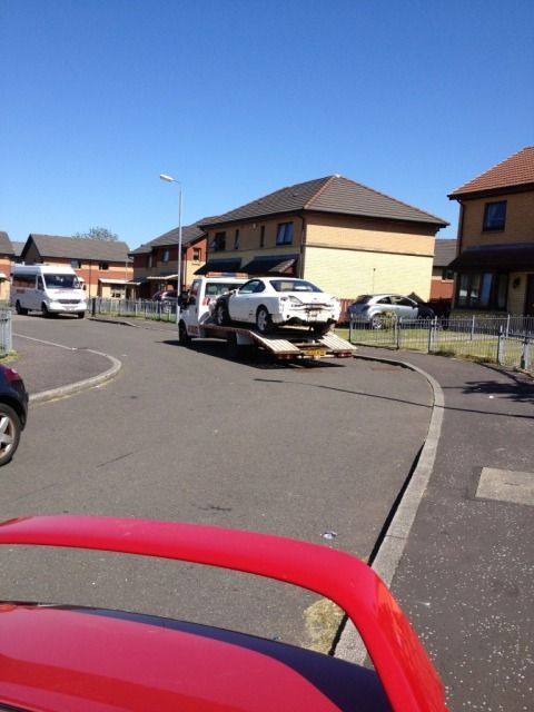

I have finally got myself an S15 Spec R, got it at a price i couldnt refuse off here, drove 250 odd miles to Glasgow to pick it up:
this is how it pretty much looked when i got it back home:
the car came with pretty much everything to put it back together incl bumpers, rear wing, bonnet. which left me just to track down the wings and side skirts...

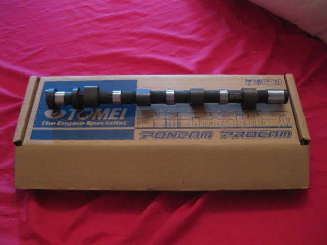

not got any more pics of the car yet but been gather parts for an engine rebuild which is basically a stoke refresh with some nice parts:

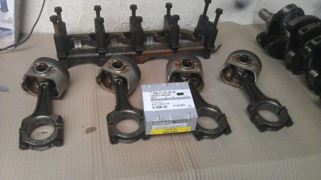

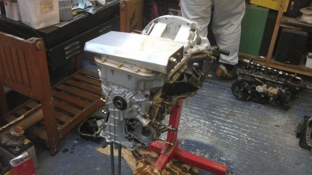

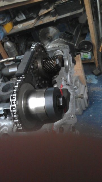

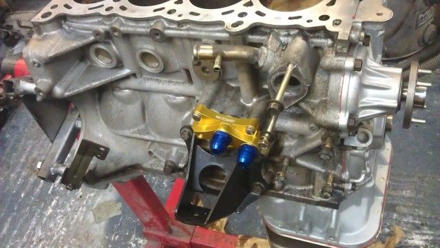

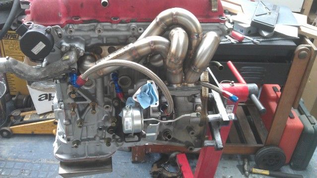

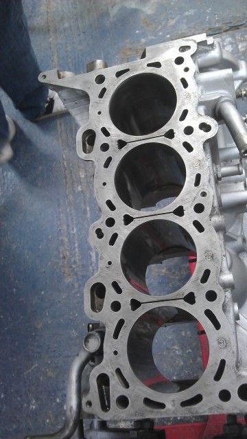

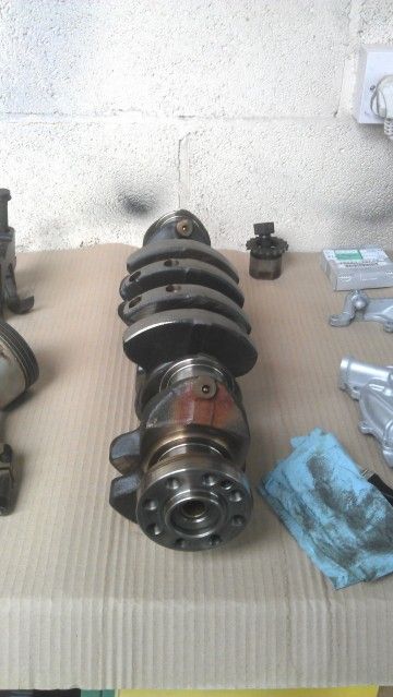

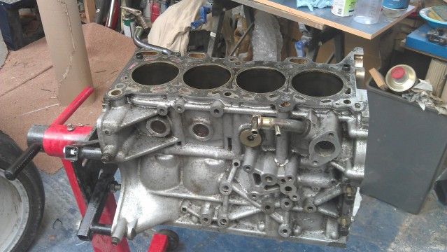

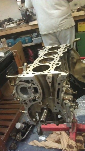

So i have been refreshing the engine since having the car and the current engine spec will be:
Re-honed block
Geniune nissan rings
Geniune timing chain kit

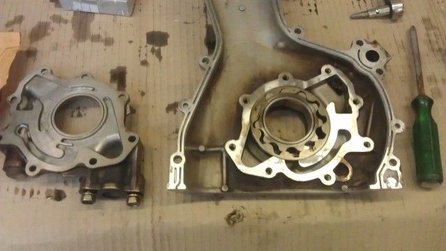

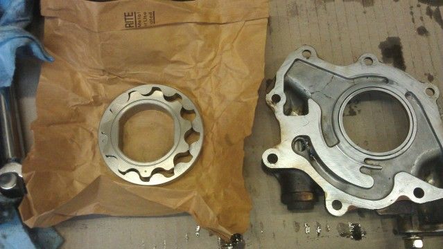

Geniune new oil pump rotors
New water pump
ACL race main bearings
ACL race rod bearings
ARP rod bolts
Cosworth MlS HG (1.1mm)

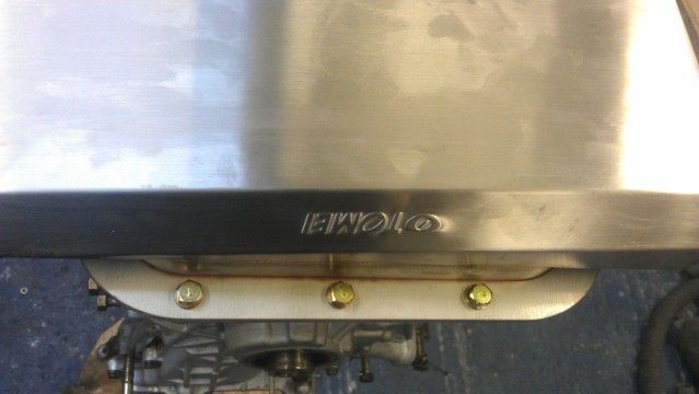

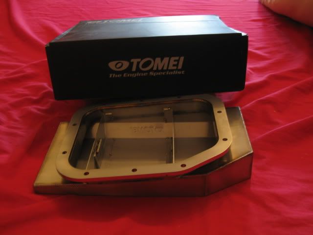

Tomei Baffled oil pan
Tomei N2 oil block
head skim,/clea/ valves and valve seats re cut
Crower valve springs
Tomei Pon 256 deg cams
New VVT

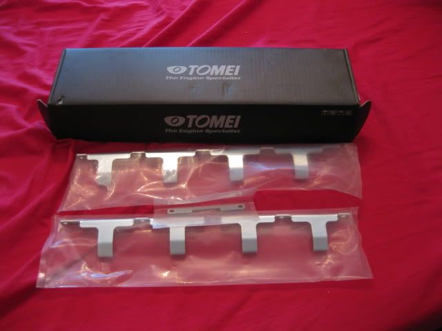

Tomei rocker arm stoppers

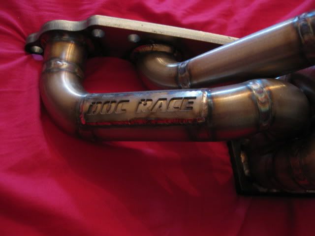

DOC race manifold
Garret GT2560R
here is the rest of the cars spec:

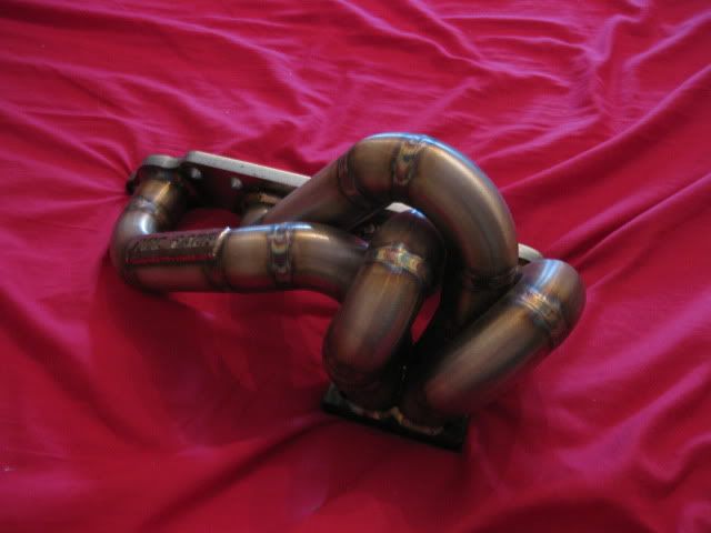

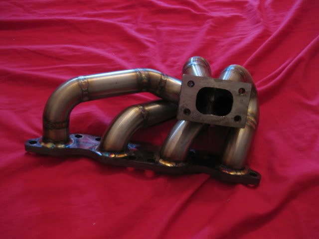

What do you make of that manifold was looking at purchasing the DOC racing one?
the quality is excellent on it mate, fit so far has been really really good... will see what its like when i get the engine in the car but so far it looks good..... customer service was also very good ...
