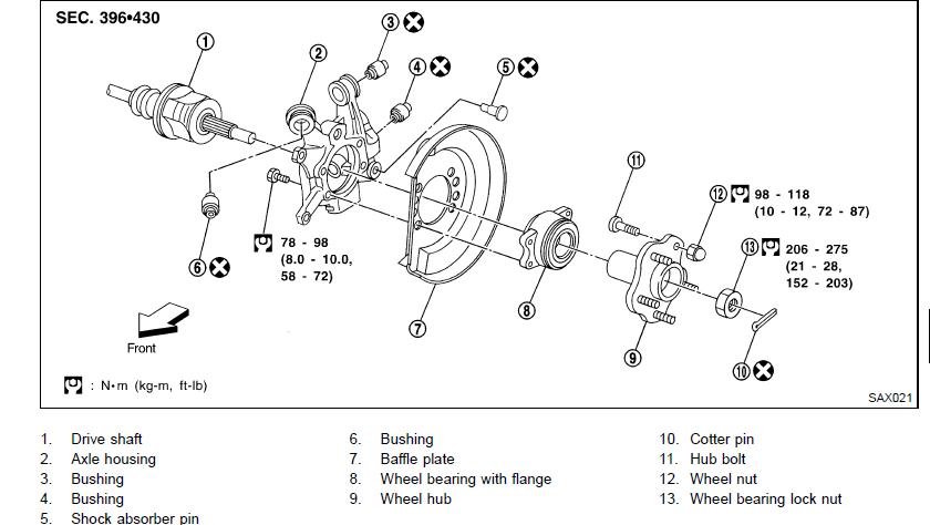

thats the rear hub dude, im looking for the front
