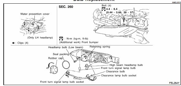

you can change them with no problem. There is a cover at the back of the light that needs to be turned like a bayonet fitting. It will be quite tight. This is to keep the moisture out.
Have a look at the manual page EL-32. It gives an exploded view of the headlight assembly and the steps required to change the lamp.
EDIT: I have pasted it here for you.
The headlamp is a semi-sealed beam type which uses a replaceable halogen bulb. The bulb can be replaced from the engine compartment side without removing the headlamp body.
Grasp only the plastic base when handling the bulb. Never touch the glass envelope.
RH HEADLAMP
Headlamp Bulb (Low beam)
1. Disconnect the battery cable.
2. Pull off the rubber cap.
3. Push and turn the bulb retaining pin.
4. Remove the headlamp bulb carefully. Do not shake or rotate bulb when removing it.
5. Install in reverse order of removal.
Headlamp Bulb (High beam)
1. Disconnect the harness connector from rear end of the bulb.
2. Turn bulb cover counterclockwise, then remove it.
3. Remove the headlamp bulb carefully. Do not shake or rotate the bulb when removing it.
4. Install in reverse order of removal.
Turn Signal Lamp Bulb
1. Remove front fender protector.
3. Remove the turn signal lamp bulb carefully. Do not shake or rotate the bulb when removing it.
