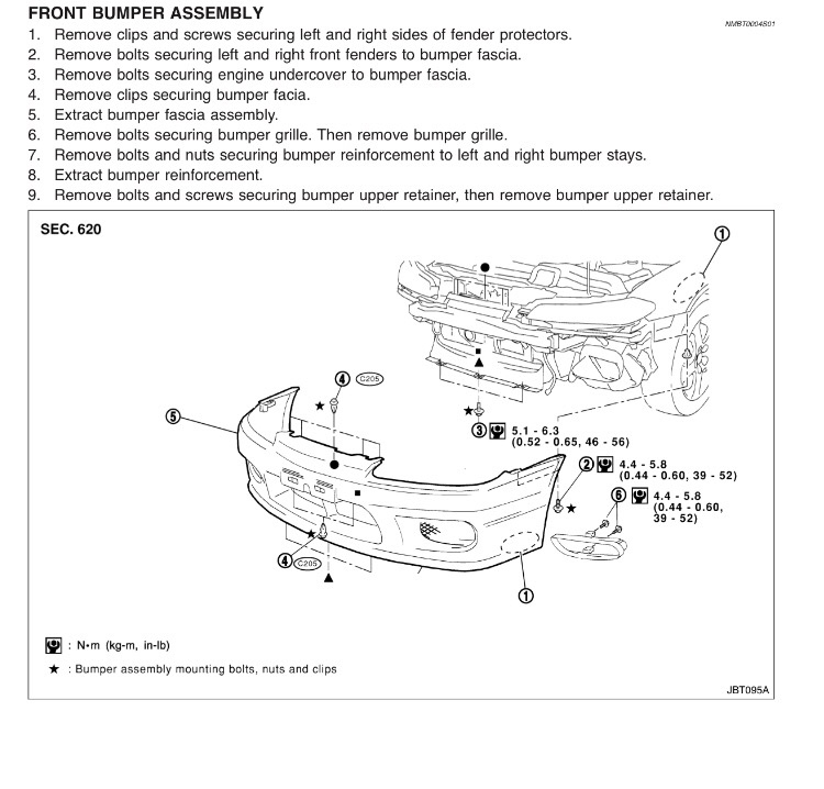

Its the same fitment as the stock bumper points, 4 10mm nuts on the inside of each front guard and plastic stud clips in front of radiator support..If you have a front mount intercooler and have the fog lights you will need to do some grinding to clear the IC pipes

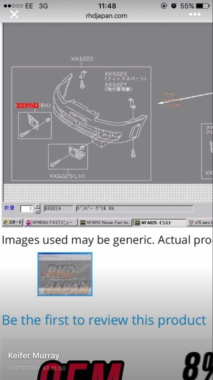

And what about the brackets? Are they the same as the non aero bumper?
Because if I look at a picture at Nengun I see some other kind of brackets, like little metal ones?
Says part numbers KK602X and KK602Y I believe? But I can't find any on the internet about it when I search those numbers..
4,644
46
These ones ? No idea lol I don't even have or like the aero bumper 🤣 from what others have said it mounts the same, I don't see why any extra brackets would be necessary they have the same mounting points . .

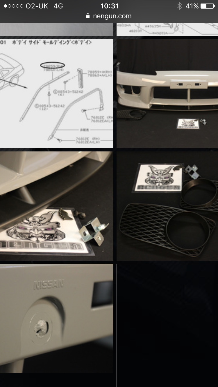

Found this , must be what they are talking about . No idea what they are for through I'm afraid

These ones ? No idea lol I don't even have or like the aero bumper 藍 from what others have said it mounts the same, I don't see why any extra brackets would be necessary they have the same mounting points . .
That photo shows the brackets for the mesh grills at the side & the fog grills.
I have no undercovers so all I needed was clips at the top front & underneath. For the sides, a foam spacer, a plastic mount & the 2 bolts for each side.

The brackets in that other photo are of the tiny brackets that holt the wire mesh on the side vent on the bumper, one at the top & one at the bottom. Its not a mounting bracket for the bumper.
