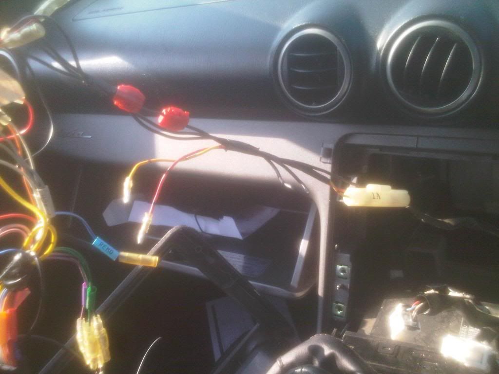

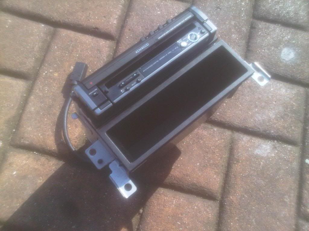

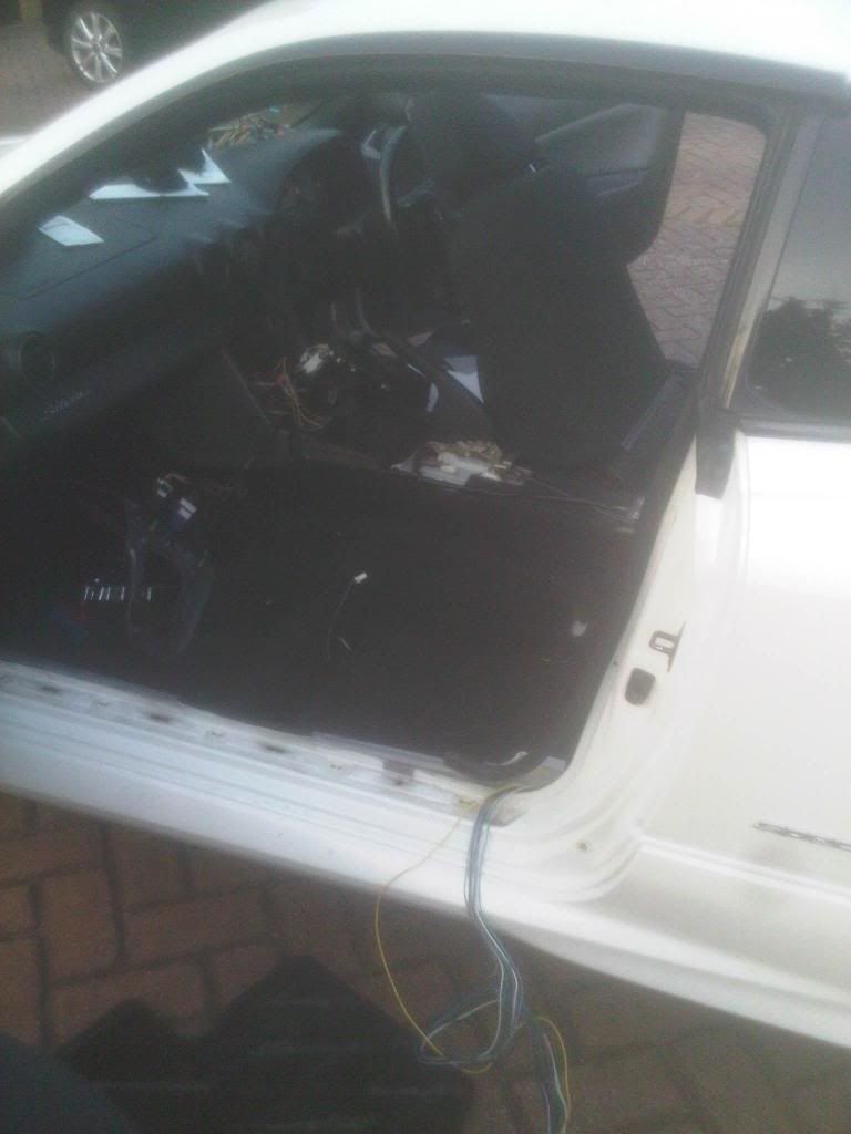

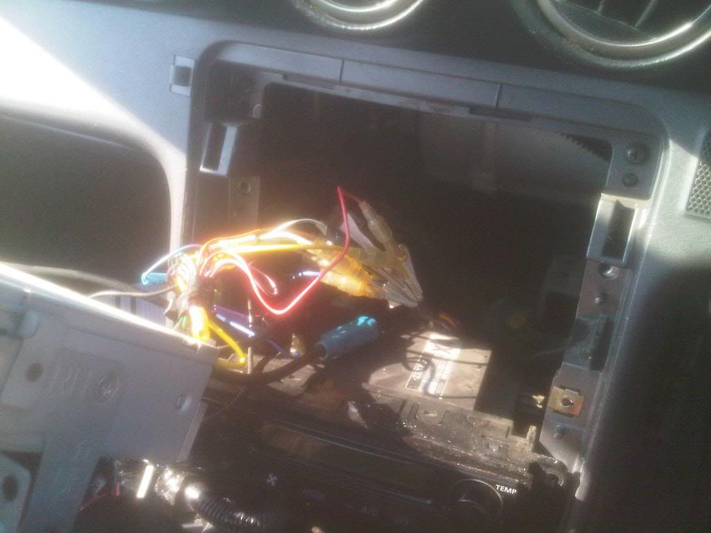

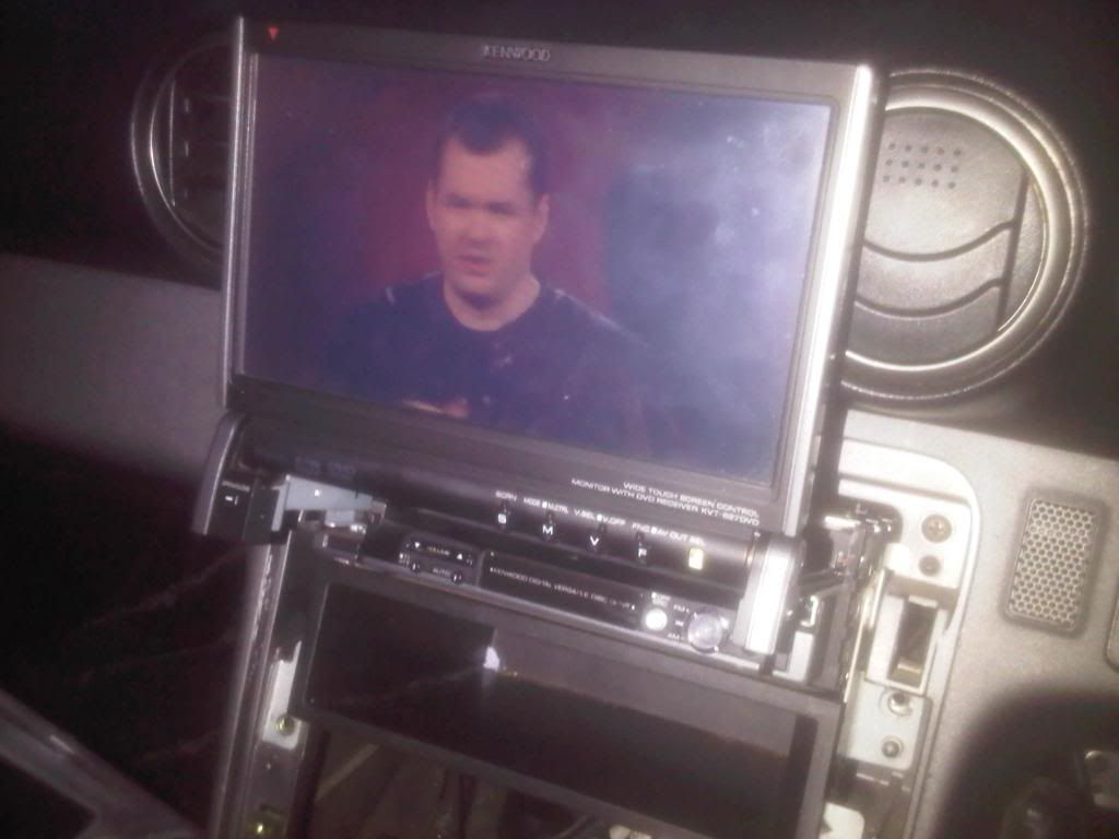

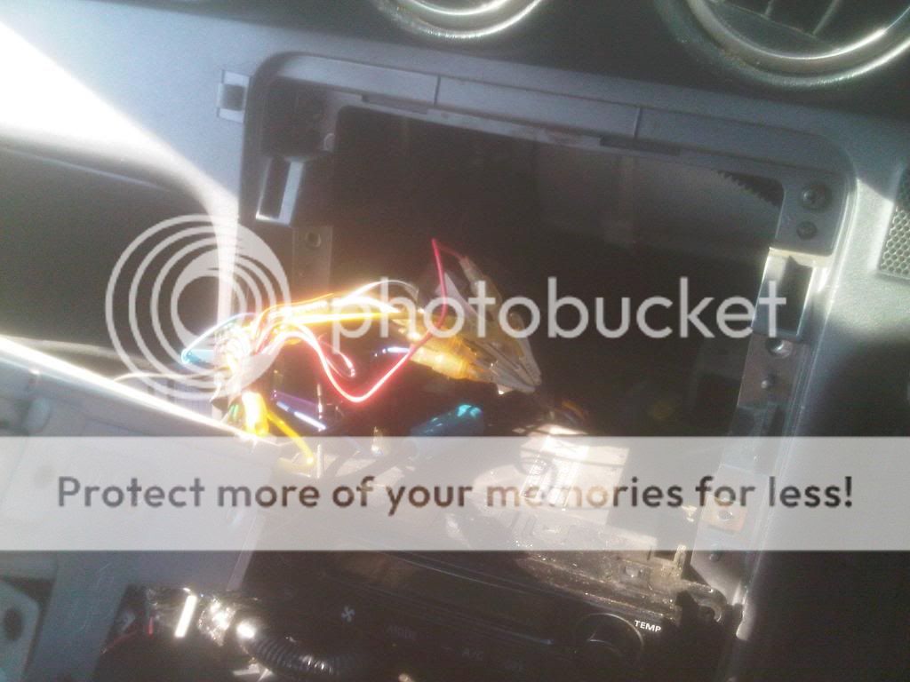

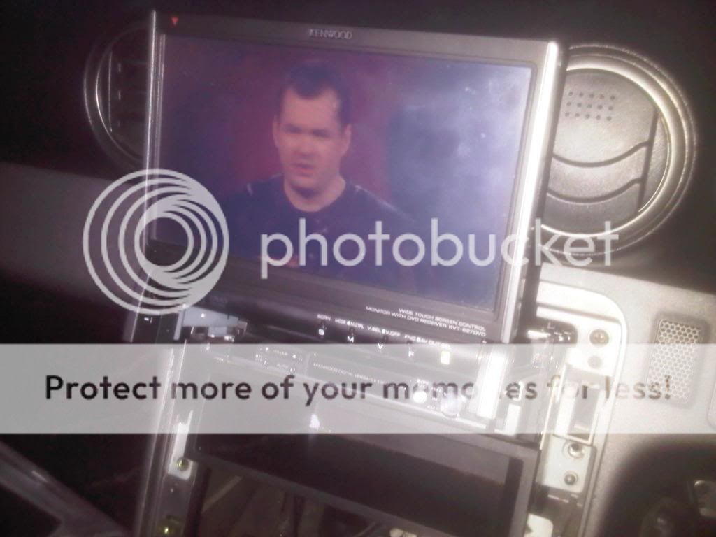

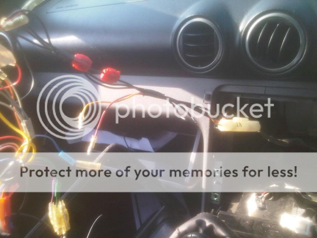

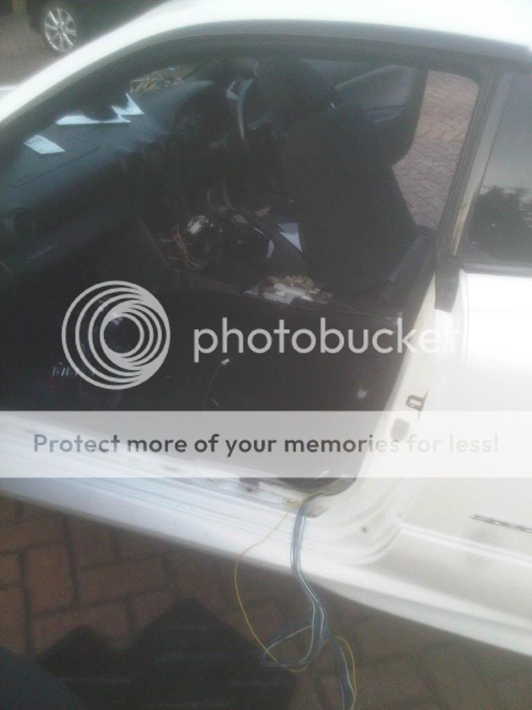

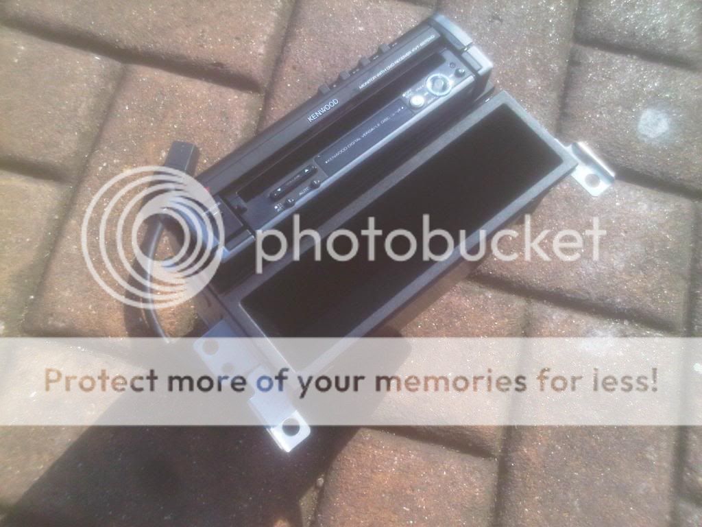

since it was such lovely weather on Sunday, I decided to fit my DVD head unit that I have had since I had my first car and thought it would look great in the silvia, plus my jap radio didnt have FM so double wammy. It is a 7 inch fold out screen so the brains are in a seperate unit which I planned on mounting in the glove box. Easy I thought, should be just over an hour to install no dramas...oh how wrong I was.

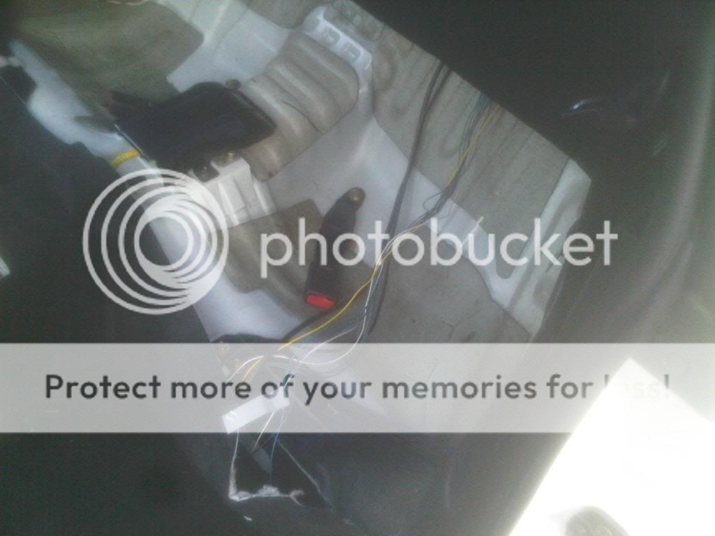

got the new stereo out and plugged all the wires in on my driveway to make sure i had everything. lots of cable but i thought hide that neatly behind the dash and can easily run the cables to the glove box. So out came the gaitor, of came the centre surround and climate control unit, unscrewed the radio and popped it out when i was greeted with what can only be described as a birds nest. Oh F*** I thought, ive read about this on here lol
so anyway it took me an hour and a half just to work out what wires were for what and what ones i didnt need, eventually got them linked up with my nissan micra adaptor thingy. hard bit over i plugged in the head unit and fed the cables into the glove box. went to put the unit in and then realised it had a snowballs chance of fitting in the glove box (school boy error).

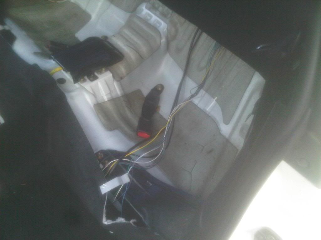

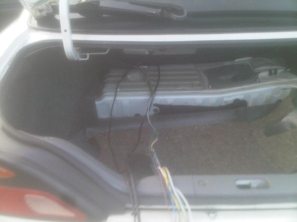

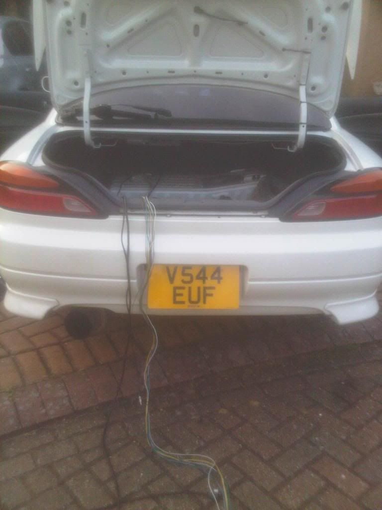

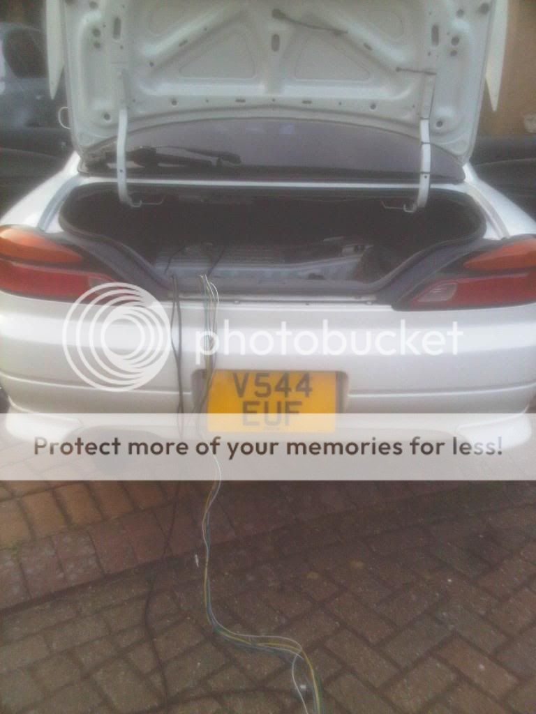

cutting a long story short an hours job turned into 6 as i then ended up stripping most of the interior out to run the 20ft of cable to the boot. then spent the rest of the time trying to get FM and getting teh DVD player to work. in the end it got dark and i gave up.
could have done the fuel pump while i was there :p
then tonight i thought id have another look. found the park sensor wire had not been earthed so earthed it and still no joy on the DVD player. i then discovered my earthing point wasnt actually an earth so ive spent this evening shredding my hands trying to get 4 earths on one tiny bolt somewhere on the bulkhead. turned it on and still no dvd.
decided to then go round my mates as he is pretty savvy with this sort of stuff, as i turned the engine on it sprang into life :) sound, picture the lot! in my excitement iforgot to check the FM works as i now have proper earth, guess i was over excited that i can now watch porn on the way to work haha!
jim jefferies has never looked so beautiful lol

Looks great dude...lot of work though haha!
Dont suppose you know where to buy a double din cd bracket like what you have got, I have got single din but want one that has the stereo and then storage underneath...

yeah it was but well worth it in the end!
I just assumed all 15's had that bracket, that came with the car mate. I can only suggest doing a google search or ebay but I assume you would have already done that. also the head unit isnt in a cage, it just screws directly into that bracket thing I had (spent half hour with radio clips trying to extract it, only realised when i took the surround off to get a better look lol)

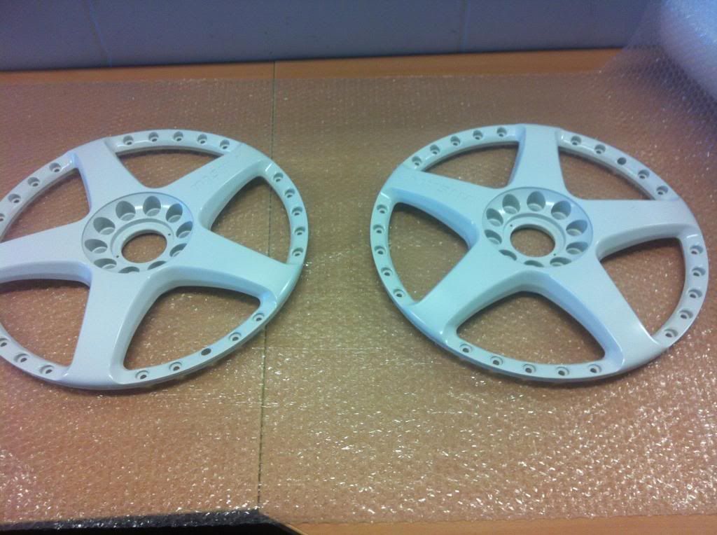

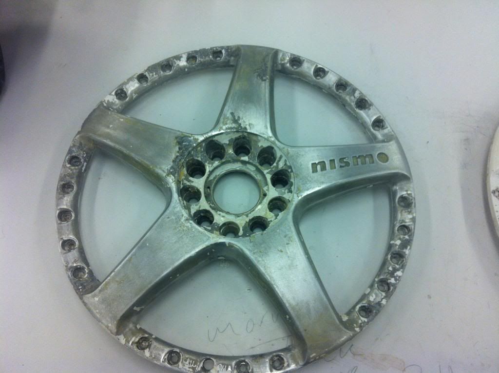

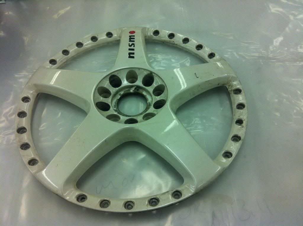

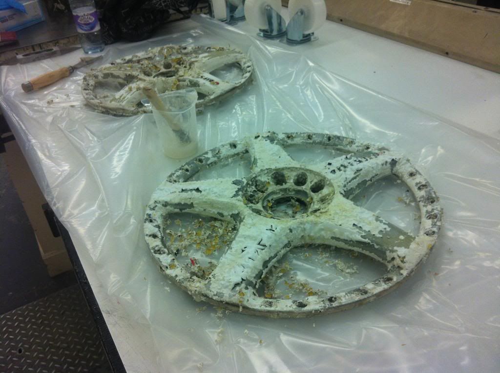

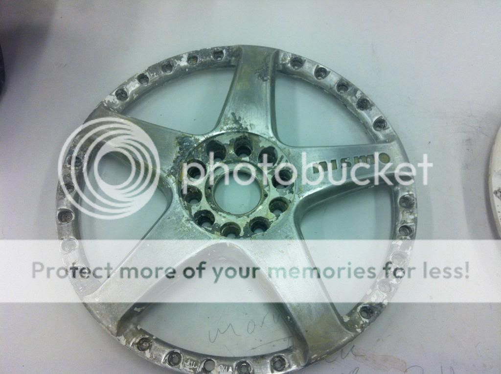

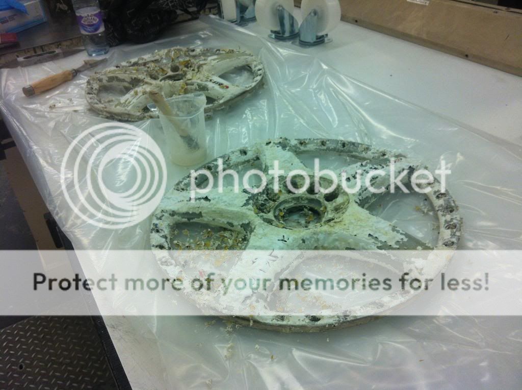

Seems like ages since and update but good progress has been made, the nismo barrells have gone away to be refurbed and i have stripped the centres at work ready or paint :) the car is going into the body shop next week for paint at the sum of erhum £850 and the guy sad if im not happy with the way its done he'll do it again for free :) (painter my dad uses and he's no mug)
But the best new is is that the car actually runs now. Have a few niggles to sort out like the speedo and fuel gauge not working and also still no rear lights :(
Something odd has also happened with my boost gauage which i will get some pics up of to see if anyone can work out wtf is going on
Ready flor blasting, then some nice etch primer and high build before top coat
Any suggestions on colour, was going to do pearl the same as the car..

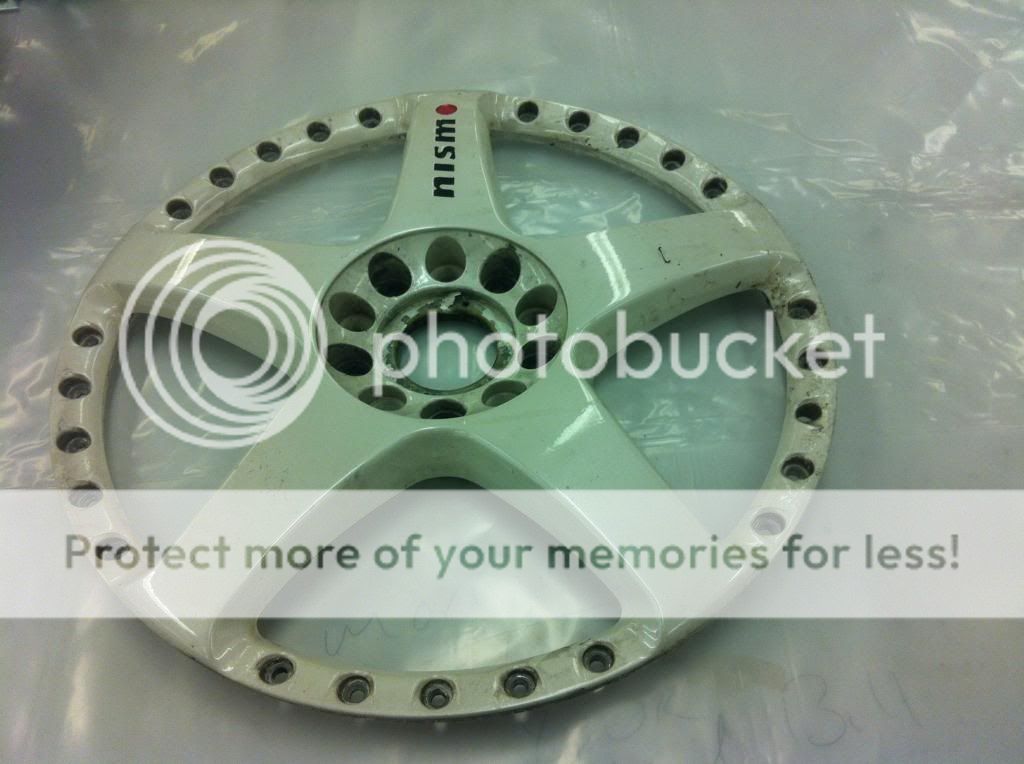

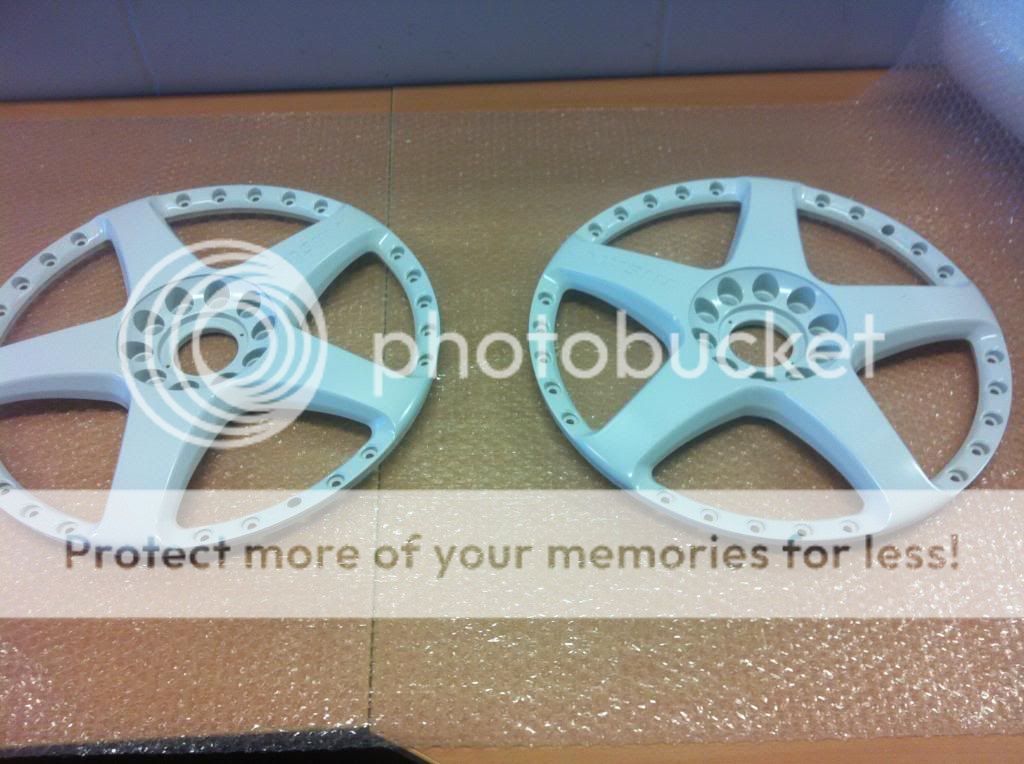

another mini update; the car is going in for paint Tuesday so should hopefully have it back by the weekend and also got my wheels in primer and they guy doing my car is also going to paint them for free which is a touch, have also just spent £120 on titanium nuts and bolts for my wheels :( but will be worth it. Have also got my barrels back from the refurb shop so just need to give the backs a quick spruce up and they will be ready for some new rubber.
Also as regular forum members have probably noticed I still have plenty of electrical gremlins to sort out so if anyone has any useful tips then feel free to chip in :)

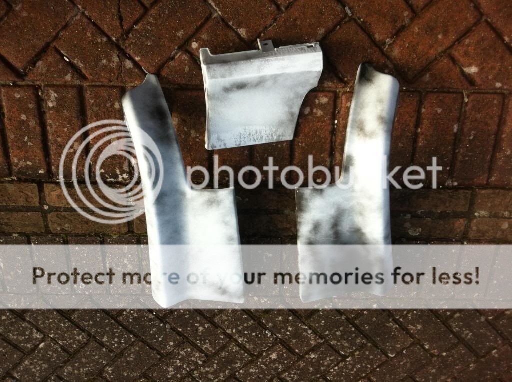

etch primer and some non sand white and they're good to go (the other 2 look exactly the same in case you wondered!)

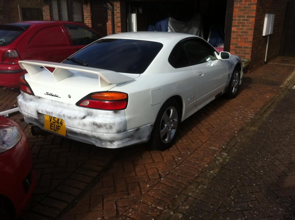

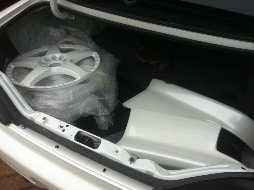

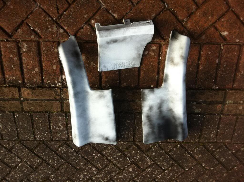

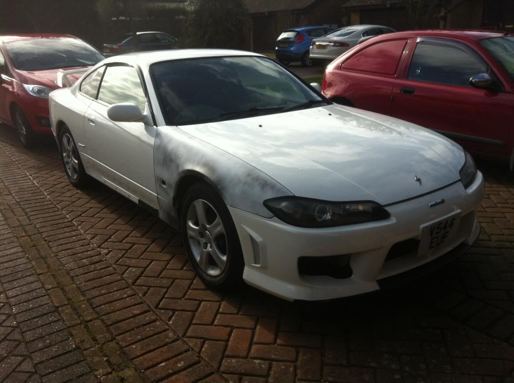

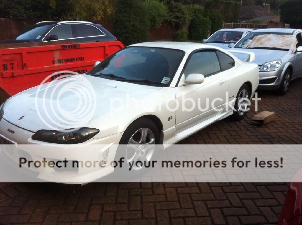

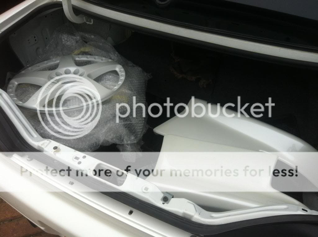

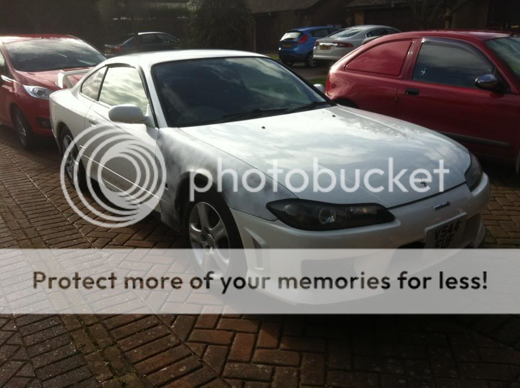

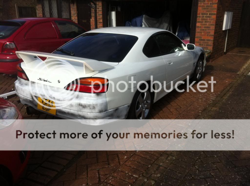

So tomorrow the car is going in for paint to be returned to its former glory and im also getting the wheels done too. I thought i should put up a few snaps of he pre cosmetic surgery :)
The joys of my job- 3D printed rear spats and front o/s skirt end :)
next update will be once shes back from the body shop

looking forward too seeing your Nismo rims all painted as I love them :smitten:

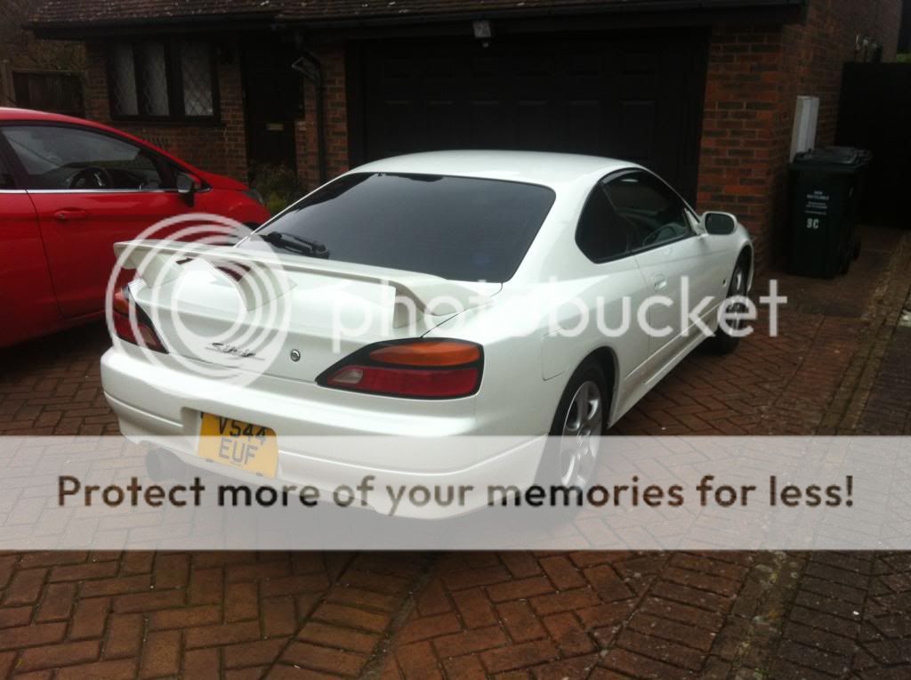

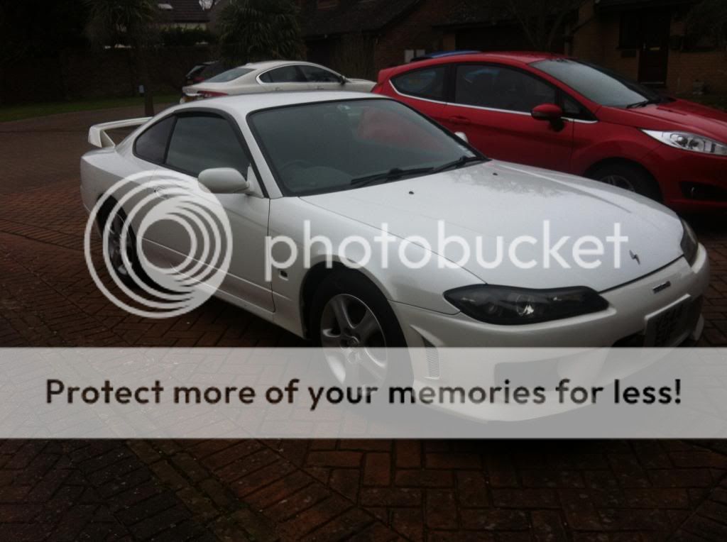

Last weekend I got the car back from the body shop- looks perfect and took them 2 days to match the colour but its spot on.
Vinnie you'll be pleased to see the centers are now immaculate :)

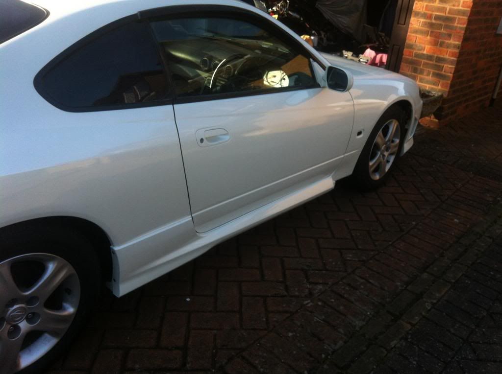

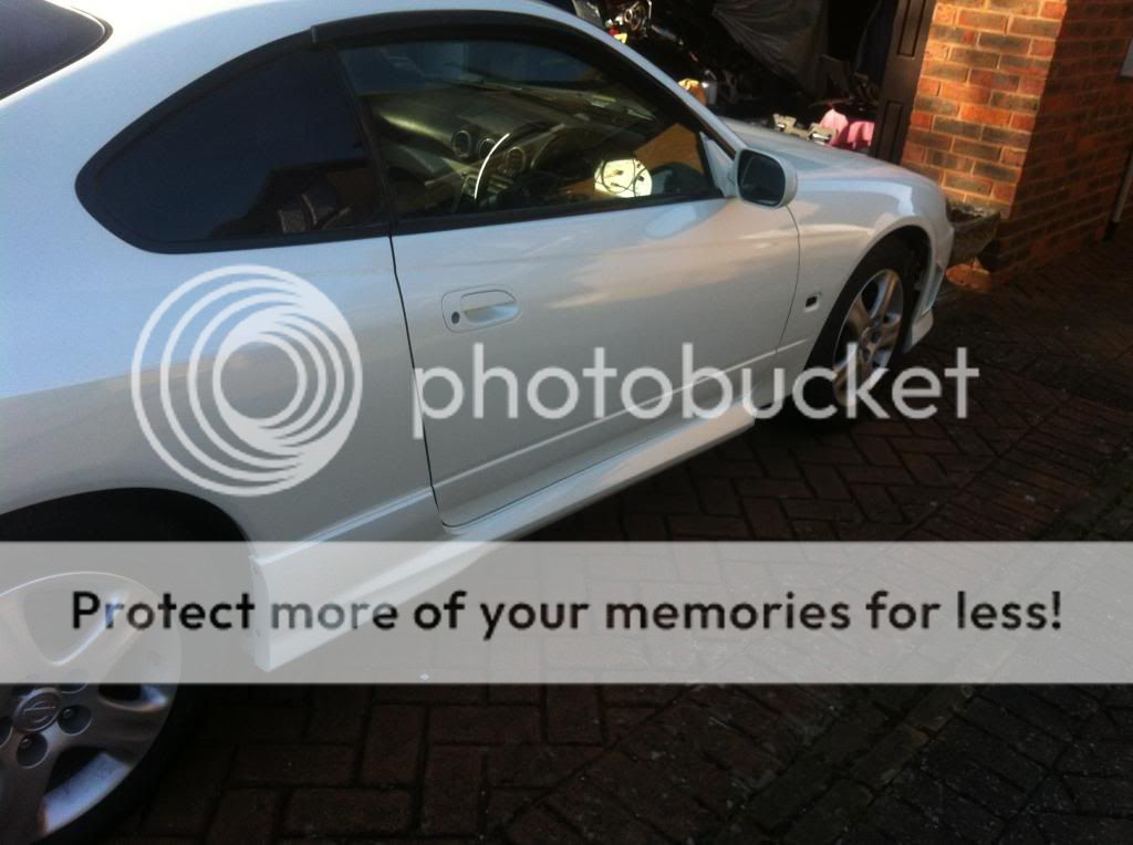

only thing the forgot to paint was the skirt I damaged with a bungee cord which was holding down my car cover but I'm taking it back today for them to do.
but got around to putting the opposite skirt on- need to re drill the wing for the front bit and also need to mount the spats hopefully this weekend

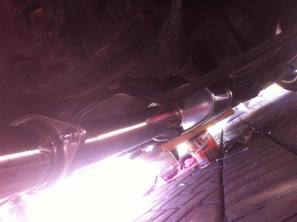

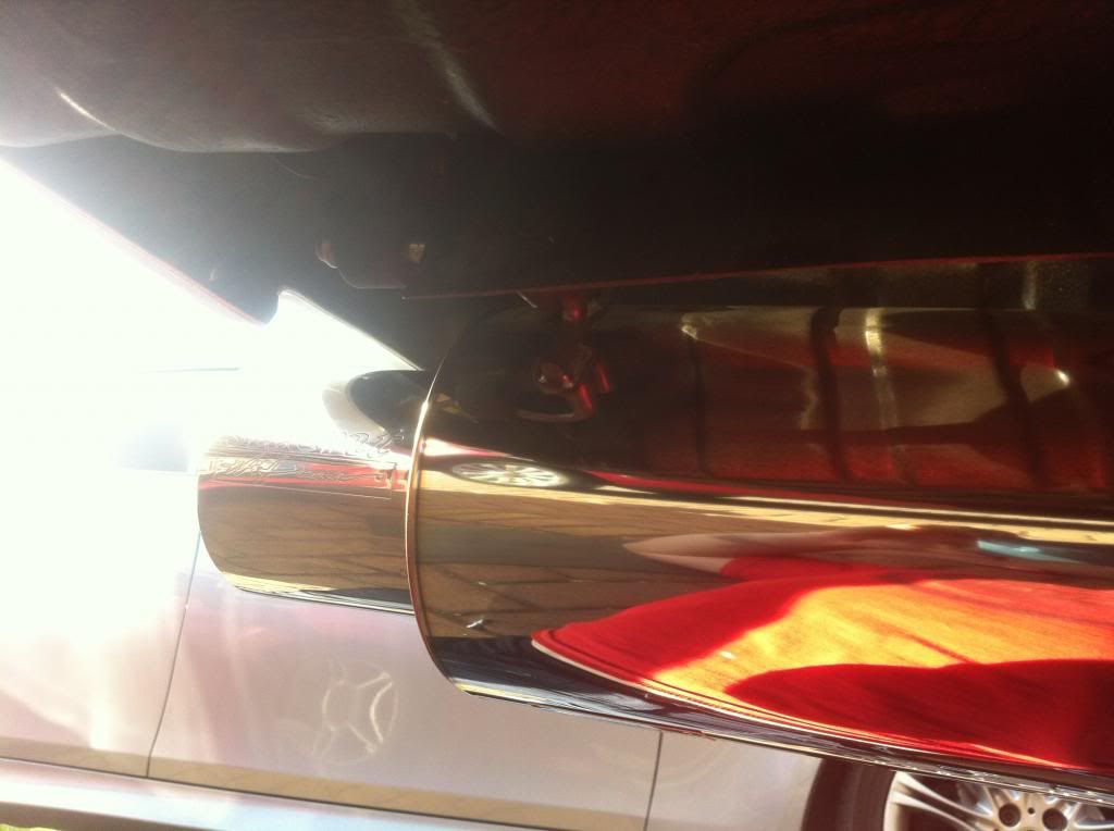

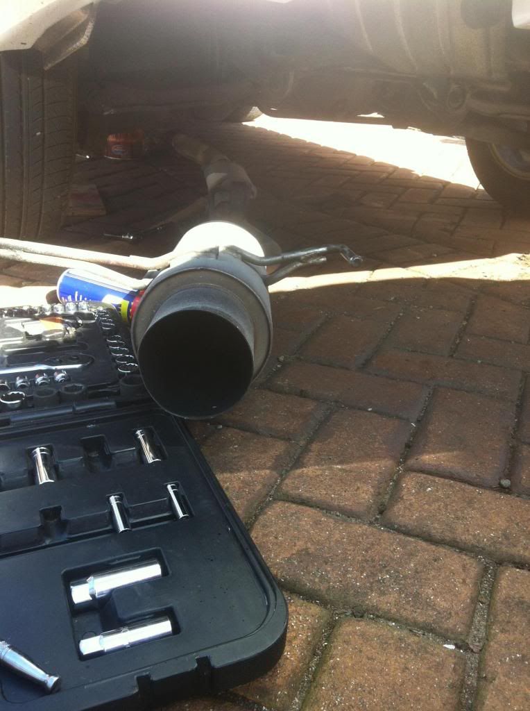

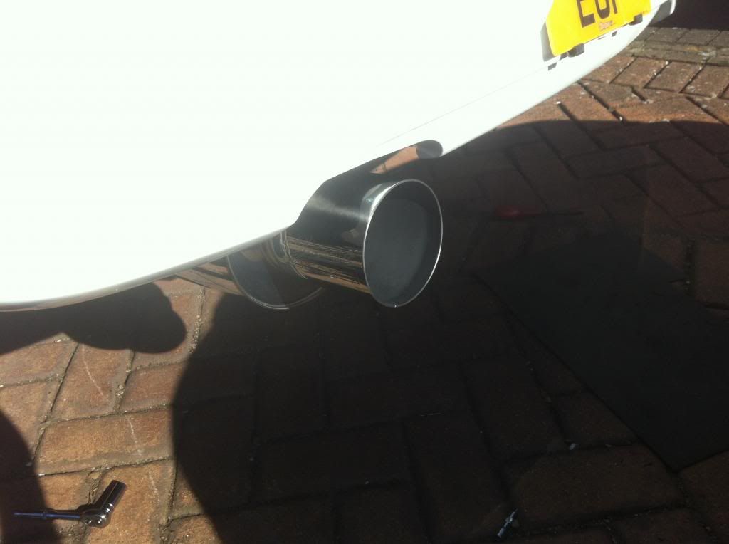

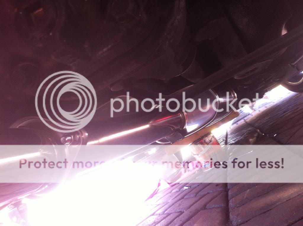

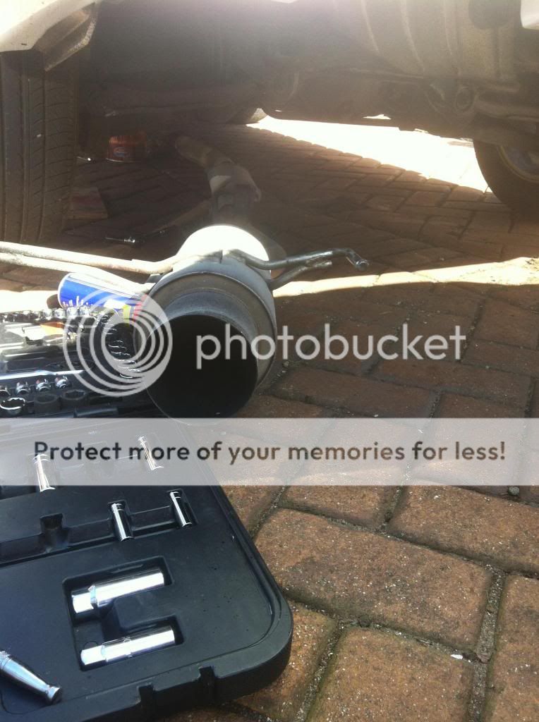

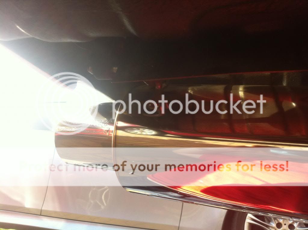

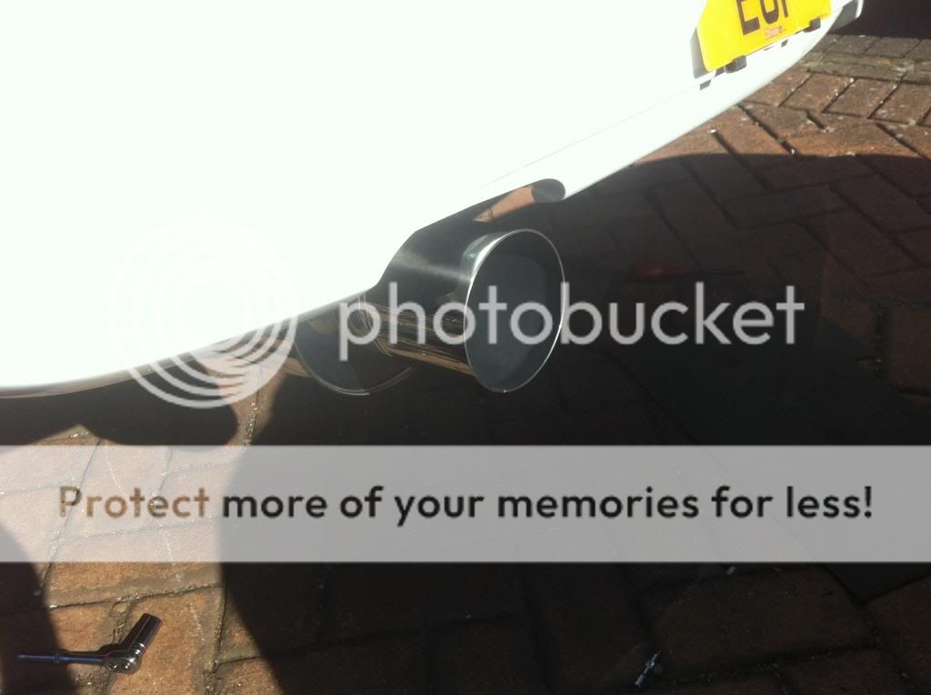

Because I was on a high i finally upgraded my exhaust. Only changed the CAT back as it needs MOT soon and changing the whole lot with a trolley jack is a ball ache so will wait till my dads 2 poster is fully functional then will whip off the rest :)
Out with the old...
And in with the new :D
and yes that is a tin or Ronseal supporting the cat lol

Ha love it dude!!
glad it's all done. We should link up as your only up the road from me lol.
which exhaust you put on?
24 January 2013
1,220
Kent
Its the HKS silent power one. Even though the silencers are bigger than the nismo it sounds louder but guess thats a lot to do with the resonance of the stainless steel :)

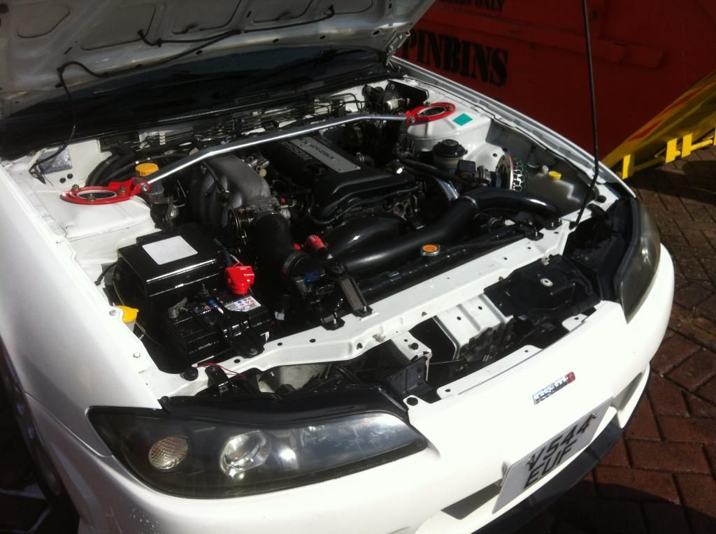

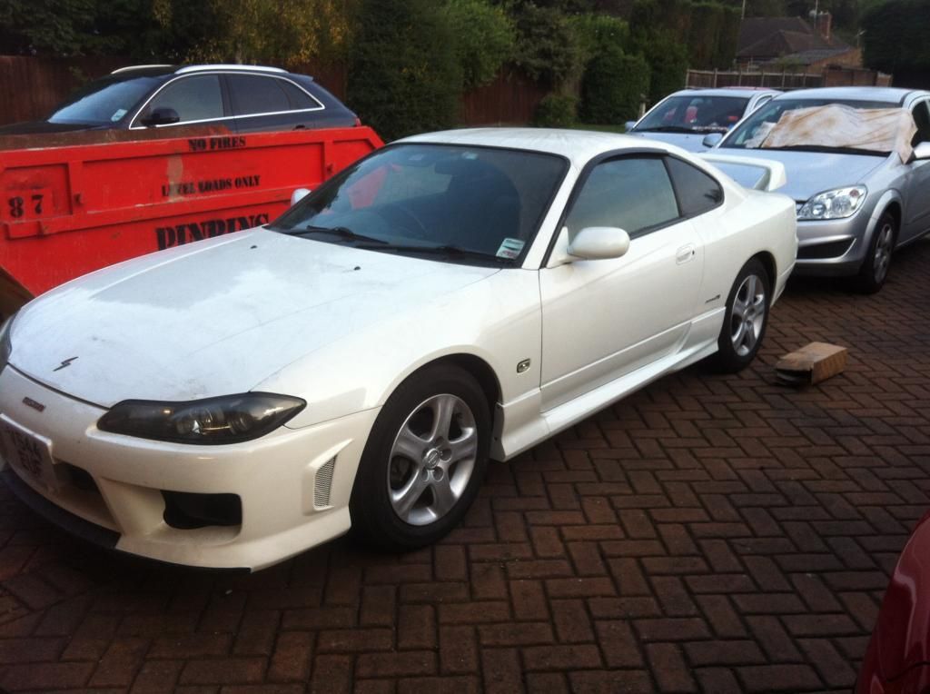

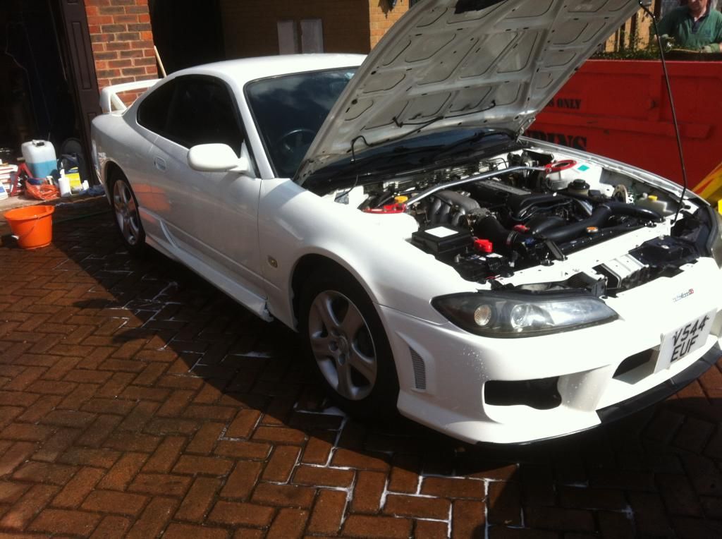

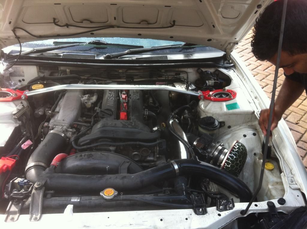

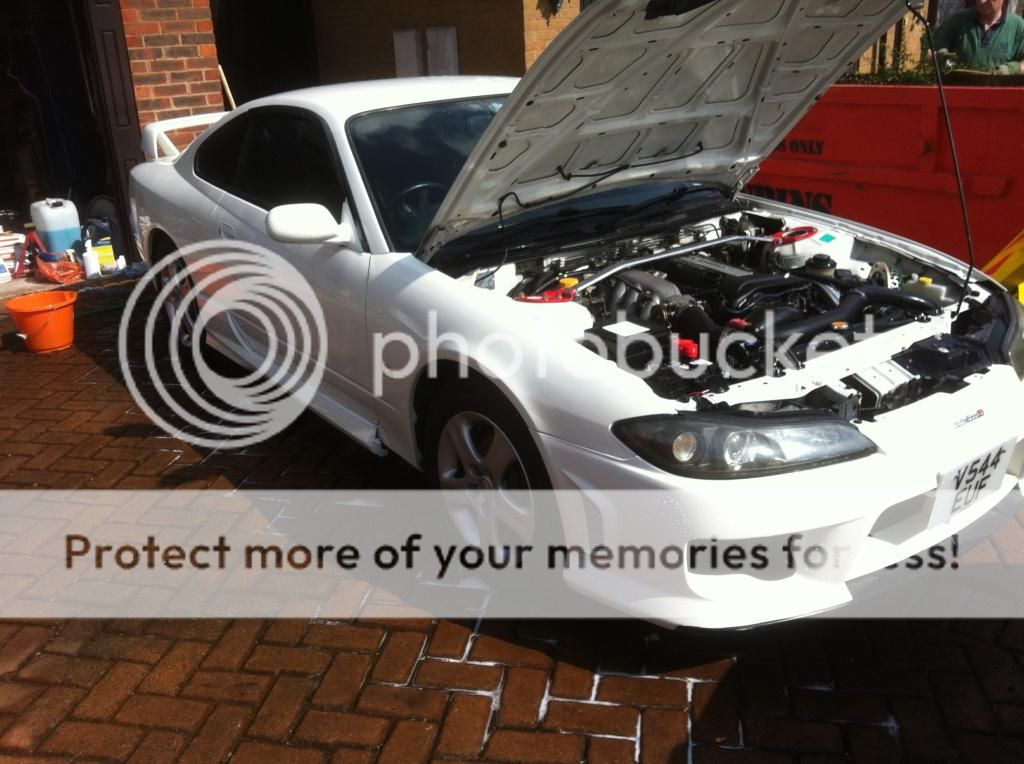

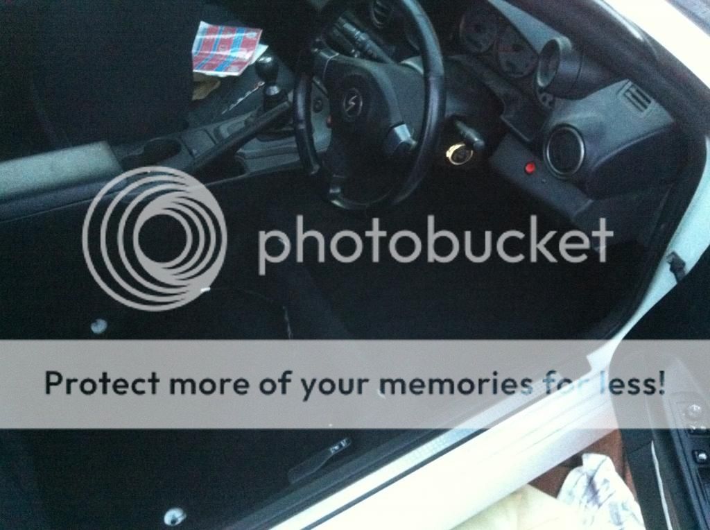

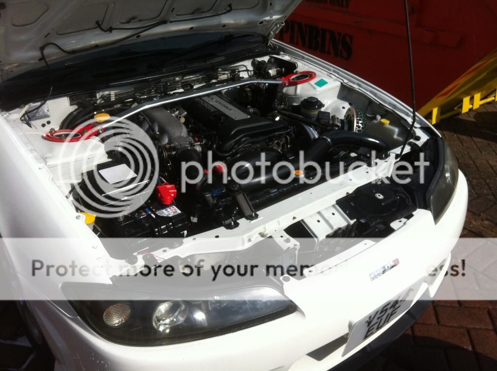

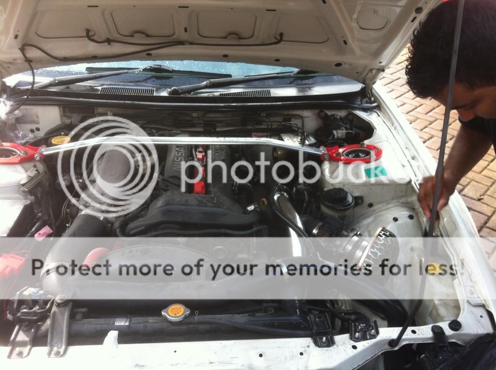

Photo time! Managed to put the interior back in the car and give it a reasonable clean inside and out with the help of my friend who seems to have car OCD which was ideal as my car was filthy! got a few before and after photos below:
The engine bay was filthy as was the outside but my buddy had a box of autoglym/chemical guys goodies to solve this :). He had this really good car shampoo and spray that i think was a chemical guys product- it basically dissolves iron deposits on your paint work that normally would be picked up by the sponge and dragged around, turned my car purple there was so much on there! will get some photos up when we do it again.
After:
engine and body looking a million times better now, all that is left to do is fit teh skirt sill and my rear spats. car is going for MOT Friday so fingers crossed she passes then will need the tracking sorted

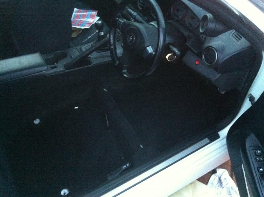

awful interior shot but took the seats out to give it a good hoover...and dry out! The guy who repaired the car put the seat back in but pinched the washer fluid pipe under the seat rail and so deposited an entire 3 litres of soapy water into the drivers side foot wells! took ages to dry it all out, done a temporary fix using an inline fuel tap i had kicking about for my mini motos.
