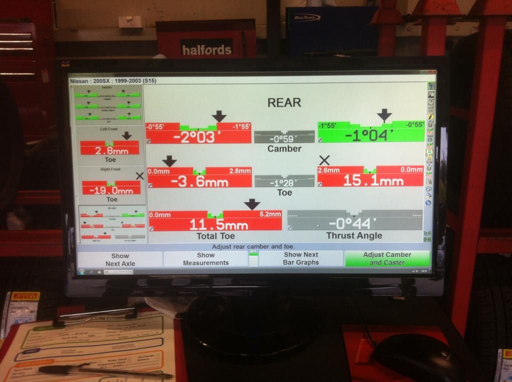

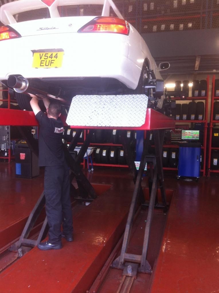

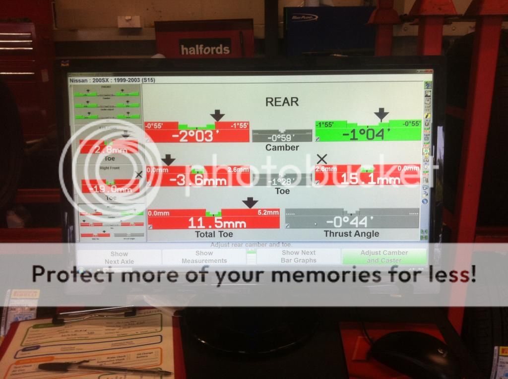

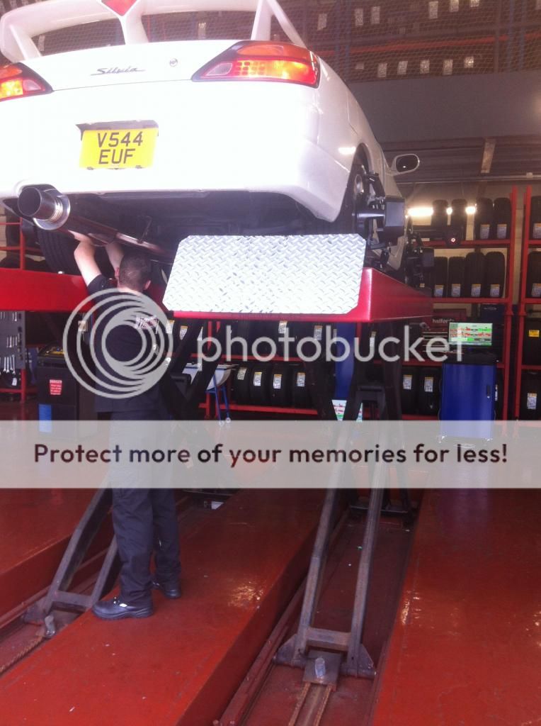

So on Saturday I took the S15 to get the wheels aligned at STS in Rochester. They have a hunter laser alignment machine and its the dogs goolies. However I wasnt quite prepared for how far out the wheels were- 16mm on the front and 18mm on the back!
This was just the rears but clear how the impact had affected everything.
My new friend Scott getting everything sorted...sort of
In the end they ran out of adjustment on the standard setup for the rear, the front ended up being 0.3 degs out on the camber on the right front but the toe angle on the rears was out by 2.5mm- that was the closest they could get. On the plus side they only charged £45 instead of the £85 it would have been to adjust everything but because they couldnt get it perfect they reduced the price :) I am planning on buying fully adjustable arms in the future so the extra adjustment will be useful. On the plus side it drives a million times better than when it went in lol. Just shows that even when a car is jigged straight they are never 100% perfect, something is slightly bent minutely but its something I will have to accept I Guess.

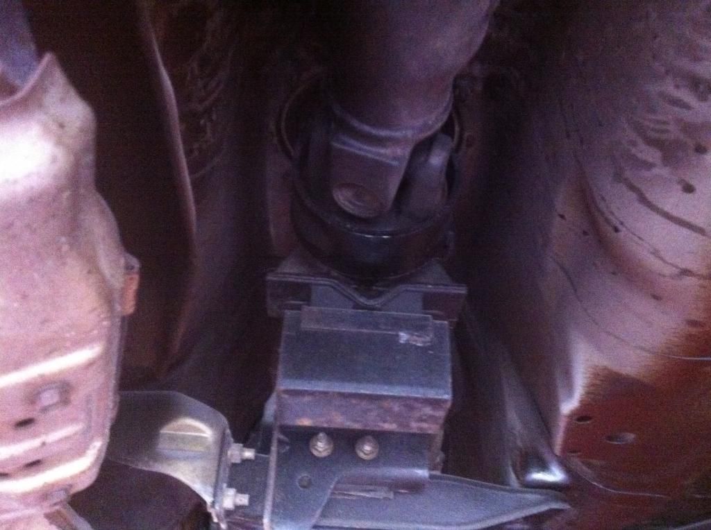

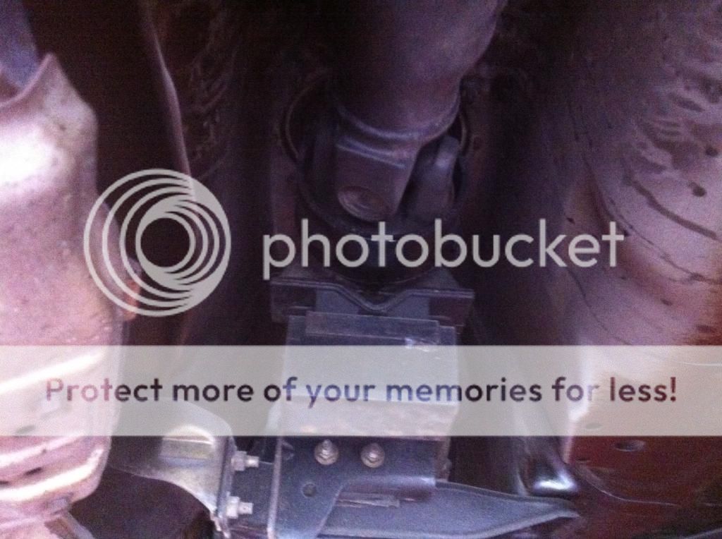

Also found this whilst we were under the car:
It looks as though the gearbox to prop seal is leaking but its only very slight as I've never noticed any oil on the driveway, is this a big job anyone know? price?

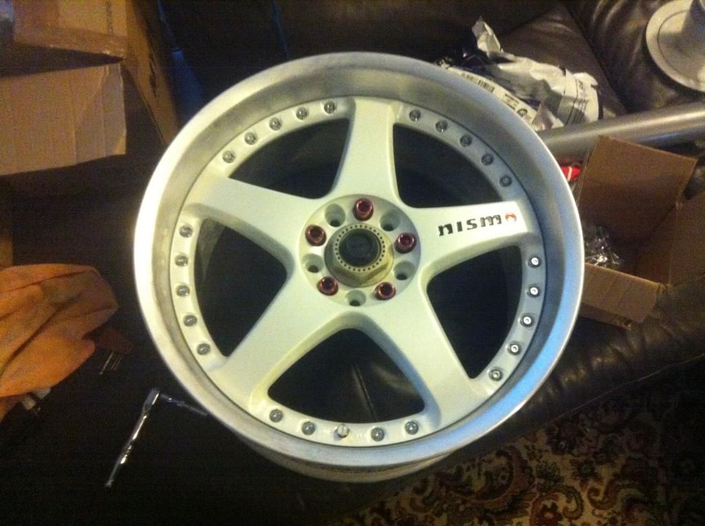

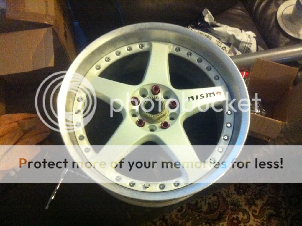

Also started to rebuild my wheels- the lips still have wax on them so look dull but they still look amazing :)

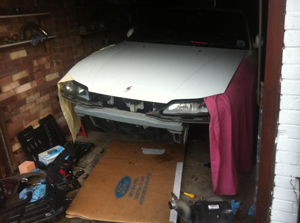

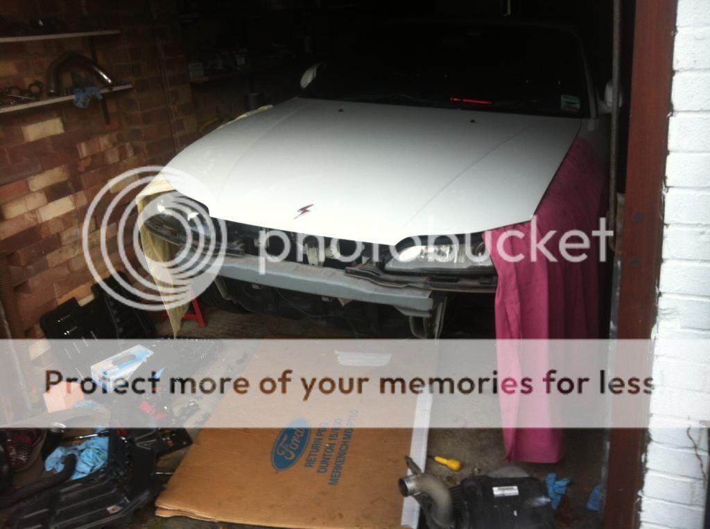

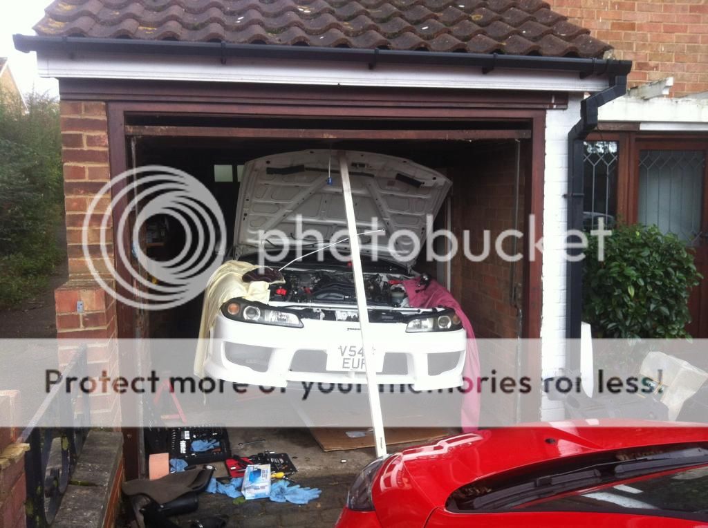

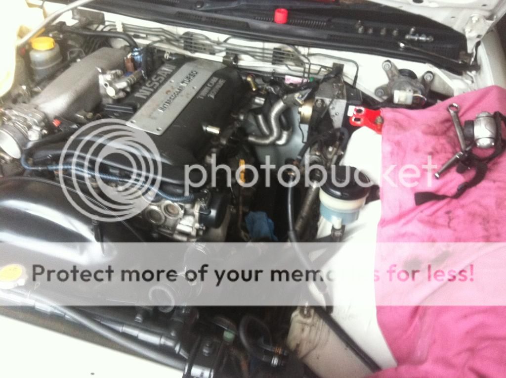

So this weekend was a very busy and productive one, first off I now have the benifit of having my own house with a garage so the 15 has had a dry place to stay for the last month and also a dry place for me to work in :) so after the recent overheating issues it was time for a strip down to find the cause. i had planned on doing this once the tax ran out in december to put on all my goodies but best laid plans and all that. So here she is in her new home in the middle of dissection (note the length of 2x2 because on AN axle stand the hood support is too long... and note only one stand because I cant get down the passenger side :()

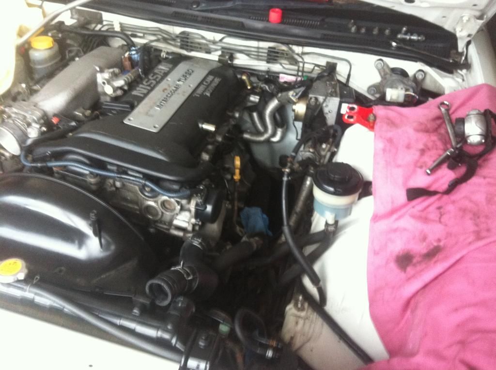

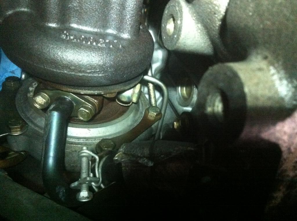

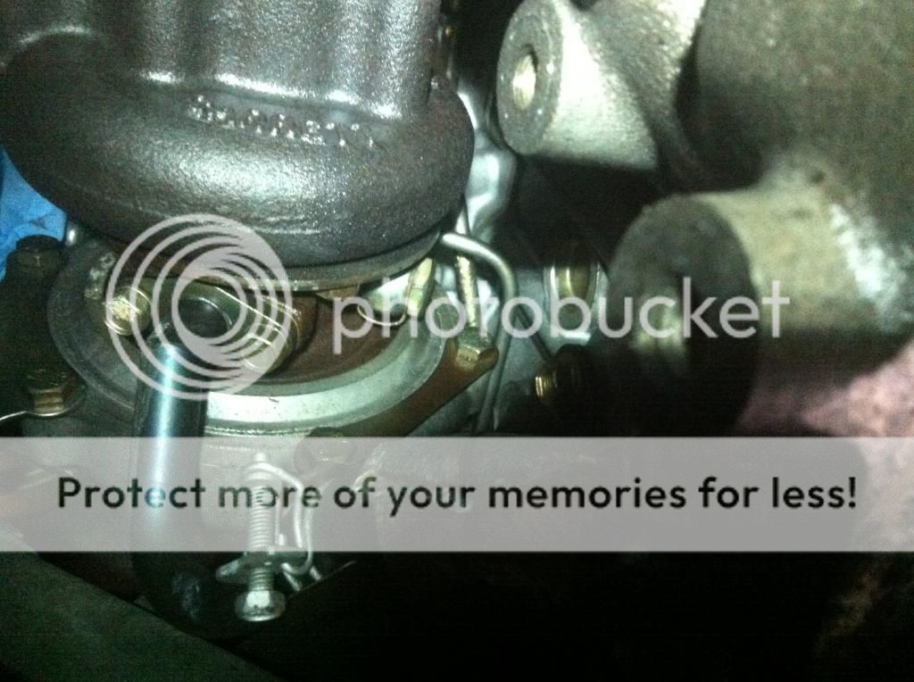

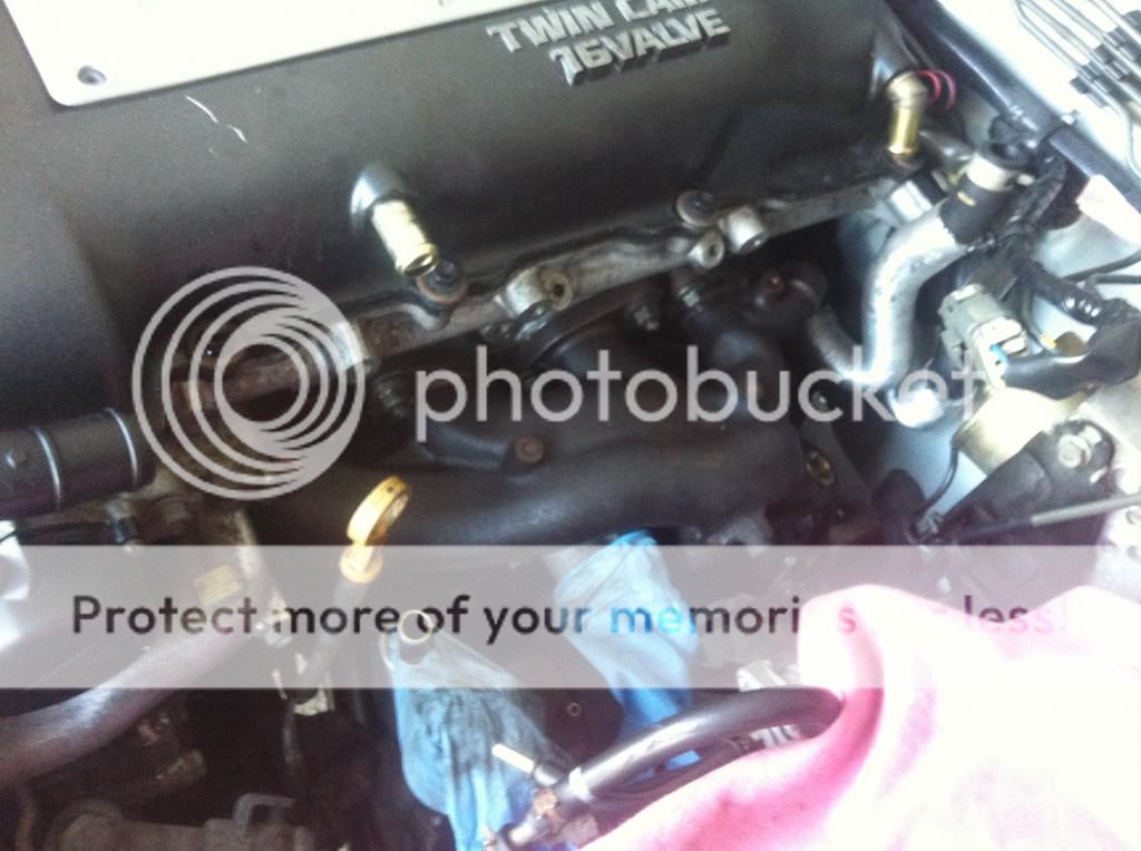

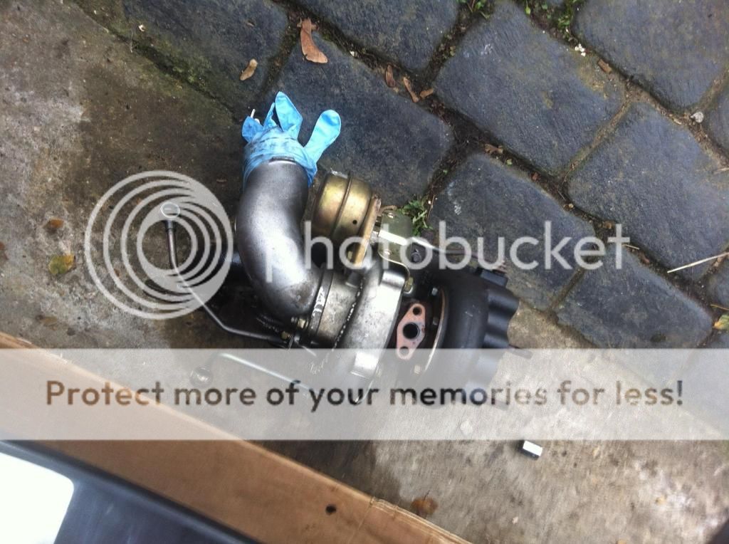

so anyway undertray and exhaust off (turbo elbow was a complete PITA due to the heat shield which i has to hammer the **** out of as i couldnt get to all the studs) and i was greeted with this:

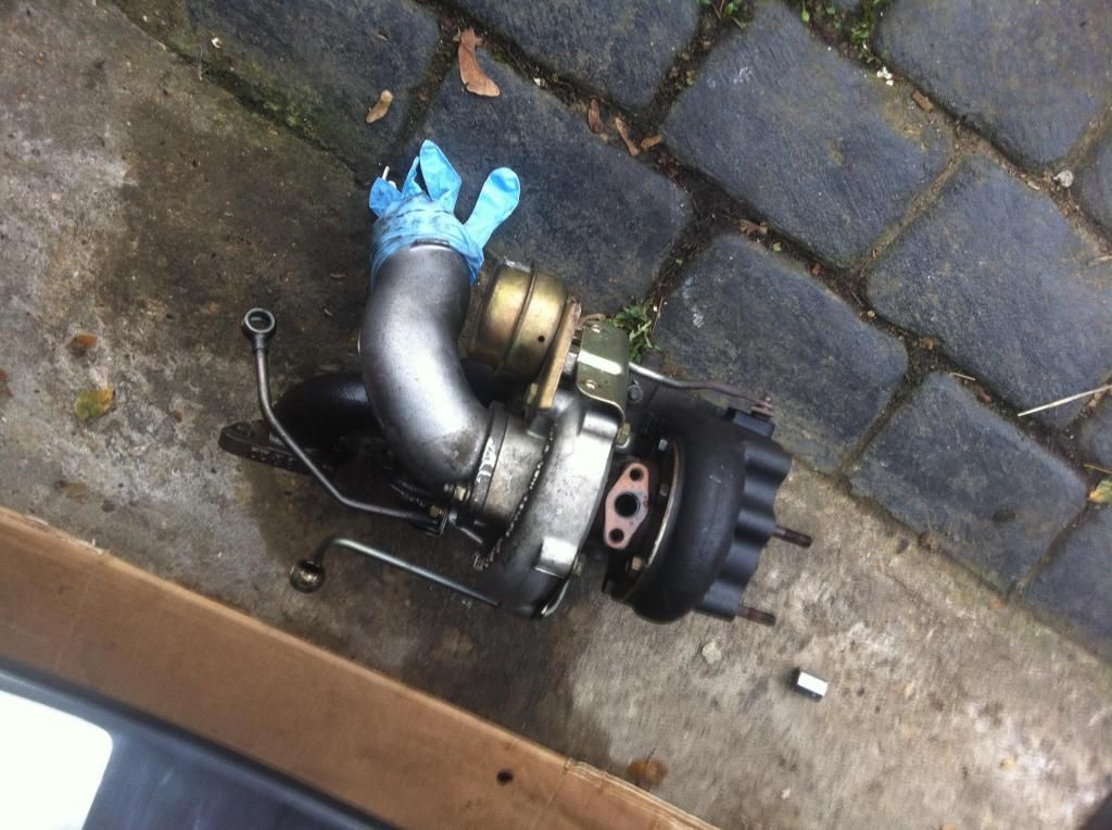

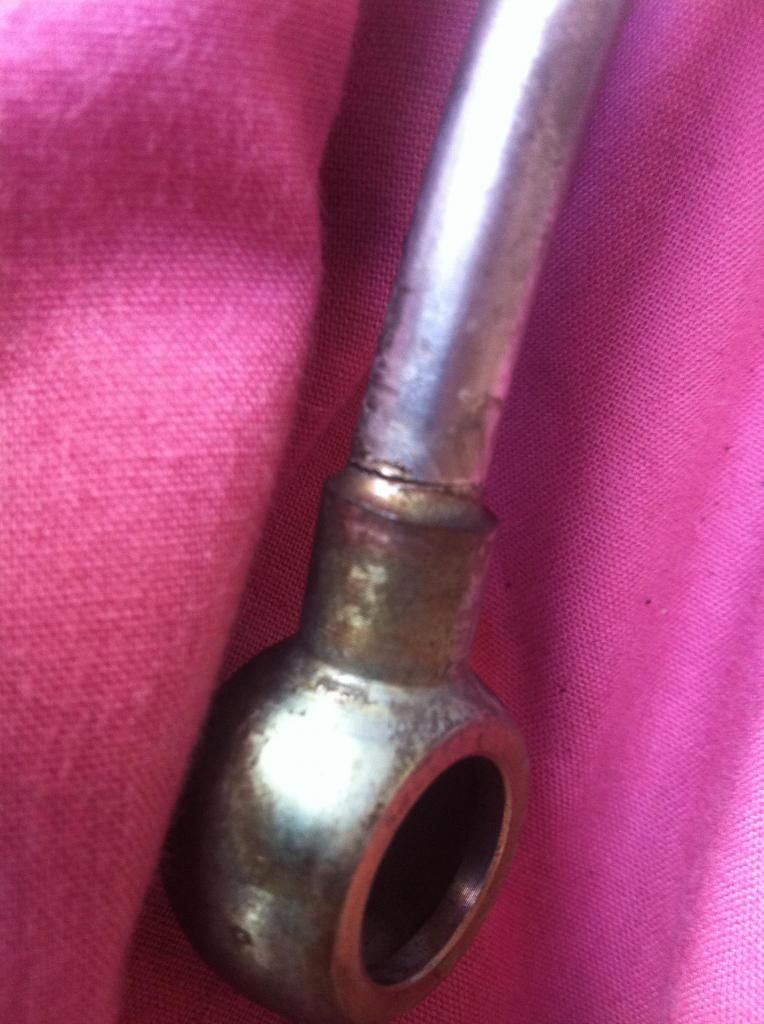

The water feed/return pipe was leaking from somewhere which is good because I'd found the problem but bad as it meant turbo and manifold had to come off and the fear of sheering a stud was becoming and ever more real possibility. WD40 my new best friend.
Anyway after much knuckle graising, swearing, cups of coffee and more swearing- she was free
problem solved

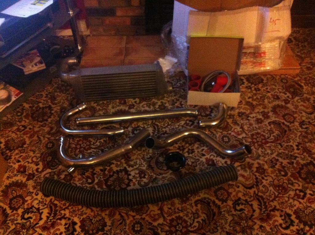

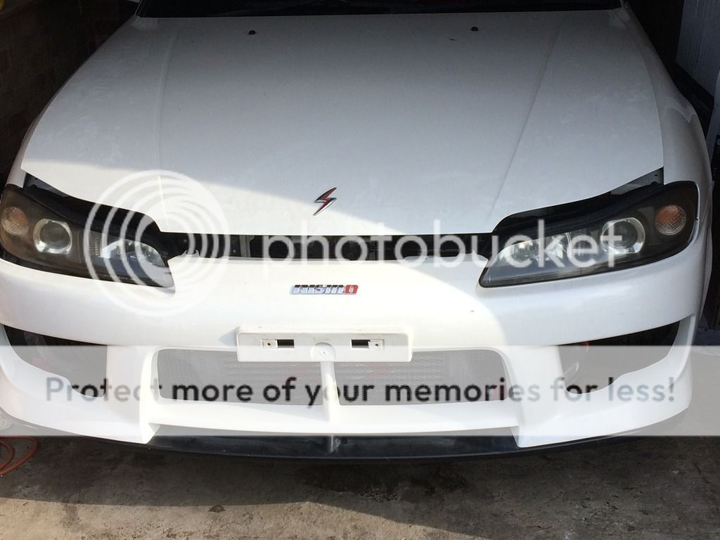

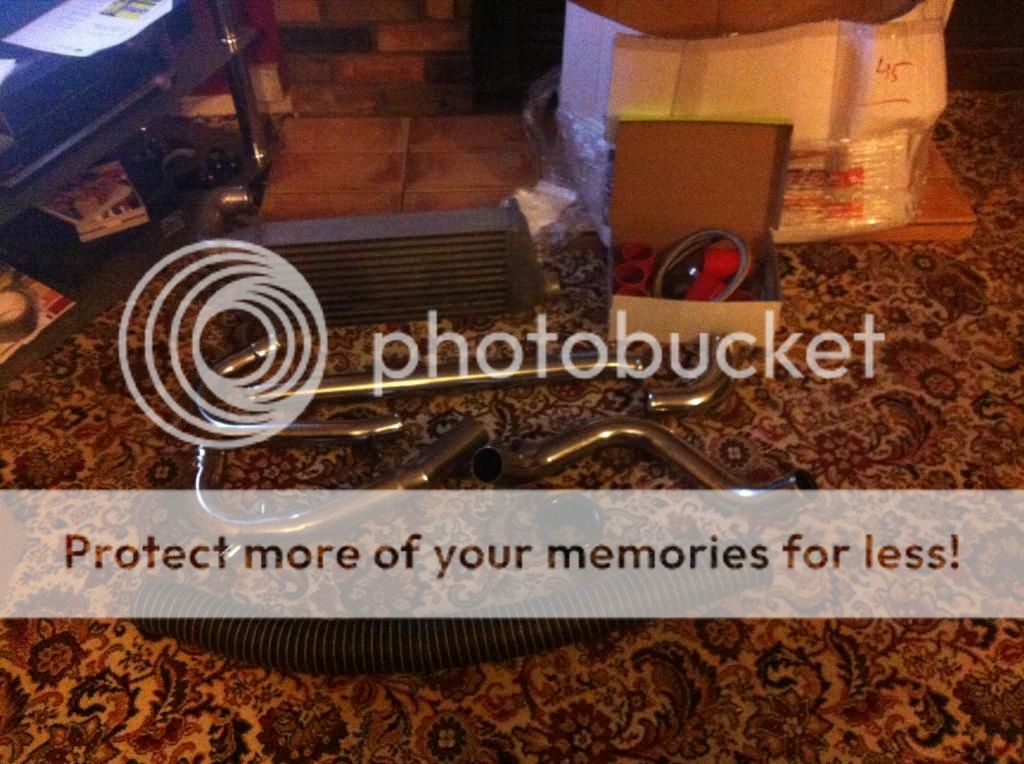

So, pay day arrived at the end of the month and I began work on the Silvia once more. I was waiting for gaskets and braided hoses to arrive so I made a start fitting my Apexi type 2 FMIC. For those of you who don't know this kit follows the existing intercooler pipe work with an extension bit to allow for the central FMIC. Even though the pipes are longer there is no cutting what so ever required and it fitted like a dream. Appologies for the shoddy photos, my flash is broken and it was getting dark and my head torch isn't much use for this as it turns out :)
I then had a mad rush of ricer blood to the head and decided to bling the core up a bit
How JDM do I feel :)
Some other little bits I did that were annoying me, firstly blacking the side grills on my bumper as they were white when I got the car and didn't look right. I also cut some black mesh for the front grill to protect the core and to make the front a bit more complete
and with bumper on:
I realise you cant see the Ricer-ness of my core with the mesh so may take it out again. I need to trim the bumper as it fails on the core- maybe an inch or so
Also the previous bumper owner had cut the mounts out for the fog lights presumably to fit a front mount so I made these at work- unfortunately there is not a lot left of the bumper to mount it to so i may have the fogs sitting further forward then use the mesh to fill around it- as of yet undecided on this

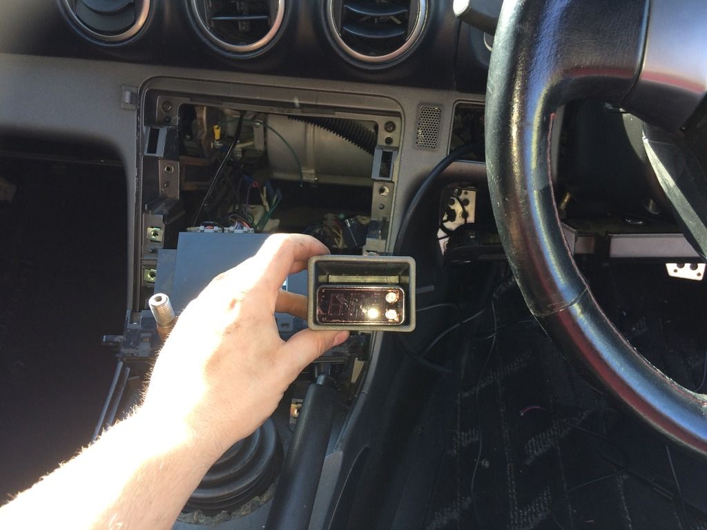

My Yashio interior bits turned up during the week so that jogged me into dry run this so i can work out where everything needs to go

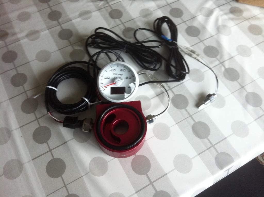

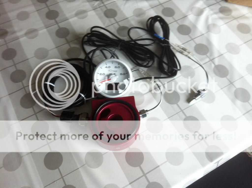

its a 4 in one gauge that does water temp, oil pressure,oil temp and volts looks like a nice piece of kit- need to get an oil filter relocation kit too because when working on the car I realised its bitch to get to.

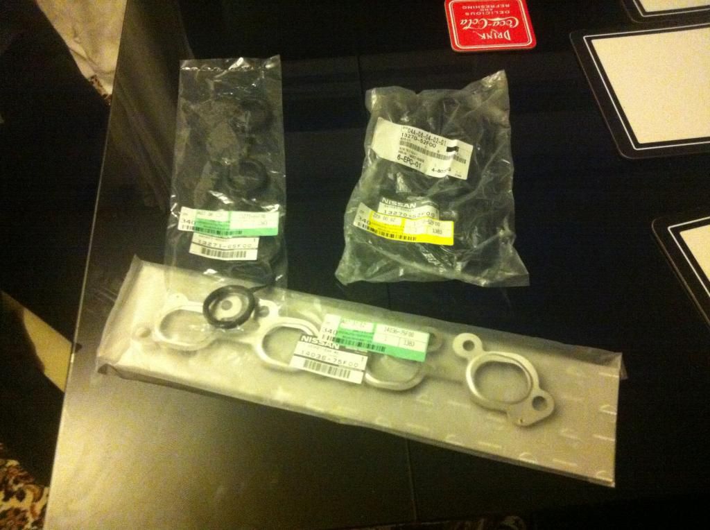

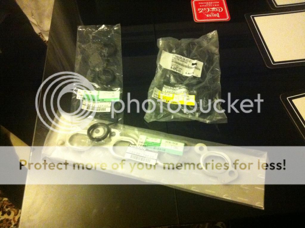

So this weekend these turned up:
manifold gasket and also both rocker cover gaskets for when I paint the cover :D
now I have all the bits it was time to assemble
braided lines were also on with new copper washers.

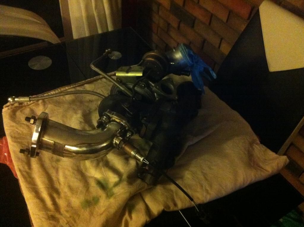

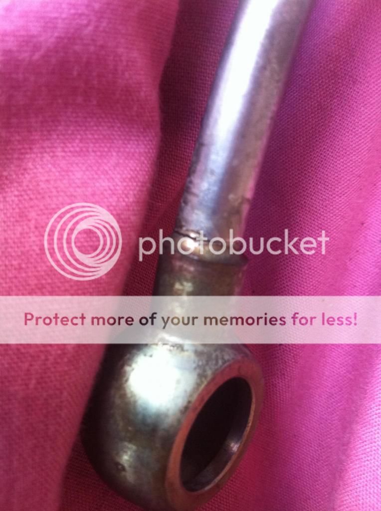

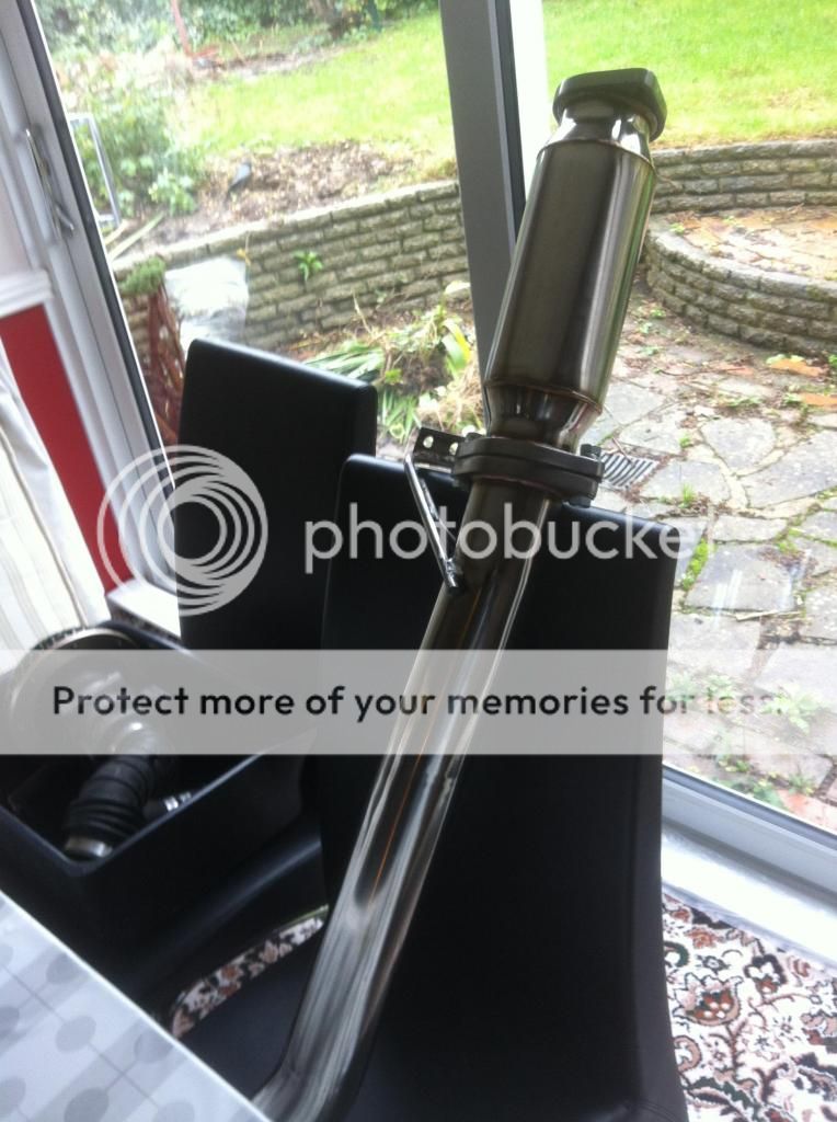

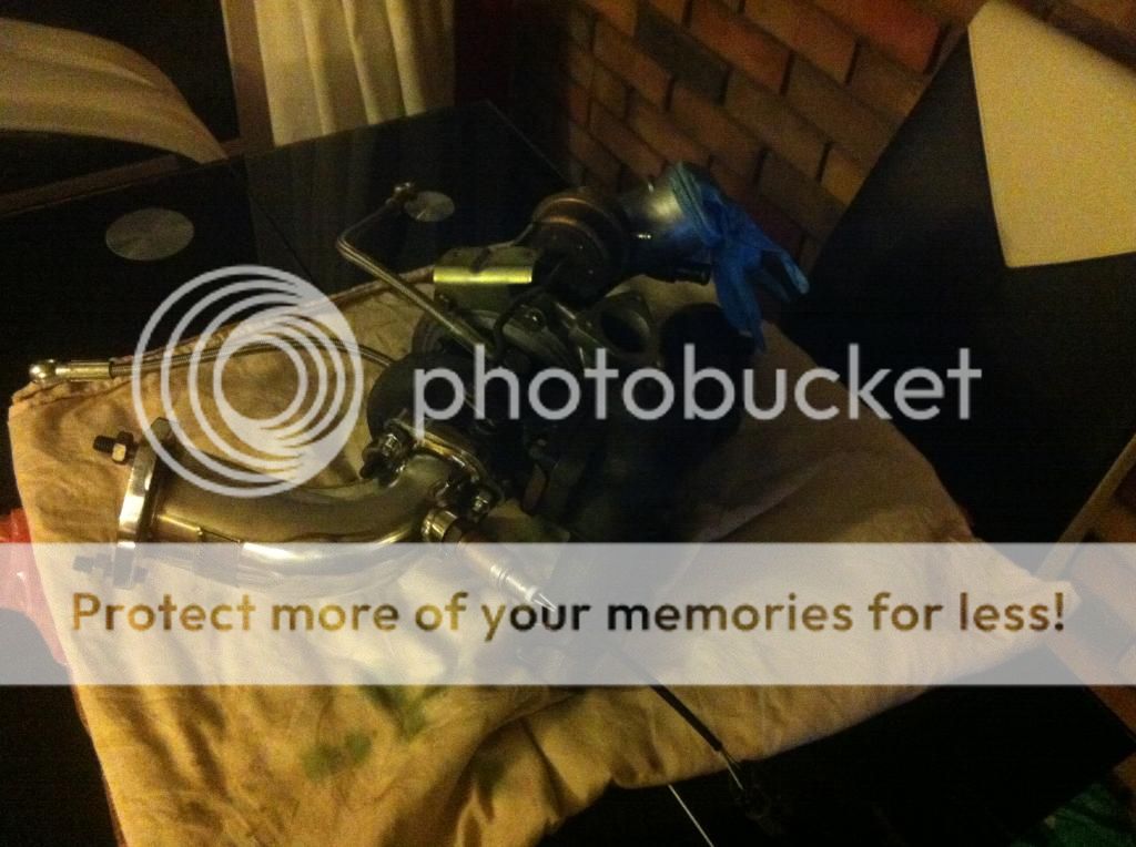

One thing I am very annoyed about and its my own fault is that I took the easy route (aka no no option) and bought toyo sport(ebay) downpipe and turbo elbow, the welds looked good and there was no splatter etc inside and looked good quality...the fitment however left much to be desired. Basically with everything connected the downpipe is butted up against the floor pan and the support bracket is about an inch short of where it is on the car. even with me pulling on the exhaust there is very little movement. I'm worried that by driving it something will definitely crack (down pipe or elbow). So my short term plan is to get some stainless plate machined to make a spacer between the elbow and downpipe till I have funds to buy a branded pipe. I'm hoping the elbow is ok but if not will have to invest in a Tomei one. A relatively inexpensive blunder at £90 but on something I know I shouldn't have done :( hopefully they will last till I get it mapped at least.
21 July 2011
500
England
I had an s14 elbow and downpipe and they did the exact same ended up getting a blitz down pipe and fitted bang on. Builds looking good pal be nice to see u back at shows soon.

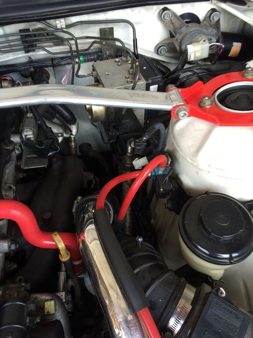

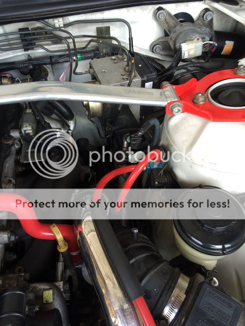

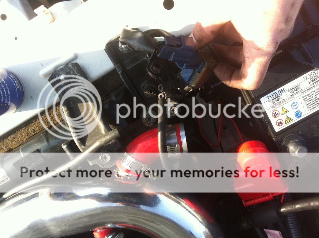

Another glorious day of sunshine today has spurned me on to add to the build thread as a lot has happened with my car since the last update. Firstly I had some of these delivered which i then took to a friends who is fitting them to my refurbed wheels :)
They're Pirelli Pzero Rossos from camskills, worked out to £100 a corner with postage which i though was excellent as the reviews i read said these were a very good tyre so time will tell.
A lot has also been happening in the engine bay- mainly finishing off loose ends, but since my last update quite a lot has actually occured :)
-carbon cannister delete
-fitted front mount

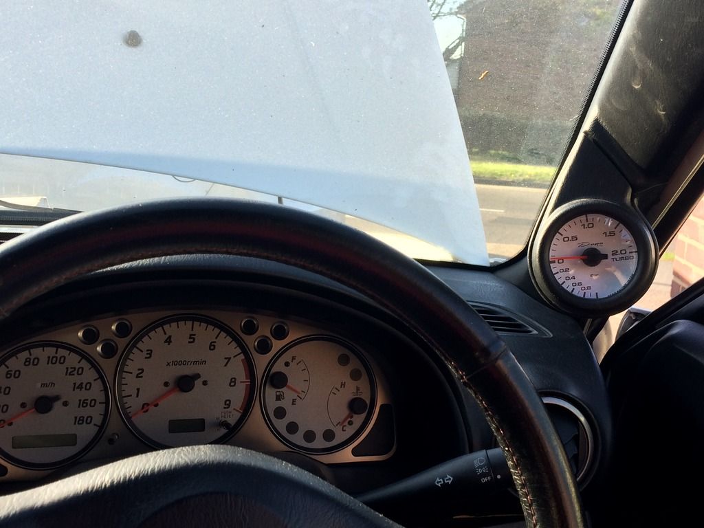

-fitted new boost gauge and wiring
-fitted water temp gauge
-fitted gizzmo EBC
-trimmed front bumper and fitted new grill
-replaced boost hoses with red silicon hose
-BOV delete for that turbo chatter-ness BRRAAAAAPPPP-chu-chu-chu-chu :D
so here are a few snaps as of yesterday afternoon :)
the drivers side isnt actually attached which is why the fitment looks poo lol

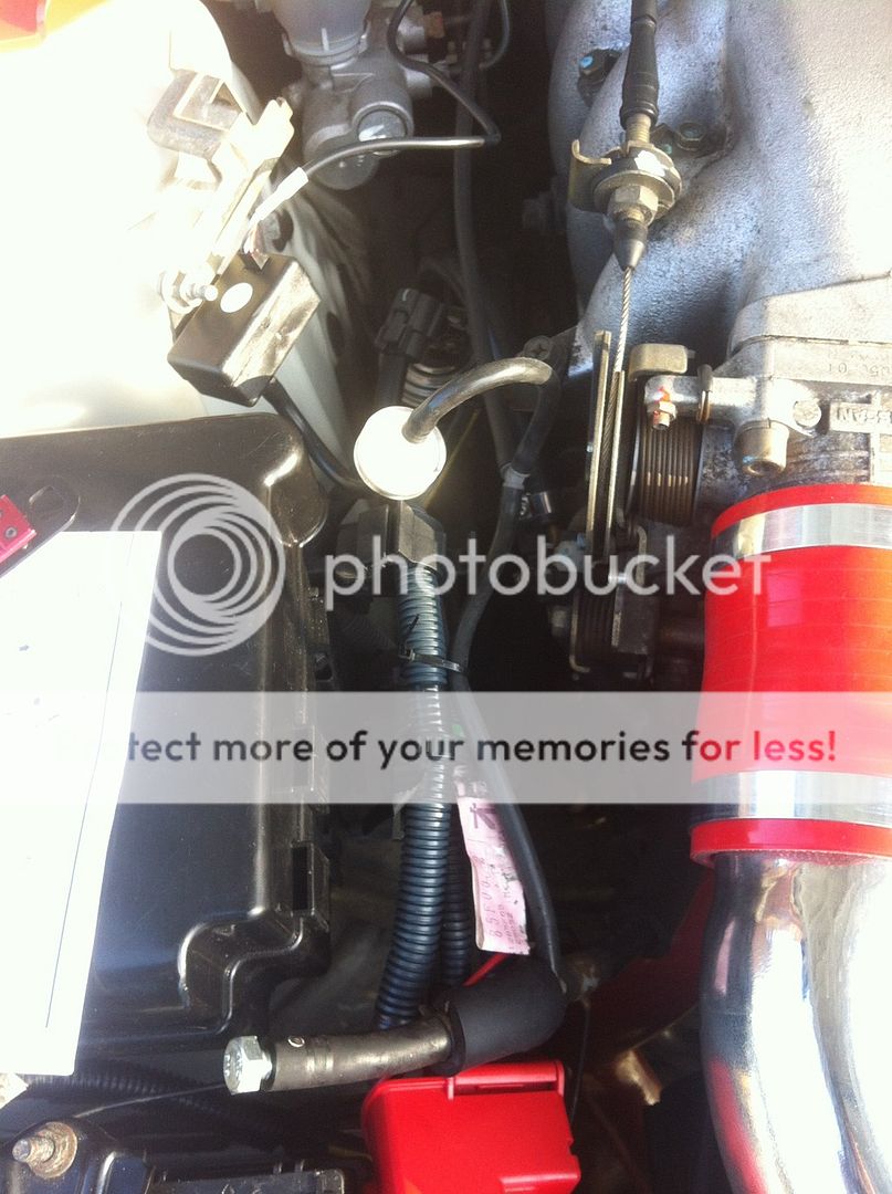

For future reference for anyone reading this, the best place to run your cables for anything is through the HUGE rubber grommet located in the Drivers side wheel arch, I stumbled across this by chance but it is very flexible and quite thin which allows you to get cables with plugs on them through no bother :)
lots of lovely boostness :)
Things I hope to get done by the weekend: run wires for oil temp and pressure (wont fit the sandwich plate as haven't got all the bits i need for filter relocation yet), fit the gauge in the centre air vent, top up power steering fluid, coolant flush/change, trim and fit slam panel and rewire the horns as took them off when i put on the front mount and havent re-attached them.
So lots gone on and a few steps closer to having her running and reliable before Japfest- I just hope i have no leaks from the water lines to the turbo.
I used a few of the useful links on this forum which turned out to be very useful (funny that) boost gauge install was a big help as was a thread on installing a boost controller and setting a 'safe' map on it if you cant get to do it on the road for setting duty and cycle, so thumbs up and a thanks to everyone who made these! also Nicely's guide on BOV delete/pigeon mod

Good work. Such a great spot for the gizzmo that eh? Did you ever get your Downpipe and elbow sorted? I have an old jperformance s14 Downpipe and s14 japspeed elbow I'm planning on fitting. Wondering what my chances are... Loving the look of yours especially with that FMIC. Does it alter the sound nicely? I pretty much want to do all of those things! Doh so much for staying completely standard... But at least it's sensible modding. :thumbs:
24 January 2013
1,220
Kent
yeah fits perfectly, might blank over it so it looks like it is supposed to be there and not just stuck in a hole lol. It will fit but its flush with the the bottom of the car, I think its the down pipe that's the issue, I'm just hoping it doesn't put too much stress on the manifold or turbo. I will be replacing with a Tomei elbow and HKS pipe once i have the cash. As for the sound I haven't run the car since the water leak so have no idea what it sounds like!
