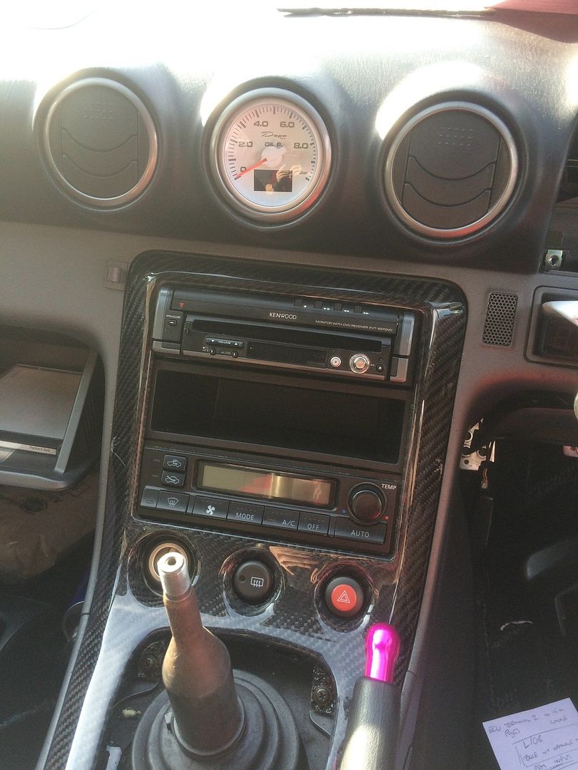

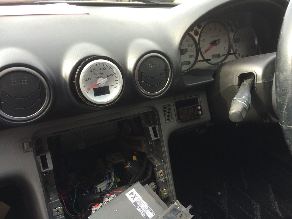

got my centre console back together all looking rather neat- few small things to change though. Firstly the diagram for the gauge was slightly wrong, the water temp socket is actually for the oil temp so need to swap those around which is nothing and also I forgot to instal my signal booster :(
And I soldered in my boost controller but like a tit i soldered it to a constant 12v positive and not an ignition live... so cluster needs to come out again. And for anyone wanting to do an EBC install below are the wires and colours you need:
All can be found on the white plug on the back of the instrument cluster:
Constant 12v: Red with White stripe
ignition live: Green with yellow stripe (pin 12)
RPM signal: Blue with orange stripe (pin 15)
ground: black (pin 9)

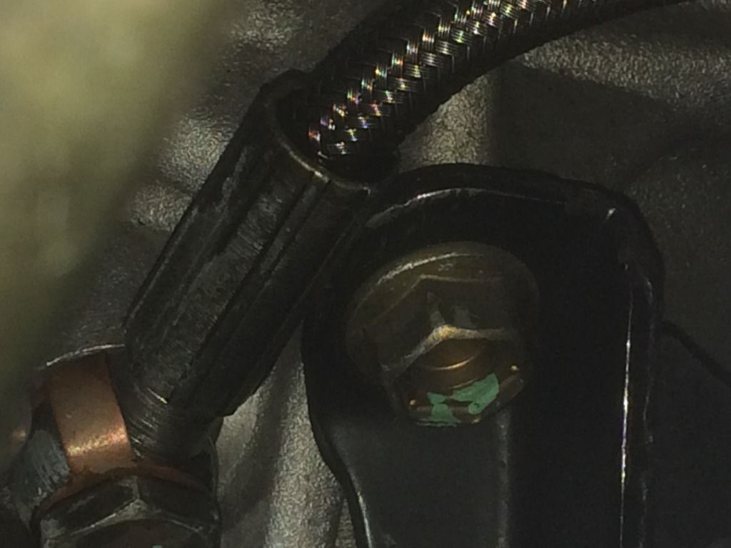

And now to the bad bit, topped her up with normal tap water to give the system a slight flush as I'm changing antifreeze colours (green to red), checked the oil level which was all good so started her up. Sounds evil with a De cat and the turbo flutter with no BOV sounds so good! water temp was bang in the middle after 15 mins, no leaks that I could see and the water was flowing inside the rad. I then started to squeeze pipes to bleed the system of any air locks and when i moved the car on the drive found a massive oil spill. after some brief detective work i found this:
My new HEL braided oil feed for the turbo is faulty, and obviously its a bastard to get to the bolt on top of the turbo so off came the manifold, and some water lines- at least i knew everything would undo easily. emailed hose solutions and they are sending a new one out today, to say i was gutted was an understatement :(
