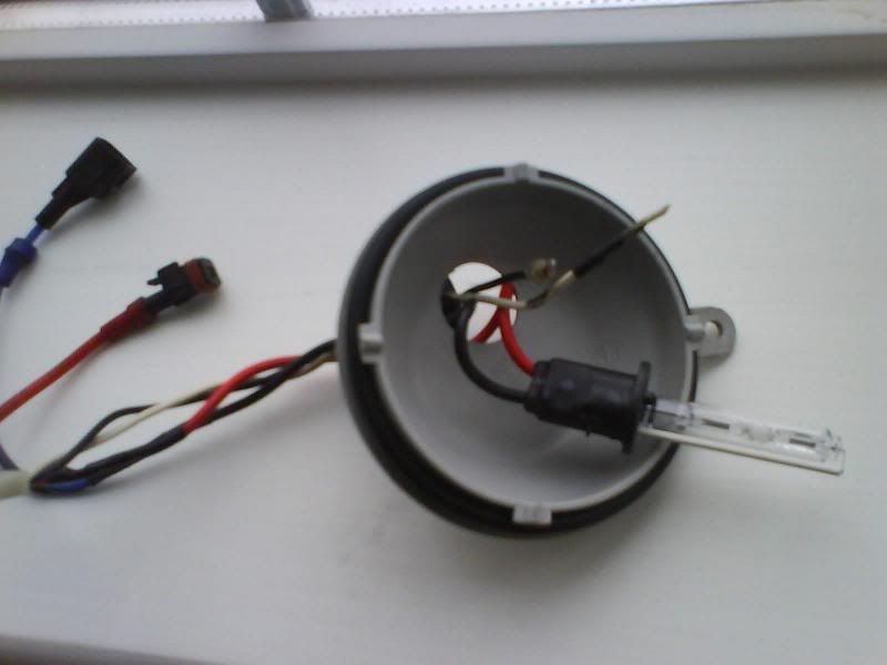

this is the bulb i removed, should be fun at the motor factors try to get one of these. theres 4 wires in it :confused:
You must have some kind of HID kit fitted do you? I dont have a hole in the cover for my lights :no:

Yup HID kit fitted , where the hell am i gonna get replacment bulbs ... just tried a motor factors there and they rang three different crowds but no joy.
looks like a h1 connection but the bulb is wired direct.

you would not get hid kit replacement bulb in local motor factors.
i would try ebay....
Are you sure it's the bulbs?????? as they are gas they should never blow.
i would try swap the other good bulb into the bad light fitting see if it works. if your bulb still does not work it would be your balast thats blown.
balast are a more common fault then the hid bulbs.
Also if your gonna change the bulb do it in pairs to make sure the colour are the same. or you will look stupid with different colour lights.

What you need there is called a relay kit..
when you flash your high beams your cutting power to the low beams for a split secound, and is normally enough to causes the bulb to go out. this is just because the gas bulbs need to build up charge before the will stay on. (you may notice your hid light on start up gives a bright flash the dims and slowly comes on full)
the relay kit just allow the balast to to feed striaght from the battery so when you do flash you high beams the cut in power down not effect you low beams as its got direct feed from the battery.

Page 2 of this thread covers all the problems you are having. Those HIDs are definitely an aftermarket kit. Its a prime example of why you need to fit an uprated loom and the relay kit mentioned. Your bulb has probably died due to constant re-ignition from flicking from high to low beam. HIDs need to be wired so that they stay on for low AND high beam, so that there is a constant power supply to them (there is a brief interruption when flicking between high and low beams which causes the HIDs to re-ignite), and to ensure the HIDs don't ignite when 'flashing' lights during the day.
DO NOT be tempted in any way to get 10000k bulbs! Don't even go higher than 6000k. The light clarity they give out is WORSE than standard halogens. Anyone who has driven an S15 with halogens will tell you that its a major achievement to have bulbs that are worse! In fact, in the UK 10000k bulbs would get you a producer due to the colour.
