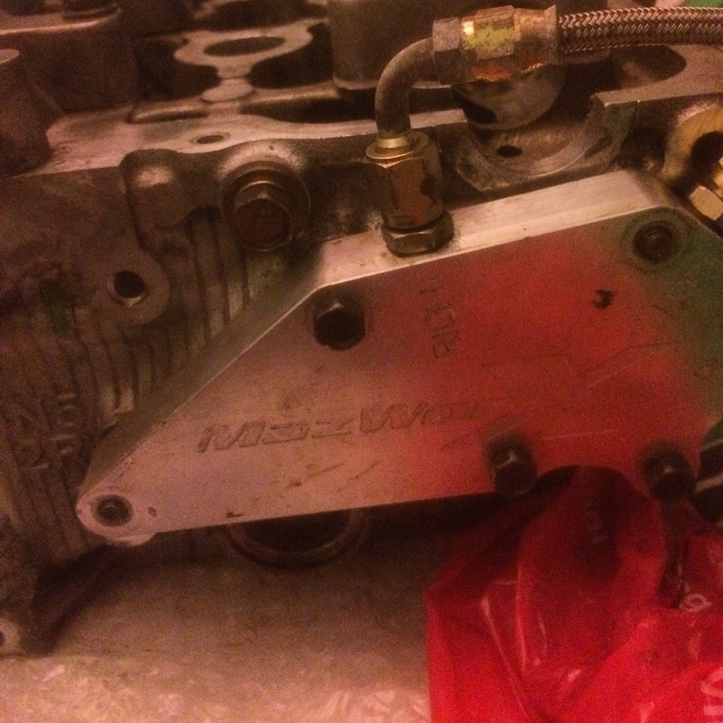

So I haven't been updating this recently BUT I have been working behind the scenes to get a few things in place.
It's been hard work trying to juggle setting up my business , kit out my workshop and build this car while still holding down a full time job ha ha
So to delay no further , the first pieces of my vet build are in my possession!
Ati super damper
Neo vvl cylinder head
Cylinder head oil feed relocation kit to put the vvl solenoids in the right position for rear wheel drive.
Custom 36-1 trigger disc setup mounts onto ati super damper, replaces the cas as the primary trigger sensor and eliminates spark scatter. This is important with the vvl as the standard vvl cas does not fit with a red setup
Modified vvl cas to allow full sequential cam triggering with use of 36-1 trigger kit.
Custom neo vvl oil pump sump pic up to allow sr16ve n1 oil pump to be used on sr20det block
Greddy vernier pulleys
Aem pencil coils
Cdi ignition system
Left to collect are rocker cover , custom cams and Supertec valves and springs and that's the head all sorted !
Better pics to follow
