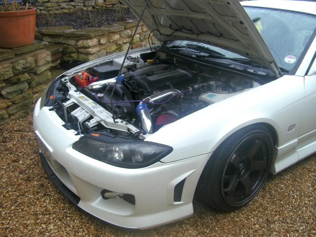

James can you do me a favour and take a pik of the set up so I can see what it looks like :)

This is the only photo i have to hand mate although its a bit crap to be fair as its hard to see!
As you can see the pipe at the front right of the engine has a cork in it! Theres no out going pressure there so nothing will push from behind it.
Over on the left side can you see the yellow cap? Thats just literally a kind of bottle cap thing i had laying around and then wrapped a couple of zip ties around it! Before i installed the FMIC i had the broom handle end jammed in the stock intercooler pipe (literally the same location) where you remove the recirc valve. That yellow cap holds 0.9bar fine! Make sure you secure that side in tight though with some super glue or something like that as the pressure behind it can make whatever you put there fire out like a missile!! :D happened to me a few times before! Have fun!
