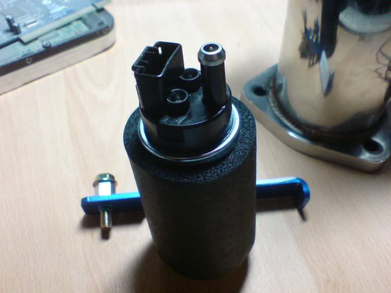

ALSO.. does anyone know if the Walbro pump (I can't get to mine now) has AN or pipe threaded fittings - or is it just a barb?
42
My walbro didn't have any threaded fittings on it.
