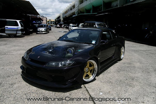

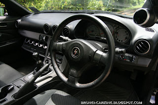

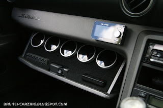

24 August 2006
588
Trinidad
Some professional pics from a local Silvia Meet lastnight, it was a nice time. More to come,
