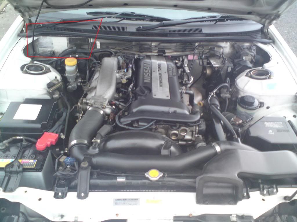

The Vin should/will be stamped on the bulkhead. If should be to the right of where the bracket for the Servo is bolted, just above where the brake pipes run across. You will have to crouch down slightly and look up. It may be covered in dirt as well and need wiping off. If it's not there I would be concerned!
HTH
Mike
