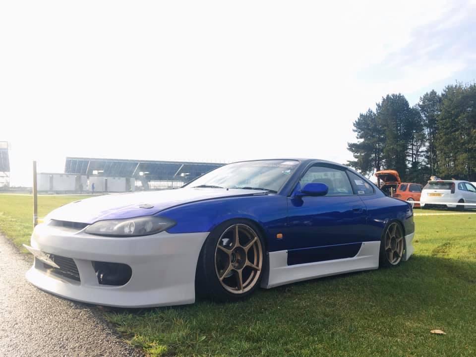

Wow you really did drop it quite low once you got the HSDs :lol:
I think they work quite well.. are you taking the photos with your phone? It doesn't seem to like the blue colour of your car, makes it a bit purple :eek:hwell:

Getting my monies worth in adjustment haha
That was someone else's pic from a meet yesterday, it seems to change colour on when, where, how and who takes the photo haha

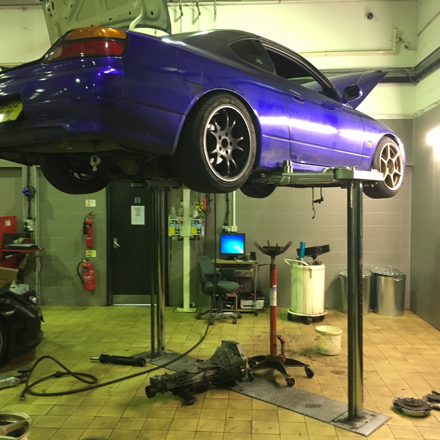

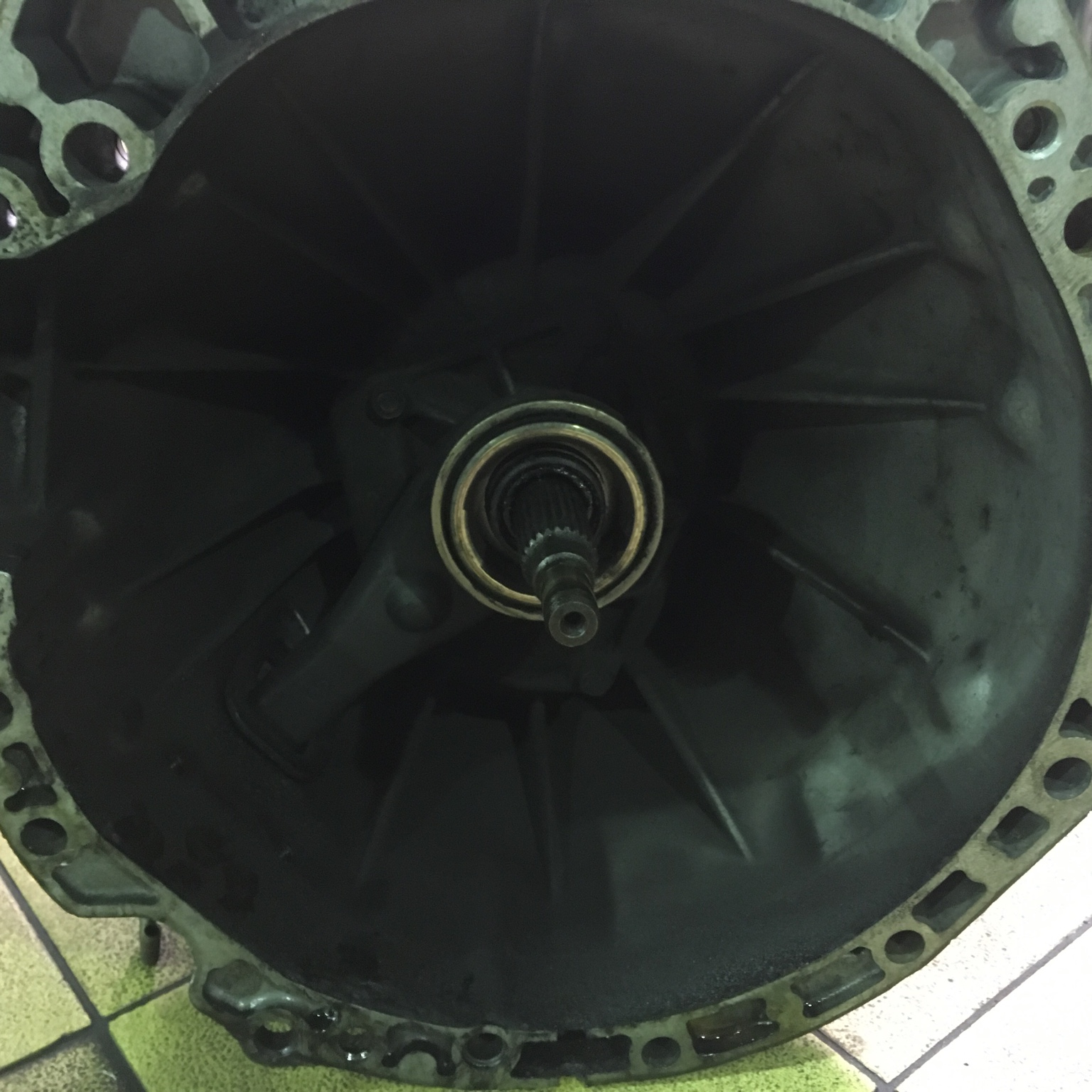

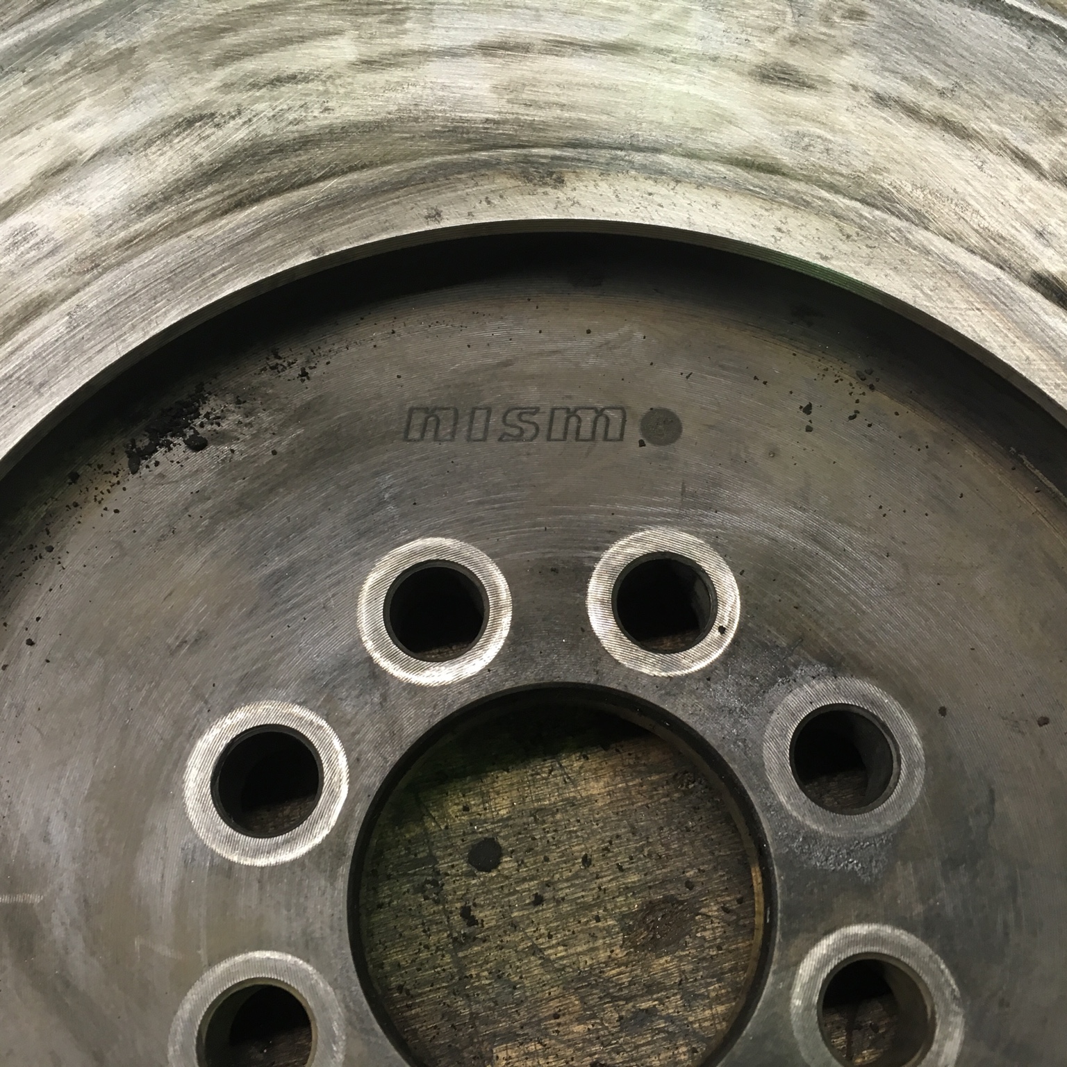

Clutch problems led to this happening today :( much broken-ness!!!!
But did find a Nismo flywheel already fitted in there :)
Didn't get any pics of new stuff going in but now has a 3 puck Exedy, not back on the road though, clutch needs bleeding and the back end feels like it's completely disconnected so need to look into that

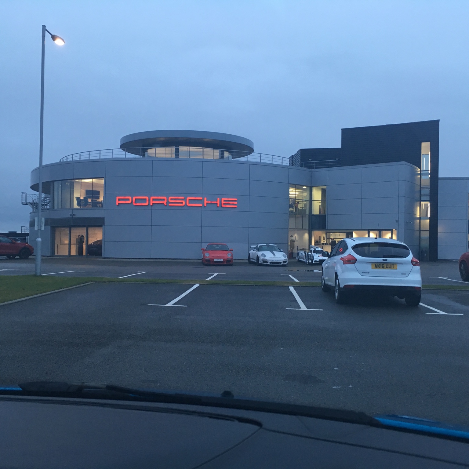

Break from hard work, 2 days at the Porsche driving centre at Silverstone :)
Just thought I'd share some of the awesome cars here
Building itself
919 hybrid racer and GT3's
A genuine 550 (valued at 4.8 million!!!!!)

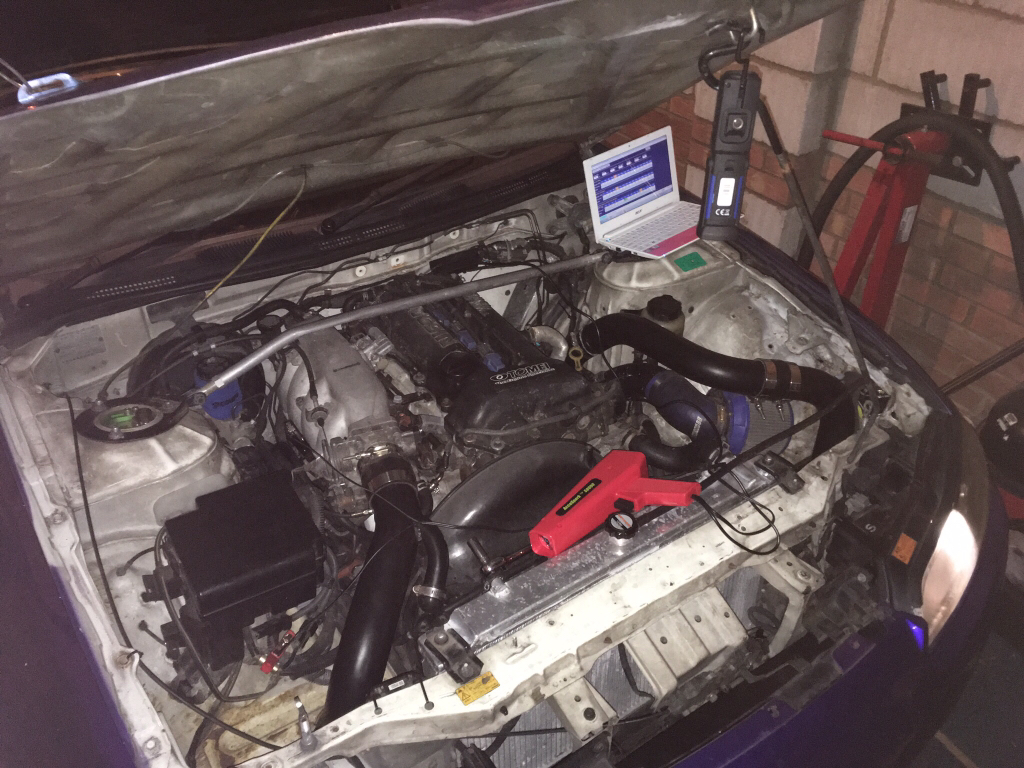

After loosing my Reytec software disc in my garage fire last year had to buy another one from Japan as my mapping laptop died :(
So £75 later for a CD ROM!!! I'm back up and running after the battery went dead flat and the ECU lost its map :(

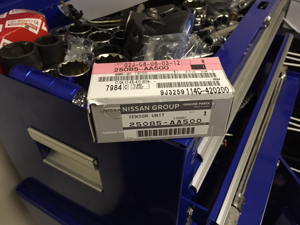

Then my MAP sensor died so another £85 sent to Japan for a new one :(

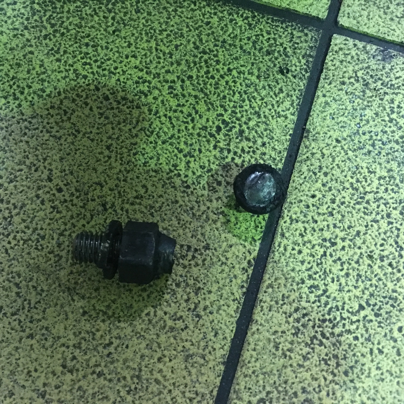

Now just to add more problems the 3 bolt flange on the turbo has decided it doesn't like being bolted to the turbo anymore!!!
Oh the joyous life of S-Bodies!!

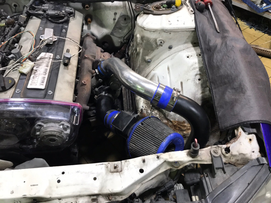

So while I have the intake taken apart I've redone my air filter relocation, obviously the best idea 3 days before Japfest haha

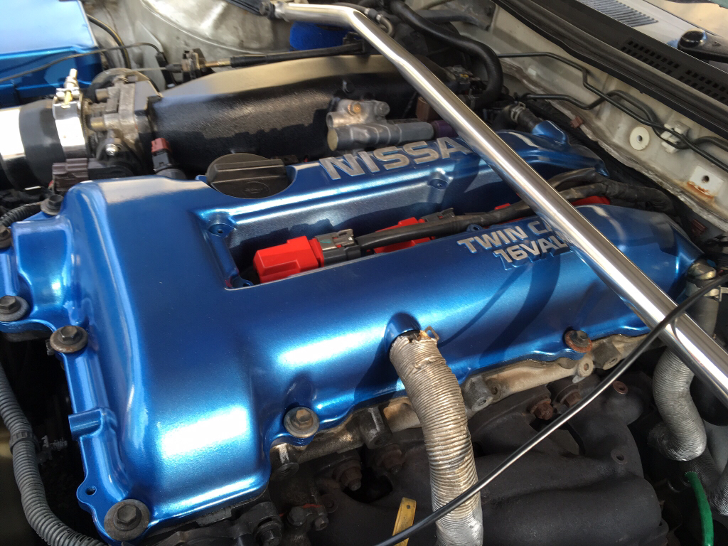

Also thought I'd chuck my homemade shotgun pipes back on :)
And make it look abit prettier under the bonnet too

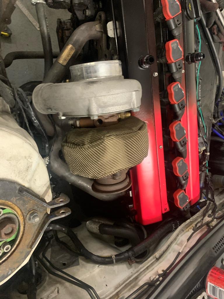

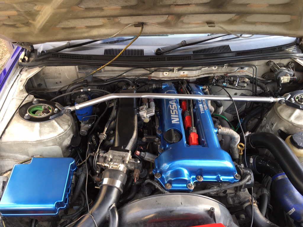

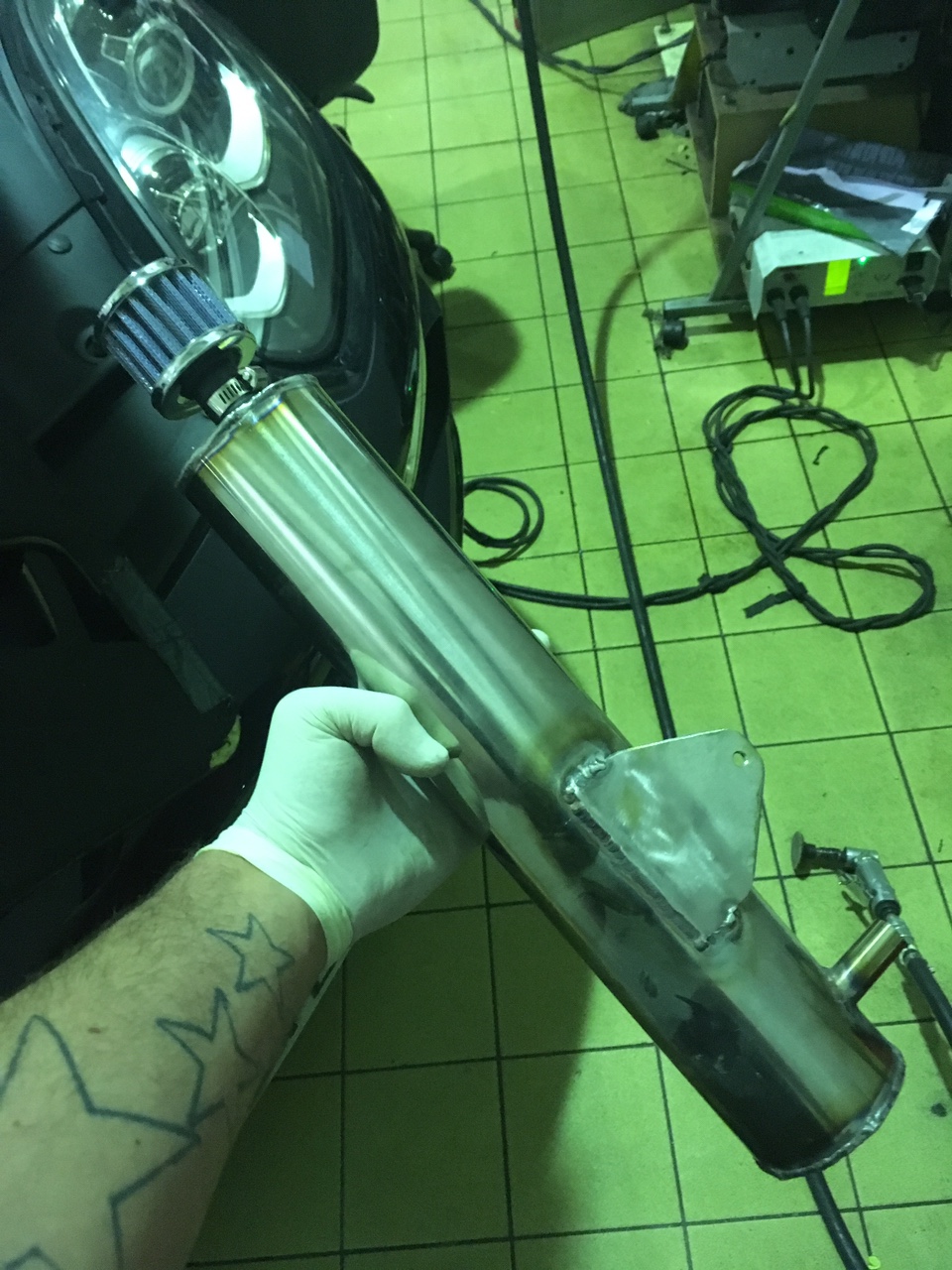

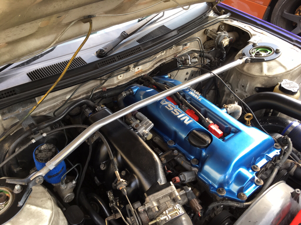

So not much change but I have made my own catch can after seeing the GK tech over radiator one thought I could build one significantly cheaper
So behold my £25 catch can!!
(strictly speaking this is the wife's cars catch can as I made 2 at the same time but you get the idea)
Here's mine fitted alongside the new coil pack cover I made at the same time

Put some vents in your coil pack cover, it will dissipate the heat better...

Could add them in the form of some funky louvres?
Catch can looks awesome, nice one!

Cheers man quite pleased with how the can came out!
I've spaced up the coil pack cover to allow the heat out as it's not flush with the cover.

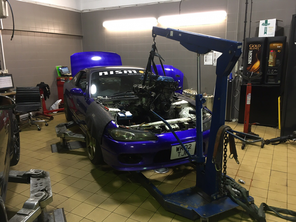

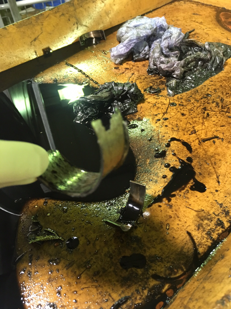

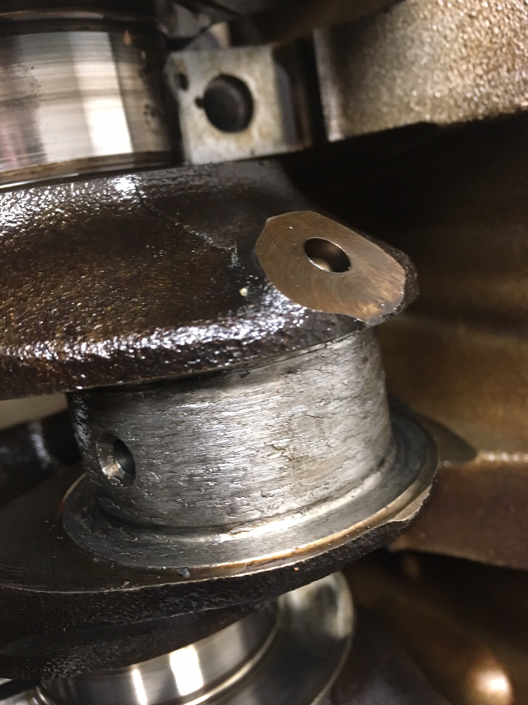

Then in October this happened

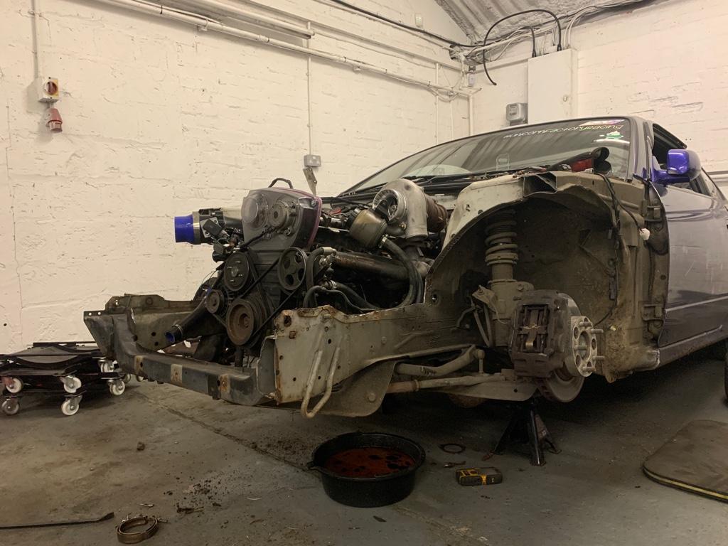

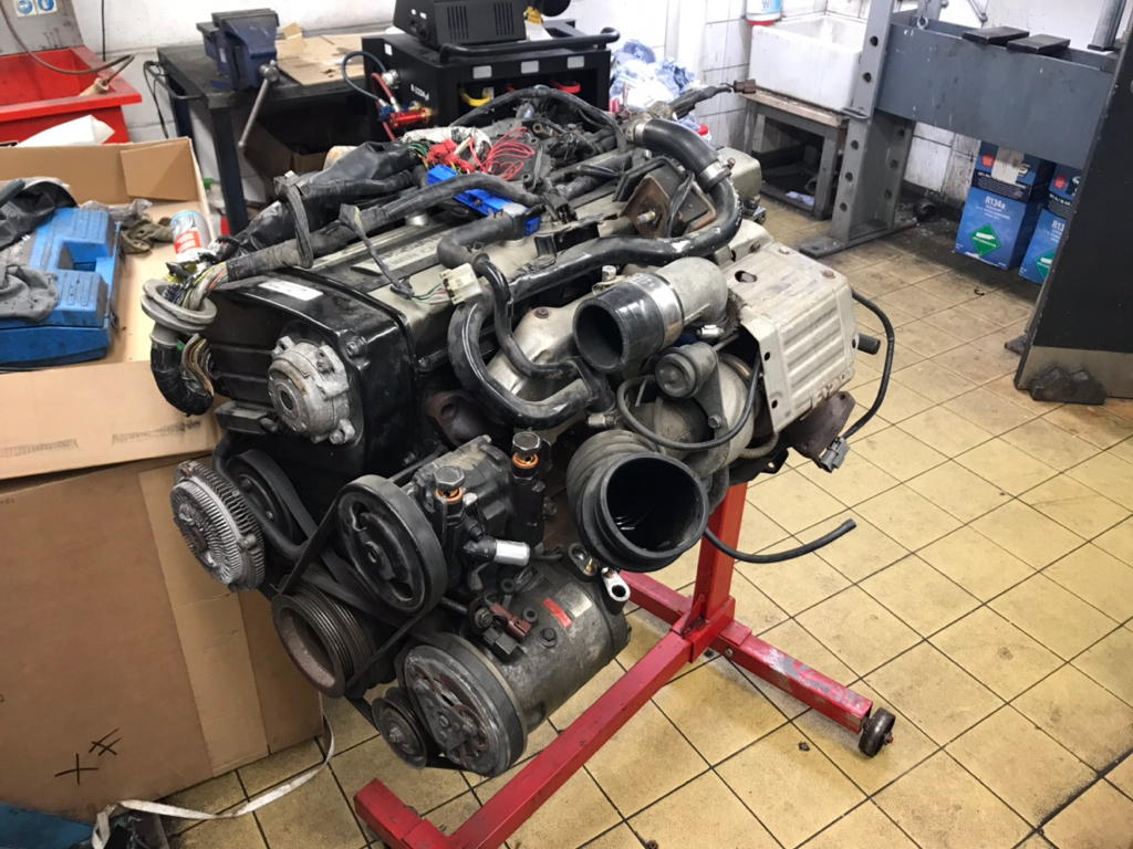

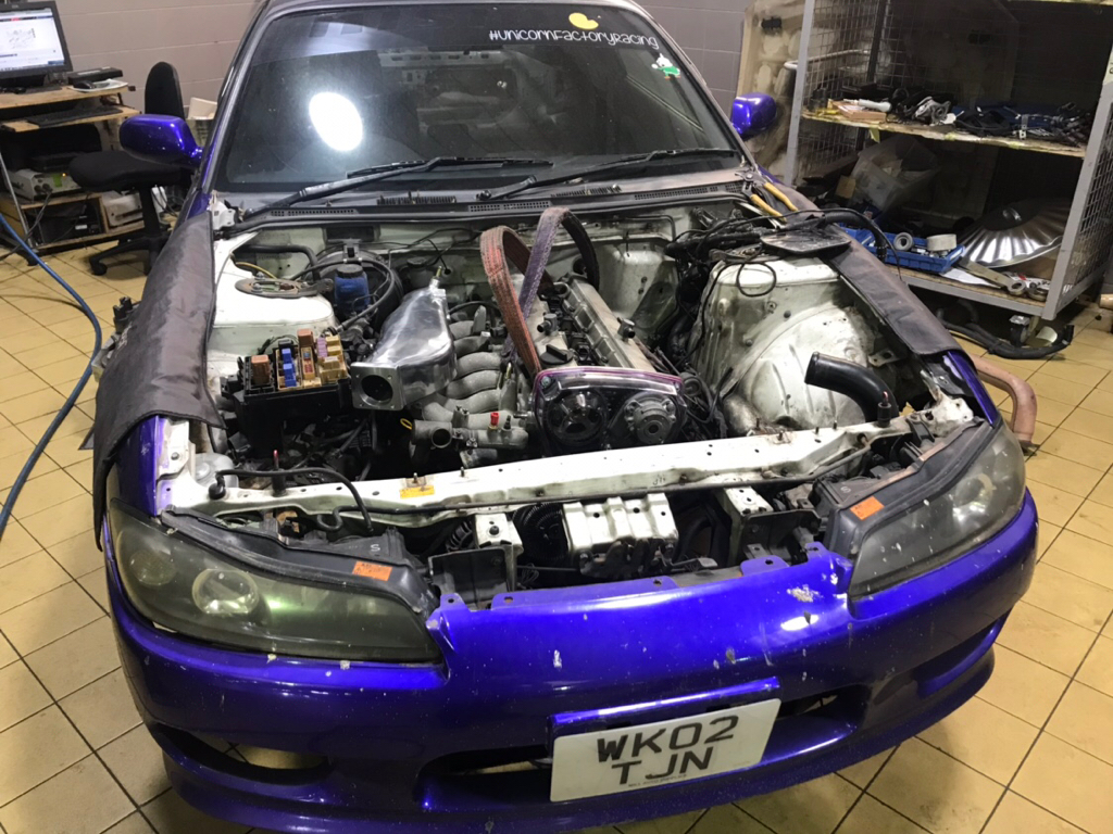

So obviously that was the end of my SR

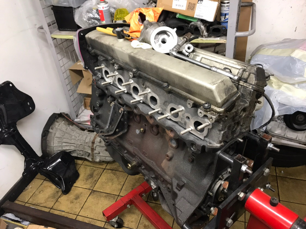

Took the crank to my local machining shop and they measured up the crank to find it was bent :(

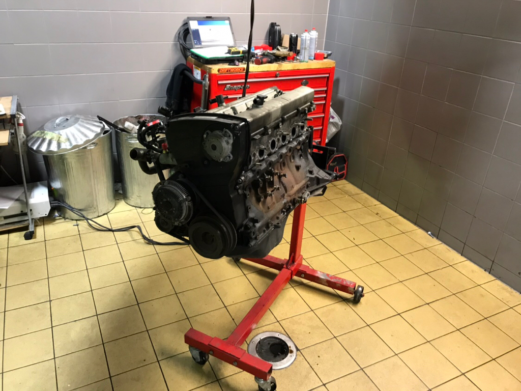

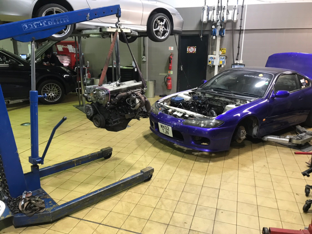

So after a bit of soul searching decided to get myself an RB!

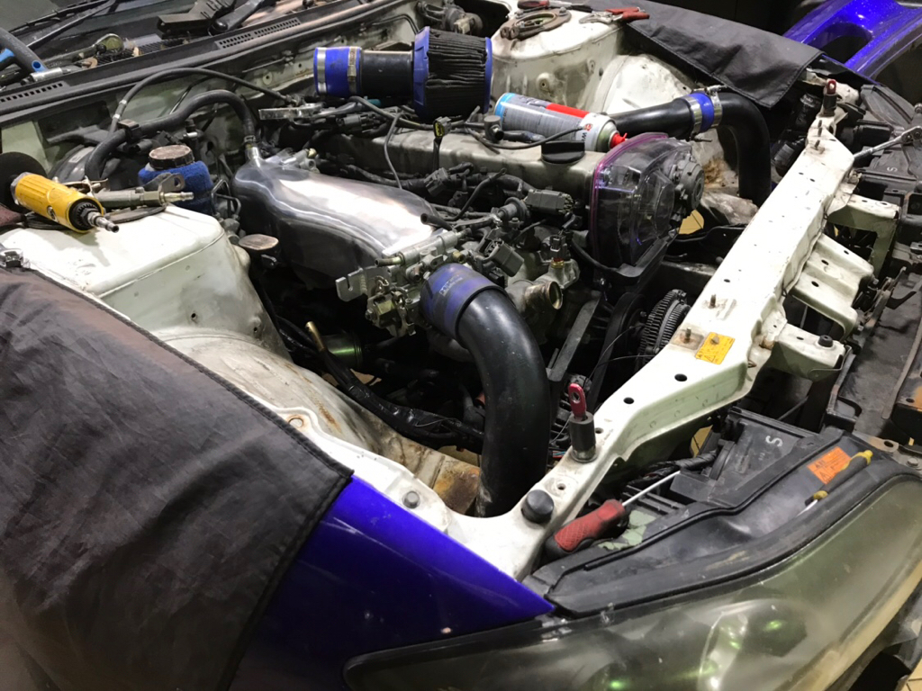

Removing some extra unnecessary bits
Stainless exhaust studs

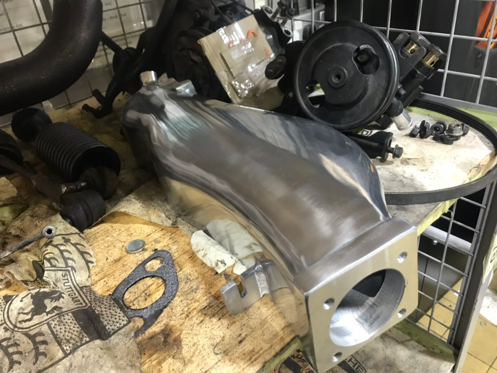

Front facing plenum
Going in

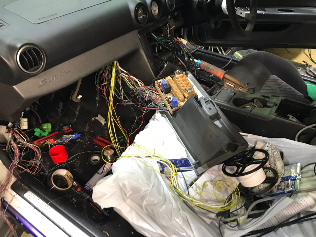

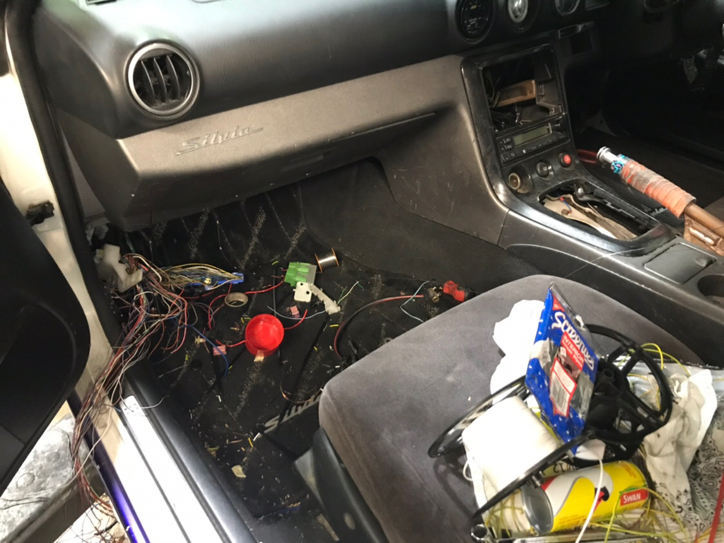

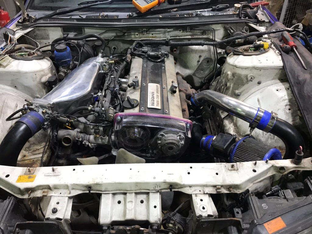

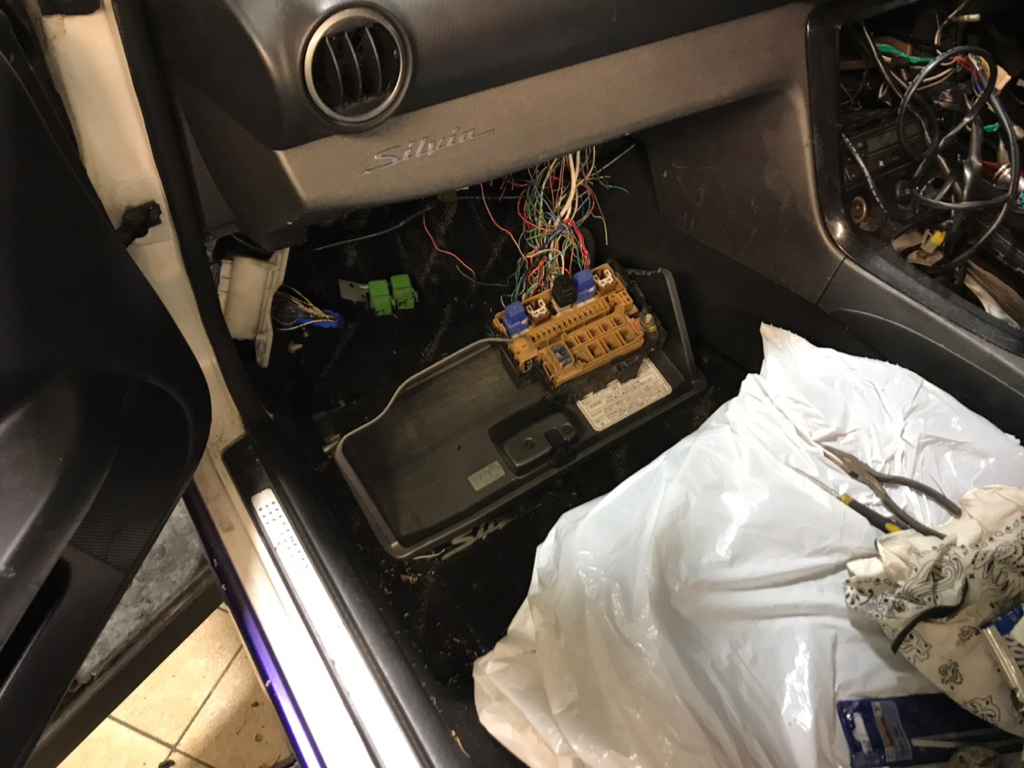

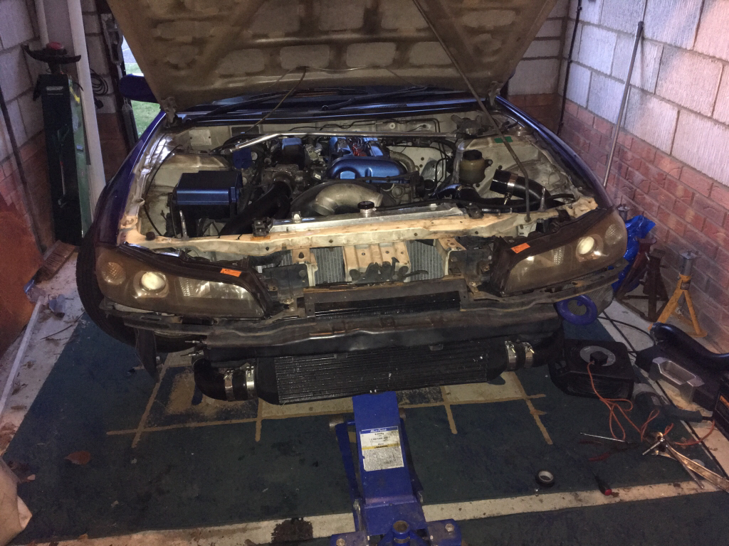

After getting it sitting on the new R33 subframe with a relocated steering rack mountings (moved the mounts by 20mm) and my now de-powered steering rack
Unfortunately my throttle body and fuse box wasted to occupy the same space :(
So I had 2 options, move the fuse box or fit the original plenum, so naturally went with the stress free and easier option of moving the fuse box!
All hidden in the glove box now

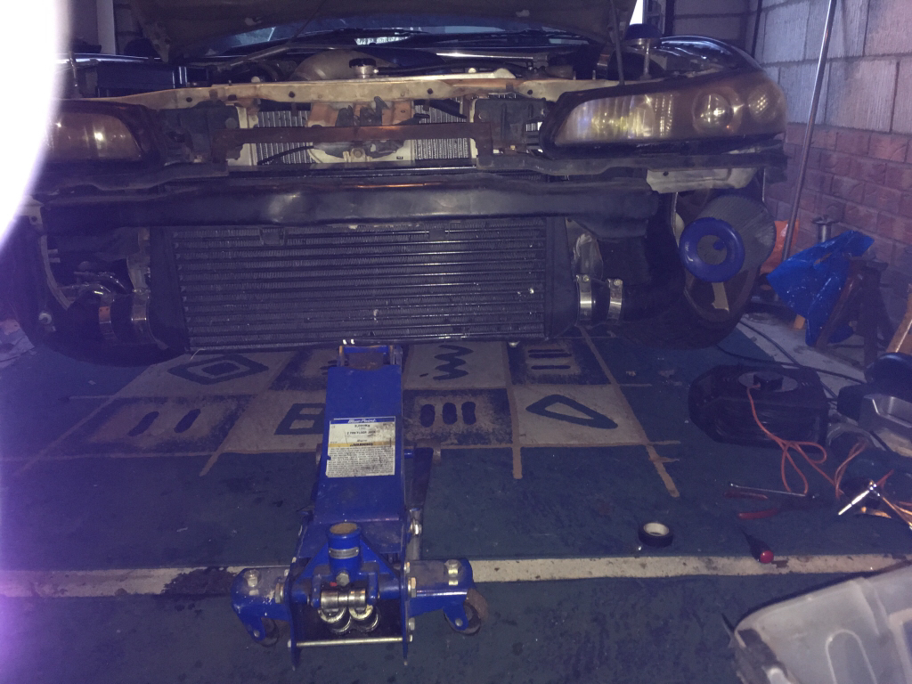

Had a break from wiring and sorted the pipe work for the intercooler

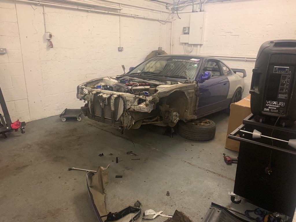

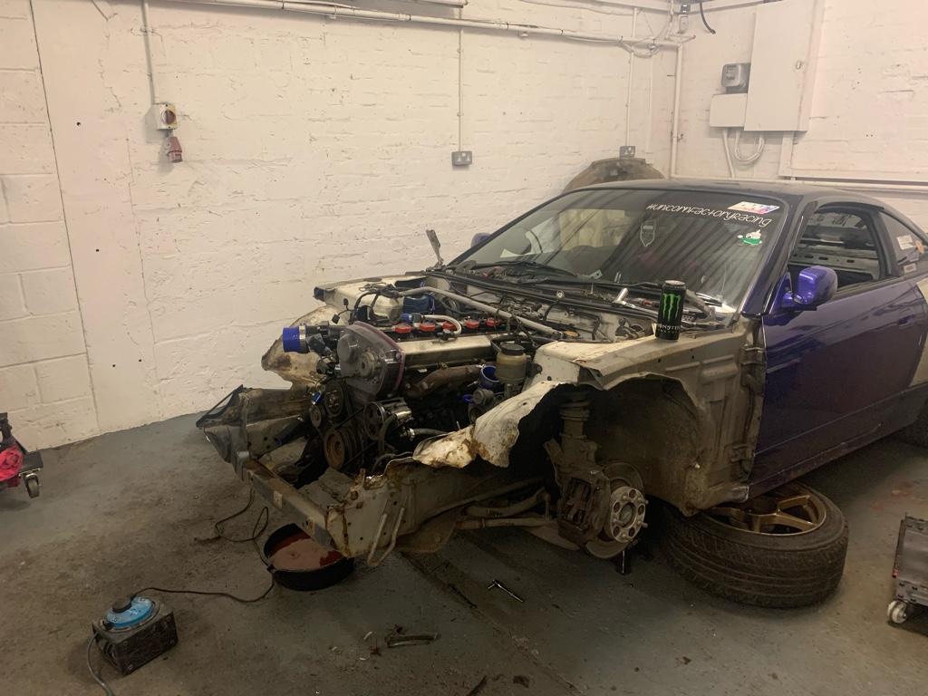

Got a bit bored of standard bodywork, so this happened..
Followed by
26 September 2015
46
6
Cambridge

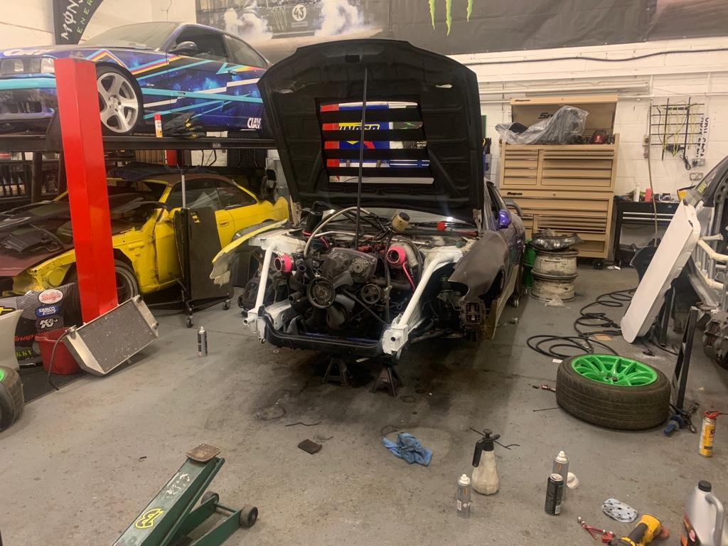

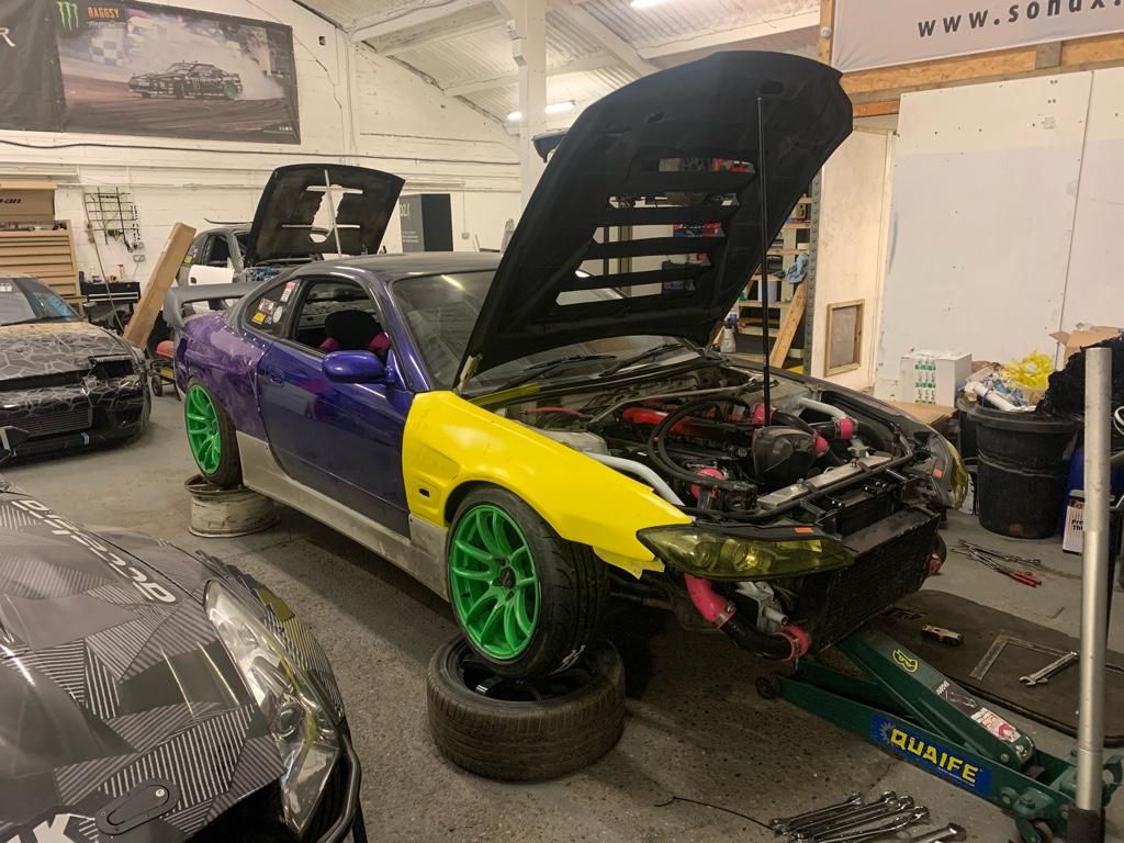

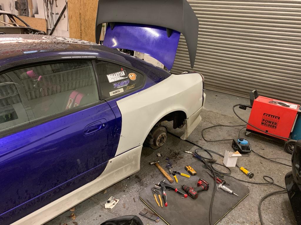

Then had a kind of sucky Saturday Morning

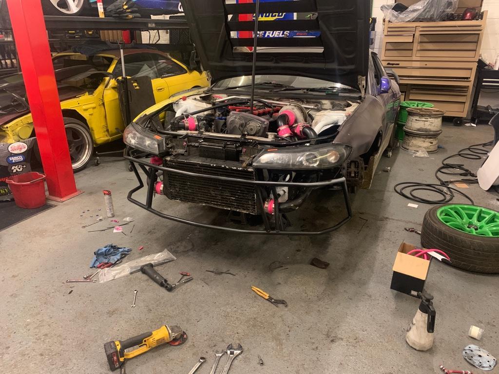

At which point I decided to go a little bit nuts with it

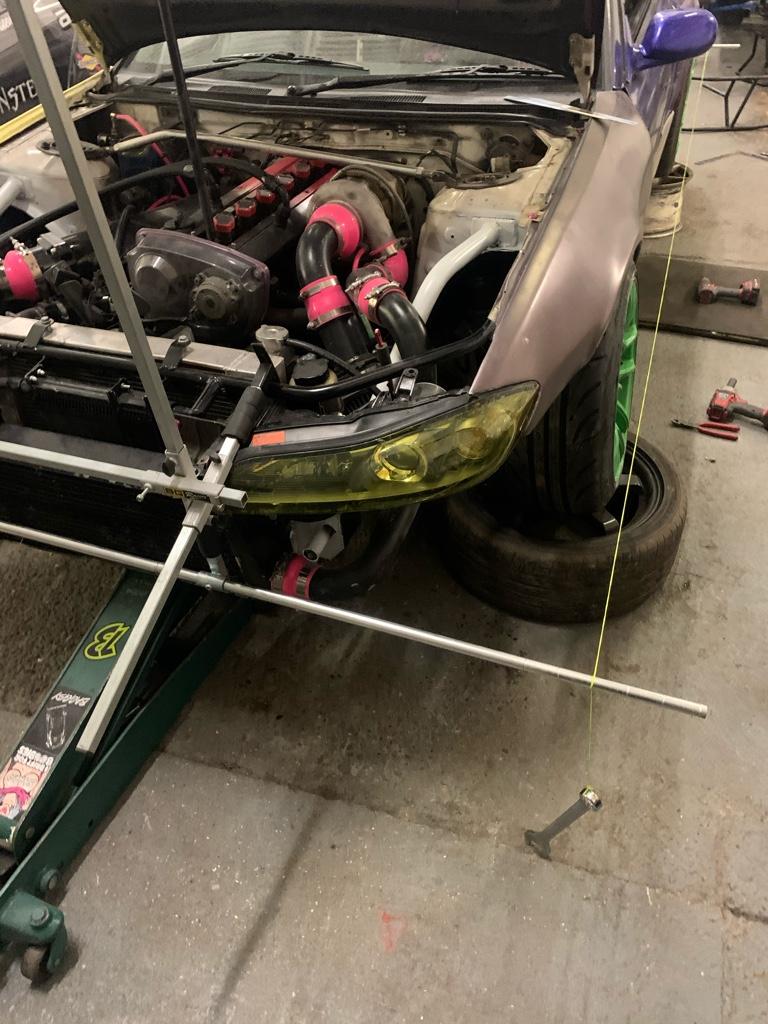

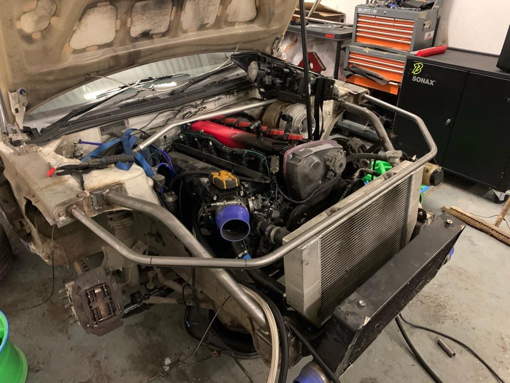

The front end has been replaced with tube, stiffened appropriately along with new wheels, +30mm front wings, the +30 over fenders replaced with +50mm
EPR competition bonnet with vent
Driftworks adjustable front LCA, japspeed Rear adjustable LCA, Driftworks Kinked rear toe arms
Willwood hydro handbrake with ASD handle
Buddy club bucket seat and Pink STR Harnesses
AEM GPS speedo
Oil cooler, PAS cooler, top mount GT35 and all new Pink silicone joiners
New inlet manifold and throttle body, Tomei Adjustable FPR

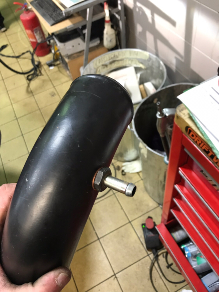

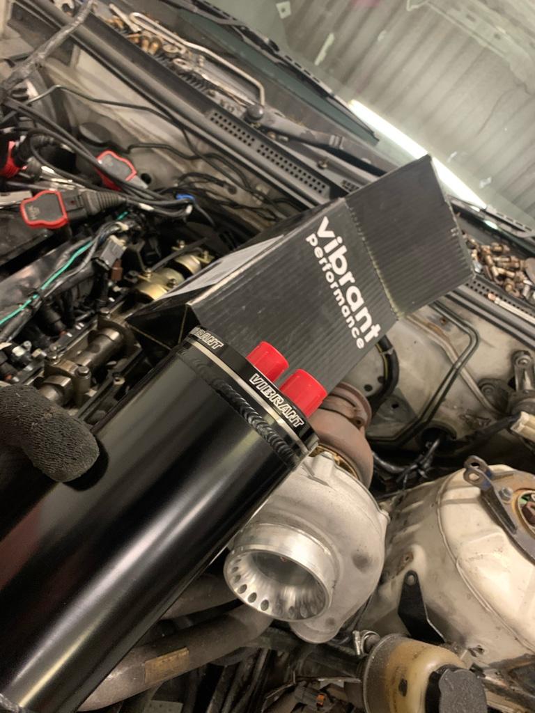

Vibrant catch can with recessed filter
New K & N filter
