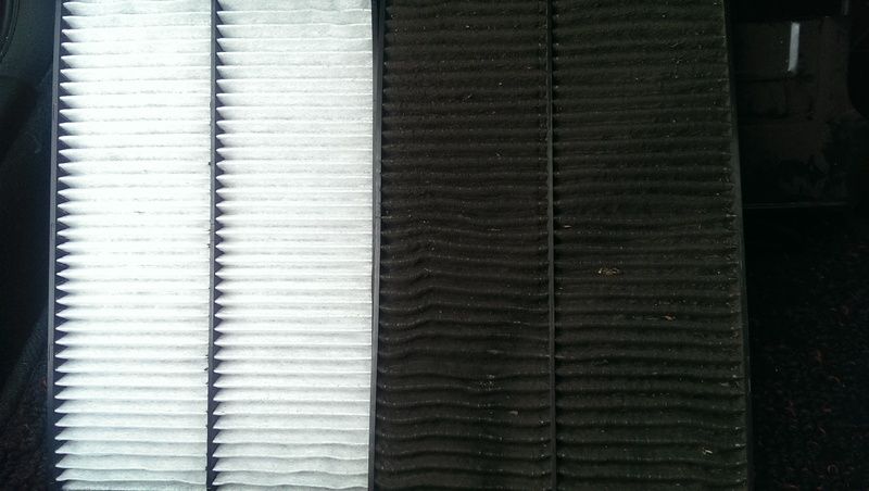

I want to get that metal panel off behind the glove box to change the polen filter but theres 1 screw that is really tight, the screwdriver doesn't get enough grip even if I push hard & its starting to mangle the crosshead. Any tips on how to get it undone?

Thought it was a long shot but tried using a freeze spray on it & it worked.
29 July 2013
274
Derby
It was still tight but it just went "crack!" & was loose.

new vs old :hurl:
